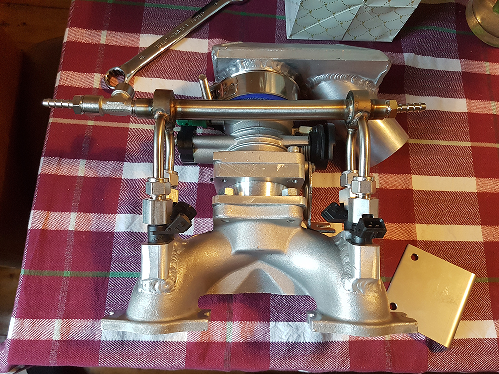

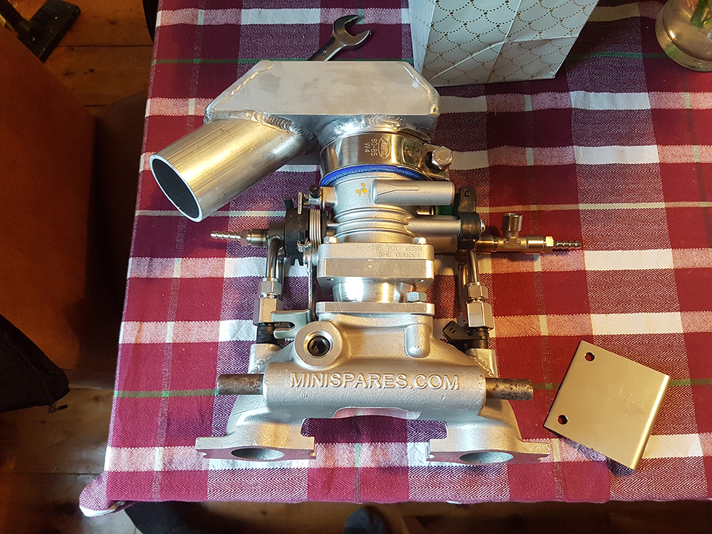

I am in the process of adding injection onto my supercharged (blow through) 1275GT. My setup is below.
Port injection, 4x Siemens Deka 630cc high impedance injectors, staged.
VR sensor for crank position/speed. (36-1 trigger wheel)
Hall sensor for cam position (modified dizzy)
Two lambda sensors, one in centre branch, one in outside branch.
MG 52mm throttle body.
MPI IAT sensor
Peugeot IACV in custom housing.
My end goal is to have a nice derivable road car. I am not chasing the last few hp out of a race engine.
I have attached some photos. (any feedback would be gladly received)

Being S/C blow thorough you don't have the pressure dependency issues with the the widebands, just put them in the exhaust the way you describe and they will read fine.
That modified inlet manifold looks really neat, the way you have got both injectors in line with the valves and pretty much the same distance away means port injection timing with staged injection should be pretty easy.

Nice work on the manifold, very neat.
I would suggest a bead on the end of your plenum chamber inlet though to ensure the boost hose doesn’t push off over time.

Tom, I machined a groove in the plenum pipe which connects to the throttle body to give the hose something to grip to. I should of done the same for the plenum inlet pipe! I will come up with something similar for it.
