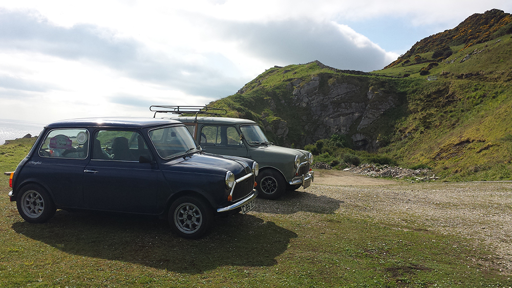

And what does said mini look like so i can spy it on sunday?

Dave, here is a picture taken last year on the way to the Ireland IMM which was basically it's last outing before I started the turbo project. It's looking a little ropey these days so if you do spot it, it is best viewed from a distance of about 20ft! *hehe!*
