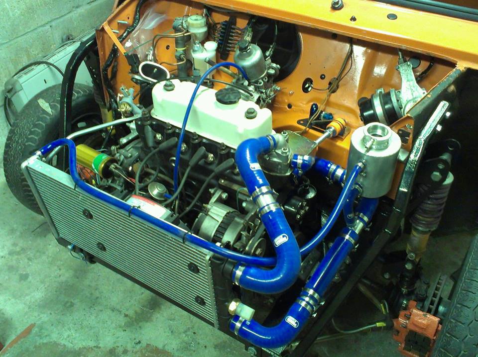

With a removable front end, I'm not sure how much this will help, but this is what ours looks like (dirtier now!).

I have no heater
can see the T here line just through turbo first instead of a heater
different header can see outlet of header goes to expansion tank to help self bleed.
