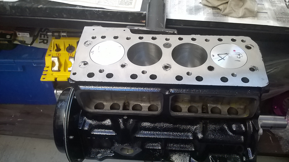

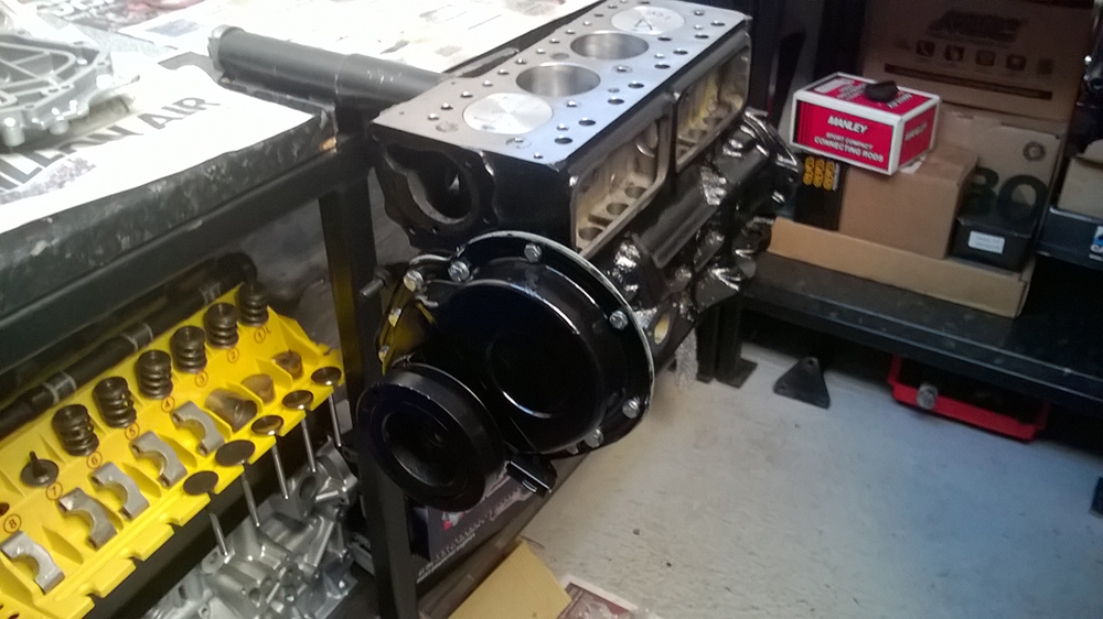

Slow progress at the moment I've had the block re bored +40 calver st pistons sticking with standard rods and crank just all balanced centre main bearing strap .Head was going to just be a freshen up unleaded valve seats and chambers taken out to correct CR .but now going for slightly bigger valves and ports polshed. Going to rebuild my gearbox and fit a cross pin diff .
