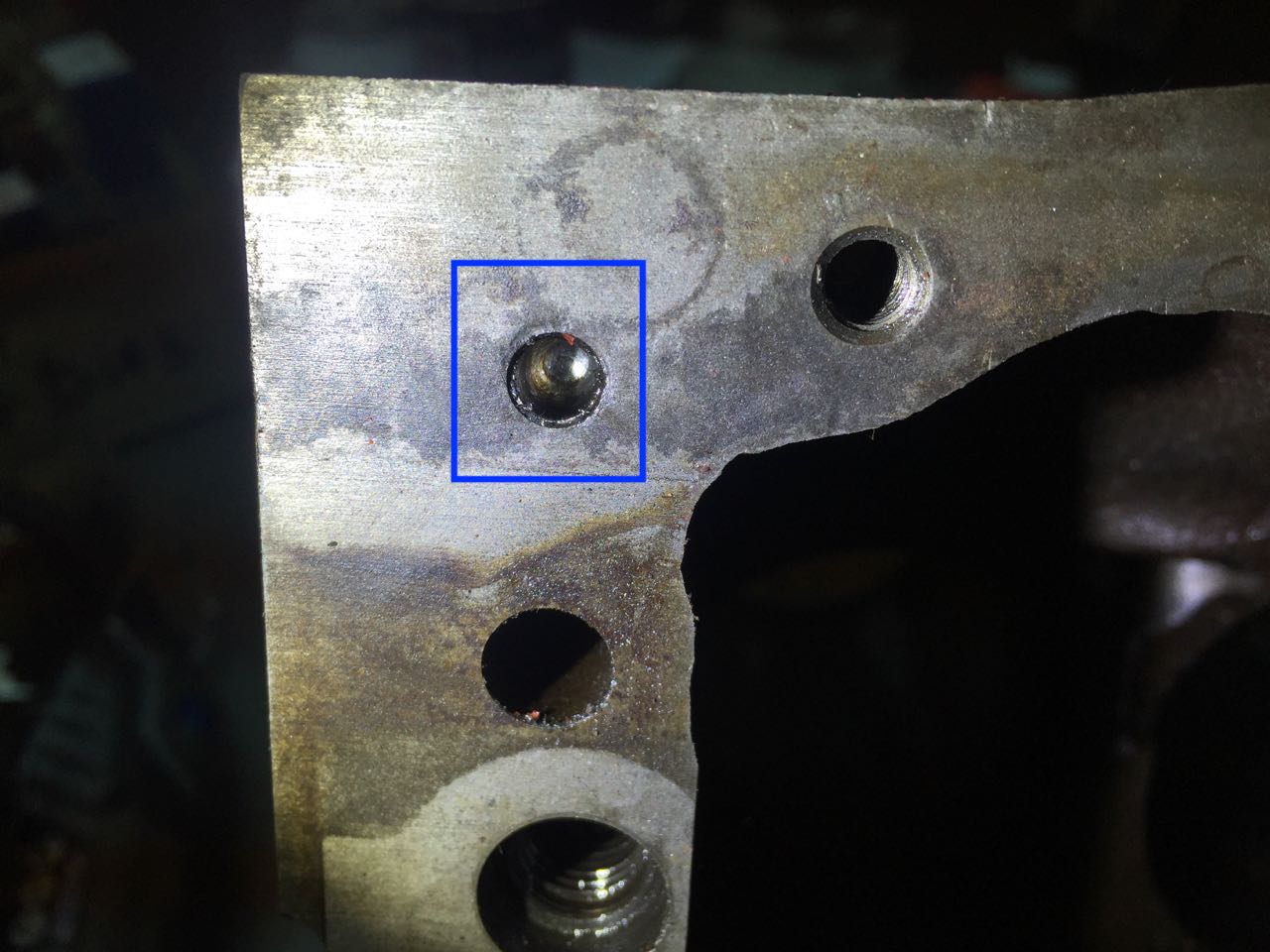

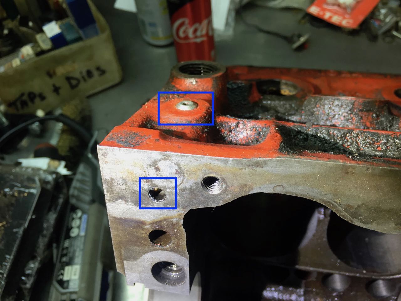

I am currently preparing my block to go to the machine shop to have it cleaned, skimmed and bored. I want to remove all oil gallery plugs to get it nice and clean on the inside. I have removed the four obvious ones (two on either side of the block) but I was wondering what these two items are (in photos below) and whether they need to be removed to give me access to the oil passages behind them?

Anyone that can comment on the "oil gallery plugs" on the photos I posted?

those gallery plugs blank off the drilling that vent pressure from behind the oil pressure relif valve, theres no real " flow" through there, only what leaks past the oil reilef valve.
personally I leave these in place, but you clould pull them if your feeling particuarly thorough,
Thanks Joe, I'll leave them in. I have enough tasks on my to-do list for now... *smiley*
