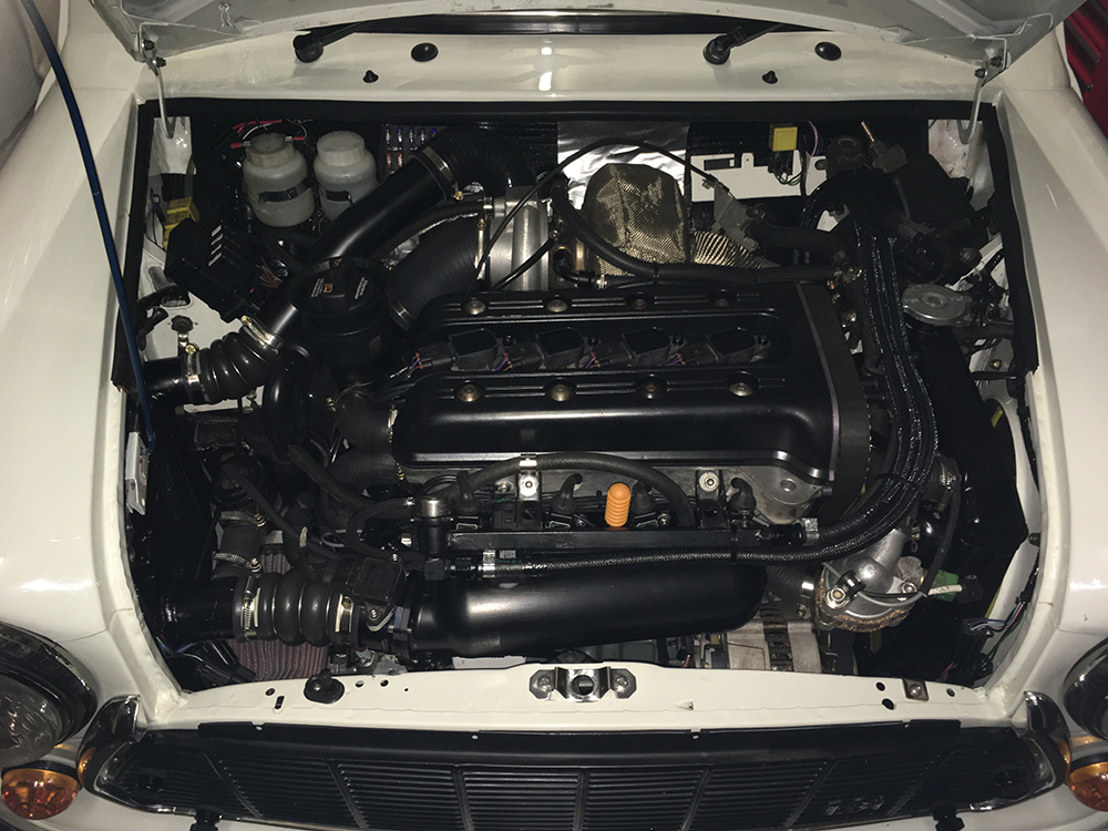

All I will say is, the smaller the hose you use as a breather, the greater the velocity of the gasses that pass through it. Others experience as well as my own, these engine seem to be quite heavy breathers. The increase in blowby gasses increases the velocity in the small breather pipe will naturally pull oil with it, it’s the same principle that refrigerators use to return oil to the compressor.
In general you want to take the breather from as high up on the engine as you can. Maybe a 1” hose what you do with that then is up to you. I think the small bore hose on the SC system should go to collector that’s usually bolted to the mechanical fuel pump mounting. I’ve debated before why they use a large hose and a small hose both from the same point ending at the same point.
I opted to have a 1” oil drain welded onto the end of the head where the core plug is. This drains into the side of the original breather can, and there is a baffle to ensure the oil has to run to the bottom. This 1” hose also acts as the main breather from the head. I further modified the breather can so that it accepts a standard VAG oil filler cap. I added an oil separator again from a VAG car which takes the same oil filler cap. This is my main breather which is maybe 20mm ID. The breather location on the transfer case was modified slightly to allow oil to drain down through onto the idler gear quickly. I then have the two drains off the back of the block and one off the end of the head maybe 10mm ID. The breather outlet is plumbed into the inlet duct via a diaphragm valve and a PCV valve constantly draws into the plenum under vacuum conditions. So far I’ve only seen a film of oil on the inside of the breather hoses and the inlet duct is clean and dry. I’m sure there is some oil vapour getting through but not enough to be any more of a problem than it is on any OEM car. One good thing is that there is no oil film all over the engine bay.
