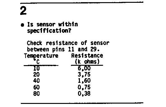

I have this that I think came from the Rover service manual:
Engine coolant temperature (ECT) sensor
The engine coolant temperature (ECT) sensor is located on the coolant outlet elbow. It is a temperature dependent resistor (thermistor), the voltage output of which varies in inverse proportion to temperature, in that the output increases as temperature decreases or the reverse. The change in resistance is monitored by the ECM on a KG wire and as a result the ECM can adjust the length of injector opening time required. The ECM supplies the coolant temperature sensor with an earth path on a KB wire.
So I thought it would be easy to test out of the engine with a 5 volt power supply and a voltmeter.
Can anyone suggest how I would make the connections to do this? I seem to read a constant 5 volts no matter how I connect the sensor.
I can test the resistance fine, but I would like to check the voltage output to verify the temperature table

First there is something wrong with that graph (or the table it was generated from) pictured above.
As Jean says, you can only see a voltage vs temperature curve once the bias resistor is connected and the more normal way to approach this is to look at the resistance vs temperature curve (or table) of the sensor itself.
The sensor itself will have an NTC thermistor inside it, (Negative Temperature Co-efficient) which obeys a very precise equation called the Steinhart–Hart formula (google it) which produces a nice smooth curve so the voltage achieved after adding the bias resistor should also be a nice smooth curve. Go to DigiKey or Mouser and look at the datasheets of any thermistor (the bit inside your temperature sensor before all the metal case etc is added) and look how smooth the curves in the datasheets are. That curve in your graph is not smooth at all.
Secondly, the MGF one won't have matching voltages simply because it will have a different bias resistor. However the resistance values look valid and the resistance values themselves will always be what they are whatever bias resistor is used by different ECUs so long as you measure them without the sensor connected to anything - which is the easiest way of seeing if it's giving the right output.
A long time ago, one of the members on here (hasn't been active for ages) did a comparison of four Rover sensors. I can't find the thread but I do have a copy of the results (just in case I was ever to use a Rover sensor) and, as he published them at the time, I'm sure he won't mind me repeating them.
Attached as a pdf copy of his spreadsheet (TM won't allow the spreadsheet itself to be attached) and also attached a jpg copy of the sensors I use (Weber/Marelli from a Cosworth) so you can see they are the same profile/curve, just different values.
The spreadsheet (pdf) is very similar to the MGF table, provided you just look at the resistance.
So if you want to check your sensor I suggest you test it alone, just measuring its resistance completely disconnected from the ECU, in a jug of iced water, then a pan of boiling water and a few temperatures inbetween as the pan cools down.
However, all that assumes is that the SC ECU is actually calibrated for the Rover temp/resistance curve by default. The Megasquirt, by default, is calibrated for a common GM sensor but is easily user calibrated for other sensors - just like I had to do for my Weber/Marelli sensor - just by entering three points from the table because the Steinhart-Hart formula only needs three points, the maths of the curve is that precise.
