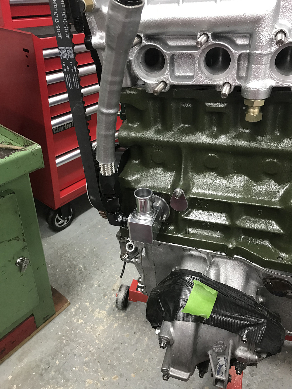

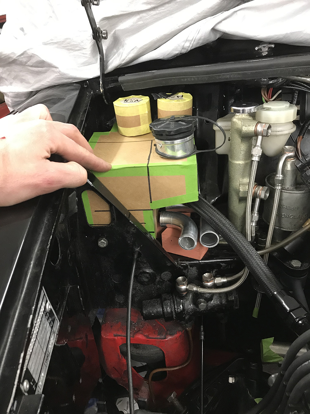

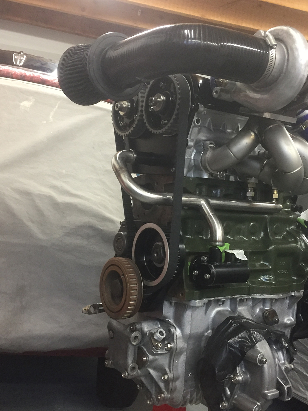

Right hope this makes it easier to see/understand what I’ve tried to achieve.
The black breather block I made originally with 2x 1/2” barbs to which I was going to vent.
This has been replaced with another block I made minus the two 1/2” ports.
The drain from the head has now been extended toward the clutch housing where it will meet with the vent from the housing up to a baffled separator / breather tank.
I’ve purposely not taken off the rocker as the theory (I believe it was Slater) that venting off the crankcase well enough would allow any positive pressure in the head to vent to the crankcase via the drains.
If this proves poor in practice I’ve left sufficient space to add vents from the rocker.
Shane.

Just so I can understand, you have run the drain from the head to the block mounted at the fuel pump location and then T'd it off and extended it to a separate breather catch tank which also the crankcase breather goes to?
This sounds achievable, although making that catch tank would be difficult with my welding skills, can I just leave it in cardboard form *happy*
Thanks

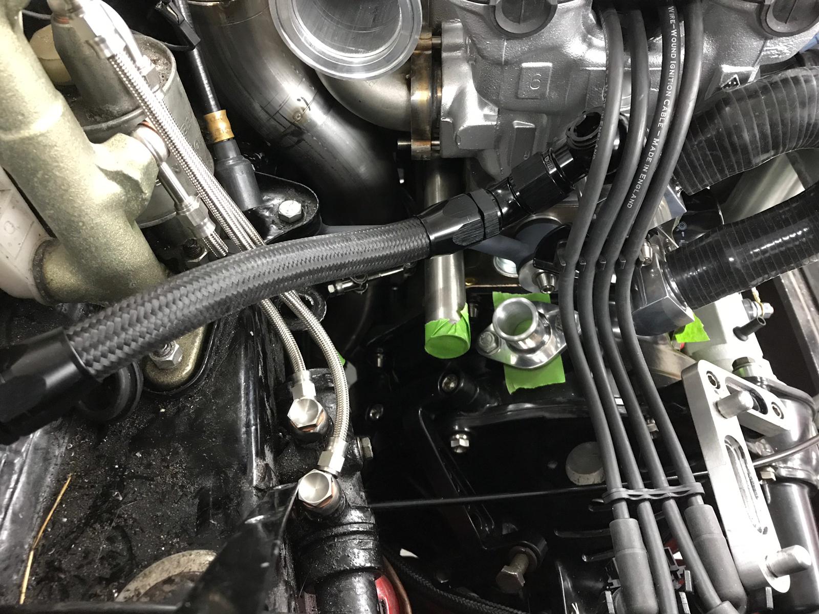

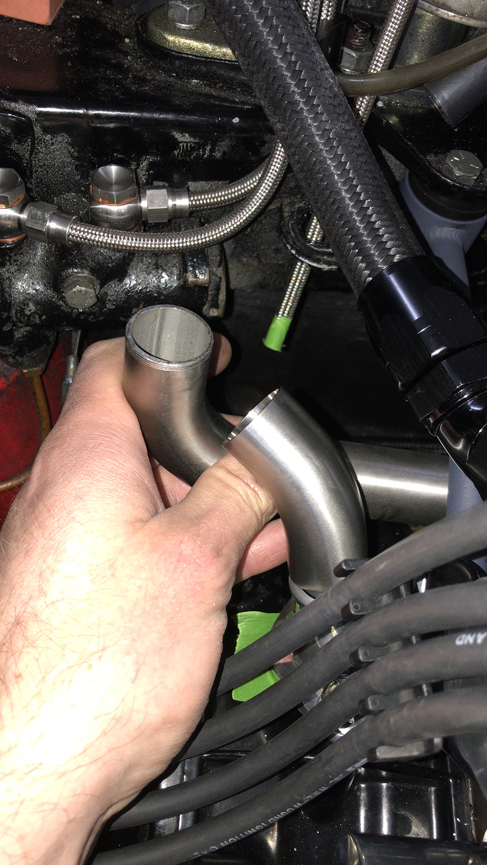

Yes, if you look at the first photo of the rear of the engine this is pretty much what I have ended up with. But the 25mm tube has now been extended to where the clutch housing breather is. Two hoses will then go up to the separator/breather tank.
I’m afraid I haven’t any current pictures of the rear of the engine with the latest revision, hence the multiple images and poor description.
Found another pic showing where the extended tube now runs too, I hope that adds some clarity.

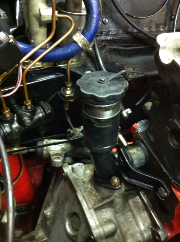

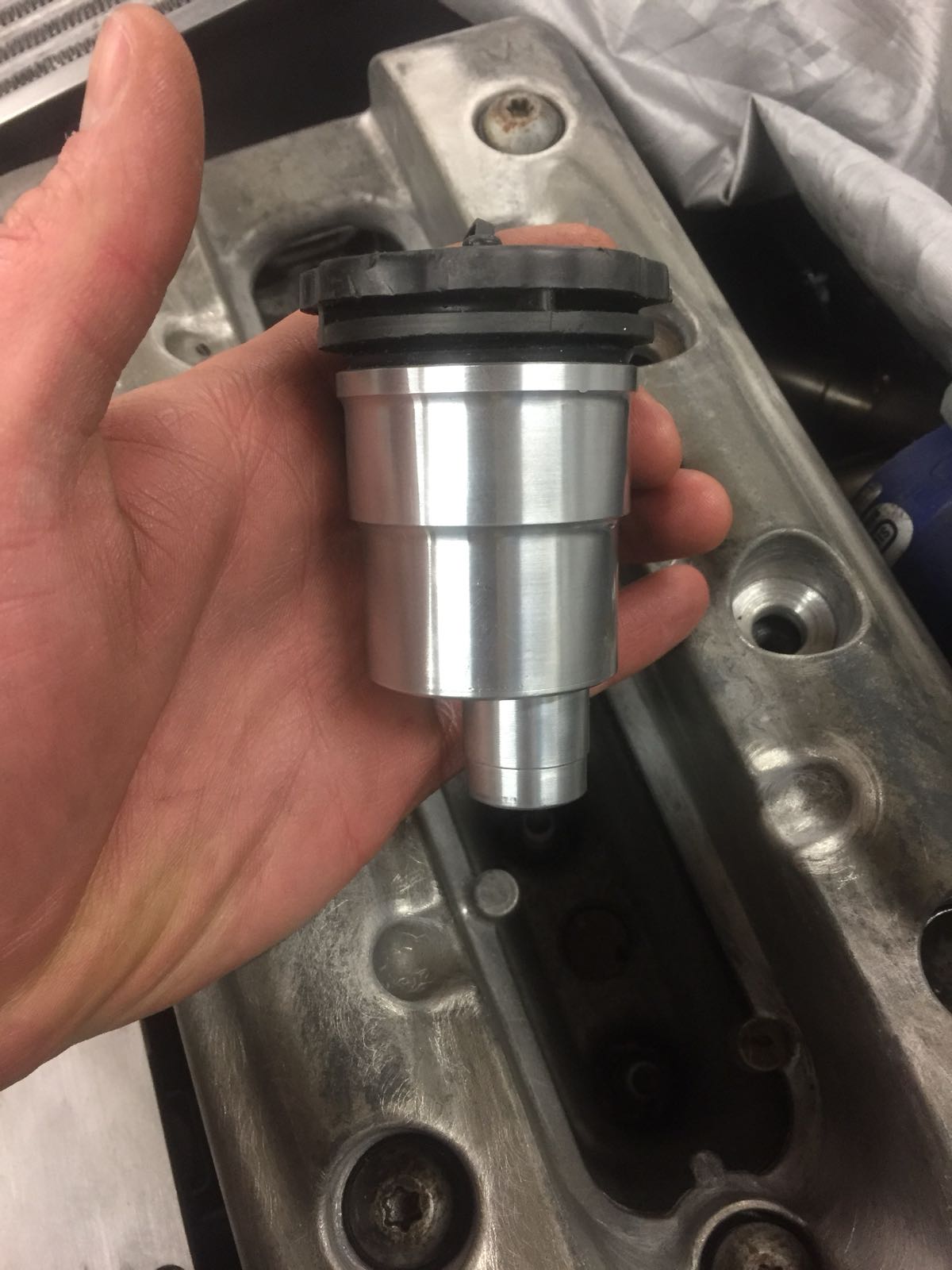

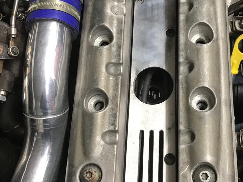

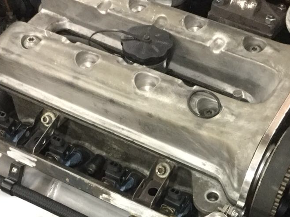

Re oil filling I’ve p@@sed around with a few ideas over the years but not really got a definitive yet.
My favored option was a caninableised breather can with a filler on top (similar to what SC sell) but space ruled otherwise.

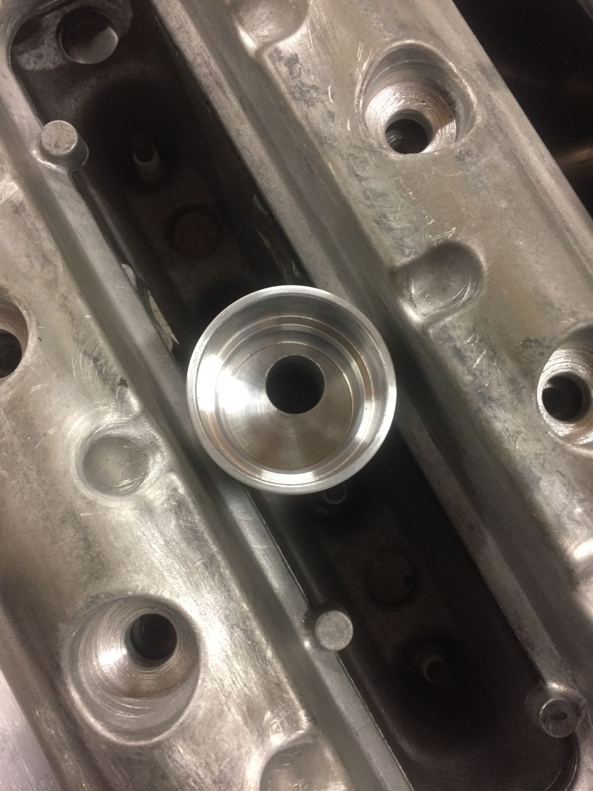

I then faffed with a filler that drained in to a core plug for the oil gallery on the head between the cam’s. Aesthetically it was nice but made doing anything with the leads a pain, it may of been ok if using coil on plug.
Again hopefully picture explain better.
Shane

Could you fill with oil through the dizzy hole or is that hard to get to. Been ages since I've seen my engine in the mini itself?
If going down the route of modifying a breather can to use as a filler on the transfer housing would you 't' in to the pipe to run a breather to it also?
shane
2646 Posts
Member #: 1246
Lowestoft, Suffolk.
I can see that, but that said there has been previous comment on here within other breather related threads that there is a lot of oil flying about around the transfer case breather with the drop gears located below, also I think it was Joe C mentioned once that a lot of oil gets flung out of the dizzy hole if open with the engine running but that hasn’t stopped people using either as breather point successfully.
The advantage you have here is you have a car that’s running and a breather system that dare I say is proven.
I think I saw once on here that someone did use the dizzy hole as an oil filler, but this obviously takes up space at the front of the engine bay that could be used better. I agree with Slater the transfer housing is the neatest option.
