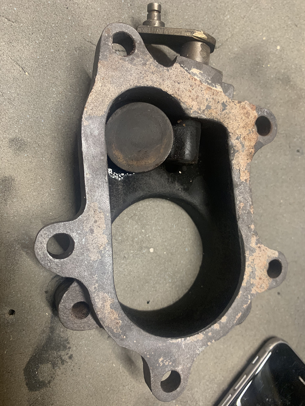

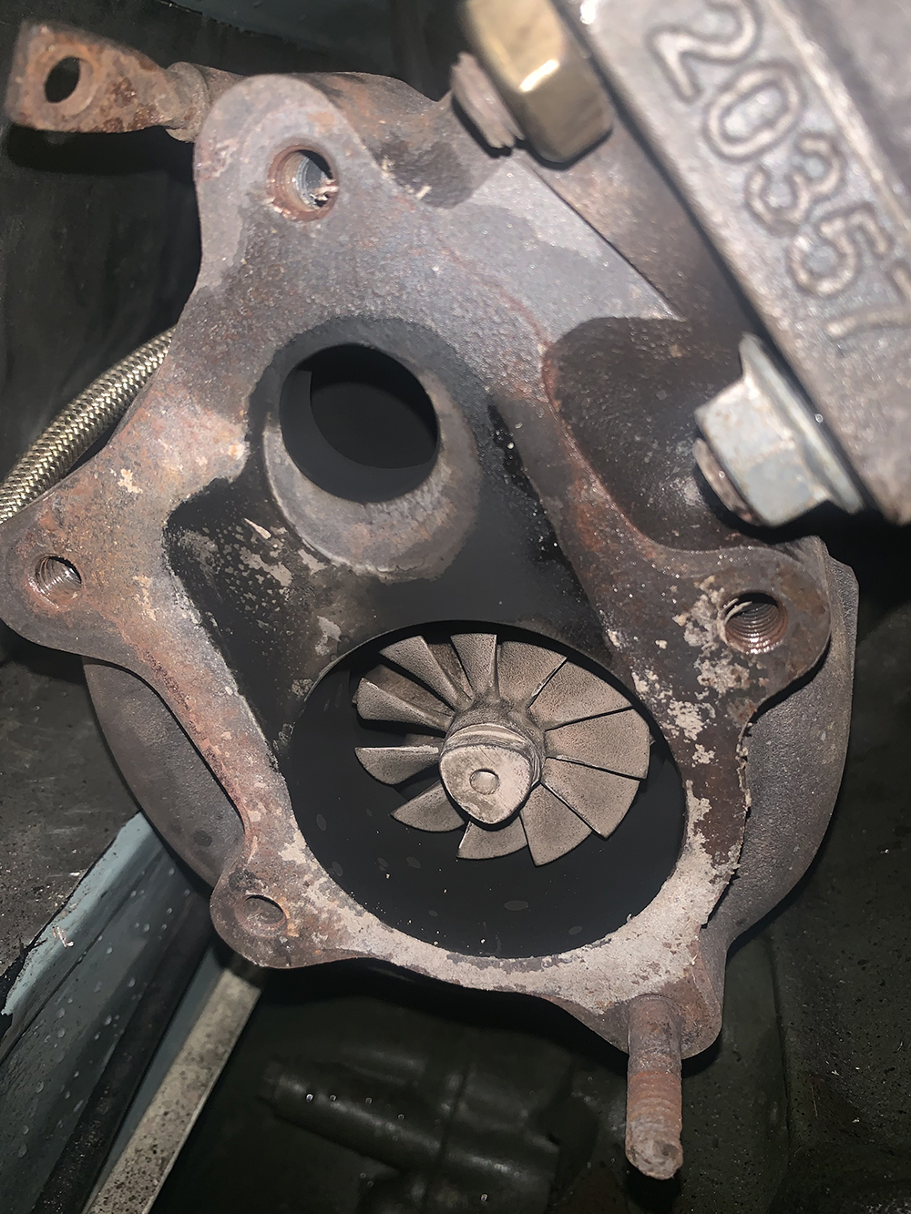

So took the car apart again tonight and think I have sussed out the problem! Seems like the actuator has far to much play in it preventing a full seal over the hole (see pictures) You can also see the sealer I used which I will remove. Is there a way to tighten up the actuator/flapper rod? Or do I need to source a new part? Seems like mostly up and down play not side to side.

What do you mean it has far too much play ?
It's a simple flap, and you were asked ages ago to ensure it was actually closed, and ideally with maybe half a hole pre-load on the actuator arm.
Which from the black marks....seems it was nowhere near closed, and doesnt even look as if it is aligned over the hole ?
Is something fucked with the arm/flap ?

It looks fooked to me too.
Usually when there is play in the wastegate shaft or it's not sealing it's new turbo time. These aren't parts you can get.

I fully understand how the flap should work and reset the preload several times before stripping it apart. As I just said the shaft has to much play up and down as shown in the black marks. This is allowing it to leak at the top.
I am not going to scrap my turbo just because this part is not available. I plan on removing the weld from the top of the shaft then moving it up and re-welding to cure the up and down play. This will then make a full seal over the hole and solve the problem.

So finally managed to figure out the cause of this!!! Bought another turbo from phil and as soon as I took the wastegate housing off I started to see differences.
The turbo fitted to my car I had bought in a kit from eBay described as removed from a running mini. This was lies!!! The hot side of the turbo was completely the wrong size inside so the core was just sat in a void. Wastegate hole was lower down so poppet valve did not cover. So I have changed this along with the cover took it for a test drive tonight and bloody hell I have boost!!! 🤪
What other vehicle could this hot side be from as it’s clear that it’s not made for the mini turbo core?

Well done finding it. Frustrating but often can be the way with second hand unknown bits. A photo would help but the exhaust housing is metro specific, it could be from any other larger T3.
