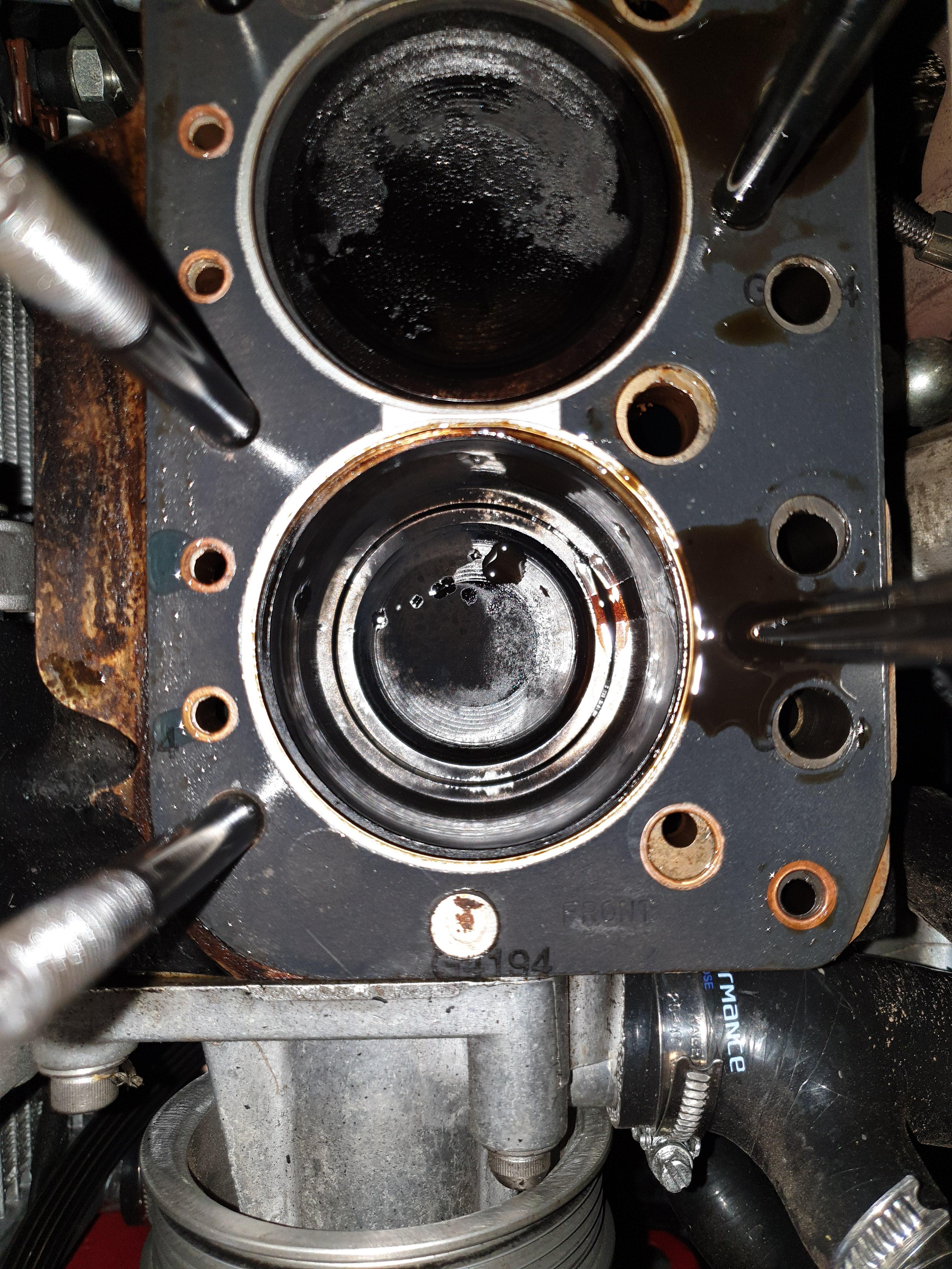

Quick rundown of today - Went for mapping, car is running 13psi, comp ratio is around 8.6:1. On the last run i noticed a puff of white smoke come from under the car, on investigating the engine bay, white smoke was coming out of the breathers, but no colours out the exhaust. We called it a day and checked compression on all cylinders:
1 - 80psi
2 - 175psi
3 - 170psi
4 - 175psi

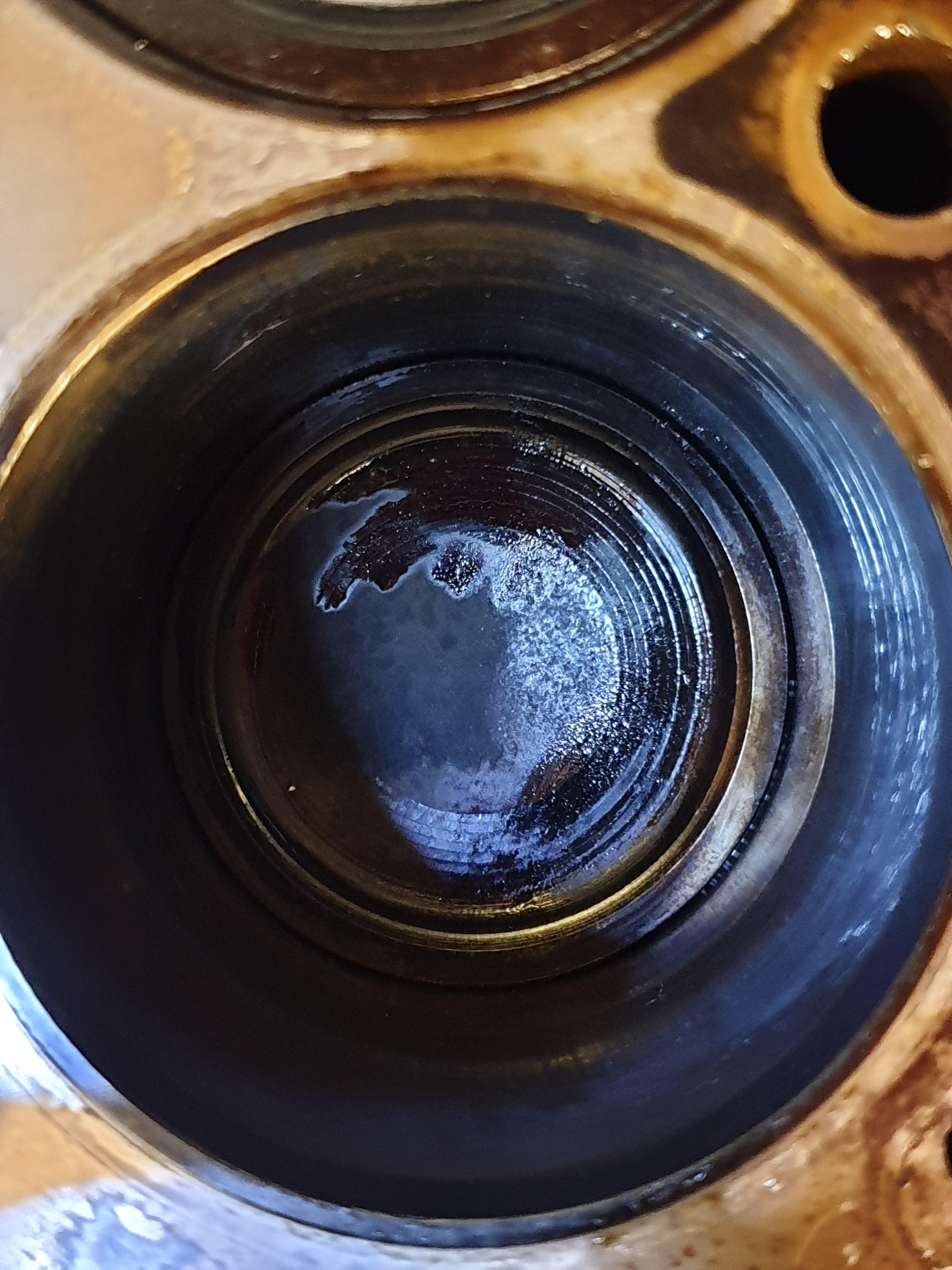

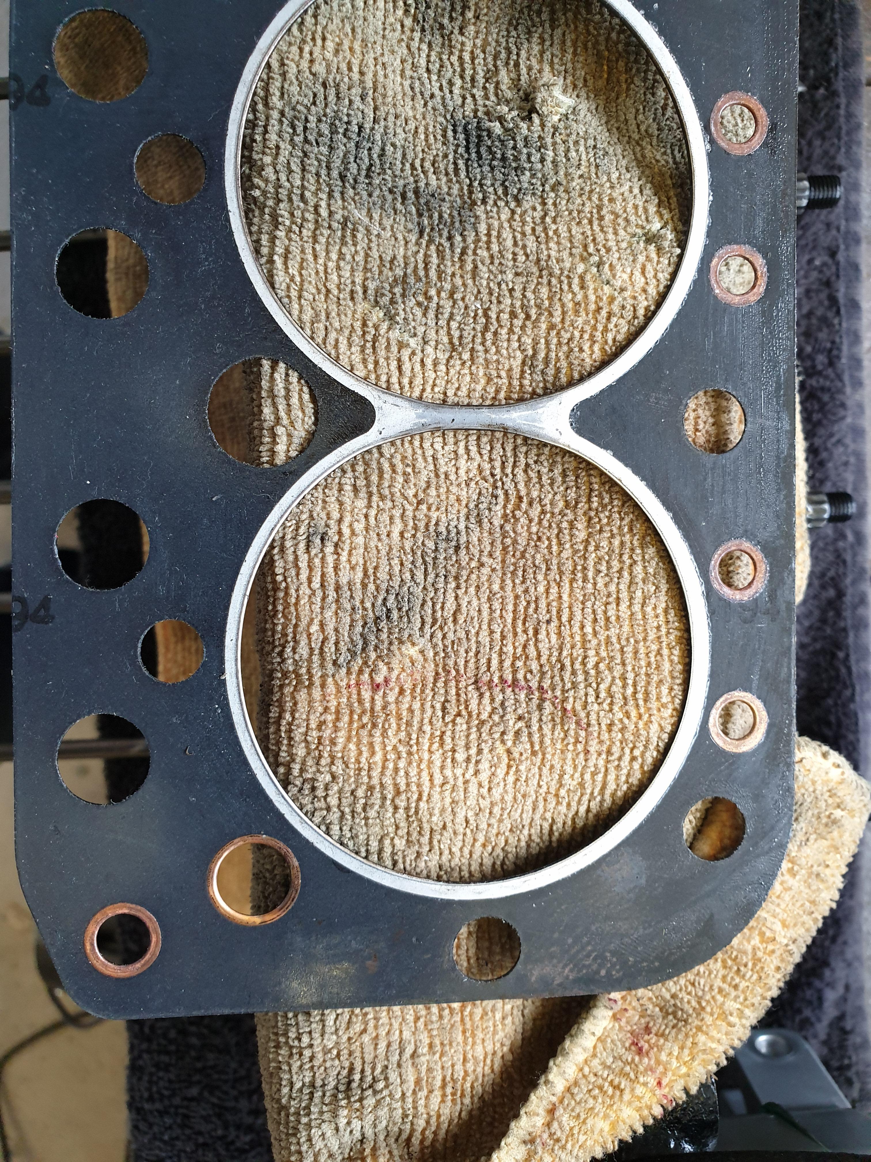

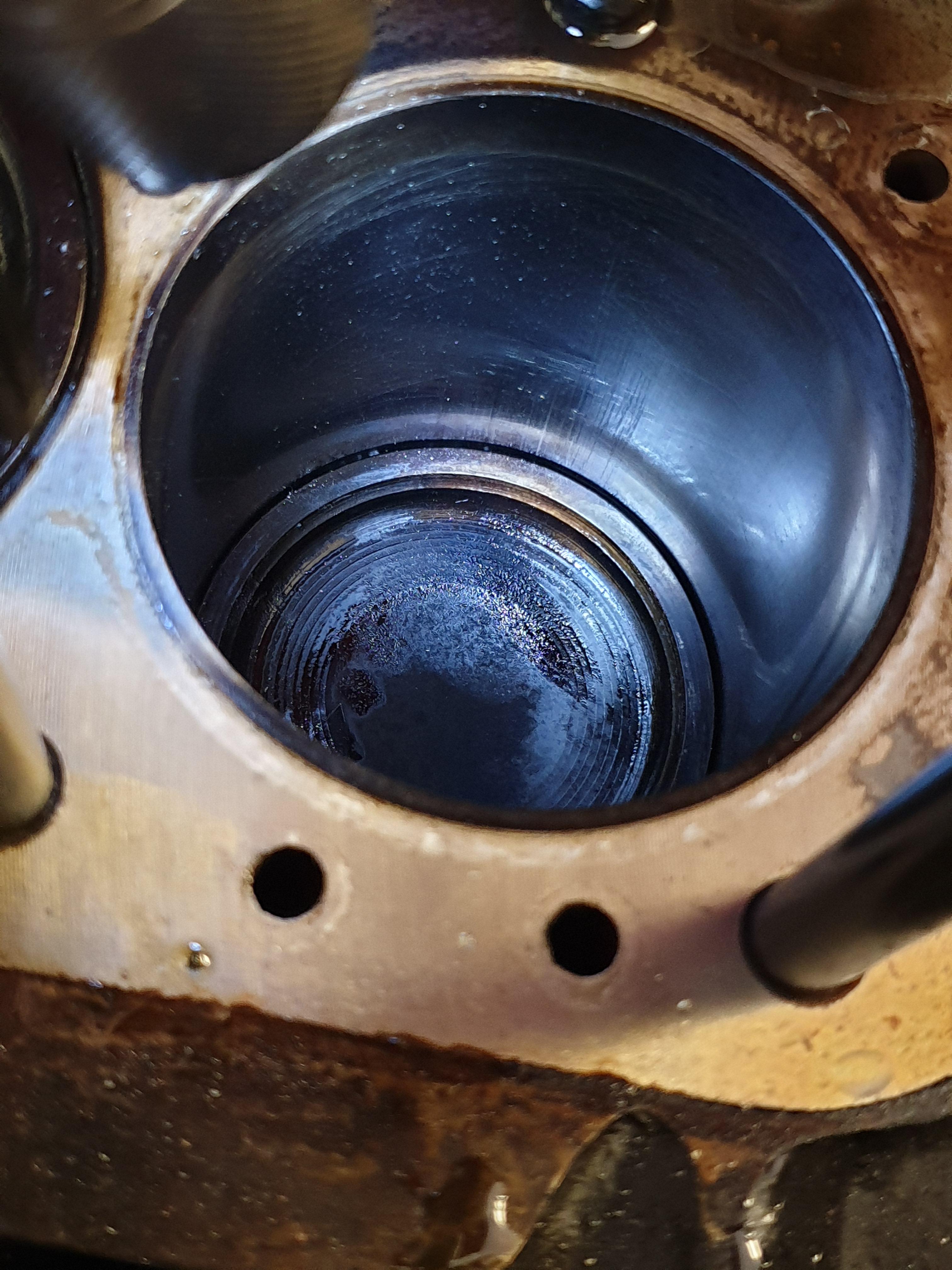

Clearly something wrong with cylinder one, however no oil on the spark plugs and no signs of det on the piston crowns. Got her home and whipped the head off. Cylinder one has minor scoring that cannot be felt with the finger nail.
Now, in the past when i've seen pistons get blow by, its quite a tragic loss to the cylinder, this just seems odd! Any ideas?

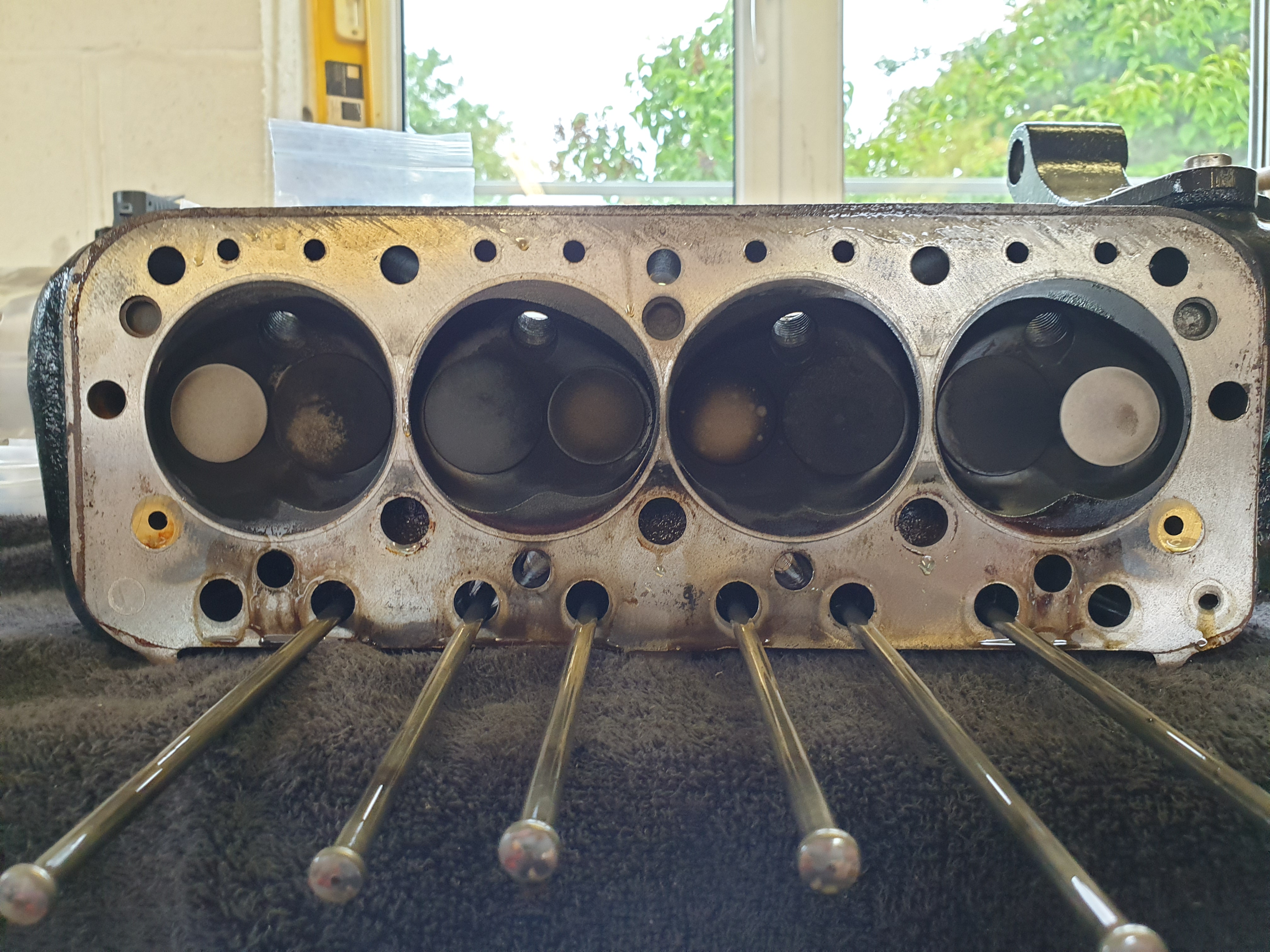

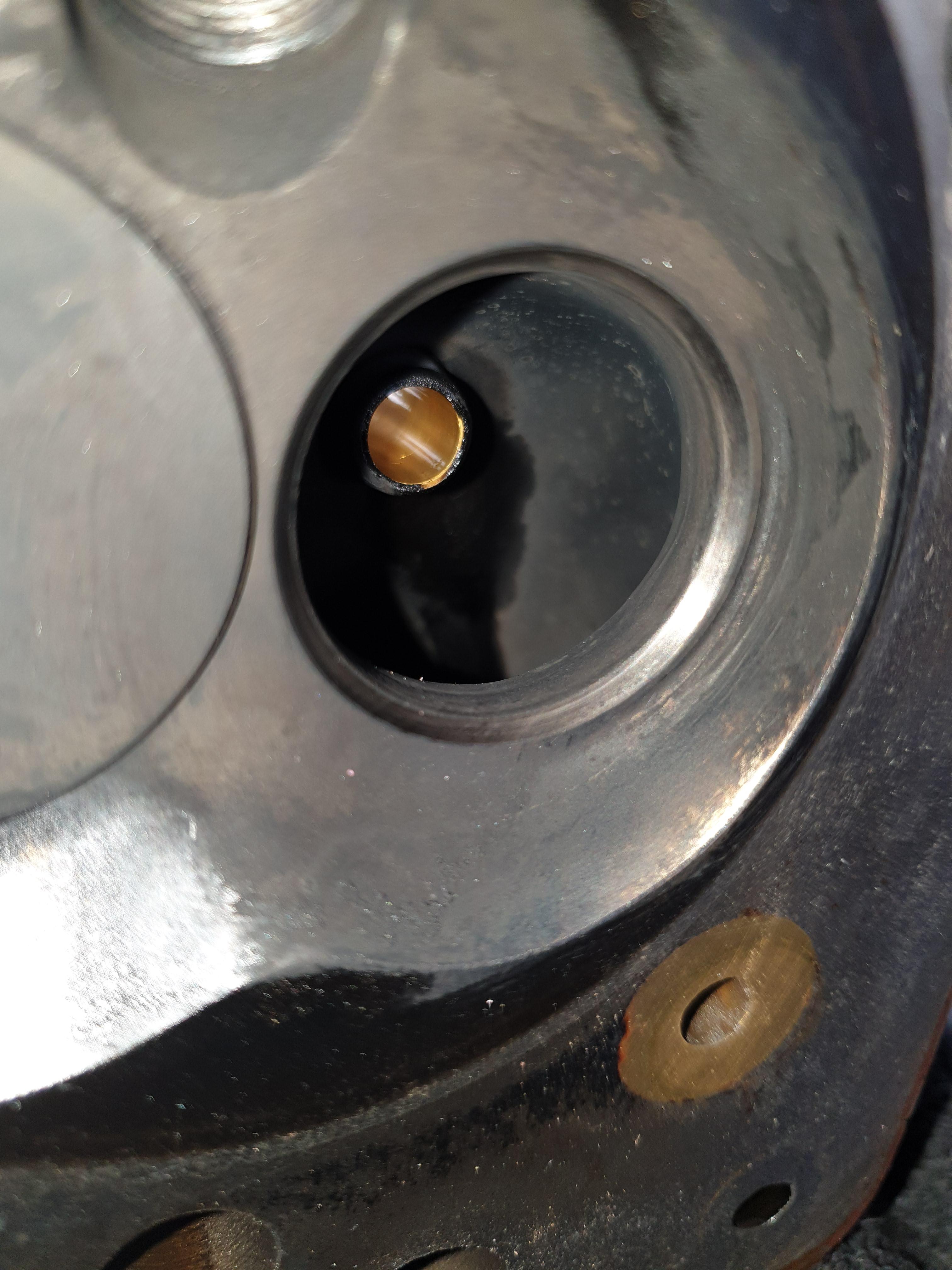

I would say you need to get that piston out and have a look. Could be a broken ringland which might not damage the bore.
On 18th Jun, 2019 Paul S said:
Rich on inners and lean on outers. Poor fuel distribution.
Check the exhaust valve before digging deeper would be my advice.
Not sure if you missed it Paul but he says it is smoking out the breathers and fairly heavily. Would of thought that could only mean one thing?
Only quickly skimmed the pictures.
The bore damage looks like it could be caused by debri.
Is that exhaust valve even sitting on its seat?

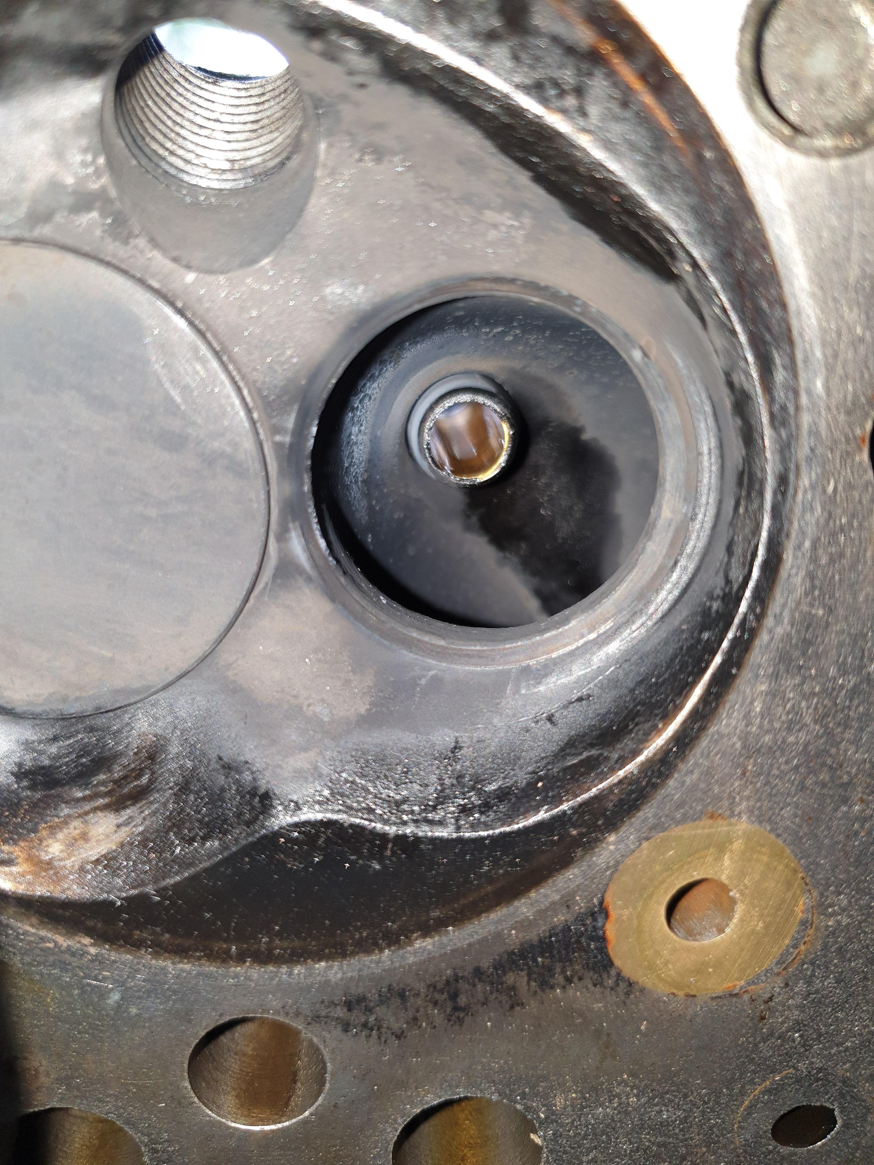

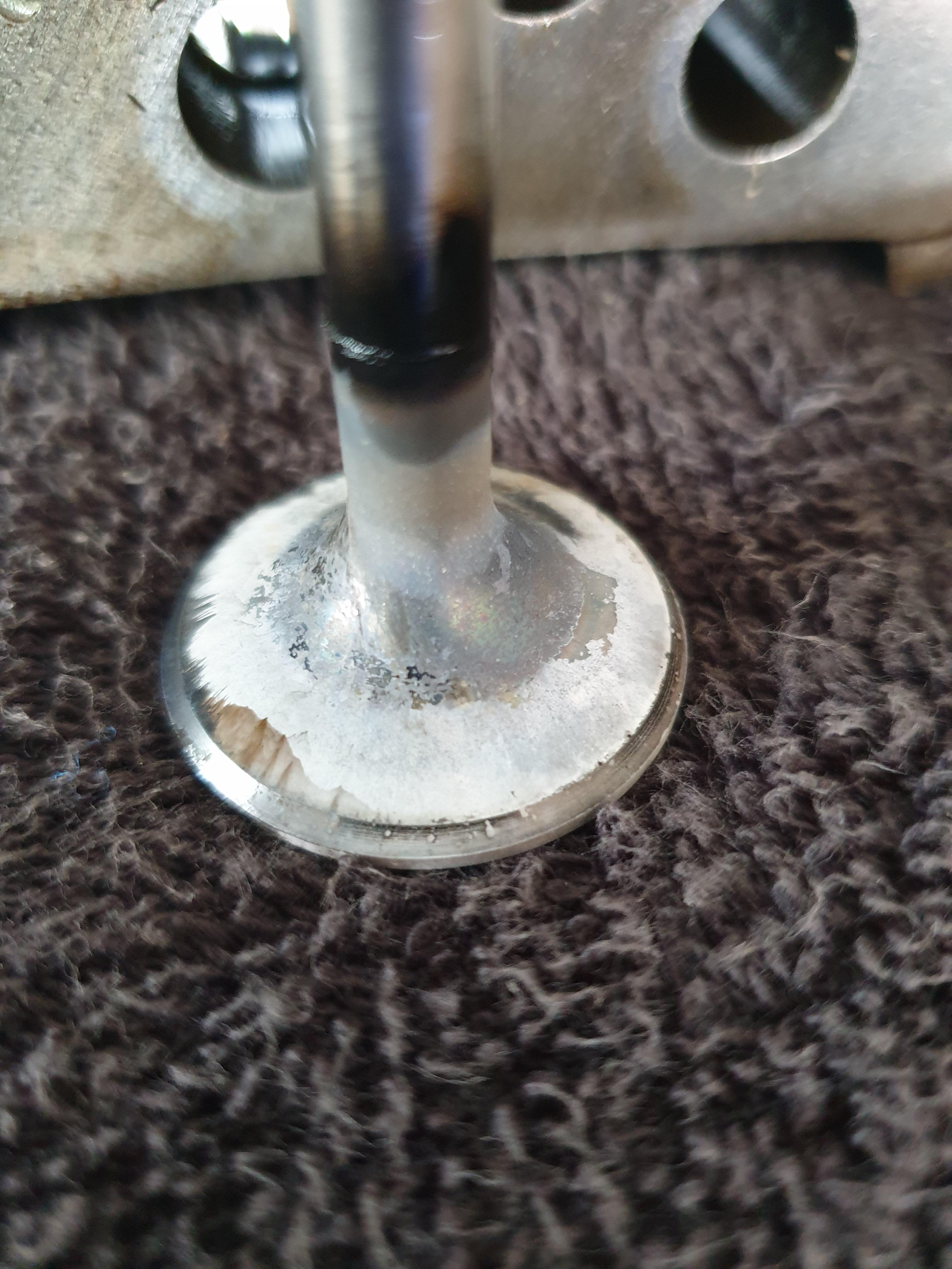

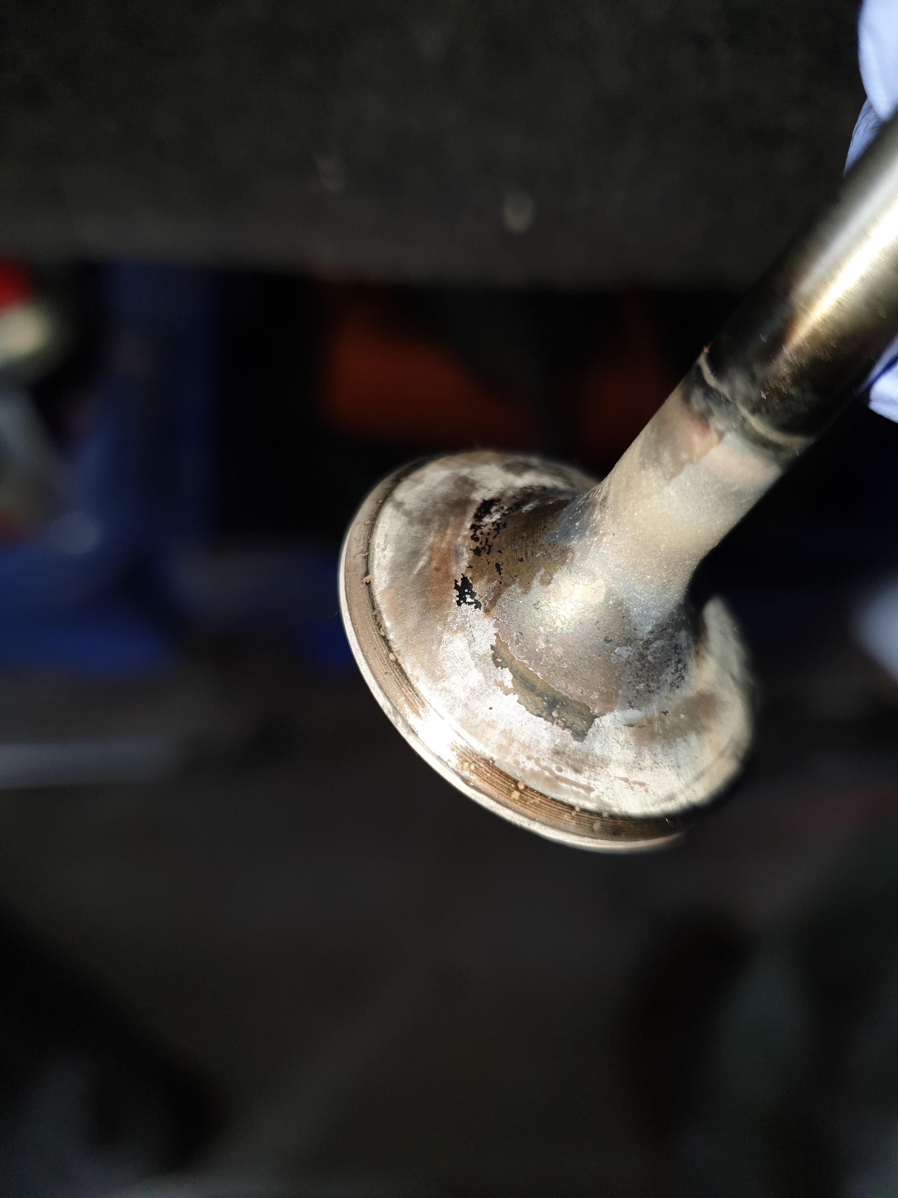

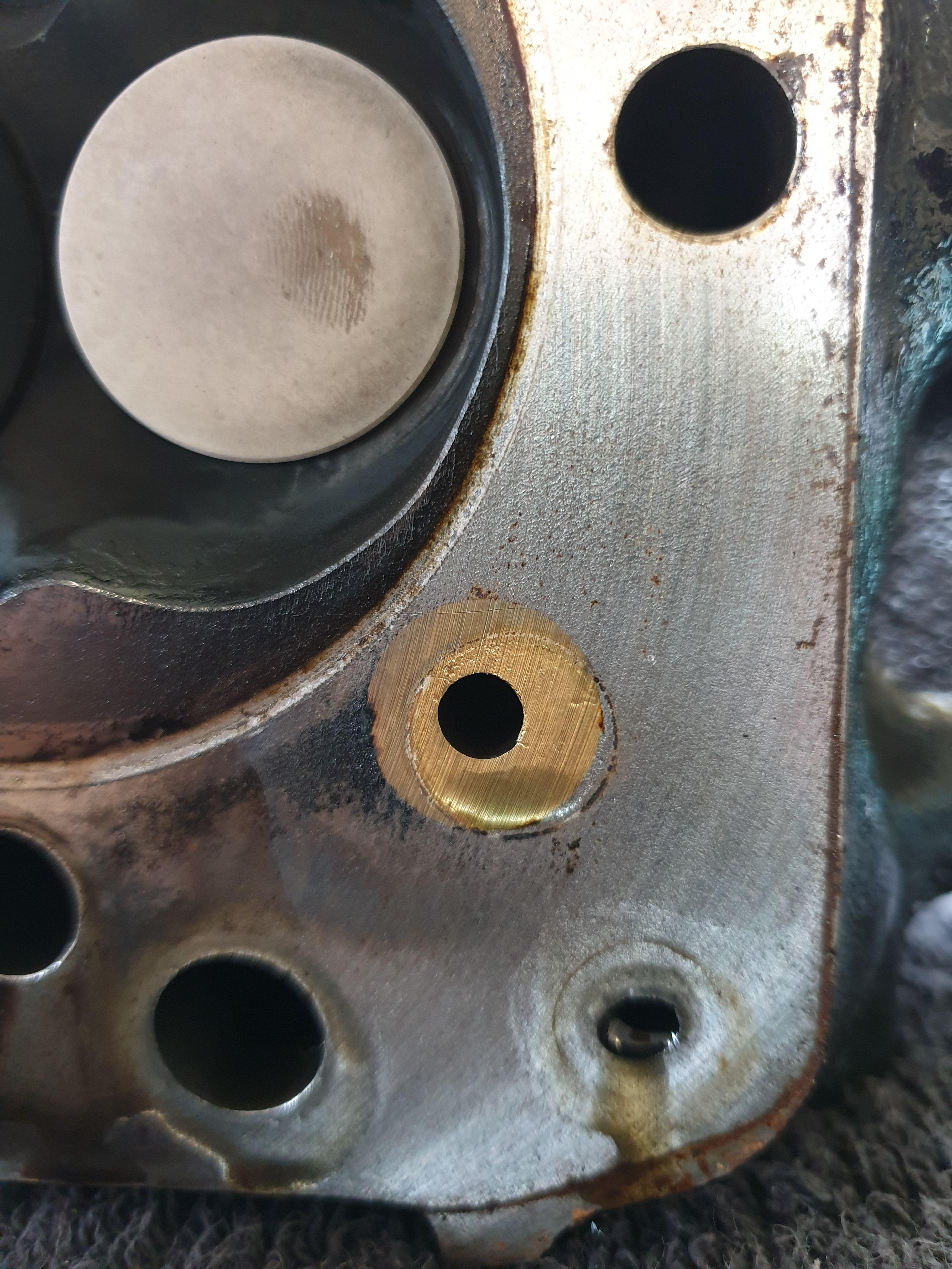

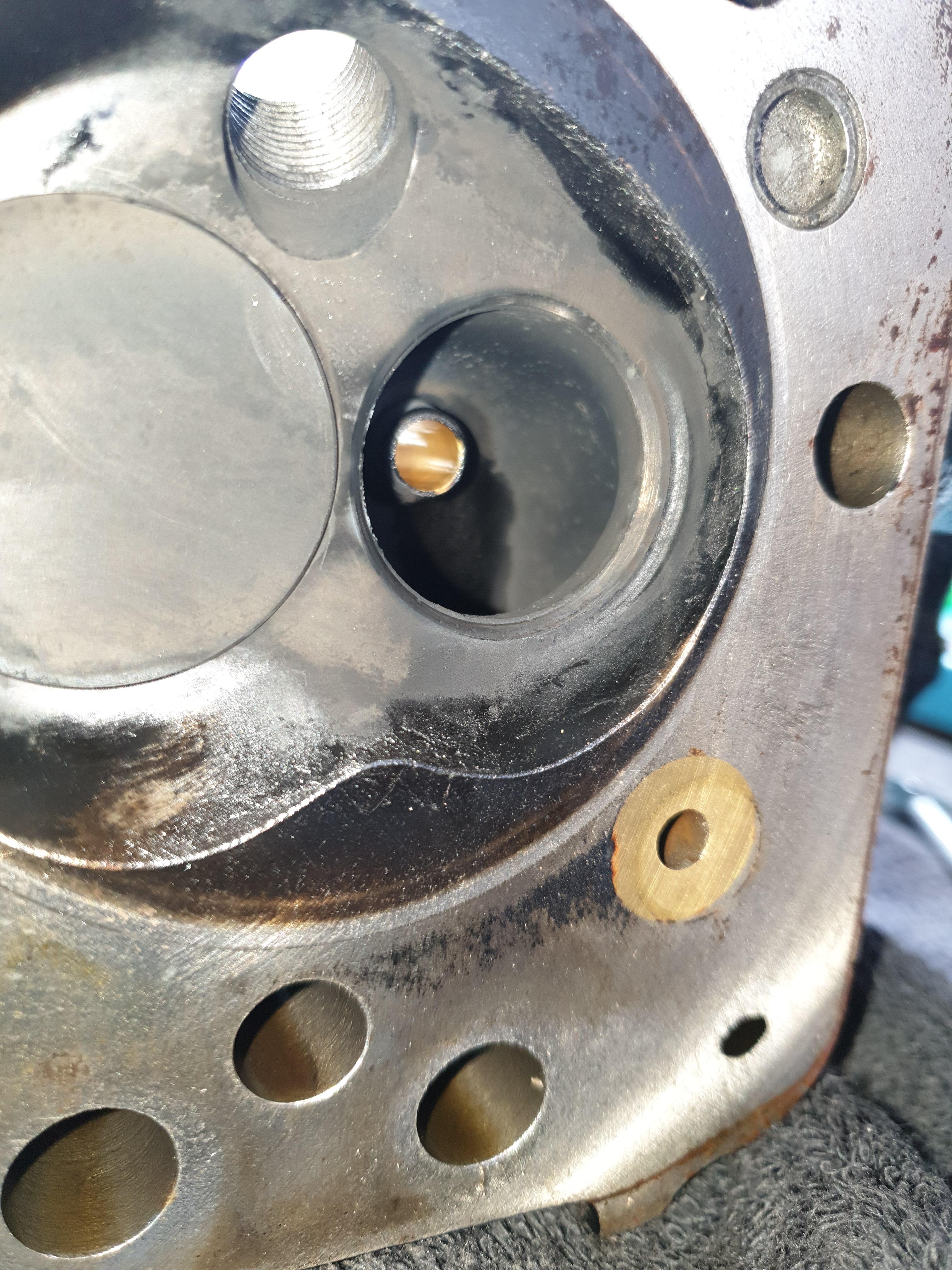

Hi all,

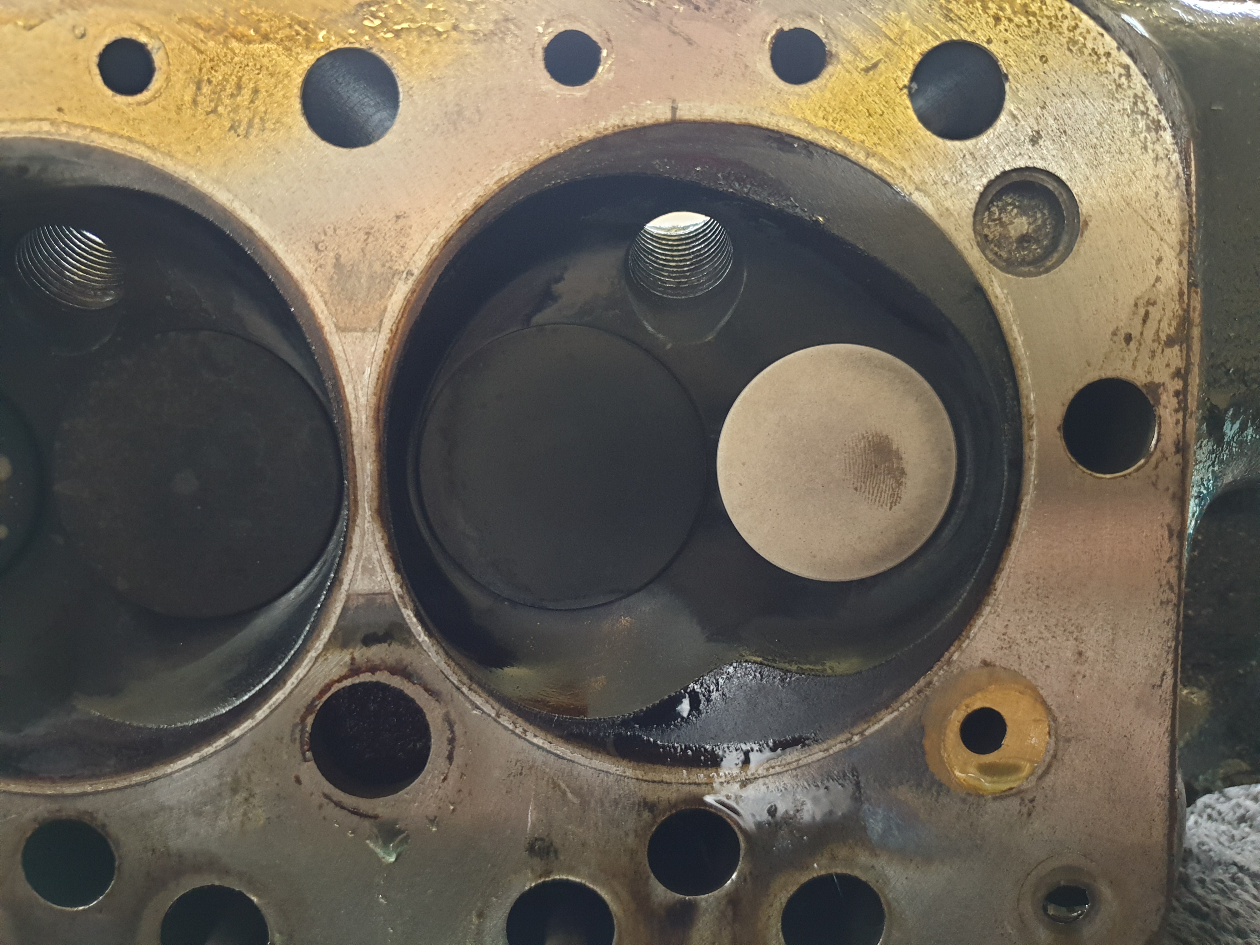

Quick few pics after removing the valve and after a wipe over with solvents.
Steve220
257 Posts
Member #: 11017
Shropshire
On 19th Jun, 2019 robert said:
quickly put the head on its side and full the ports with petrol.,
it weeps out of the exhaust valve
that could be it then, roll ithe stem on the desk to check it not bent, if not touch it back on the seat with some pase and try the petrol test again. also check the valve waggle in the guide.

Stem of valve is straight, no contact marks on the piston crowns either.
Steve220
257 Posts
Member #: 11017
Shropshire
Just lapped the valve in and its still leaking fuel

Check the seat on the valve. Has the paste cleaned it up all round? If not it would suggest the valve is bent.
Likewise the seat in the head. Looks OK in the photos.

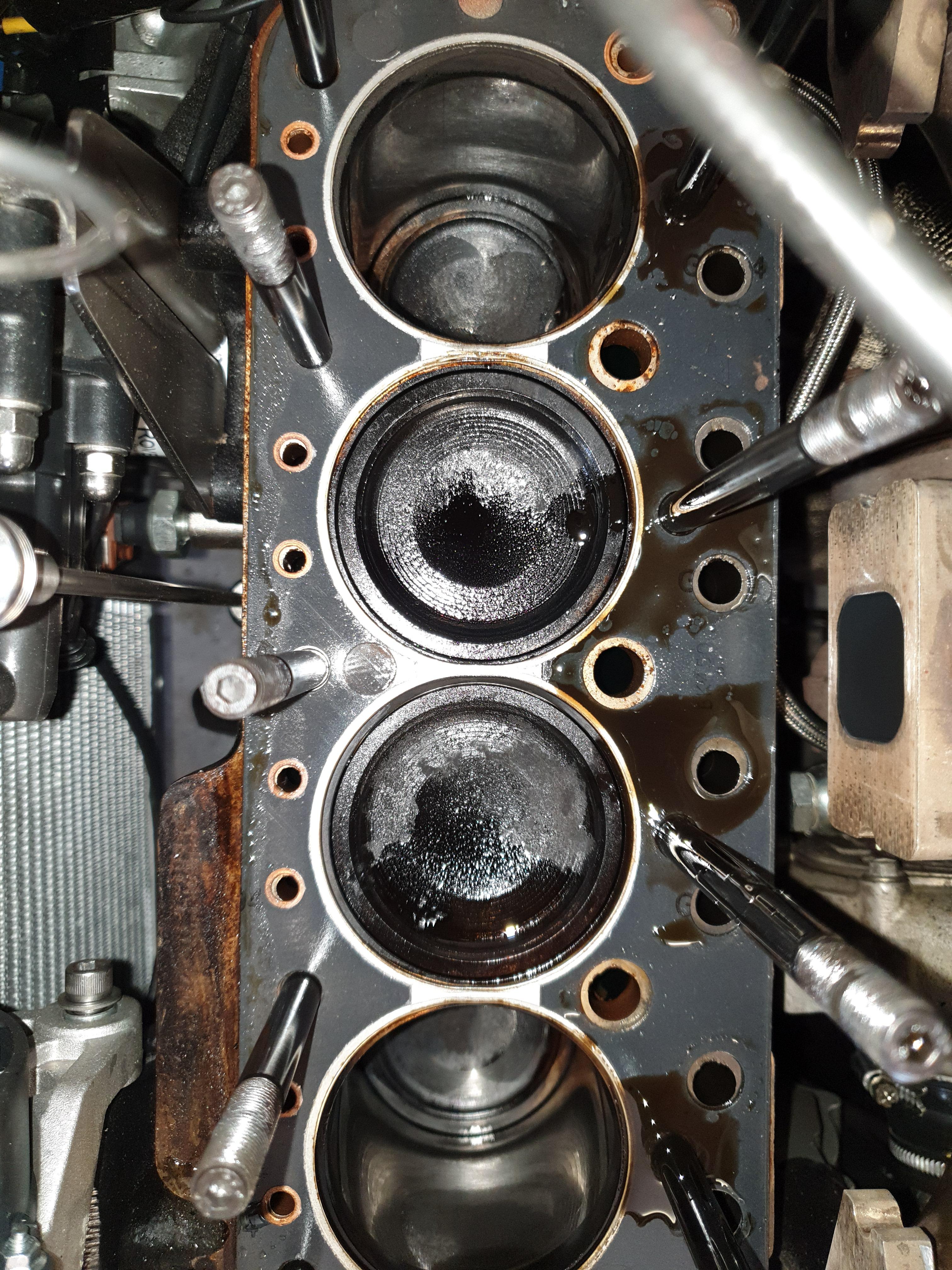

hmm , maybe drain oil , and put all pistons level , and pop an inch of diesel or petrol on them and see if the duff cylinder dissapears faster .
Steve220
257 Posts
Member #: 11017
Shropshire
Not a bad idea! About to pull the engine now.

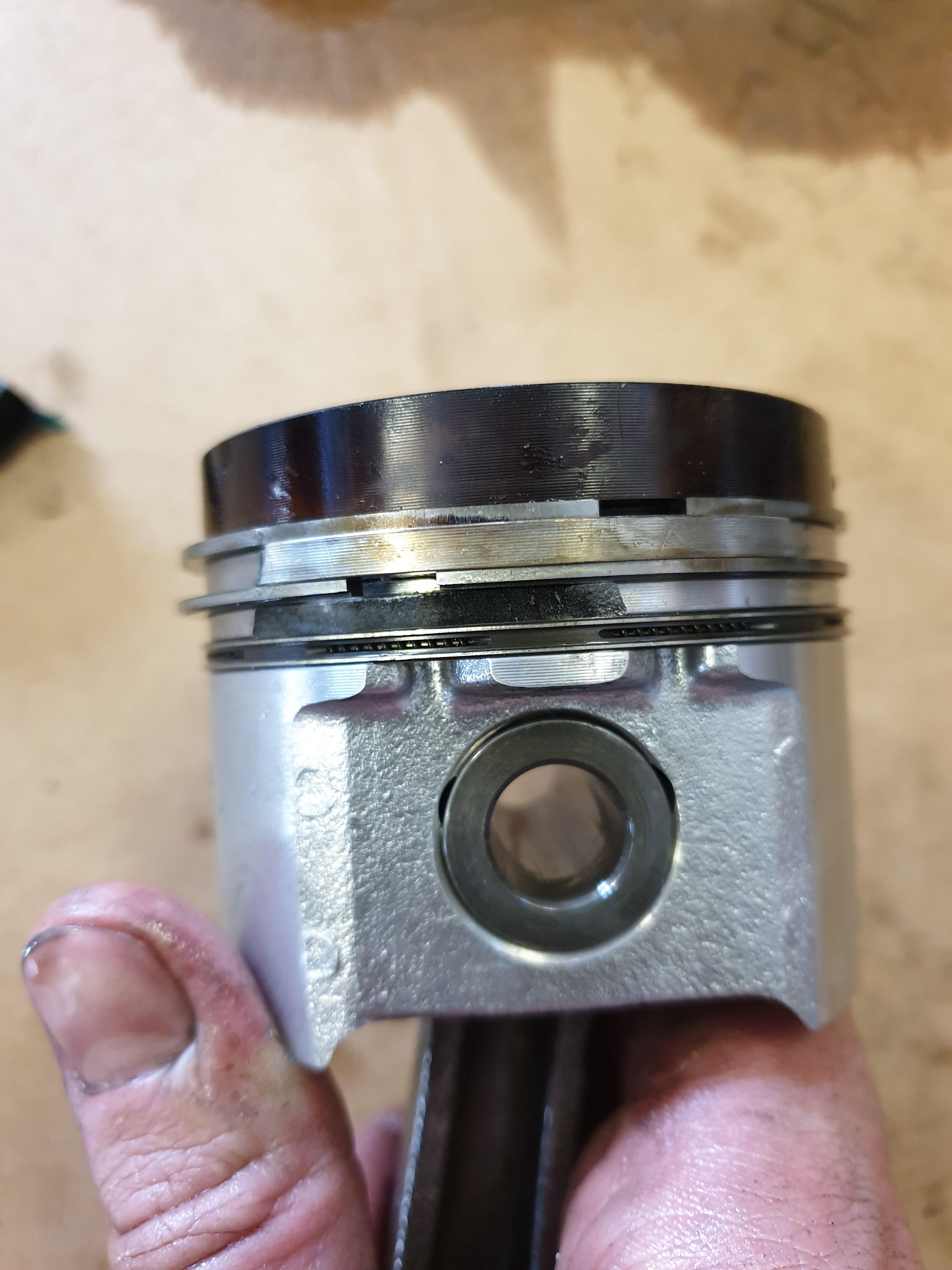

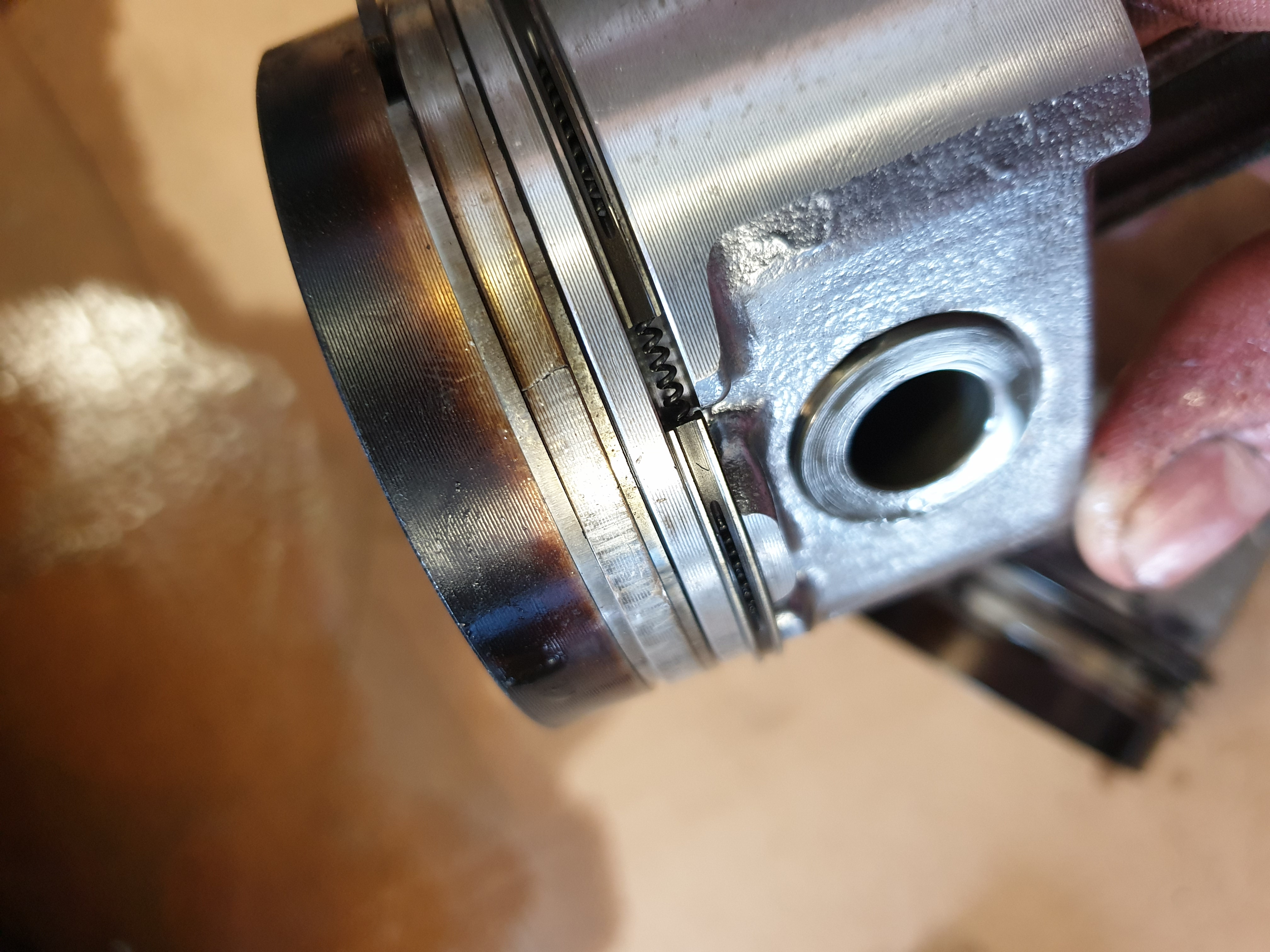

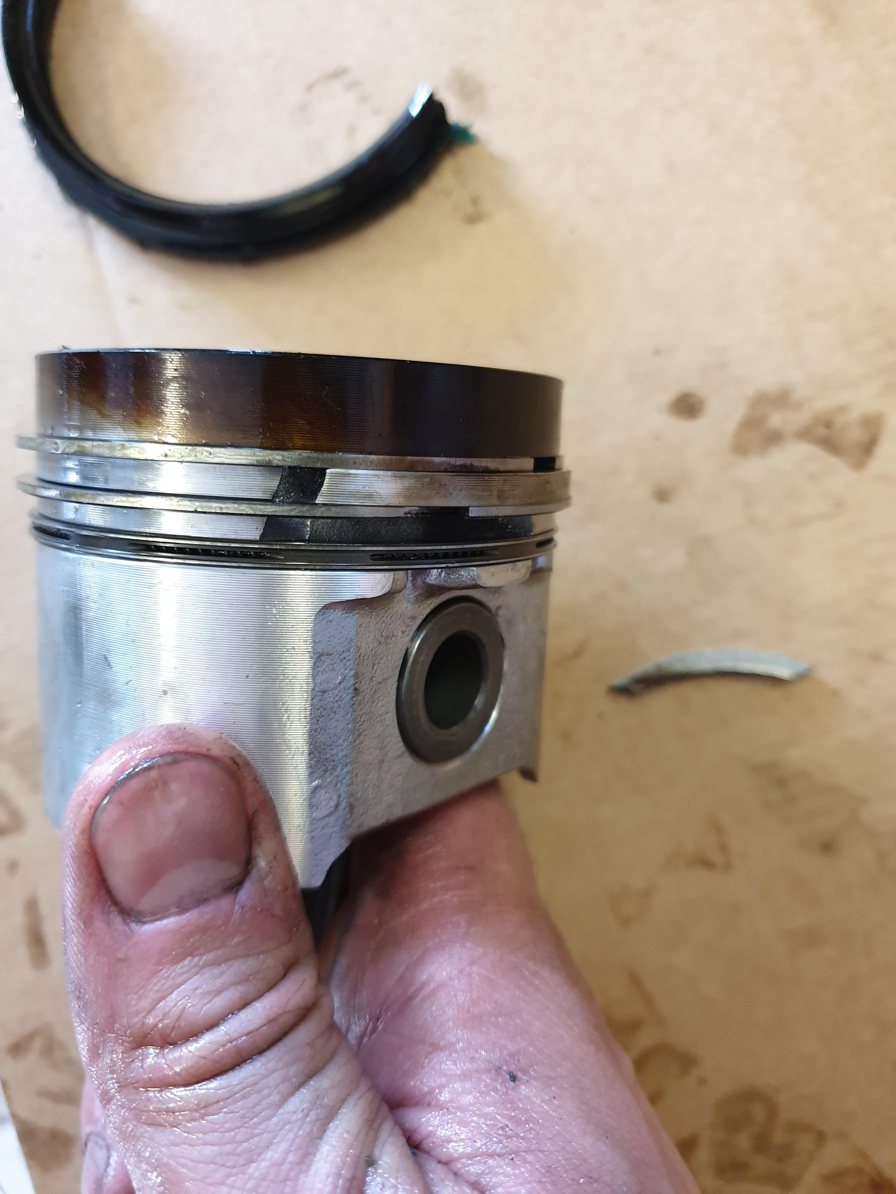

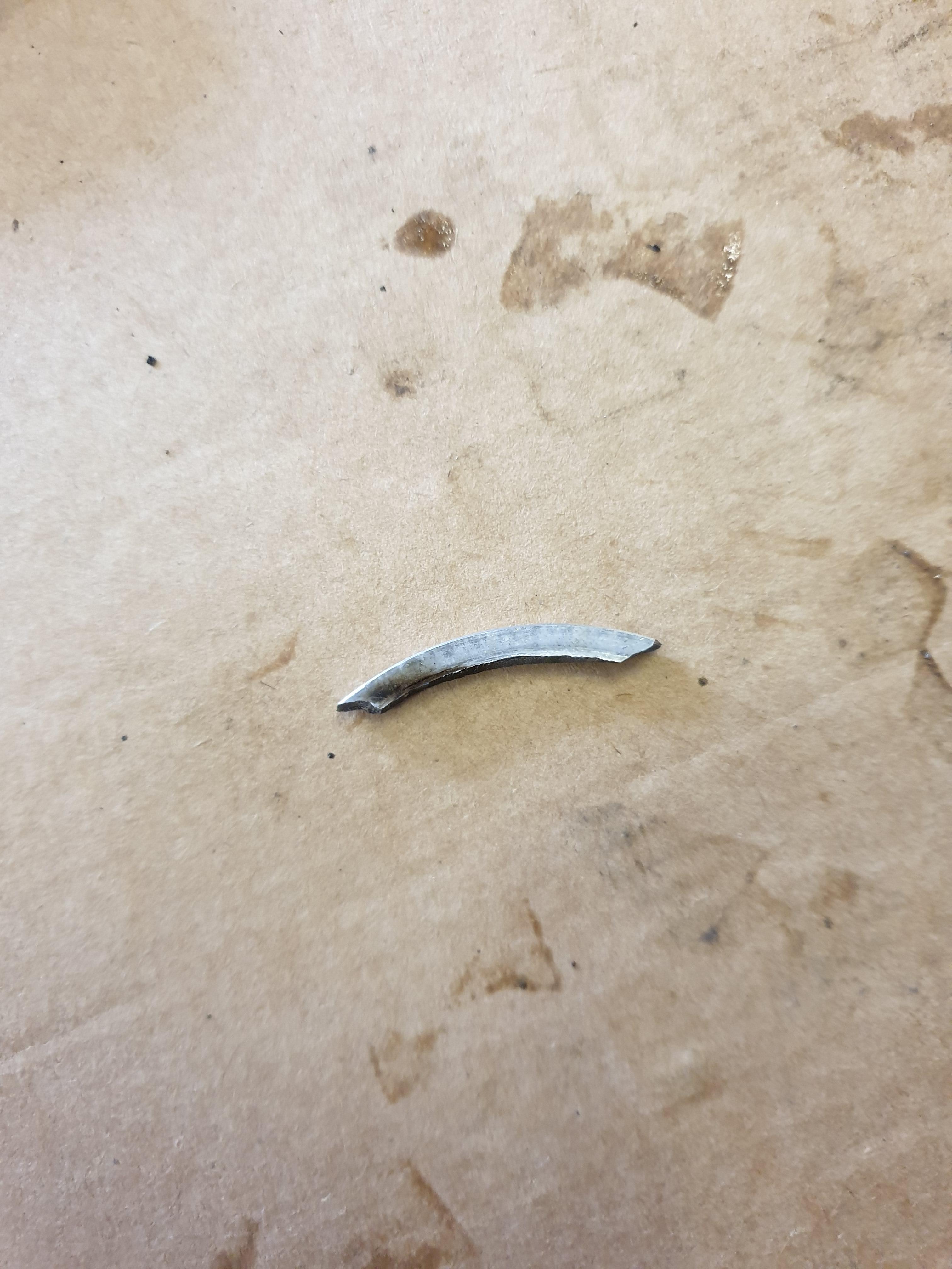

And there we go. Piston 1 & 3 have cracked ringlands
*oh well*
Out of curiosity, what usually blows ringlands?
Ouch!
jonny f
2096 Posts
Member #: 9894
Dorking
That’s a bugger that two have gone. You can sort it though.
What were ring gaps? Perhaps gone tight. I am no expert though!
I'm beginning to think it could be that and running hot!
