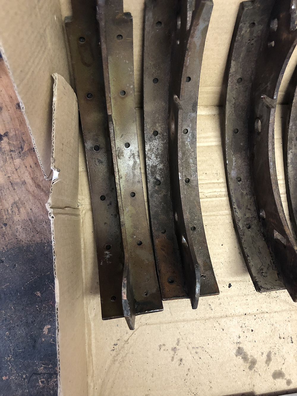

I have replaced the rear shoes. The right rear look much darker in colour than the left and I wonder if they had been contaminated. Plus they must be a good few years old.

Maybe this is the issue. A bent rear shoe
Edited by gr4h4m on 5th Jul, 2019.
Thanks all for the help and motivation, it’s fixed, is was the bent rear shoe.
well done graham , that's an odd one .
Well done finding it. Must have been the shoe grabbing the drum early causing the car to pull from the rear brakes. A run on the MOT brake rollers would have helped narrow that down to a rear problem.

I agree Tom it’s strange that it passed an mot about 4 weeks before. I still don’t know what caused the bend. I will put it down the previous owners as the last mot in 2011 showed a failure on front and rear brakes. I also noticed that on of the shoes had picked what looked like rust. I wanted to run the car for a few miles and then change the braking material using the old stuff to clean up the surfaces.
