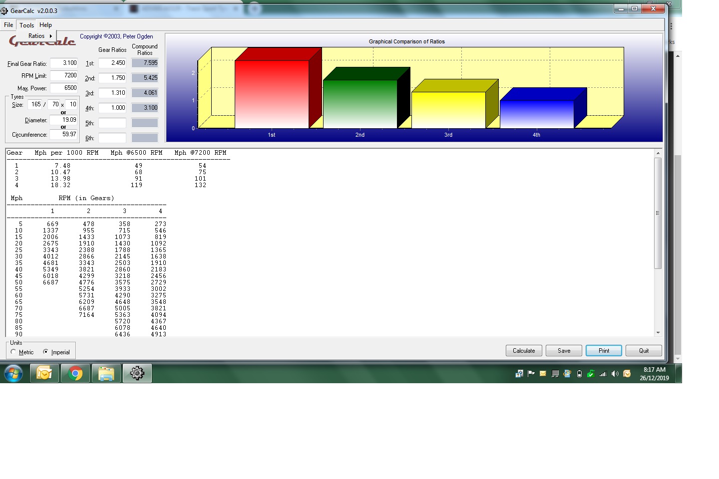

On 20th Dec, 2019 mini93 said:
Useful information. I've seen the guessworks calculator which'll map out revs, gear drop ratios etc and not played around with that too much yet. My last engine used a 3.7 ratio and was topping 110 over Avon rise at Combe. New engine is going to turn over a taller gear much easier.
You'll be at 120 easy with a sorted turbo engine. Mine will do 120 at 7200rpm and sit on the limiter at most tracks. I'll up the rev's if i go racing but that's enough on a trackday for me.

3.1 on a 10" tyres seems to work out much higher johnny ?
jonny f
2096 Posts
Member #: 9894
Dorking
Strange, i must have messed up somewhere! I will check. Perhaps i am using a 3.2.
The speedo is GPS and rev limit is set at 7200 on the ecu. You can hear it nudge the limiter here at 3.18. https://youtu.be/p_Qtj-IR_H4?t=199
