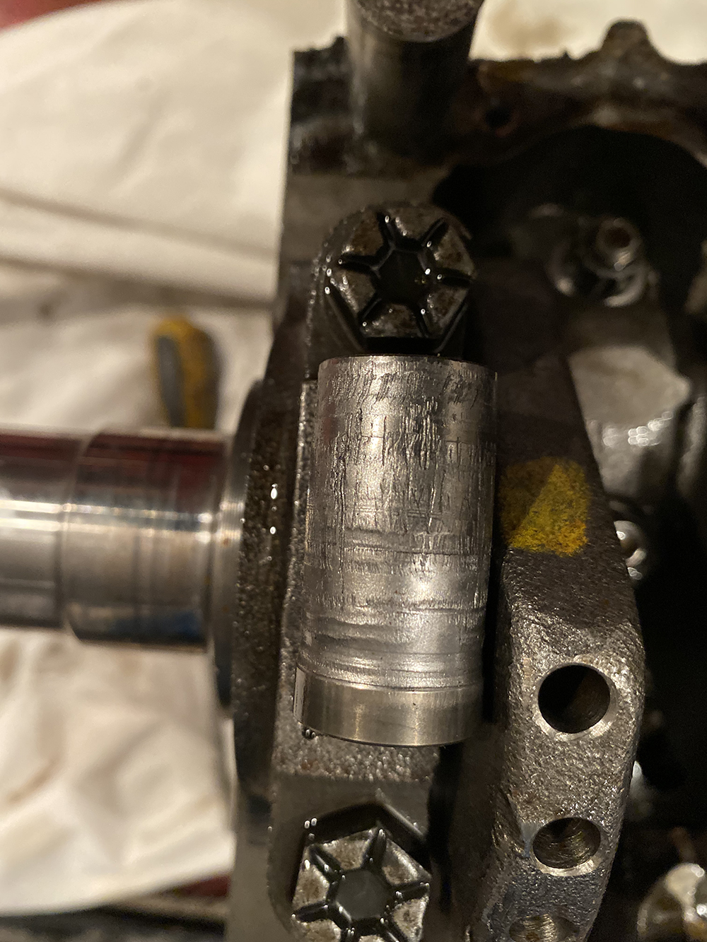

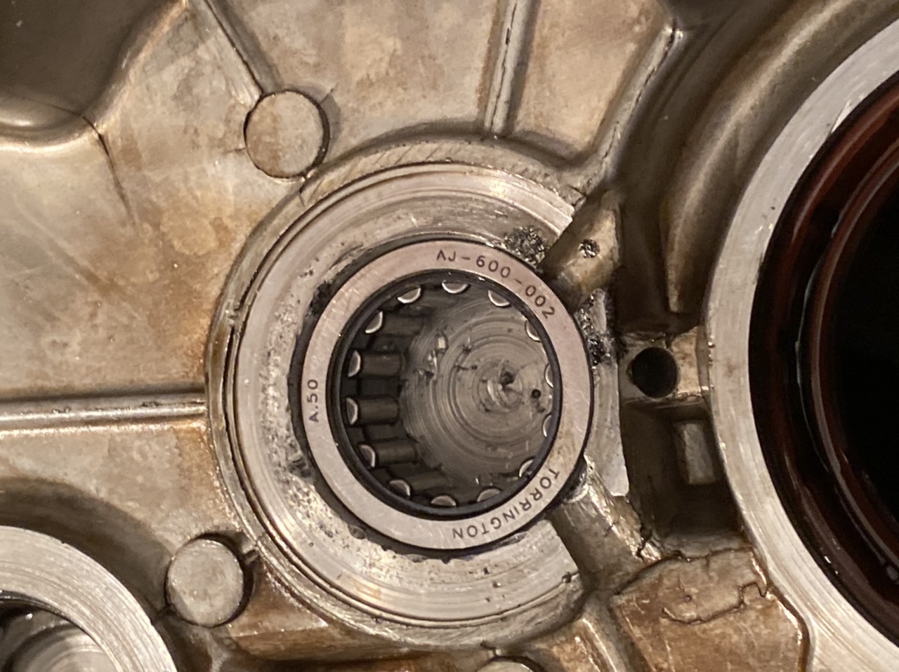

Been doing a bit of stripping this evening of an old spare engine and box I acquired a few years ago to be the unit for my Twin cam build.

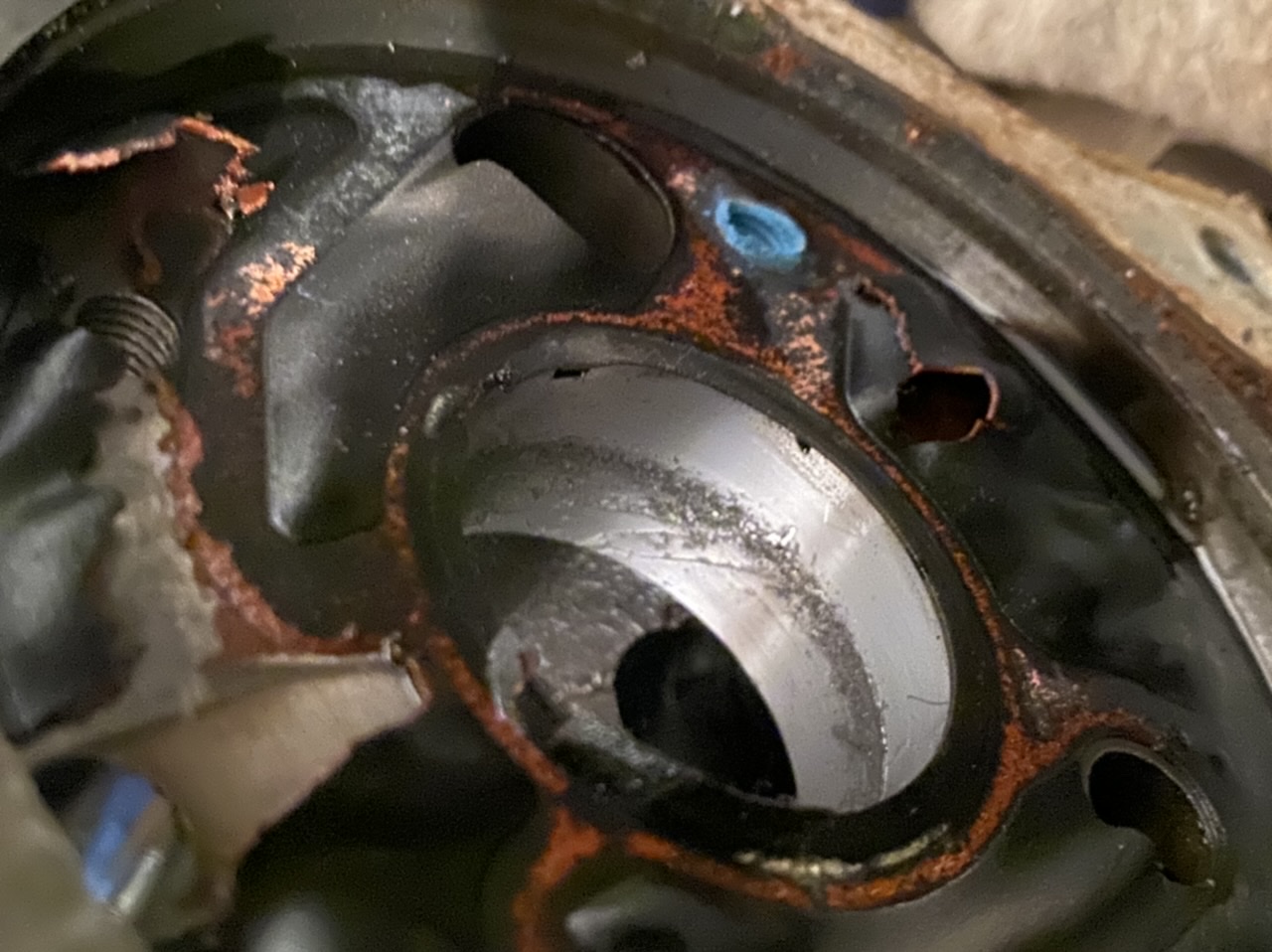

Got the transfer case off tonight and wanted to share this pic of where the idler thrust runs! What causes this? Poor build quality by whoever built it? Would it just be the shimming on the idler?
Will See what other nasties I find tomorrow!

What did the idler thrust look like when you pulled it out?
Shane

Weirdly the thrust didn’t look worn or damaged at all!

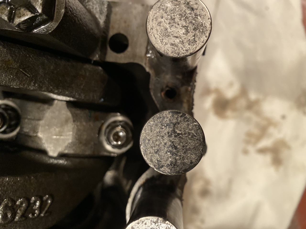

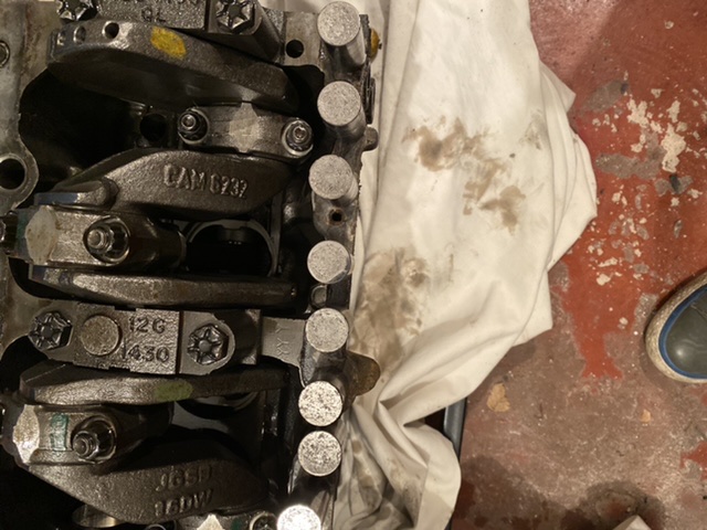

Got the engine off the box this evening. It turns over but is right in a couple of spots. Turns out it had a 286 cam but I think it may also be scrap now.. these were the followers! The pic showing the one on its own was from no 7 and looks like it’s had a rather rough ride!
I’m wondering if it had been starved of oil or if this is a symptom of really really bad build as some one has obviously put it back together in the past! Oil pump is also pitted and worn! I’m also wondering if it could have been starved of oil at some point, the box gasket was on top of the o ring so could possibly have drawn air in at the back there??

it was using roller rockers but they were proper fooked! Probably related to whatever has gone on here. No idea what ratio but they were a yellow/gold colour if I remember right!

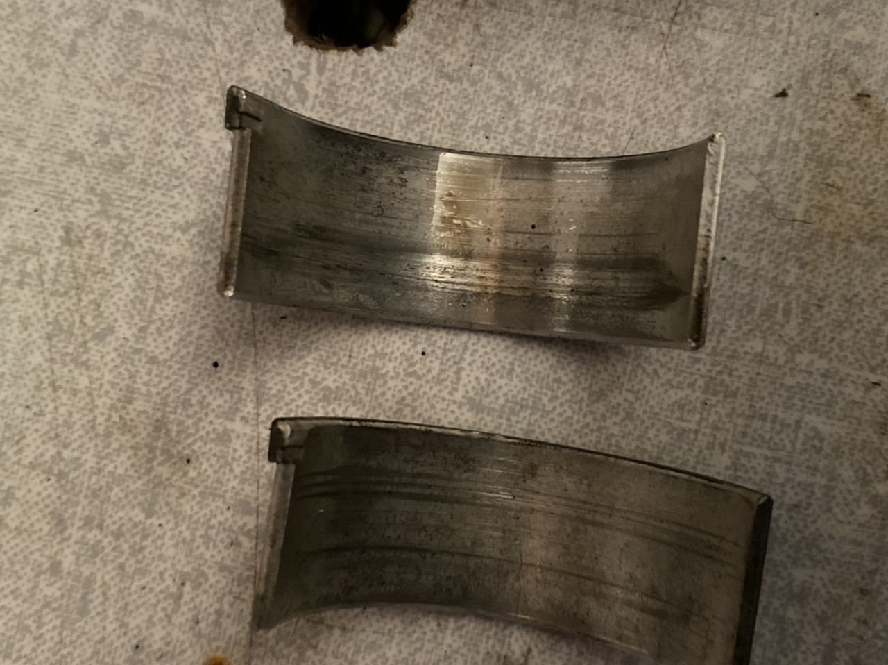

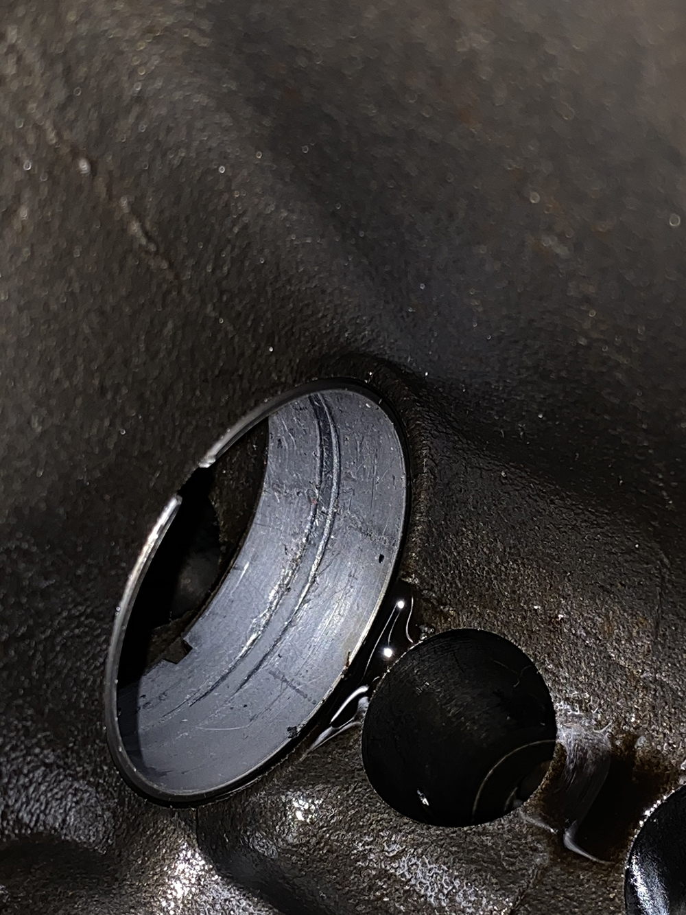

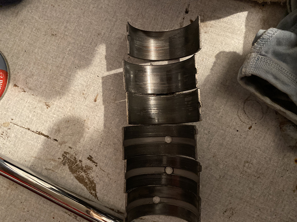

Managed to get the engine stripped completely over the last few days. Every bearing is knackered! What do people think could possibly cause this? Bad build with shit in it or something else? Only asking out if interest really as I didn’t expect it this bad, god knows what it would have run like!
Although the bores look fine with no wear!

My first guesses would be not cleaned/ shit in the oil?
Shane
It is debris that has gone round rather than lack of oil or wear. Something like a worn out diff pin that leads to the diff planet gears breaking up can cause it. By the time the symptoms develop e.g. the car starts snatching round corners and making horrid noises, its too late, all the metal debris has gone through the oil pump and round the system shagging everything as you have found. The joys of the engine and box sharing oil!
Andy500
869 Posts
Member #: 2443
Cheshire
Thanks chaps I haven’t stripped the box or diff yet so will no doubt find things in there too. Does said debris make it through the oil filter then as well?

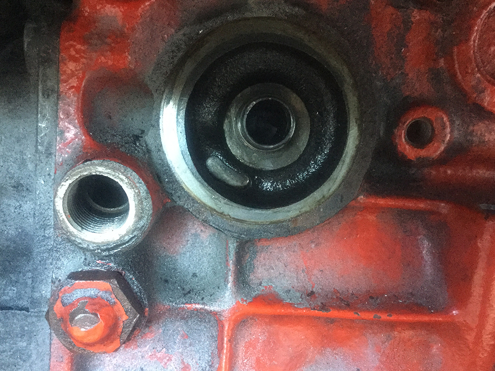

On 10th May, 2020 Andy500 said:
Oh dear sounds bad and considering every bearing is the same I would expect this is the case. It is an mpi block though so not sure if that has the same bypass?
Steve220
257 Posts
Member #: 11017
Shropshire
On 10th May, 2020 shane said:
I think the only "bypass" on the MPI's is the sprung oil pressure relief. Im not 100% of how the oil ways differ on these blocks to the A+.
Shane

Doesn't the MPI filter have a bypass valve in it?
shane
2646 Posts
Member #: 1246
Lowestoft, Suffolk.
Not under the filter itself that I’ve ever seen.
I’m headed out tot that garage shortly, I’ve an MPI block spare I used for my Twink mock up, will Post a pic.
Shane

There is nothing on the block, I have one here now. Will take a look in a filter, think I have one he re somewhere

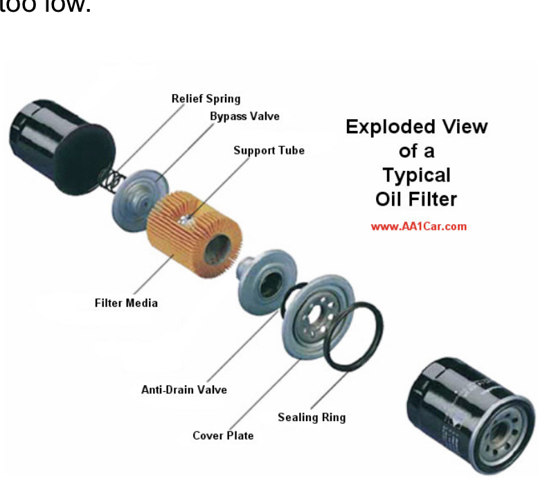

On 11th May, 2020 Andy500 said:
So the filter does have a bypass, apparently all good filters do and it’s not uncommon for the bypass to be operating on cold start up and obvs if the filters clogged....well every days a school day!
Andy500
869 Posts
Member #: 2443
Cheshire
Yep, I suppose it’s one of those things you wouldn’t normally cut in arf to take a look!
Andy500
869 Posts
Member #: 2443
Cheshire
Think it’s the same as this!
My comment was intended to express that the filter has a bypass valve in it. But looks like you've found that out. Interesting stuff.
