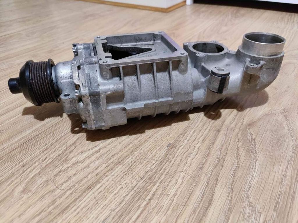

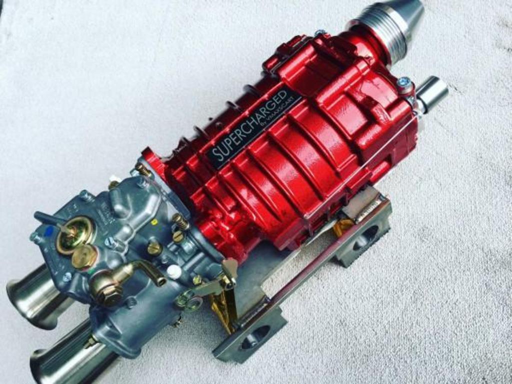

I have been advised by Stuart to get an M62 as opposed to an M45, however looking at M62's I can't see that it has a removeable flange?
Attached is a pic of an M62 and one of Stuart's DCOE setups to compare.
Speed is just a question of money, so, how fast do ya wanna go?
shane
2646 Posts
Member #: 1246
Lowestoft, Suffolk.
you can see on the second picture where the flange has been welded on.
Shane

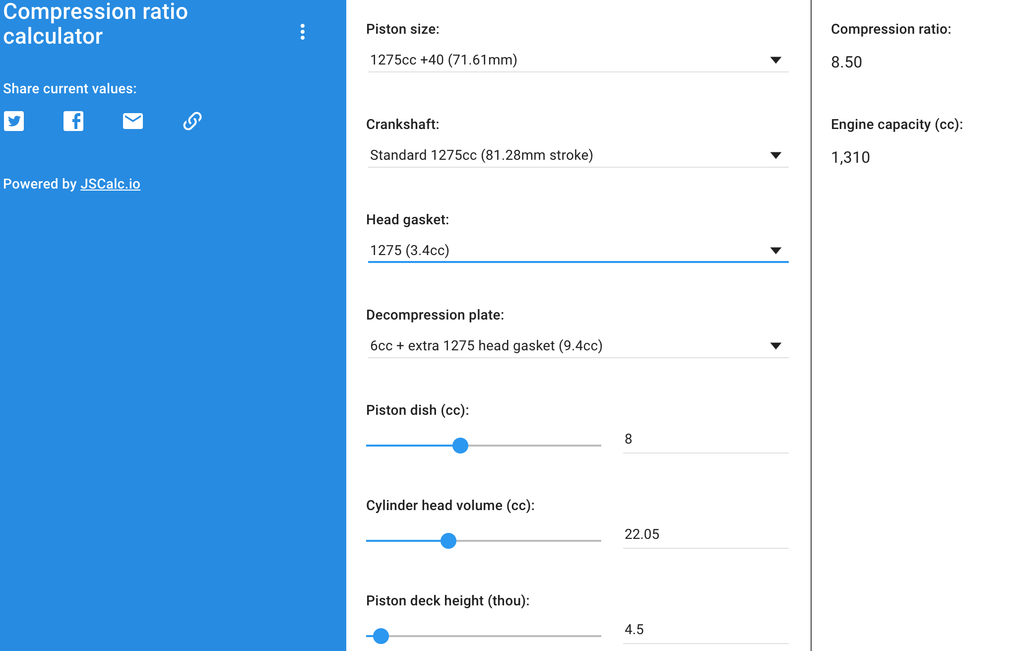

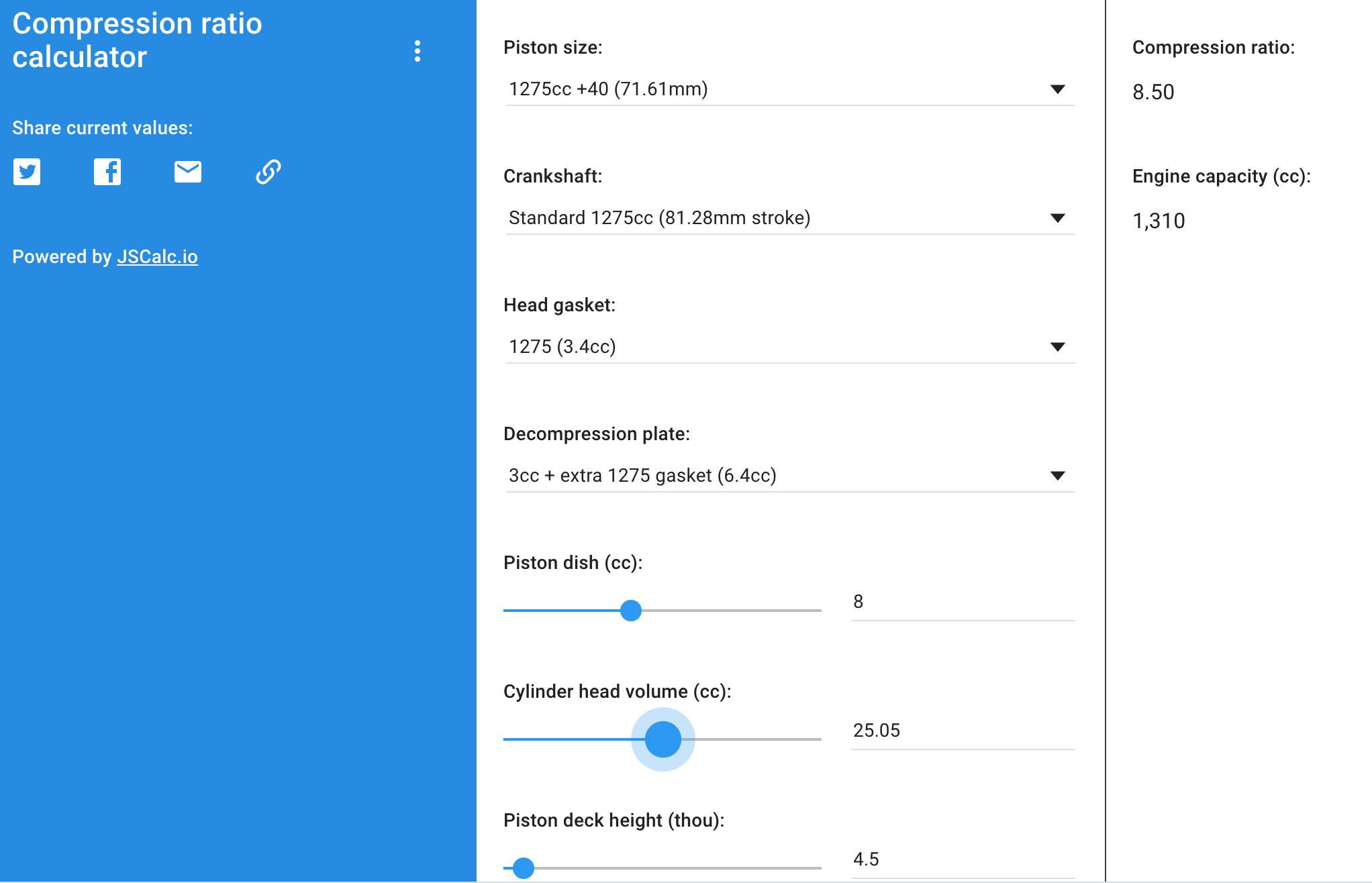

OK so here's what I have found out so far.
The SC I need is an Eaton M65 not a 62 (pic attached) the one I referred earlier in the thread.
This will need the end chopped off, new bearings and a flange welded on - which come in the DIY kit from Xmaxscart
I believe I will also have to modify the chain case by removing the breather as it will foul the multi vee belt.
Chamber size and decompression plate to to matched to achieve a CR of 8.5:1 allowing me to run 10PSI boost. With a 3cc decompression plate, I need 22.5cc in the head, with a 6cc decompression plate, I need 22.05cc in the head - all very doable. Screenshots attached.

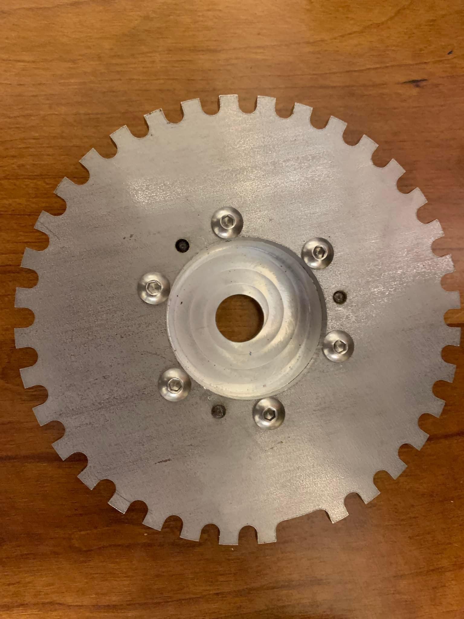

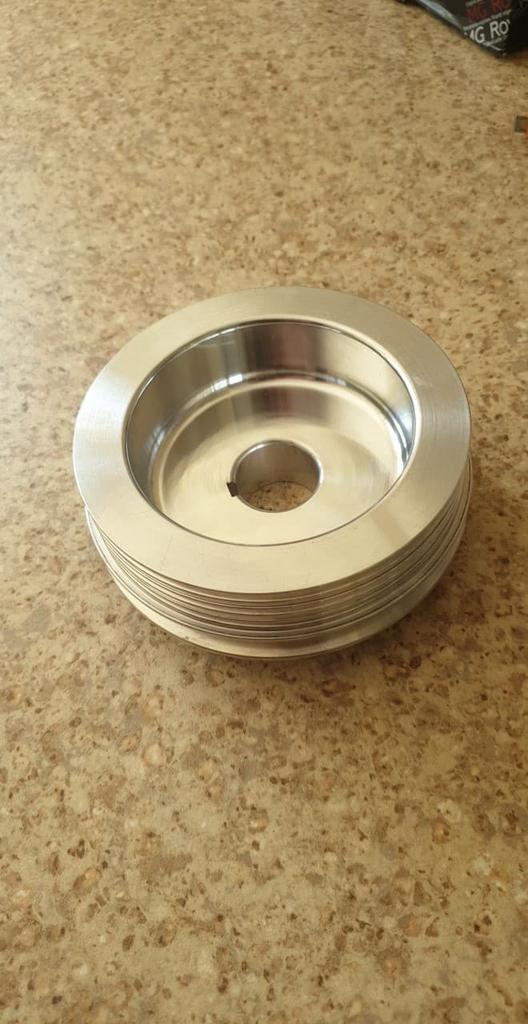

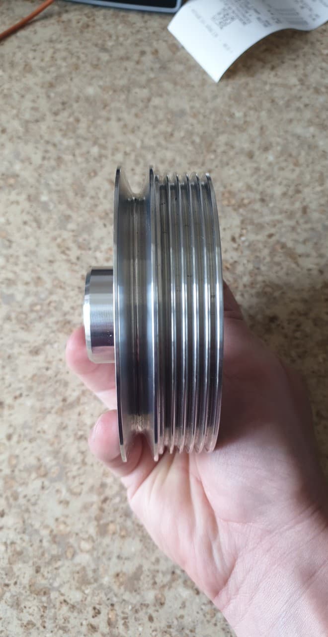

So,
I have now managed to find a Twin Belt Pulley.
https://i.imgur.com/1DR0cwF.jpg
So what I need to do now (well when it turns up) is mount the trigger wheel on it.
Here is the Trigger Wheel, its a Trigger Wheels A Series Wheel, but I need to modify it to fit on the inside of the Crank Pulley otherwise it will foul on the Radiator mount.
https://i.imgur.com/1vrYm2a.jpg
Here is a pic from a guy that advised this.
https://i.imgur.com/l9cejhB.jpg

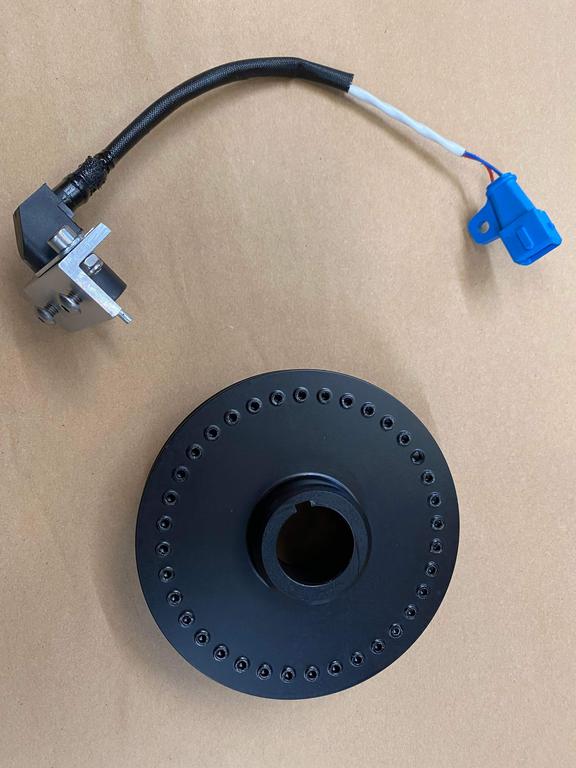

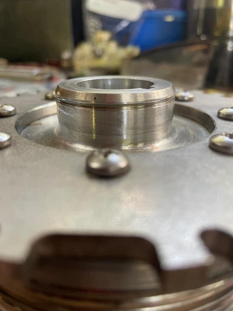

Long time since I've updated on here, lots of posts on FB and in The Mini Forums though.

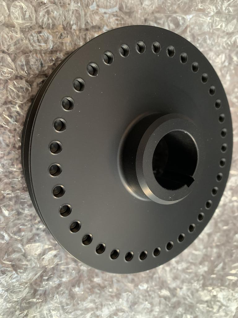

So after spending a great deal pf time sorting out and fitting the trigger wheel to the Twin Belt pulley I acquired, it turned out its was faulty.
I now have a replacement, however this one is a little different, as instead of fitting a Trigger Wheel to it, it comes with 36 drilled and tapped 5mm holes in the back side around its circumference. When 35 5mm x 5mm grub screws are inserted this makes up the trigger wheel.
https://i.imgur.com/G9dLVDc.jpg
The pulley is made by Stuart Gurr of Vmaxscart and is designed to use the stock MPI Crank Sensor, however instead of mounting to read the flywheel, it is mounted on the timing case and sits behind the Crank Pulley.
https://i.imgur.com/Myl97kB.jpg

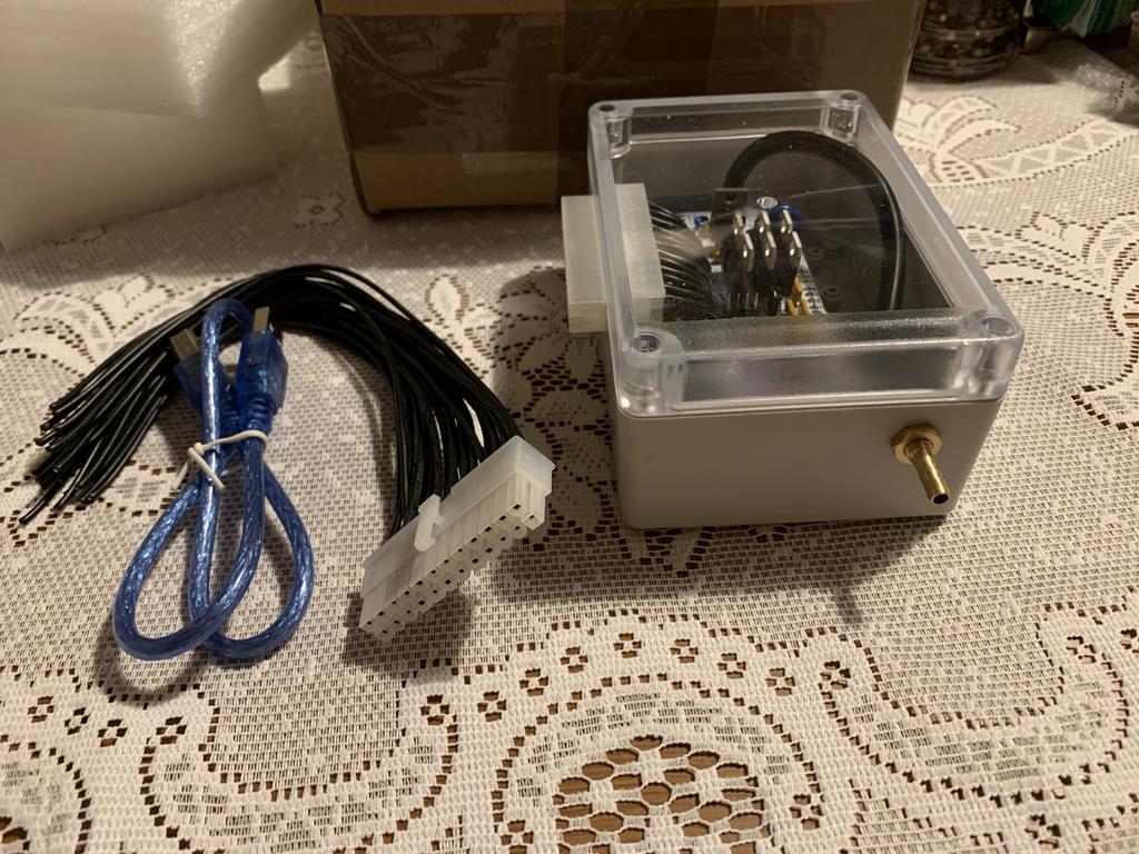

Iv'e also now received my ECU, it's a Speeduino.
https://i.imgur.com/QvD9gsj.jpg
Edited by JonnyAlpha on 30th Dec, 2022.

Yo-Han
976 Posts
Member #: 3228
North of the Netherlands
Interesting pulley, never seen one like that before
Dazed and Confused....
shane
2646 Posts
Member #: 1246
Lowestoft, Suffolk.
Does this pulley have a damper?
Shane

I'll be amazed if that gives the ECU a square wave.
stevieturbo
3597 Posts
Member #: 655
Northern Ireland
If you use a 2 wire VR sensor, none ever will.
If you use a 3 wire hall sensor, of course it will.
Edited by stevieturbo on 26th Dec, 2022.
Hes using a 2 pin VR MPi one.
stevieturbo
3597 Posts
Member #: 655
Northern Ireland
Then such a sensor will not give a square wave. I didn't see him mention anywhere what sensor he is using. Very easy to change though
Shane
This has been the subject of great debate, the Twin Belt aluminium pulleys don't have dampers and no one seems to have experienced cracked cranks as a result of using them. Stuart has suggested that the opposing forces of the twin belts help resolve the harmonics, also modern lighter Flywheels etc limit the impact.
Correct the MPI (or any VR senors) emit a sine wave. The ECU can be (and mine is) fitted with a VR Conditioner that converts the Sine Wave into the required Square wave:
https://wiki.speeduino.com/en/boards/VR_conditioner

For Wasted Spark Ignition (which I will be using from the outset), I only need the following senosr connected to the ECU:
1. Manifold Absolute Pressure
2. Crank Position Sensor
I'll be starting out with a HIF44 modified for a newly built engine (Yellow Spring and BDL Needle IIRC), I'll then (once its been setup with the correct jetting), be switching to a Weber DCOE 45 (why - because I want to).
For both these I need to take a tube from the manifold to the ECU MAP sensor. rather than drilling into the manifold, tapping and screwing in a pipe outlet, for the HIF at least, I wondered if I could just add a Vac Take Off Spacer, like one of these:

stevieturbo
3597 Posts
Member #: 655
Northern Ireland
Or just use a correct sensor from the outset.
