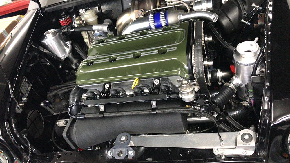

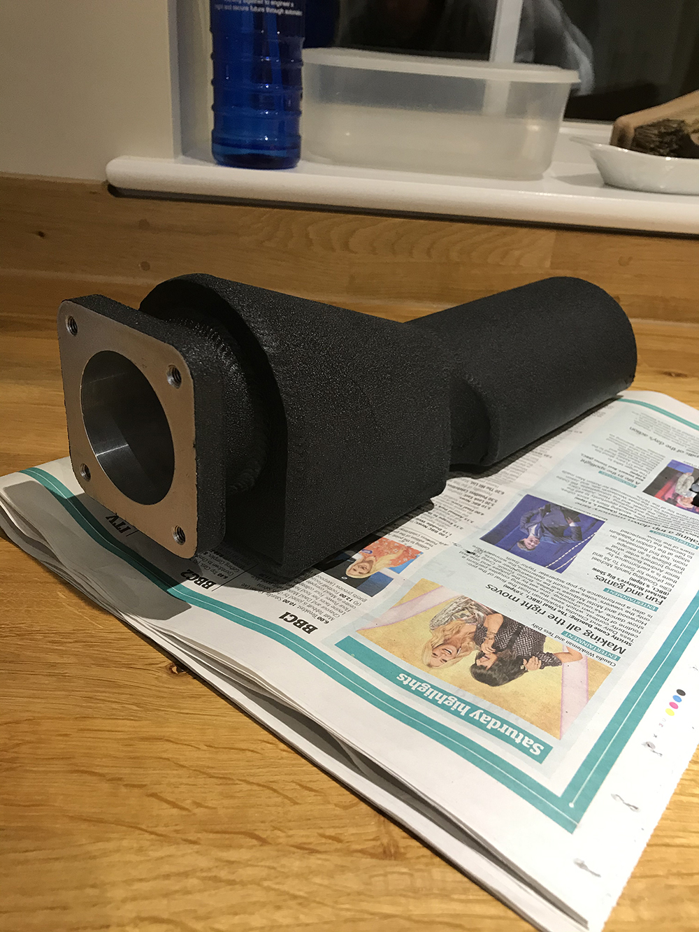

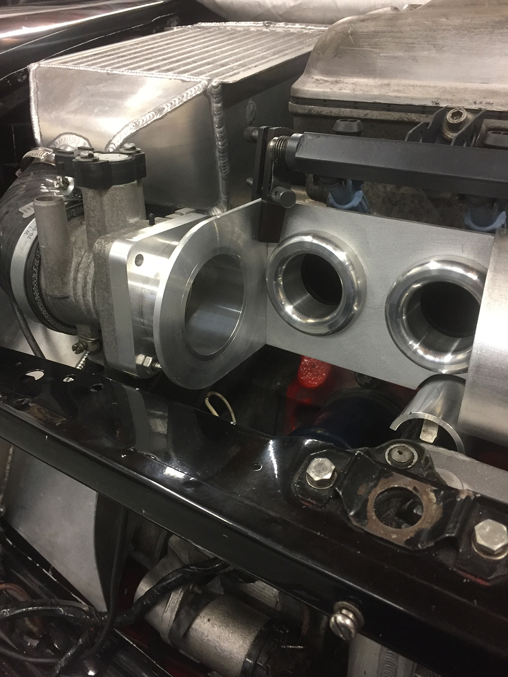

For my K build I originally had a Semi circular log type plenum with the throttle body at one end, I sent the Car to Clare and Bob at Concept racing for an intercooler to be fabricated and the feedback from Bob was the design was poor and advised that the shape should be tapered to promote flow to the furthest cylinders from the throttle body.
I think volume ended up a tad over 1.3x engine volume.
First image is the abortion I made for my K100 build as described above, the other pictures are for the revised plenum for my 16v build with radii on the inlet runners and tapered for improved flow.
Im not sure how the space constraints compare between 16v BMW heads and 7 ports but my engine bay is a tad snug.

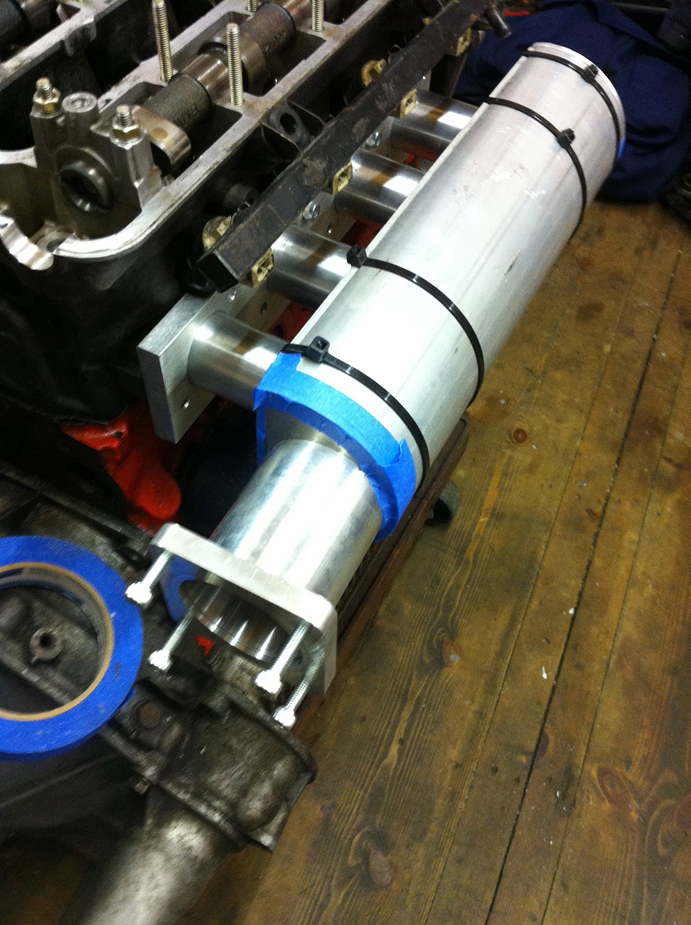

I think it will be blowing in from one end, no space on top and next to no space underneath. Single throttle body.
Mine is single TB and in from one end.
It's tall and slim and I fabricated an internal splitter so the TB was split 50:50 between each end.
I did post a lot of photos on here how I did it but when Photobucket commited comercial suicide they all didappeared.

when I built mine I used a flat alloy plate with the 4 holes in for the trumpets to hold the plenum chamber onto the throttle bodies then I welded the sides on with the blown air on one side and the blow off valve on the other side then bolted the back plate onto the box with a gasket
