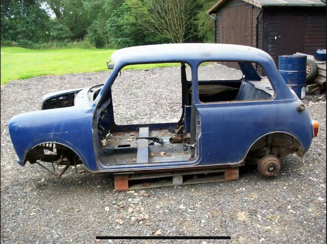

I found a de-seamed mini locally, it looked cheap and came with a complete rear subframe. Something which I already knew was getting expensive. I bid on it, won it, and grabbed my father-in-laws flatbed to pick it up.
Now some of you might be like... oh god! Deseamed! EW!
And yeah... I get it... So don't worry! I've got a roof cut to go on it, but I'm keeping the sides de-seamed as I kinda like it. That whole 'different' thing I was on about.
So I got it home, had a load of fun unloading it into the garage.
And there it stayed for a few weeks whilst I sorted my life out.

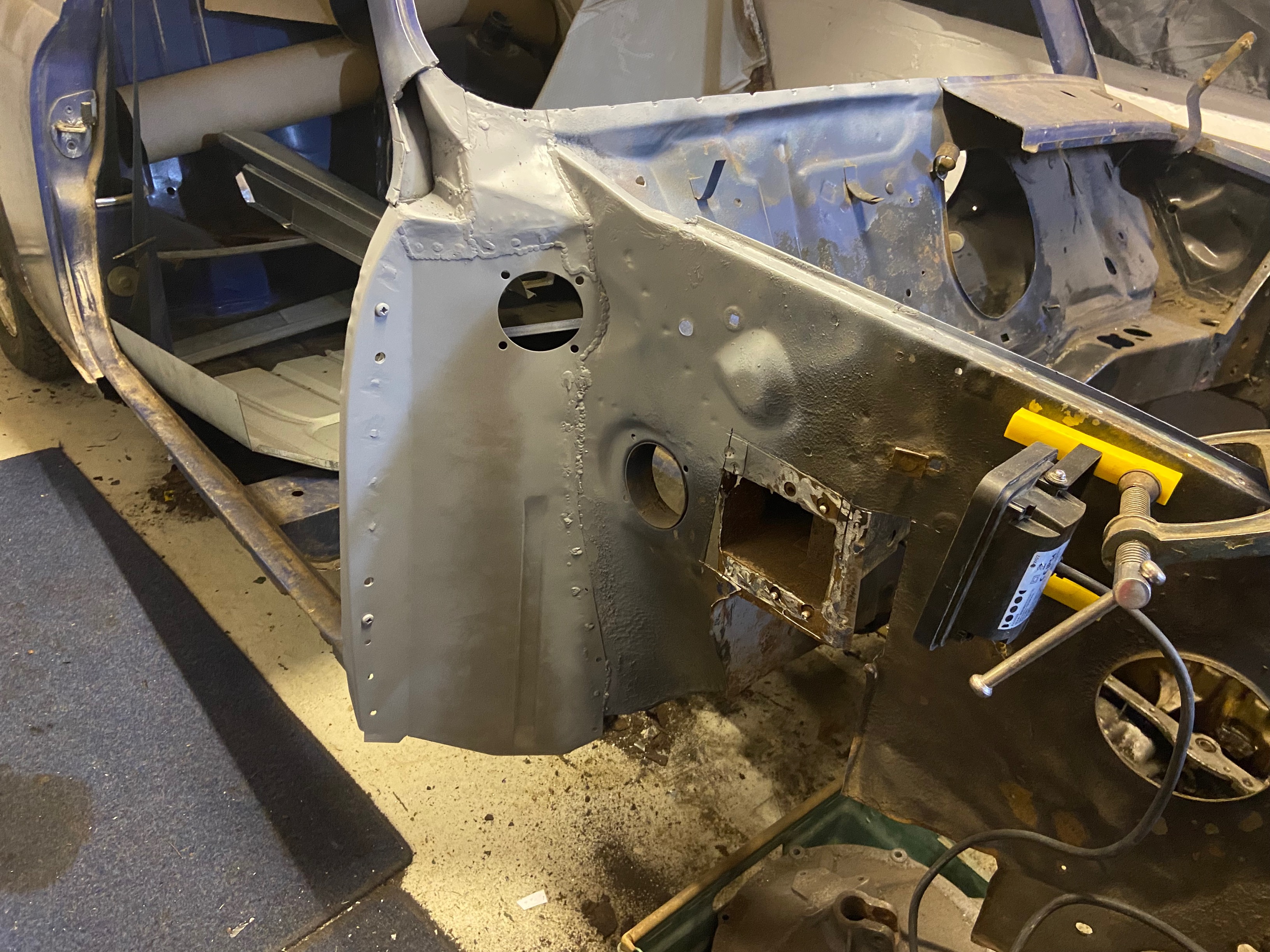

Then I got to work stripping it down. Removed the subframe and stored it. Removed the seat belts and a few errant brackets. Fuel tank, etc.

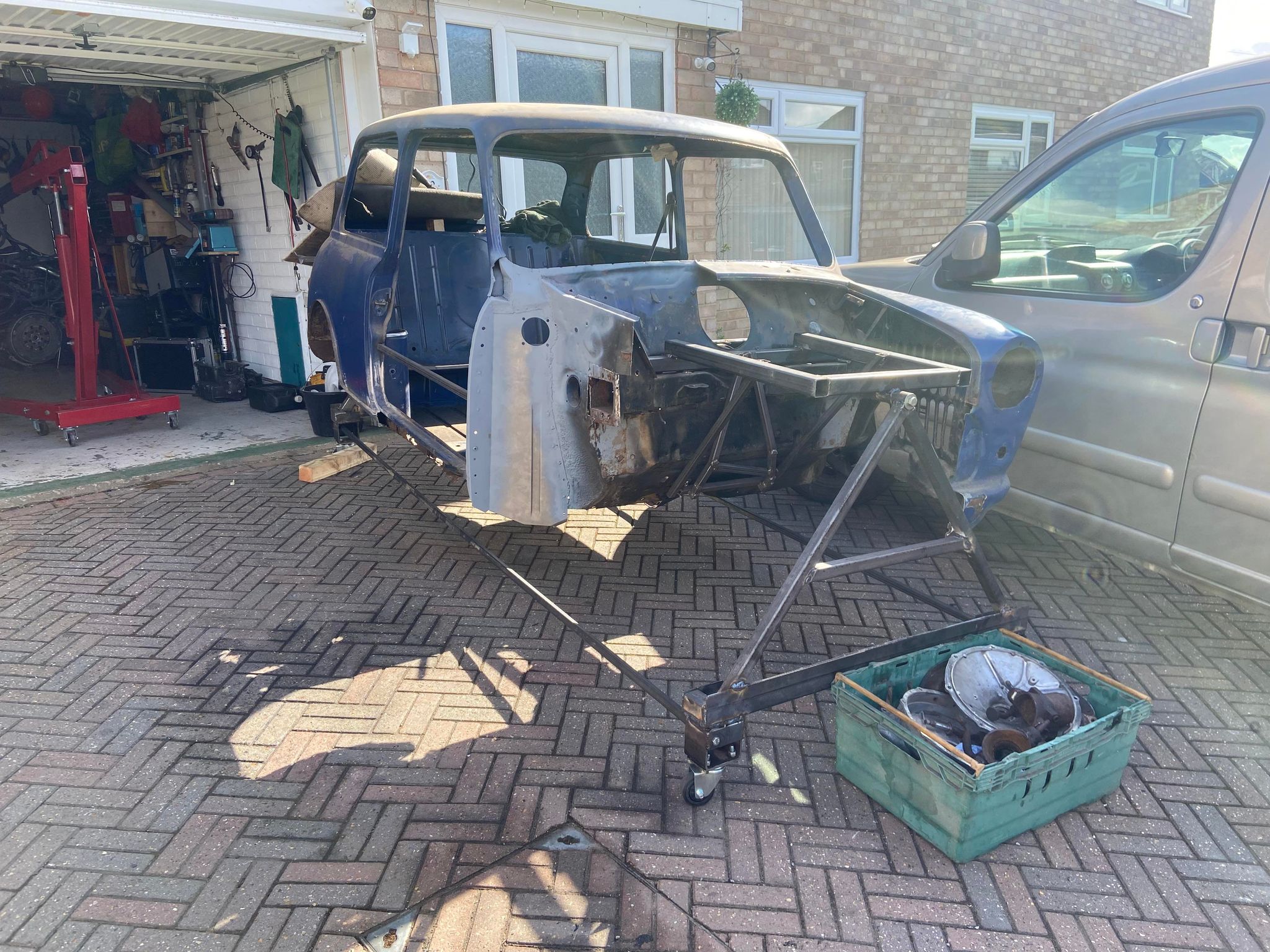

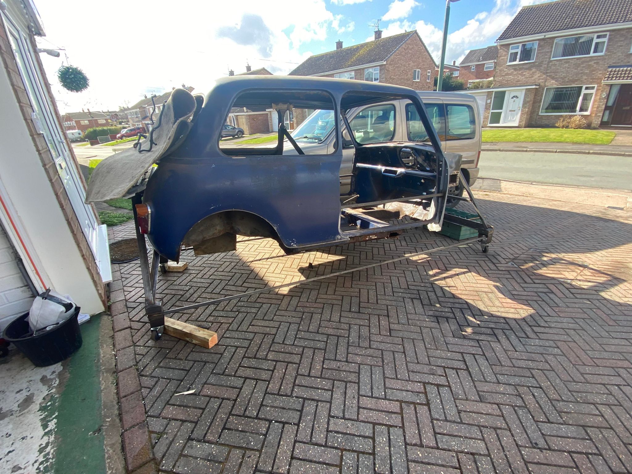

I went out one weekend, and tore in at the front right wings... I just couldn't stand the rust 'looking at me' ordered some new panels from minisport and started fitting things. Looking back now I should have gone in with more of a plan.
The welds aren't my best but I was getting used to a new machine. Also it became quite obvious that I needed a roll over jig.

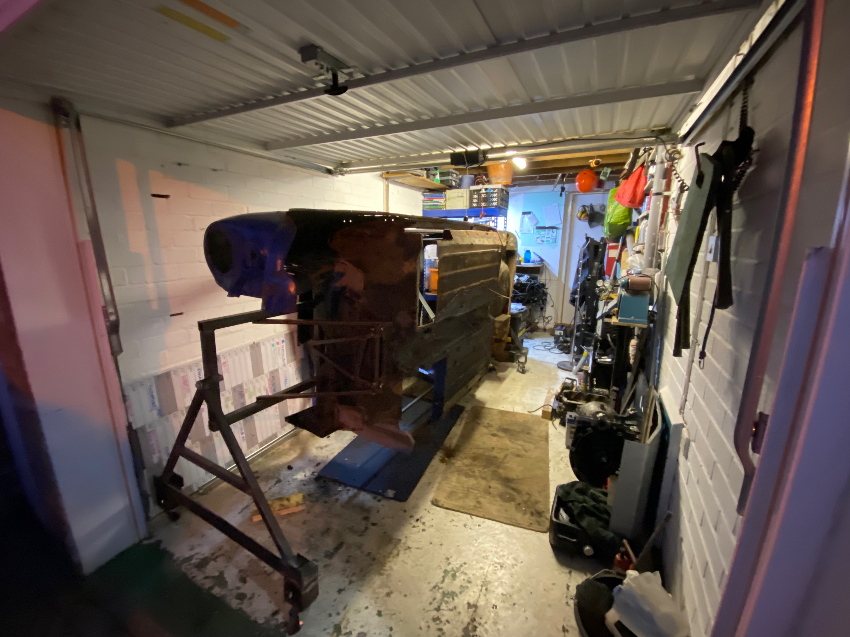

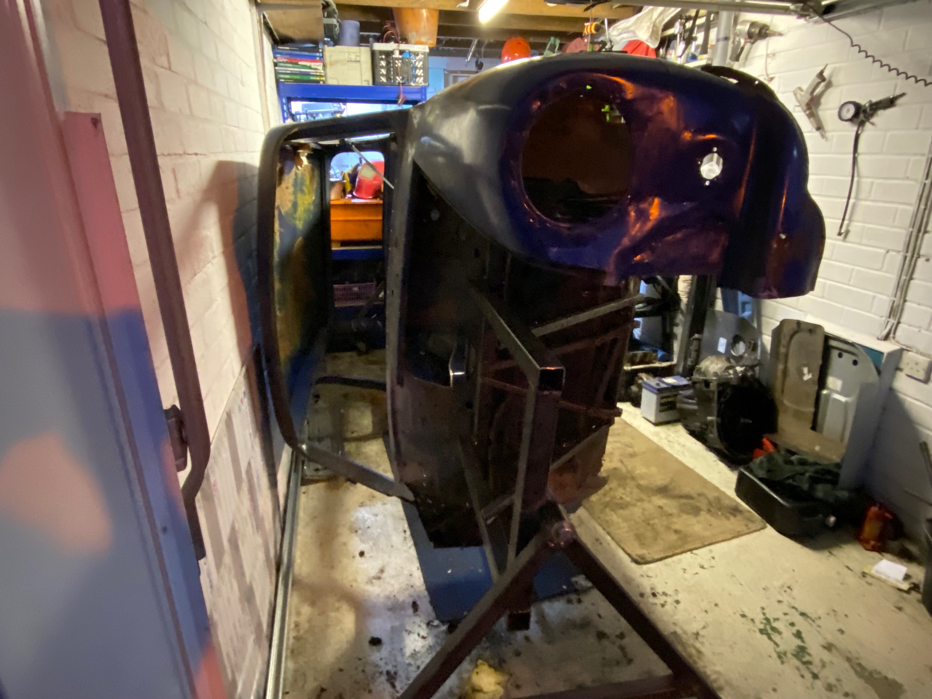

I measured the garage, and not one of the plethora available online would fit. So I decided to make my own. It became quite a project! But I'm pleased with the result.
fits really well in the garage, and you can roll it over 90 degrees both sides, and lock it in place. It wheels around for easy access, and I have 4 inches of room at each end when the door is closed!

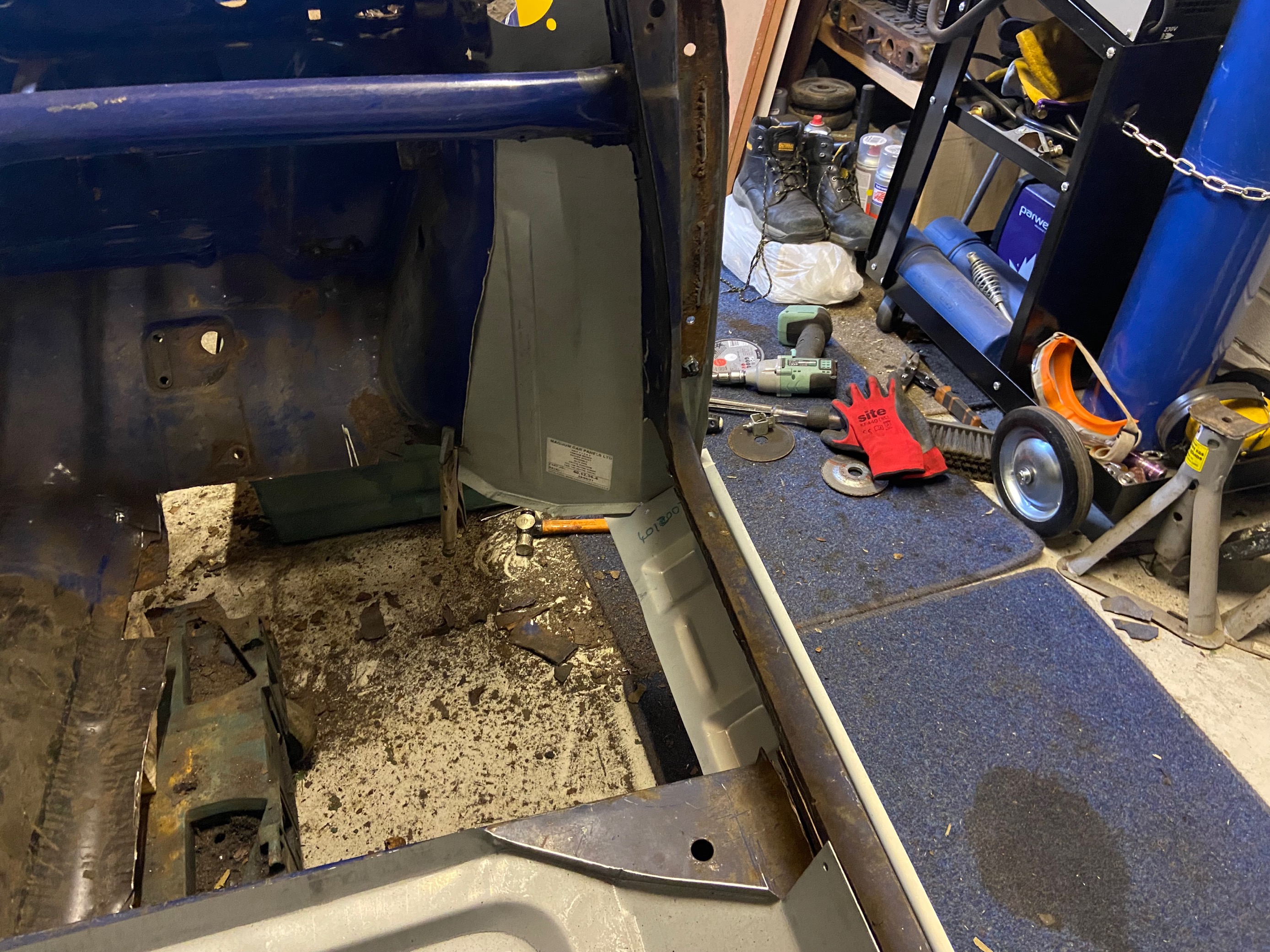

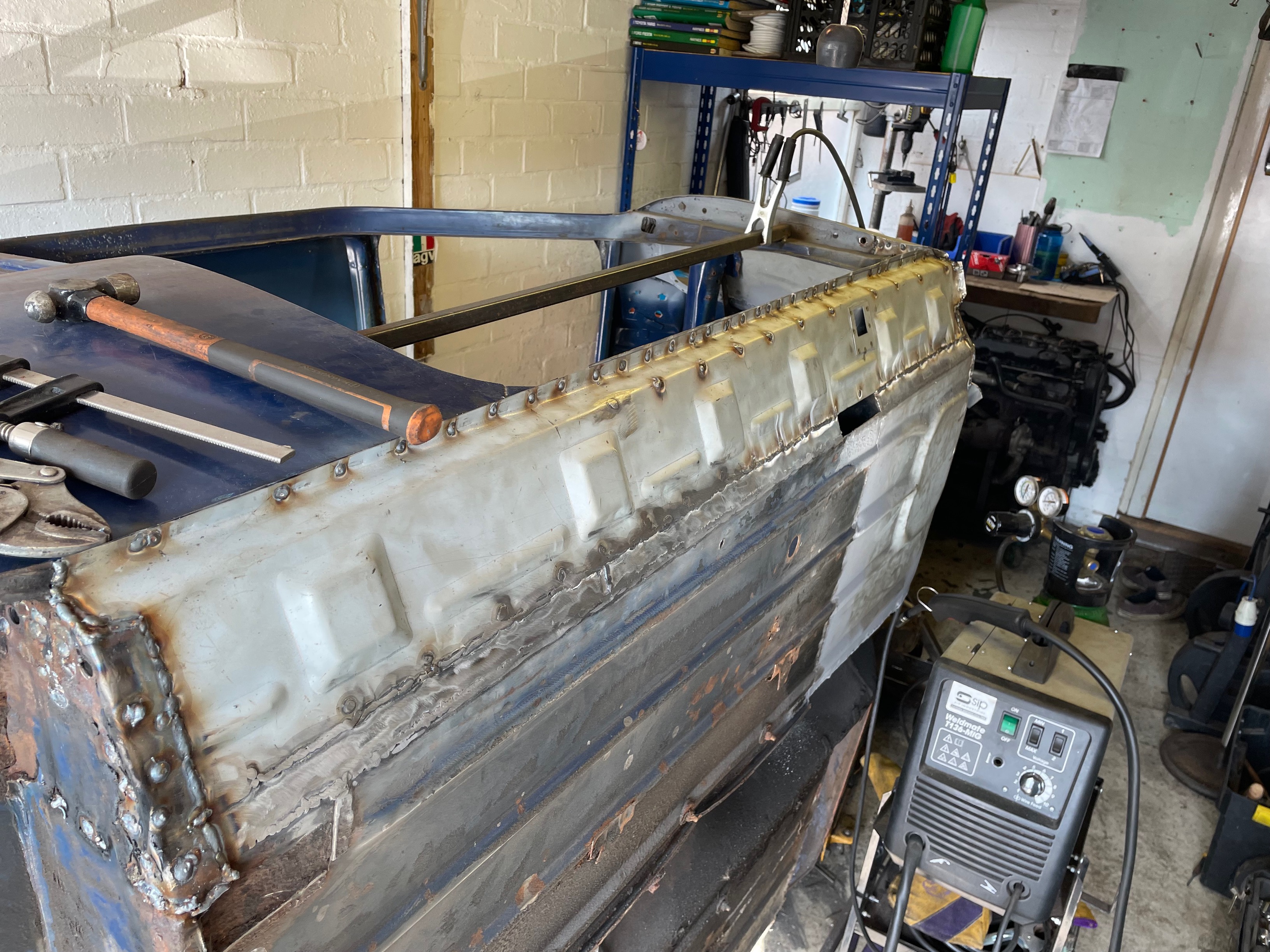

I was also able to get some well needed practice in with the MIG which paid dividends when I was ready to start attacking the shell again.

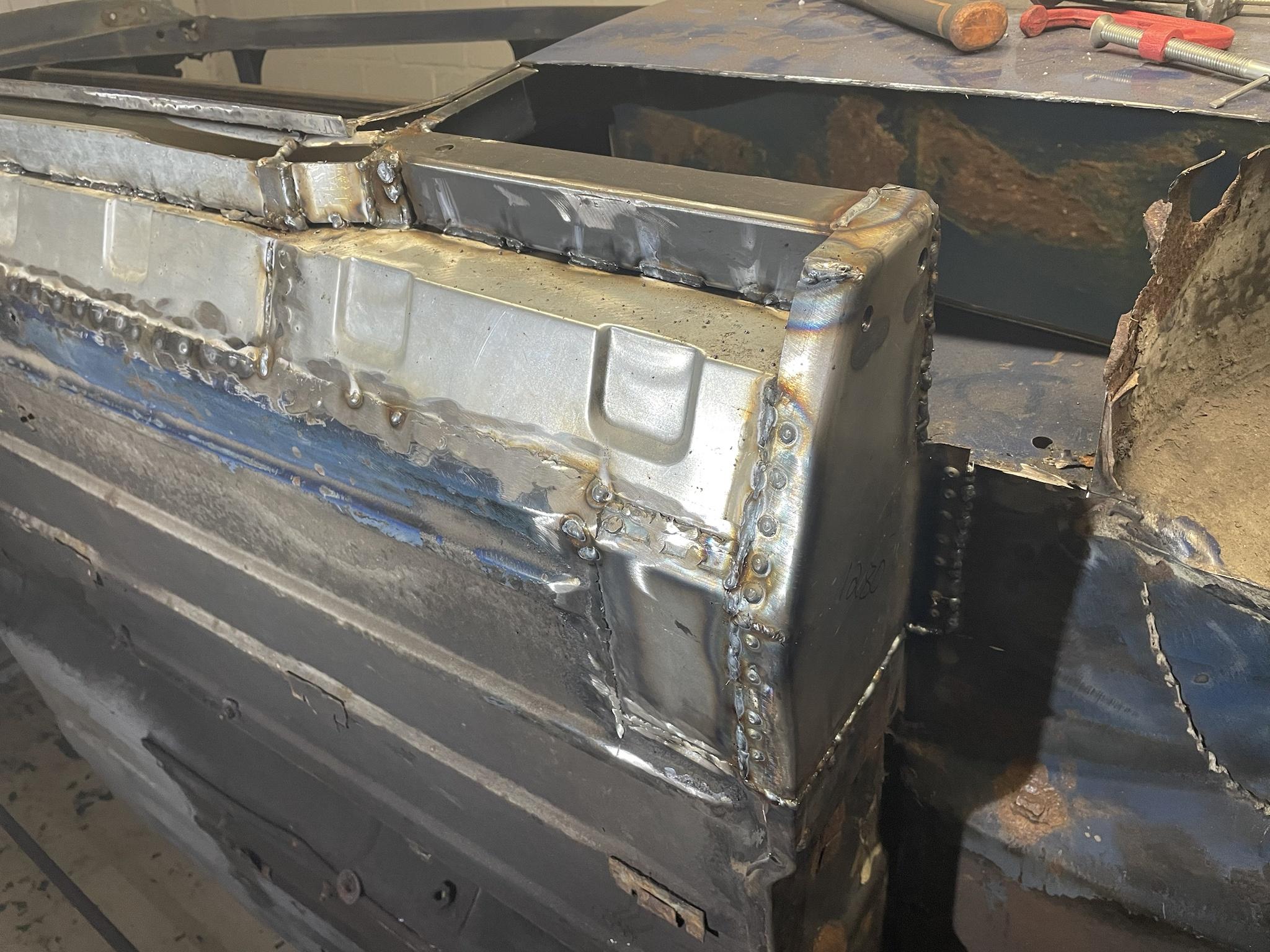

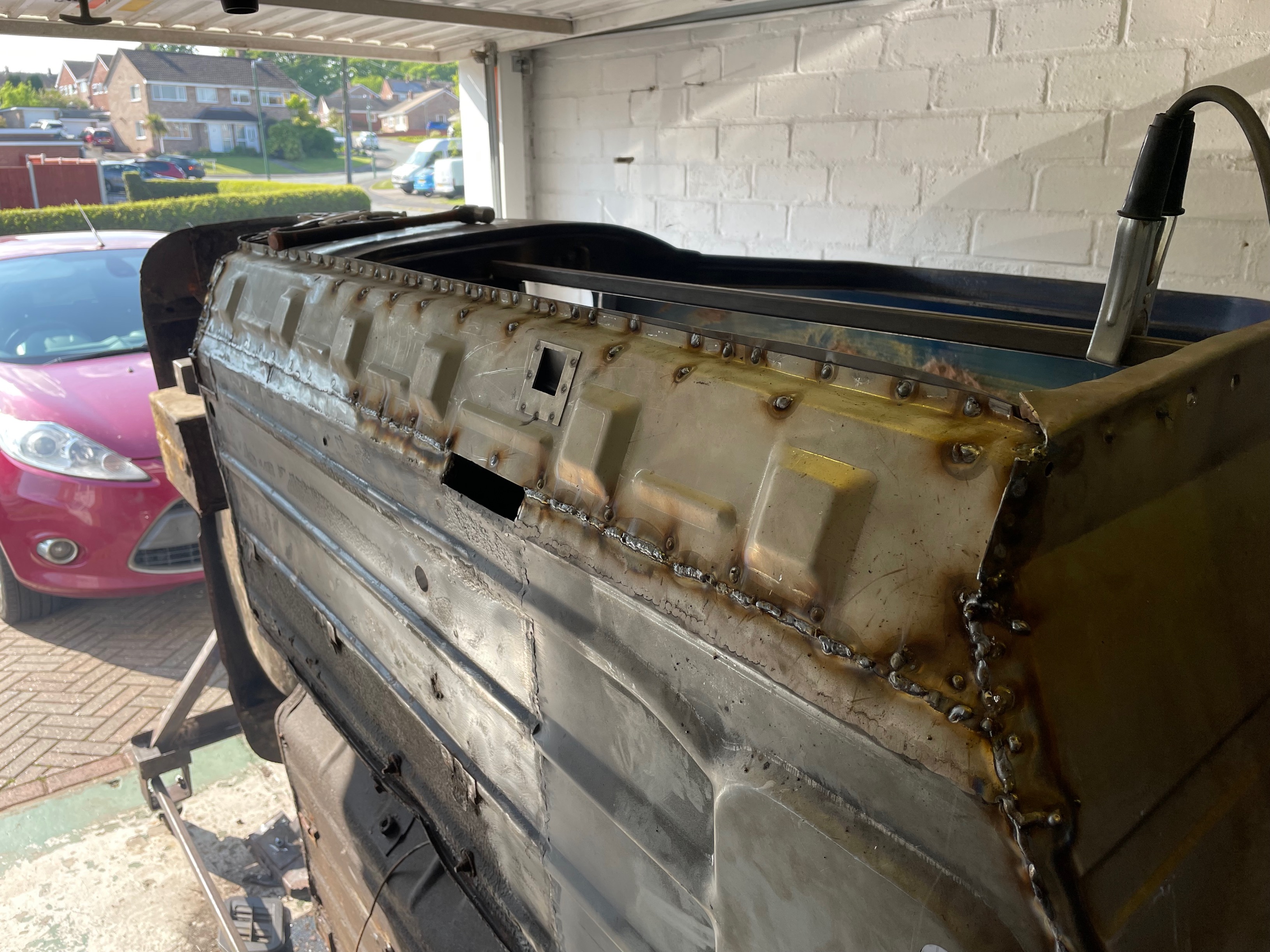

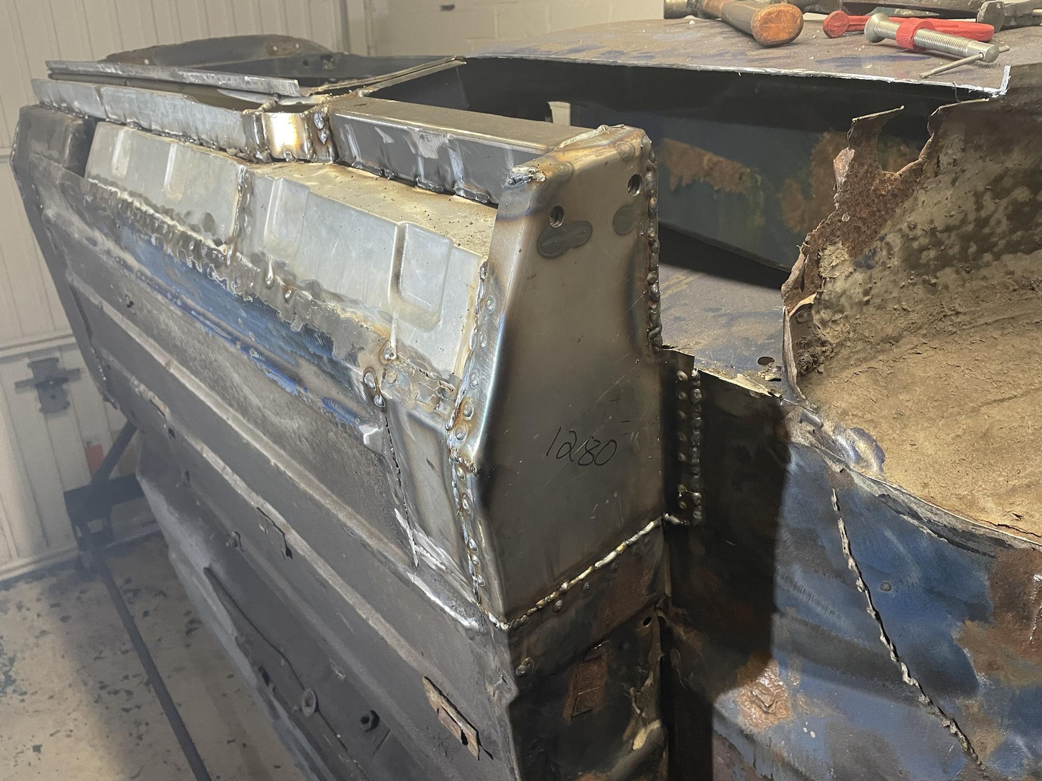

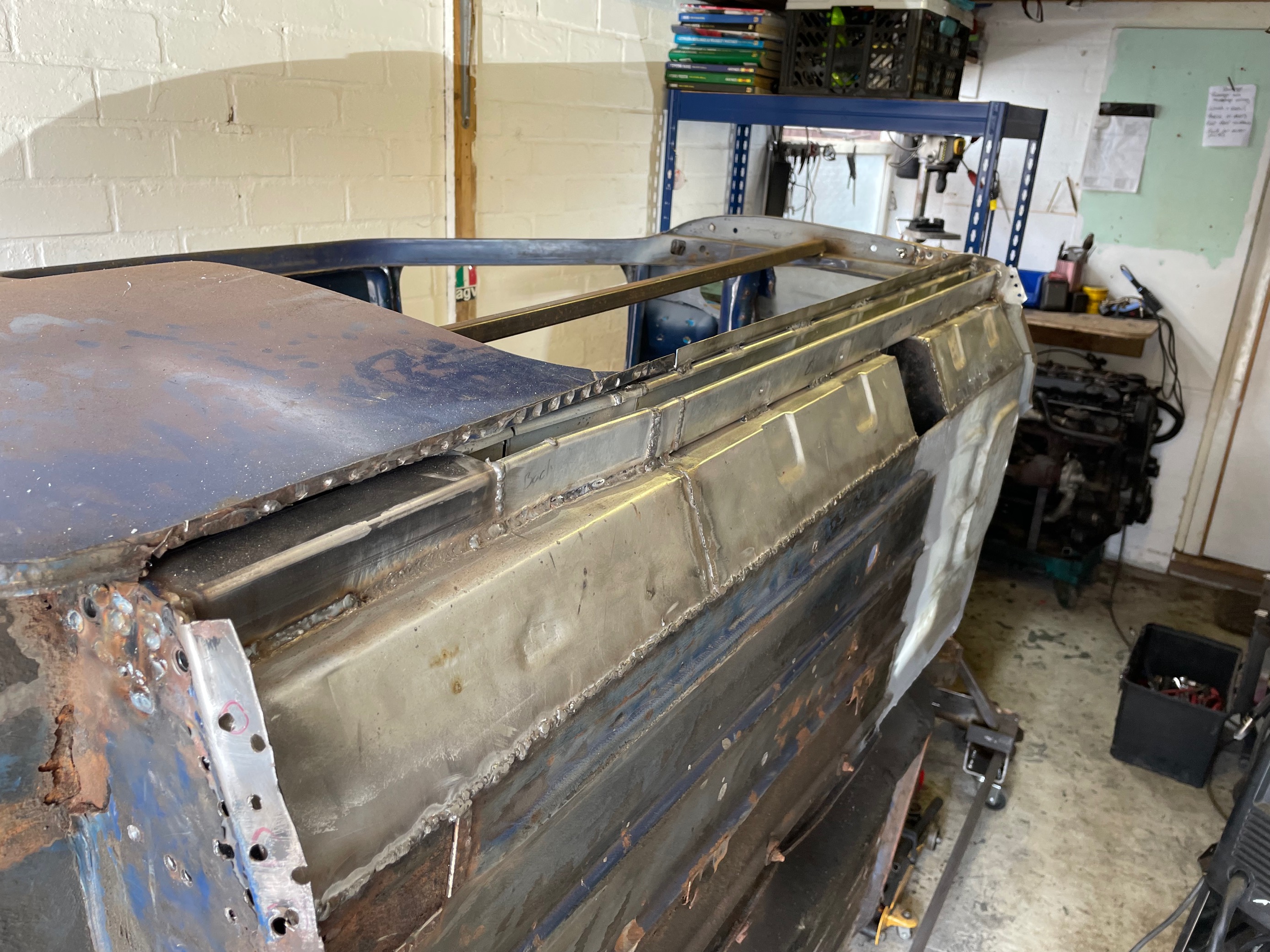

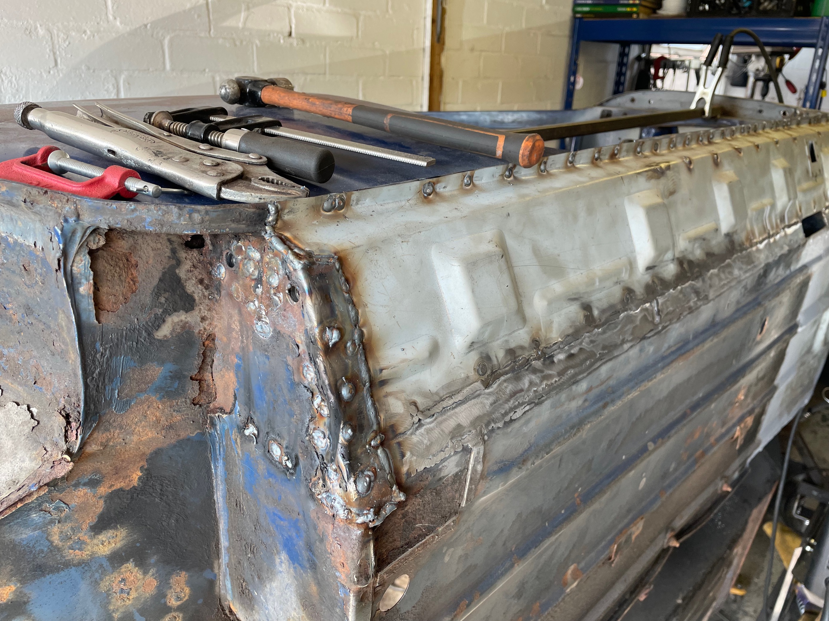

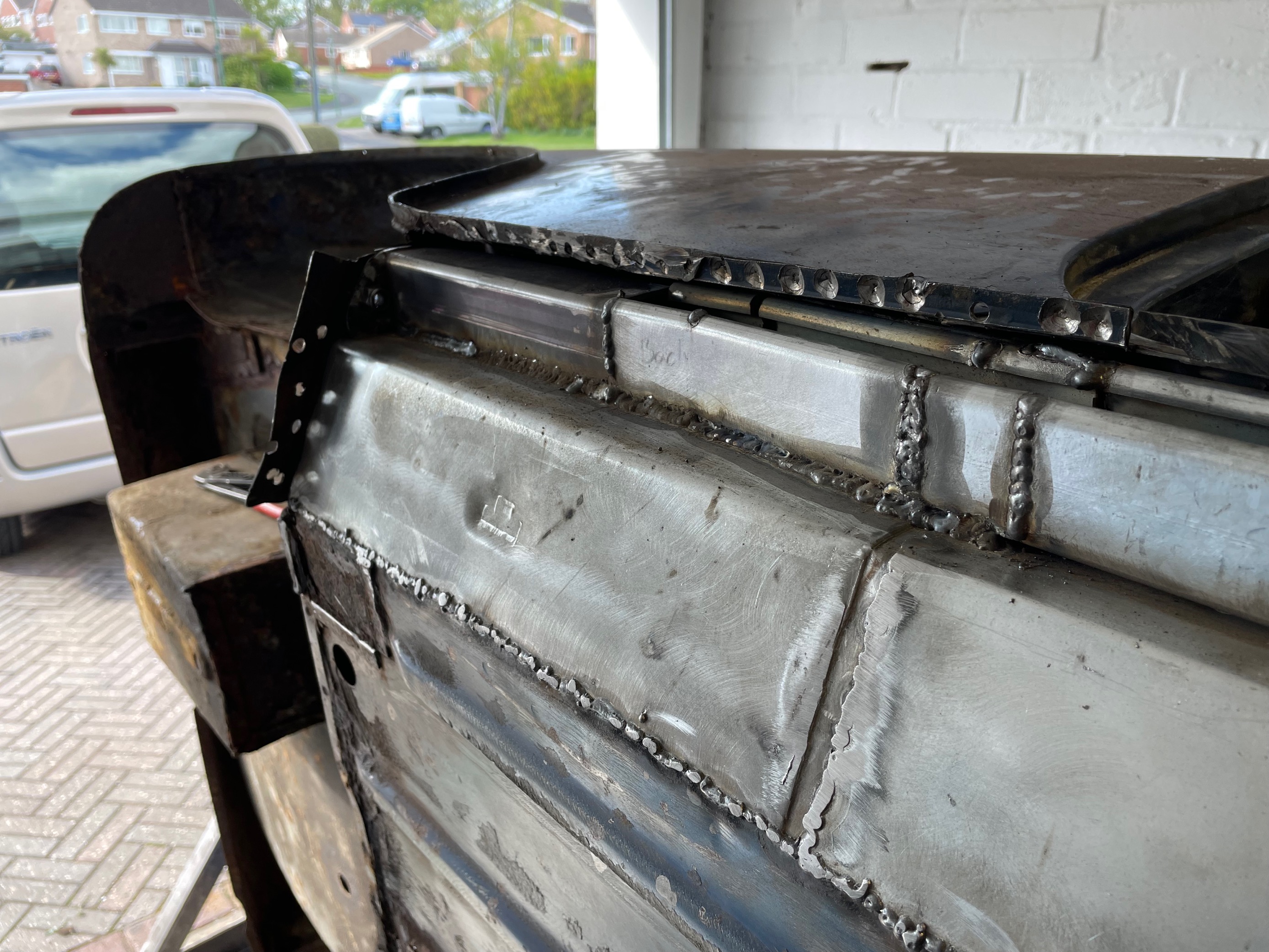

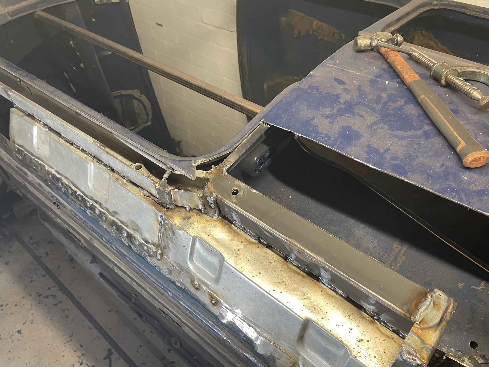

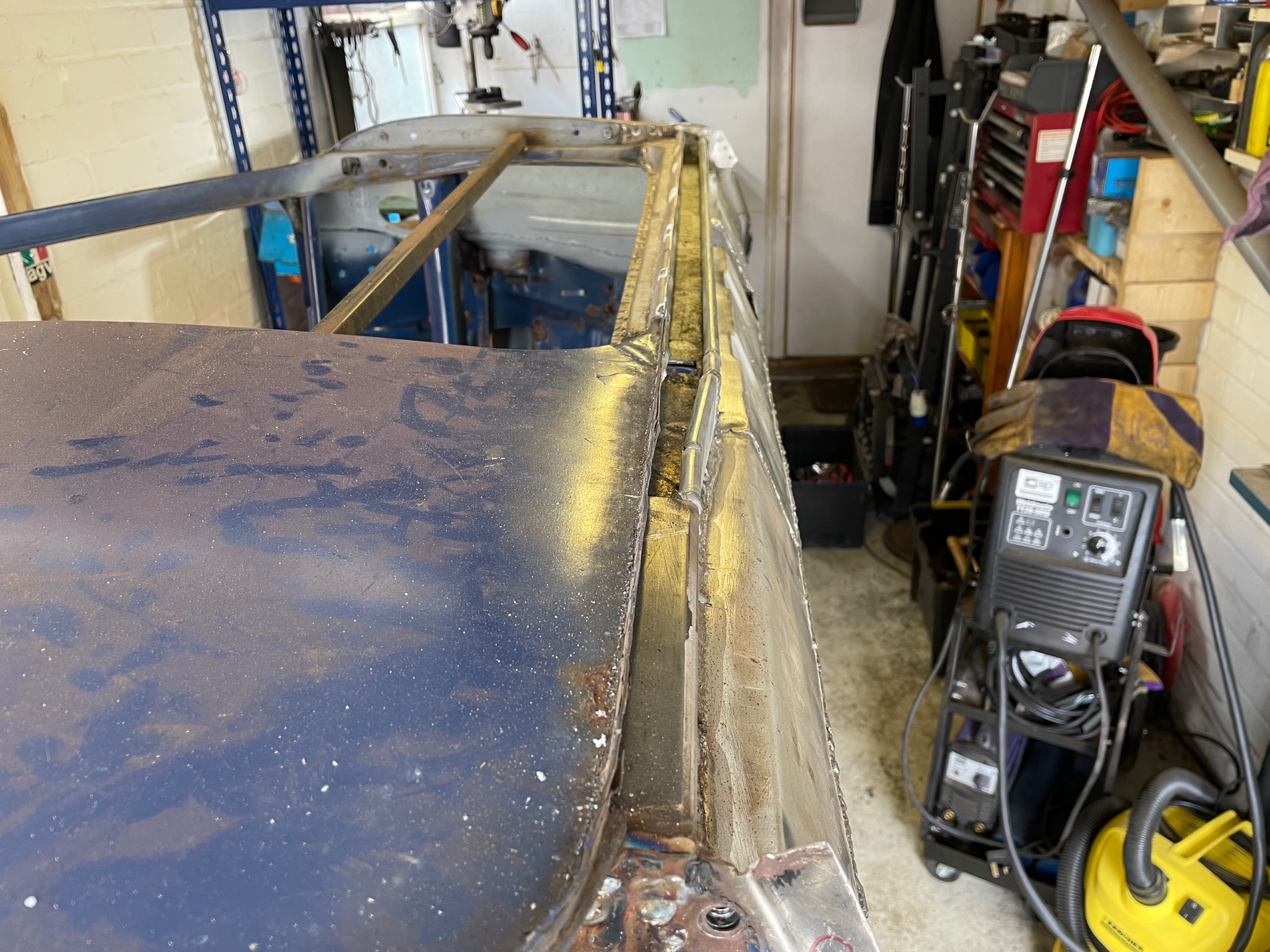

I started on the drivers side, as it was the worst. I've welded in a new inner sill, front floor, door step, and then my reinforcement.
I've taken some 3mm thick galvanized U channel, that I've bent slightly to follow the curve of the sill, and welded that inside the sill channel. It also curves heavily after the door step, to accommodate and reinforce the rear subframe mounting location. It doubles up as the seatbelt anchor, and a side impact protection brace. Whilst the weight may be a factor to speed later in the build, I'm sure it will help corner nicely!
I've since ground all the welds back, and last bit of work on the shell before I started this blog, was to put the sill outer on.
From this last picture you can see the area I need to tackle next

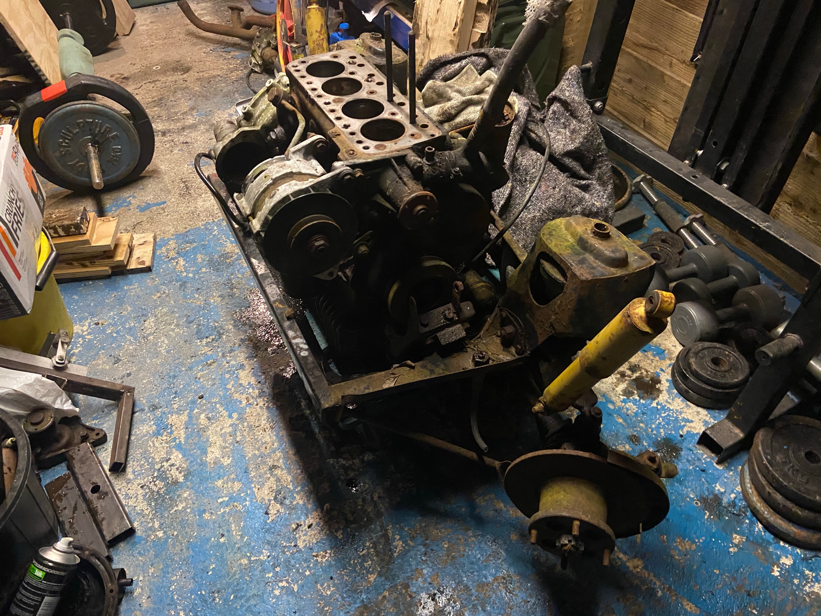

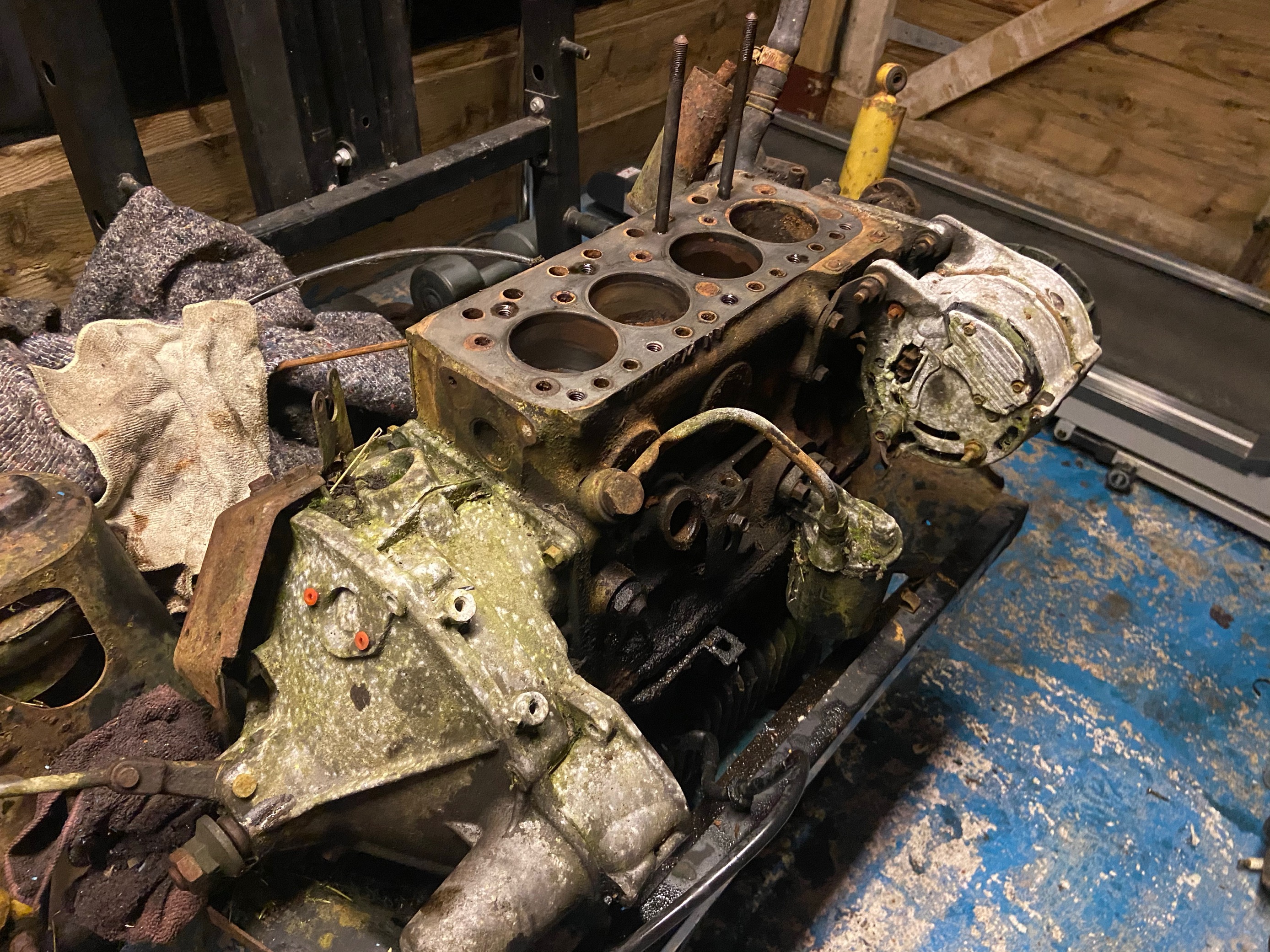

Before I sold the MR2, I was already set on doing something with a mini. I knew I had to sell it, so I bought something to tinker with to stop me... finding a supercharger on eBay or something.
I got hold of a more or less complete 998 engine in it's subframe. The starter was missing, and it had no radiator, but most of the building blocks were there. I knew the engine was going to need work, but for £80 it wasn't bad. This was mid-lockdown too so I needed something in the shed to do. [I]this is also pre house move, so I only had a shed, no garage]
I stripped it down to examine what I needed, and during that time a 1098 crank came up on eBay. So I snatched that.
Sent both the crank and the block to get machined, and they've come back looking stunning. The block is 060" over, so I ordered some 1098+060 pistons and everything is on a shelf in the garage waiting for more parts to arrive.

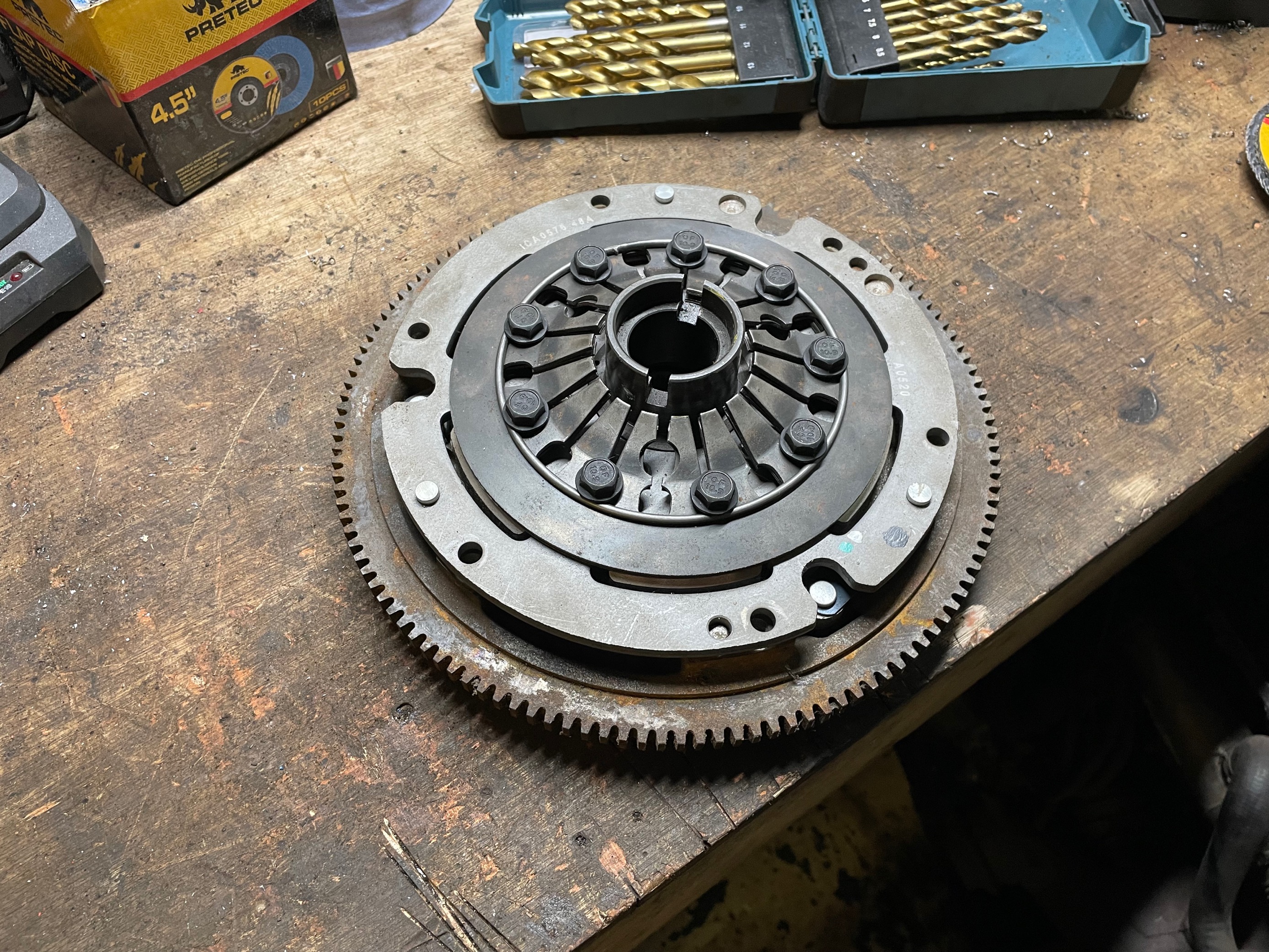

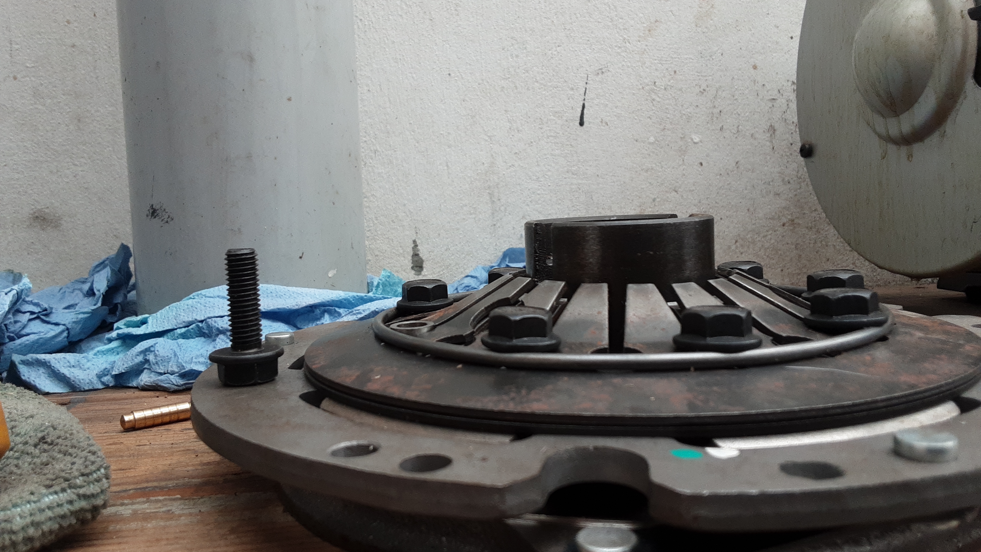

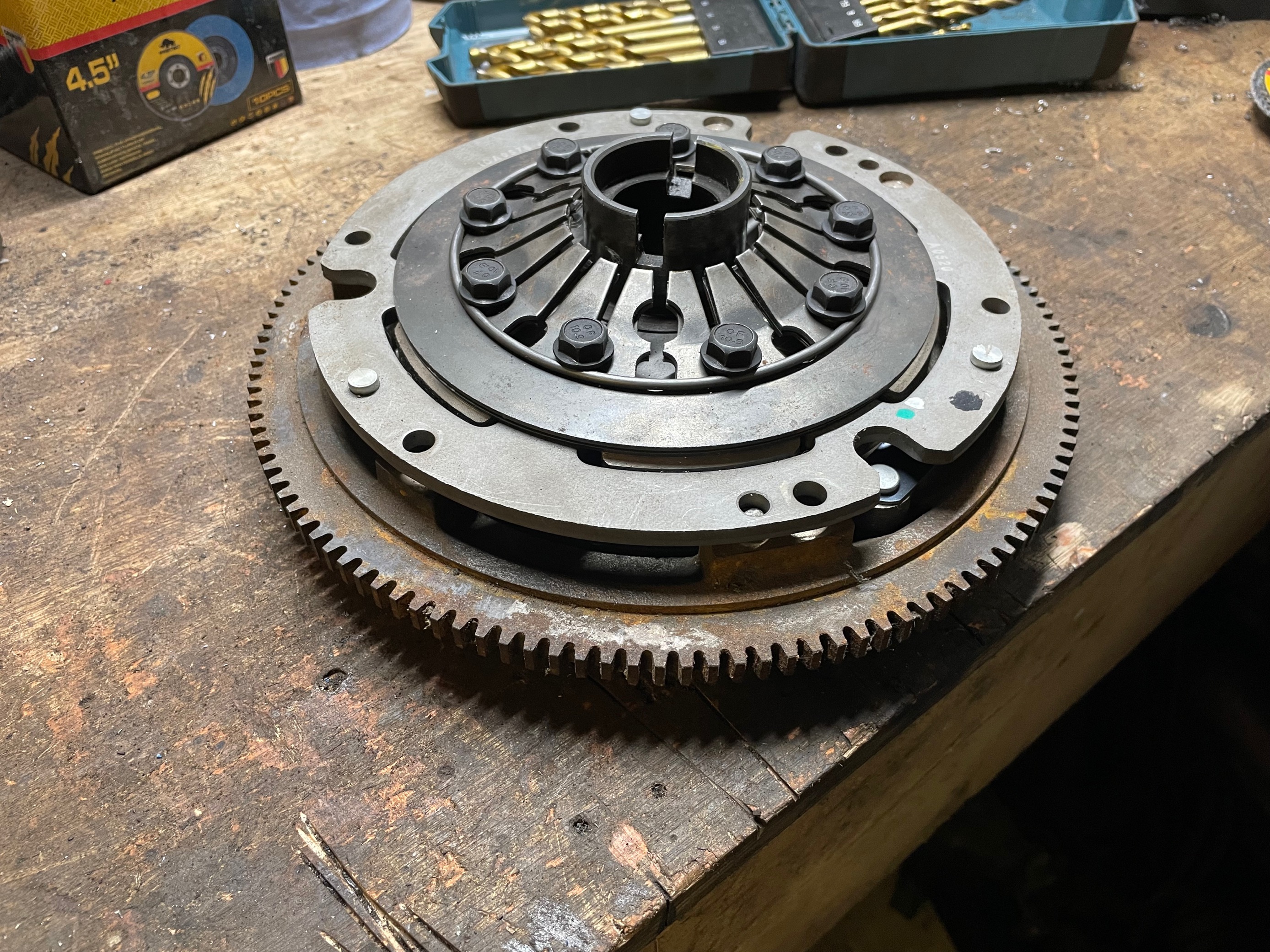

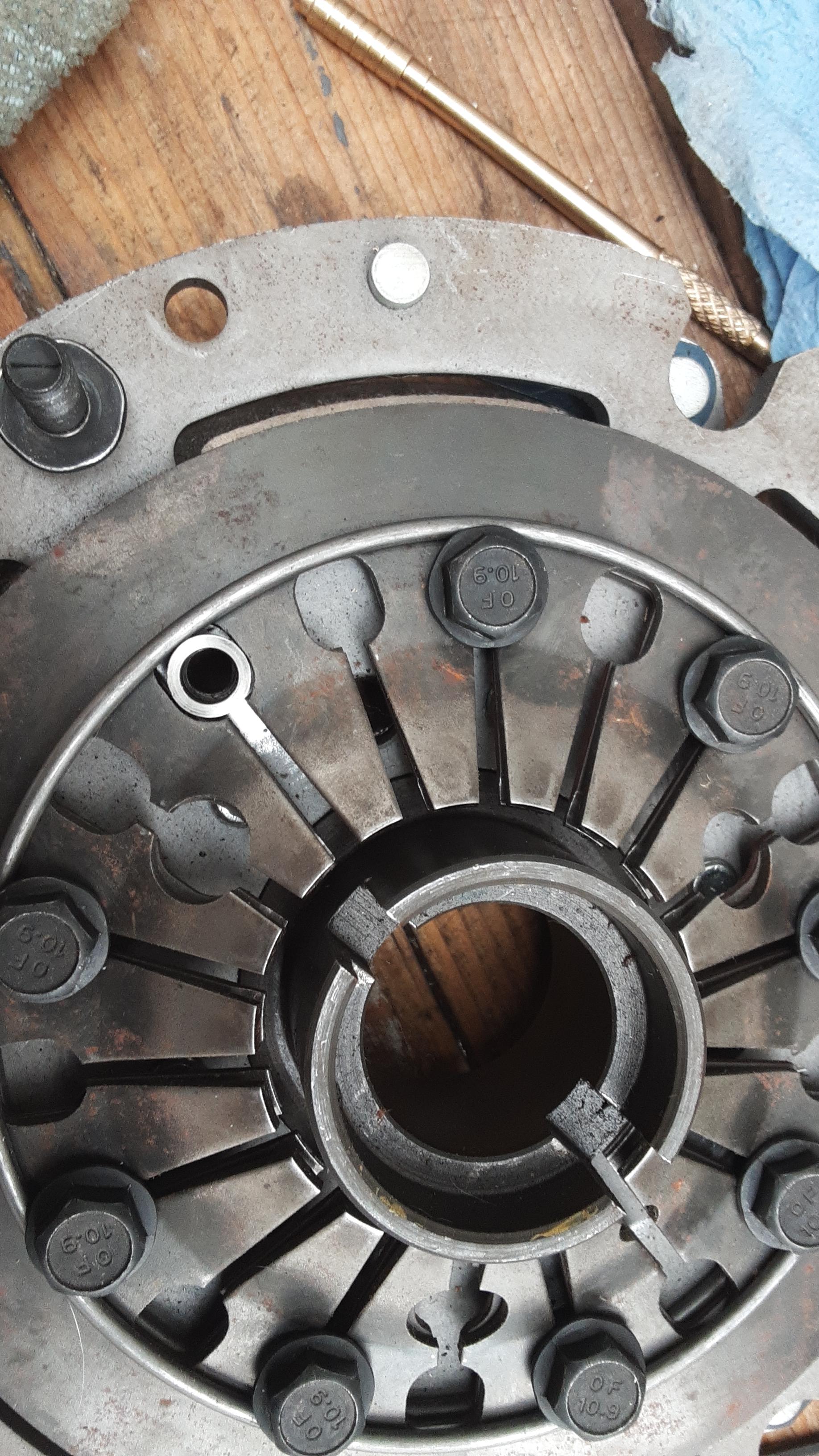

The most pressing is the clutch, as I need that to balance everything, then it can all be assembled. I had read about an RTS clutch on this very forum, so I followed the accompanying guide and I've set about making one. My colleague, who has a beautiful Myford ML7, is currently machining the required spacers for me. These are his photos of the current progress
Once it's back it's all going to AC Dodd to get lightened and balanced, then I can measure everything and start assembling the bottom end.

Please open the vents on the oversill panels, or your hard work will be be for nothing when the moisture can't escape and it's rots from the inside out.
Good luck with the project

Will do, I did wonder why they didn't come pre-drilled or stamped, or something.
I've since ran a line of drain holes at the bottom of the sill, and it will be filled with Cavity wax post paint.

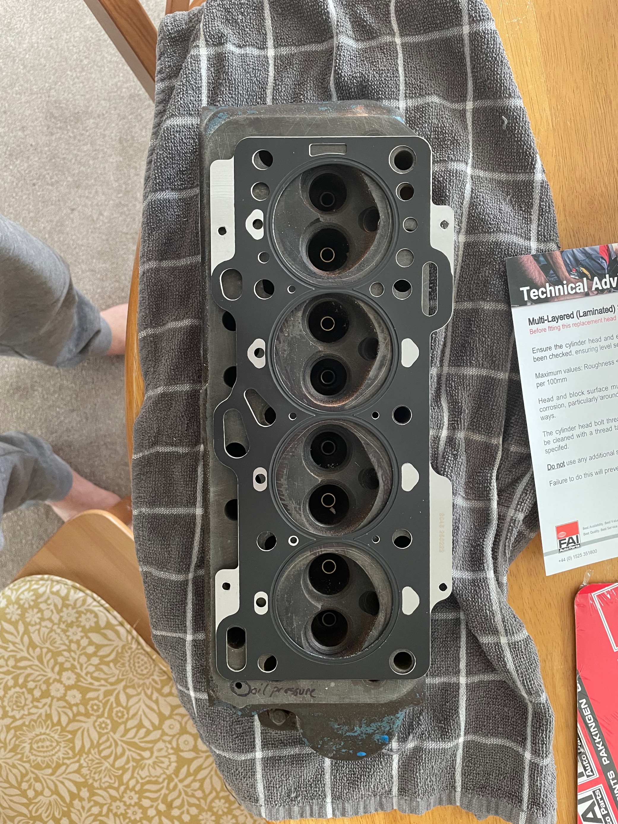

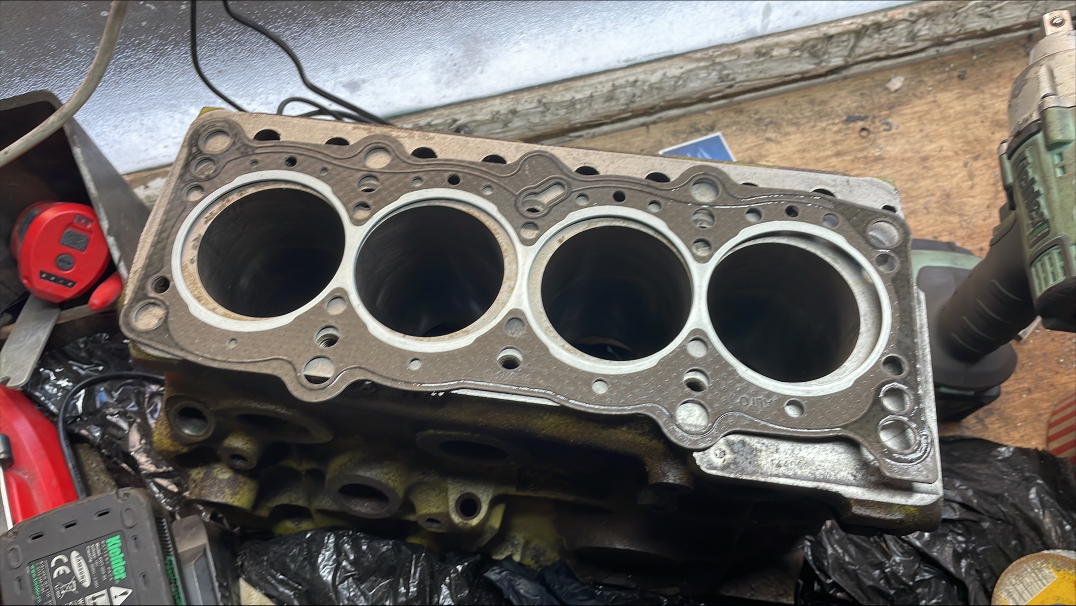

Still working on the Jag, and got showered in ATF today which wasn't fun! And my evening was spoiled as I've now got to wait for a new gearbox sump pan to arrive.
So I looked at the parts shelf and offered two things together to test a theory I had.
Sadly, it didn't work!
This is a Hyundai Getz 1.1 engine gasket, on a 998 A+ head. The bore size is perfect, but sadly the spacing is off due to the center spacing issue.
So that lead me to researching an age old topic once again. Is there any 8 (or 7) port head from other vehicles that can be bolted onto a 998 block.
I've looked into the following:
8v Fiat Fire head - Not sure if this was a 998 block or a 1275. However I've seen that it's really tall and you would need a fibreglass bulged bonnet to make it work.
CBR600 Head, loads of work for this, more even than the K100. So many custom parts are required.
K100.. again, lots of custom parts, and you need to modify the block by adjusting the bore spacing, which isn't something I can do as my block is already modified to 060" over.
Obviously the Hyundai head is a no go, but the other ideas I've got:
- Lancia / Fiat Twin Cam engine head
- Hillman Imp head
I thought I might be on to something with the Hyundai, as nobody is really looking at this sort of thing anymore, with modern (ish) engines. But I thought someone would have tried to throw a hillman imp head on a 998 before.
If anyone knows about any more, please let me know.
I'm eager to get around the Siamese port issue, and I've even found the old posts about boring out the inlet ports until you break through into the pushrod chambers, then inserting a sleeve with a partition welded into it, so you effectively create a 7 port head, with D shaped inlet ports.
My ideal goal would be something like the Fiat 8v head, as it has all the electronics in the head ready for sequential injection. I could then modify the existing inlet system.
Anyway, waffle over! Need a shower to get the ATF and rust flakes out of my hair!

I've also spent a lot of time cutting and welding new parts to the left hand side of the mini.
Mainly just a repeat of the right hand side, but with my welding skills improved a lot more.
I've still got the front left to do, where it transitions to the toe board, but I'm getting there.

https://www.minispares.com/product/classic/14A9534.aspx consider using the genuine outer sill, rather than the MOT repair panel. Worth taking a look at how an original sill section is constructed.
