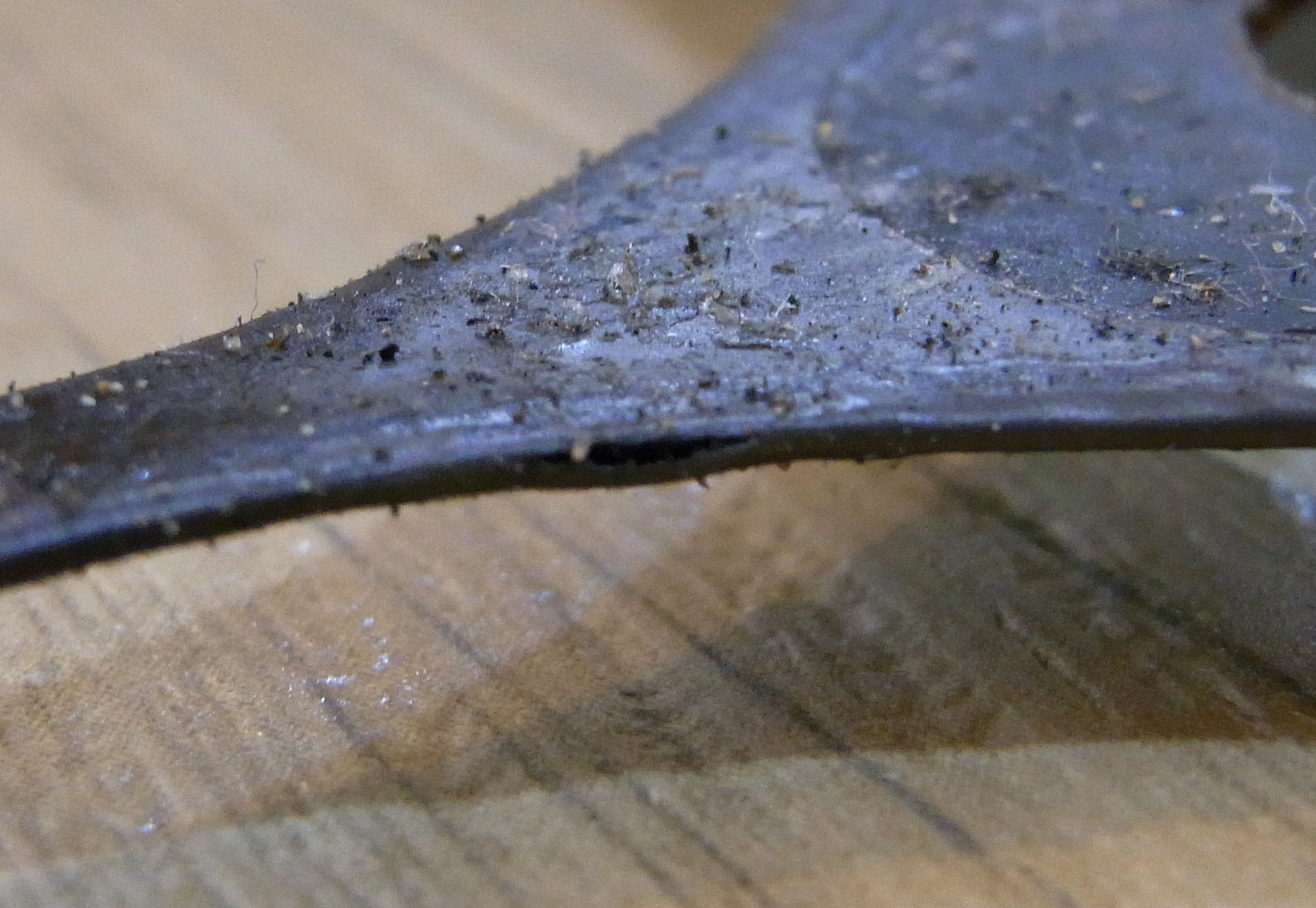

I thought that I should update this thread with my experience of the 'new kid in town gasket'
Basically I have now had two failures of the new gasket, one after a few thousand miles, one after a few hundred, so the first failure:
After lunching a copper gasket when I had boost control issues and lots of det I put one of the black ones on, this was just before Le Mans. I was running around 8psi, no pinking, no overheating, a nice relatively unstressd life for a head gasket. It then failed catastrophically. You can see the photo below.

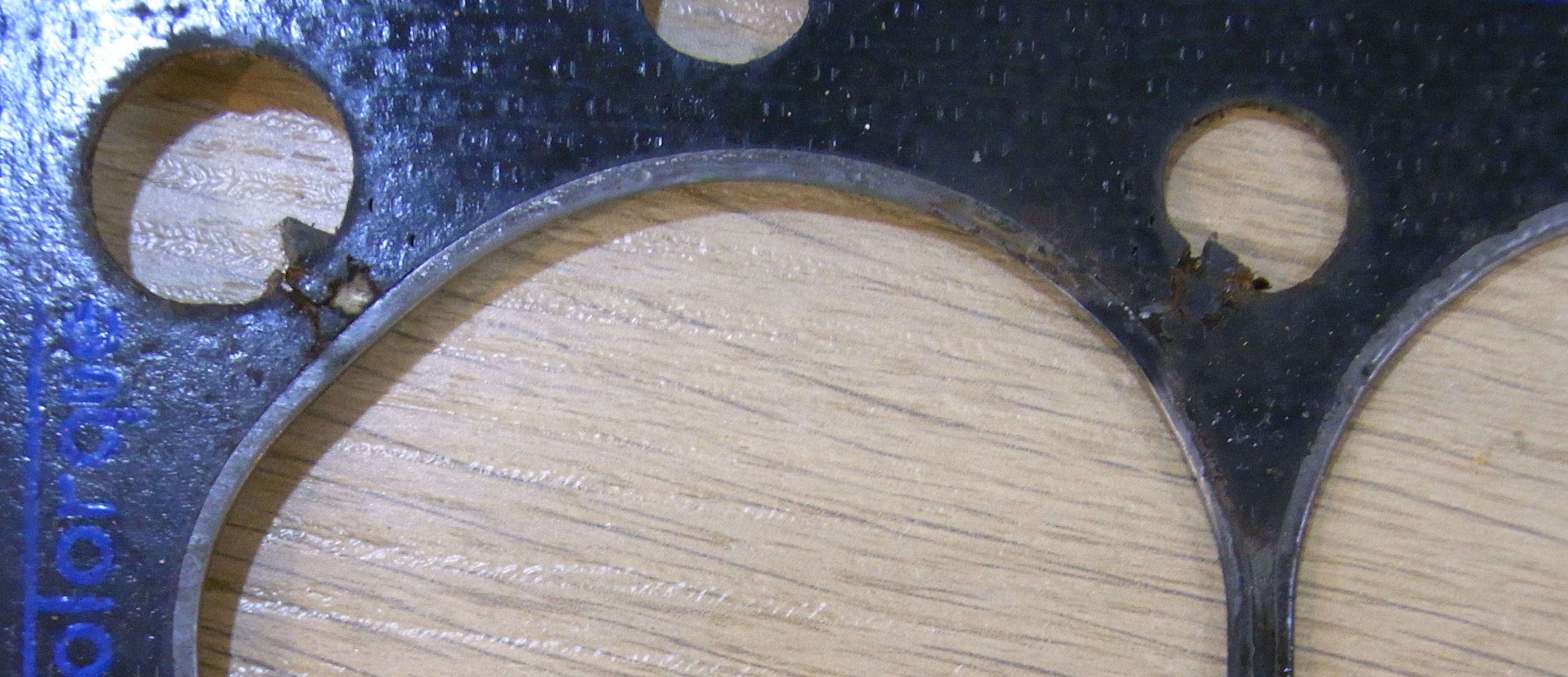

Now, it has to be mentioned that I had torqued the head to 68Nm (as standard) but the gasket packet specified staged torquing 20Nm, 40Nm then 54Nm.
The following photo shows another firering with damage and likely to fail soon:
I therefore put this failure down to me over-torquing the gasket.

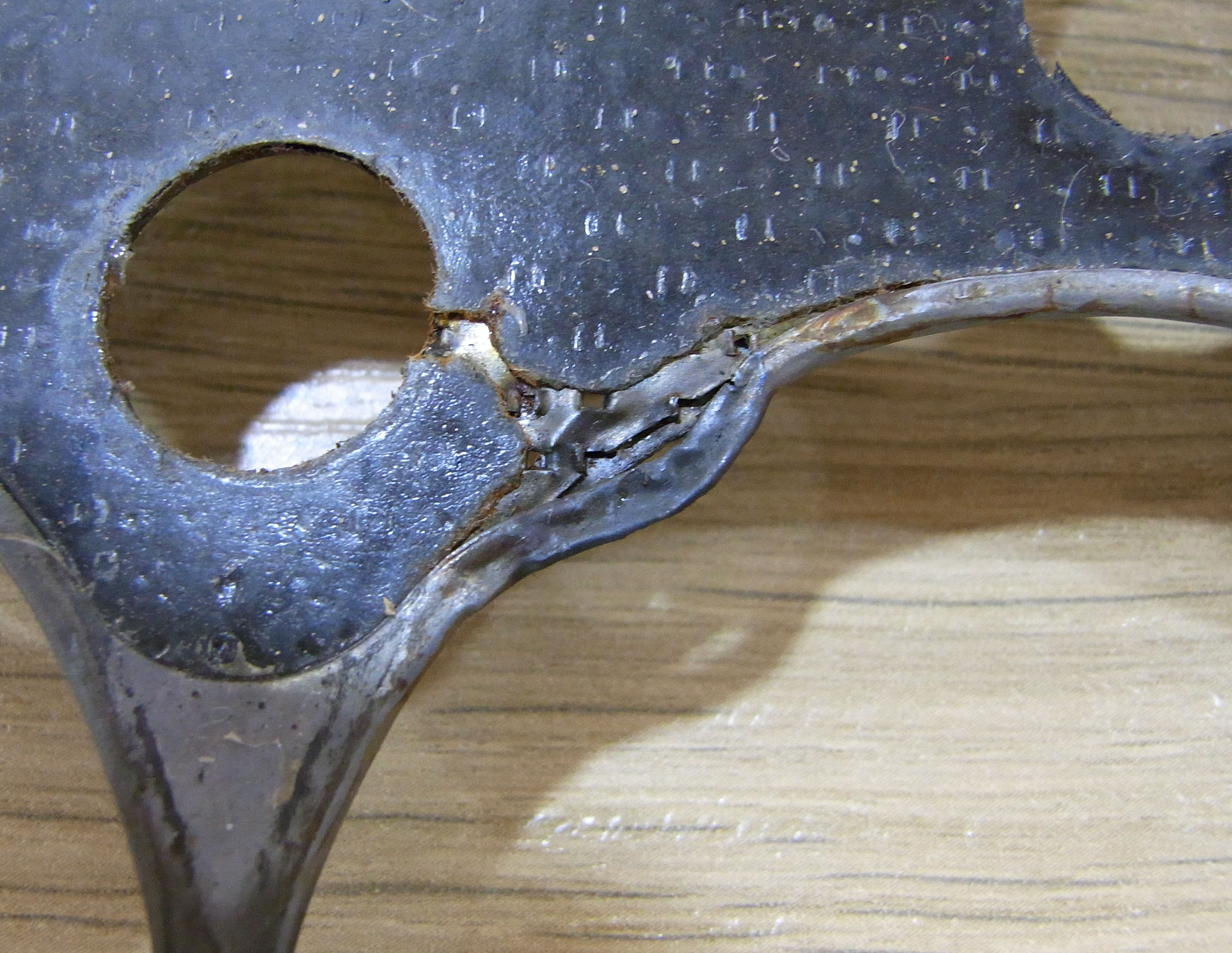

So, on to the second failure. This time I torqued to 54Nm in stages as specified. The gasket failed, with a leak from cylinder to coolant, see photo:
Now, having experience of this type of failure I know it's owing to under-torquing. I calibrated my wrench last month by the way, but it's unlikey to be high at 68Nm and low at 54Nm in any case.
I'm not suggesting that this gasket is a pile of junk, just it may not be suitable for the extra heat and pressure of a turbo engine.
My advice is that the Copper type (that are half the price) are more than up to the job and I wouldn't suggest using the Black type.
I'd be interested in others experience. It is worth noting that these gaskets are not in any way the same as the BK450 in material or construction and that the fire rings on the copper gaskets are actually thicker.
