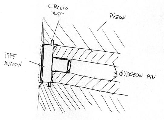

Firstly, I bought some PTFE (Teflon) off Ebay, I bought a 250 mm length of 20 mm bar. I can't remember what it cost but is was pretty cheap.

These replace the circlips completely? unlike the other method of preventing the circlips from falling out?
29th Jun, 2006 at 11:03:16am
Yes, remove the circlip completly. Fastest 998 mini in the world? 13.05 1/4 mile 106mph

sorry i know this is very old but why would these be better than circlips? |
3rd Mar, 2008 at 01:23:49pm
The circlips are prone to failure, and when they fail they take big chunks out of the side of the cylinder walls rendering the block scrap. Fastest 998 mini in the world? 13.05 1/4 mile 106mph

because if a circlip comes out (and they often do) it scores the bore, the PTFE button wont. |

is there anywhere i can buy some? I dont quite understand the diagram Edited by miniboo on 3rd Mar, 2008. |

its basically a top hat shape, so some round bar to a particular diameter, with a step in, parted off to length.

i doubt they will wear much (if at all) inbetween rebuilds, its not just us that use this method, its a common mod, racing jags use them, nissans use them etc etc
3rd Mar, 2008 at 08:13:21pm
There's no real wear as they don't fit tight in the bore. Small amounts of movement isn't a problem.

It sould be sth like this, right?
7th Mar, 2008 at 08:43:37am
Correct. Remember the crap diagram I drew at the top if fot 20773 pistons. The Hypertecs hare completly different.
