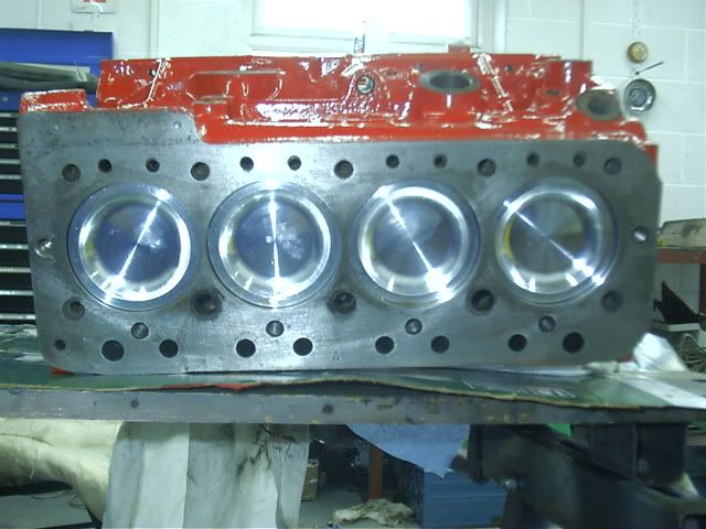

1380cc makes the goods! *wink*
togeather with accralite 18cc dished forged pistons from
mr Avonbar *happy*
this will puff the T3 up a shade faster and take the camminess out of the Avonbar phase 2
this also with mapped ignition & a Larger intercooler, trick head and exhaust modds.
it should pull the skin off a rice pudding now. ...................lol *wink*
will keep you posted!

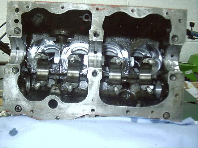

Bores gap to next bores look scarling thin....

Looks great Ben. Those pistons look the business and a nice piece of offset boring! The wall between 2&3 looks thicker than mine, what offsets did you use in the end?

Vrooom they look thin from the underside its a bad pic, look on the block deck pic
spridged the 2 center bores pitched to the outside 0.015"
the two outside bores pitched to the outside 0.010"
this leaves 3.5mm center and the two outside ones 3.1mm
just right but .......... some may disagree?,
most blocks differ! from OEM boring
