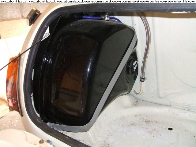

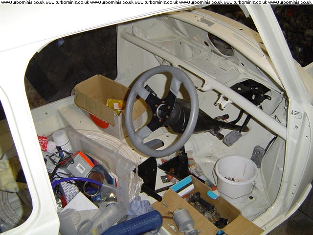

Have cut out the arches and back seat and pockets

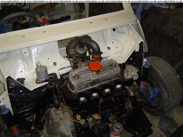

Shouldn't there be an angle here
Might be my imagination - but the whole box looks to be a little wider than standard - so it might not be as critical?
Even so- a little more clearance wouldn't go amiss!
Brocky
809 Posts
Member #: 224
Katy TEXAS
Good eyes guys...
Yep, its a custom box, its wider and deeper, fully seam welded and from thicker steel than the ones you can buy.
Hopefully there should be plenty of room...*wink*
I also put a slope on the bottom shelf to let any rain water roll off that may find its way down the air intake !!
Thanks for all the comments guys *happy*
Cheers Brocky

ni on identical box as mine, it is twice as deep as the standard one, but i cut the angle in anyway just in case.....car is looking swell by the way good job !!!

Very nice job.
I welded a slant along the bottom of my bulkhead box too, worth doing providing you still have decent clearance:)

Yes I learn't from the first turbo I built that water likes to sit on it !!

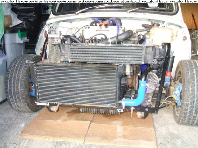

That how I was planning to run my intercooler pipes*happy*
but my 2wd cossy cooler will be parrallel above my front mounted rad or below, haven't decide where to put the oil cooler yet, slighty more room with the fibre glass front

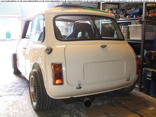

Three years in the resto, and by tomorrow it should be painted !!
The visquine is on the walls
Etch primed and stone chipped underneath, inner wings, rear wheel arches and interior ready for top coat, outside 12 hundreded and stoppered...

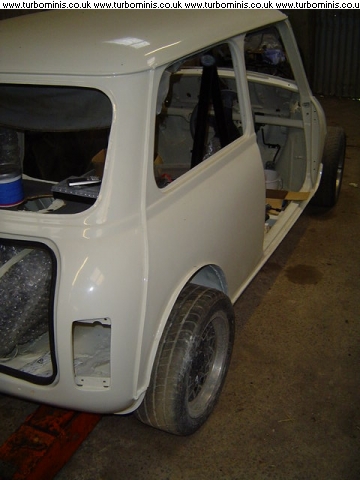

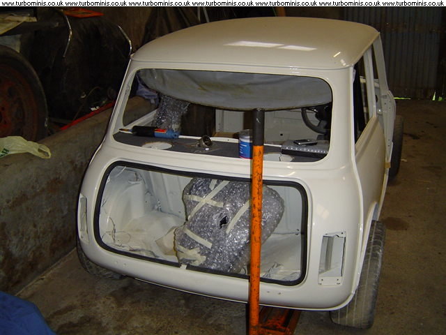

Well thats the body back from paint and slowly getting put back together. Just don't seem to have the time at the moment!! Just want to get it running and then I will get everything painted and polished on the engine. Will fit the intercooler after that.

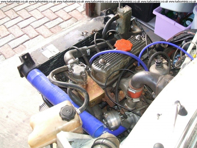

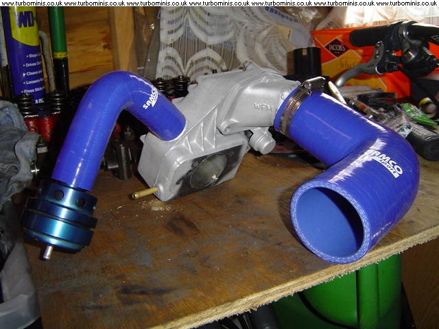

Finished of the recon job on the blower and moded the plenum for dump valve and intercooler. Is it wrong for me to be excited ? as I can't wait to bolt these on !!!

Could you get the photo of the recon turbo up as the was a serious amount of work went into that !!!

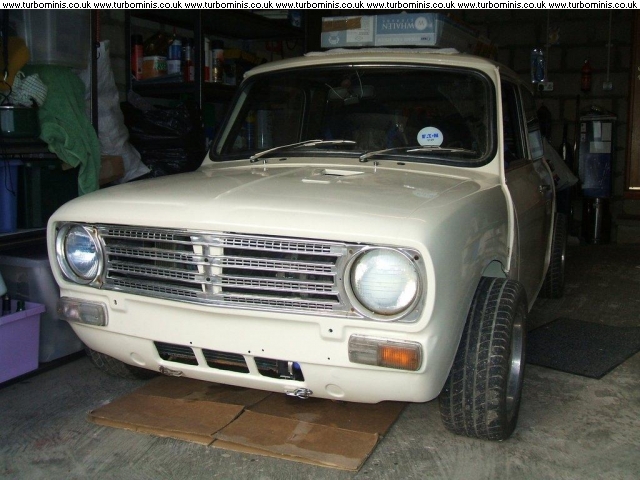

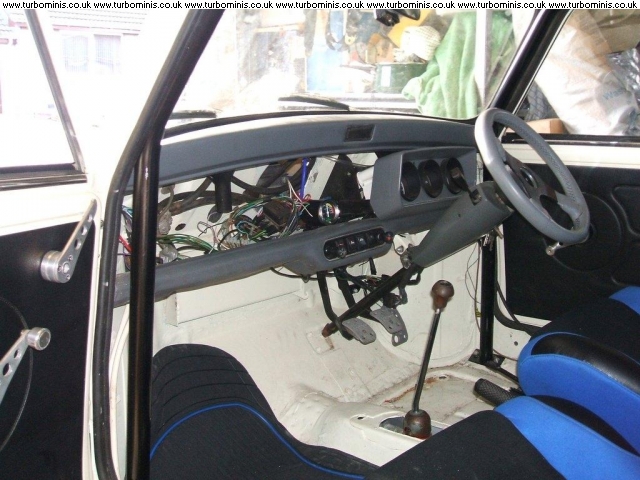

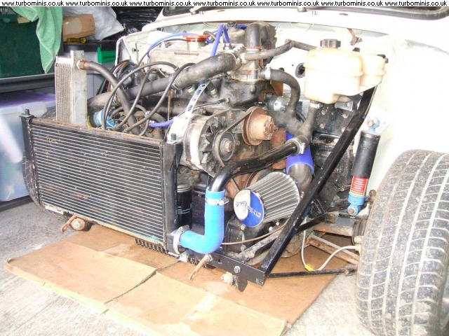

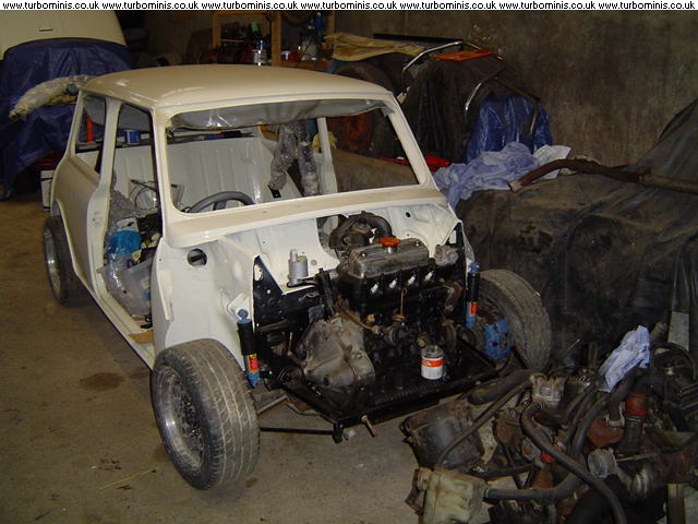

Just thought I put some pics up as I've made a bit more progress, actually went for a sneaky drive up the cul-de-sac and back today!! its the first time I've had it out now to get the wheel arches on etc.
Once its on the road I will start on the high boost engine, will use the quaife lsd I'm getting through the tm group buy in that. Benross has sorted the head, should be good for a few bannas...*smiley*
