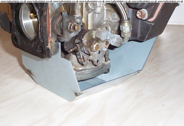

A couple people said about supporting the front of the shield. Heres a newer version, any comments please.......

what does it bolt to? pelenum and manifold?
looks good

yes m8. Got another mod to do, just tried it on my metro. Making it abit wider. 3rd time lucky!!!!!!!!!!
Problably put some blanket in there to.

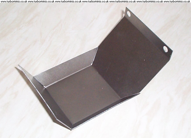

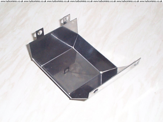

Perfected them today. Hope to get a couple made soon. Found some stainless. Natural, un-polished finish.
Heres some pics of my 'MKIII' prototype version (crappy zinc coated).....if anyone interested in a stainless one, let me know. *wink*
