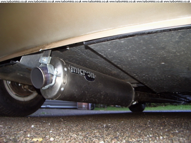

This is the one on my gold car - the main tube is 2 inch inside dia from manifold back to the silencer - the silencer is circa 60mm bore. The silencer is Ti and weighs 1kg - the rest of the system is thin wall T304 and weighs 2.5kg - so all in 3.5kg - not surprisingly it sounds like a big superbike!lol! - but not excessive or chav like by any means.

Nice undertray John, mine is a bit more extreem as the exhaust is on the boot side of it. Made a massive differance to speed and stability at speed.

Does anyone sell an undertray like that? Check out the (slow) progress at.......
197 Posts Member #: 1488 Advanced Member Bristol |
4th Jul, 2007 at 11:18:05am
Aye, also interested in the rear tray... heard about them but never really seen one before. Looks easy enough to make, but I'm sure I'm wrong lol There is no sense crying over every mistake- you just keep on trying til you run out of cake. |
4th Jul, 2007 at 11:34:02am
You'll have to make your own I'm afraid boys. Big sheet of alloy, bent to shape thwn rivited to the subframe. Fastest 998 mini in the world? 13.05 1/4 mile 106mph
