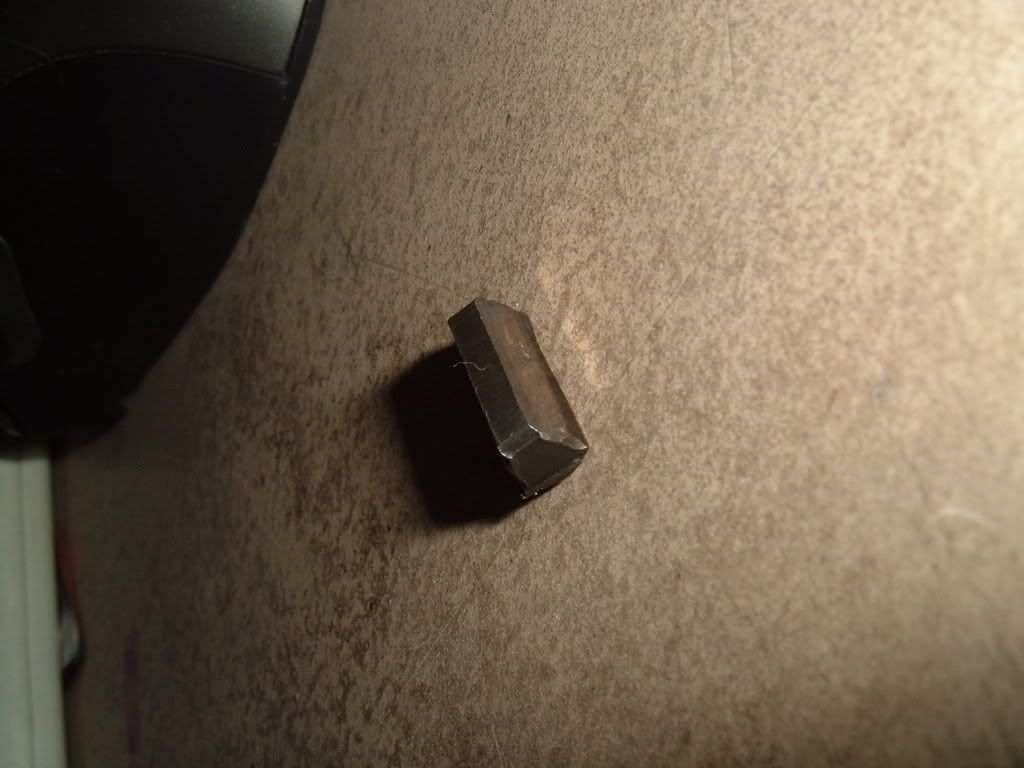

Well it's very broken, definately gearbox death.
just dropped the oil and found this stuck to the sump plug.
will rip it out and strip it down tomorrow, thats going to be a dead laygear i guess?
more pics here.
http://smg.photobucket.com/albums/v175/bud...earbox%20death/

oops - 3 years and 30kmiles of abuse... and a tooth falls out :o
got some araldite... stick it back on.. *wink*
speak soon...
Dave.
stick it in milk quick!

*frown* But on a lighter note, what sort of hair is stuck to the top of that tooth?!?

stick it under your pillow tonight nick ,and the tooth fairy might give you a shaft .!!! *surprised* :$

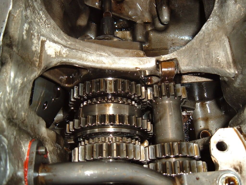

got it out and stripped today, just gotta find my 1" 1/8 socket to carry on stripping the box down.
don't know the name of the gear but here you go.
is there any damage to the laygear??
maybe a cheap fix?
