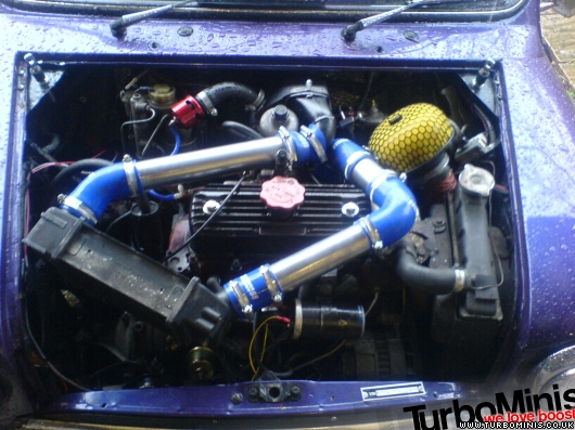

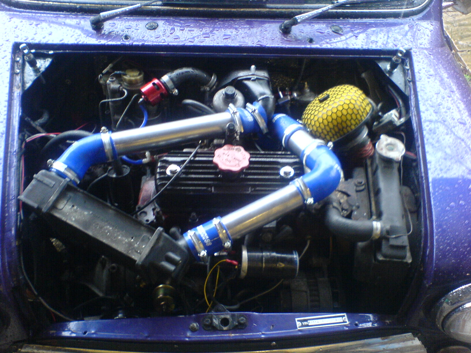

With the rr session provisionally booked for next tuesday, I decided to fit one of the many intercoolers i've been collecting.
JF supplied the modded pipes (would have loved one of nic's plenums, but cash is a major issue at the moment, and for the money, JF's pipes are hard to beat)
Ordered the silicone hoses from zenaracing and got 2m of stainless tube from the local motor factors.
After a morning of angle grinding and fannying about, here is the result:
Not the best location ever, but not bad with the limited amount of silicone pipe i had.
I really struggled to get the motivation to do this as I thought it was going to take ages, but was actually pretty simple. Given the amount of How To intercooler requests recently here is a list of the bits i used:
series 2 escort intercooler
JF plenum pipes (contact giallofly on here for them)
Silicone hoses from zena:
2 x 51mm 90 degree elbows
2 x 51mm 3" straight couplers
1 x 51mm 45 degree elbow
2" steel exhaust pipe cut in to the following sizes:
300mm
250mm
110mm
10 x size 3 jubilee clips
Hopefully this will be of help to someone. :)

Looking good. If you don't mind cutting a hole in your bonnet, I recon you could fit a 90 degree elbow where the 45 is and the 45 where the coupler on the cooler inlet is, the coupler on the cooler outlet and you'd be able to get it sitting derictly in the airflow and only need one extra 90 degree hose and a 300mm or so piece of steel tube. And I recon you'd have a damn good cooler setup especially if you seal it in like Robert did! *wink*

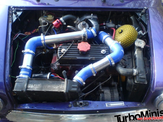

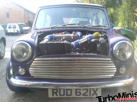

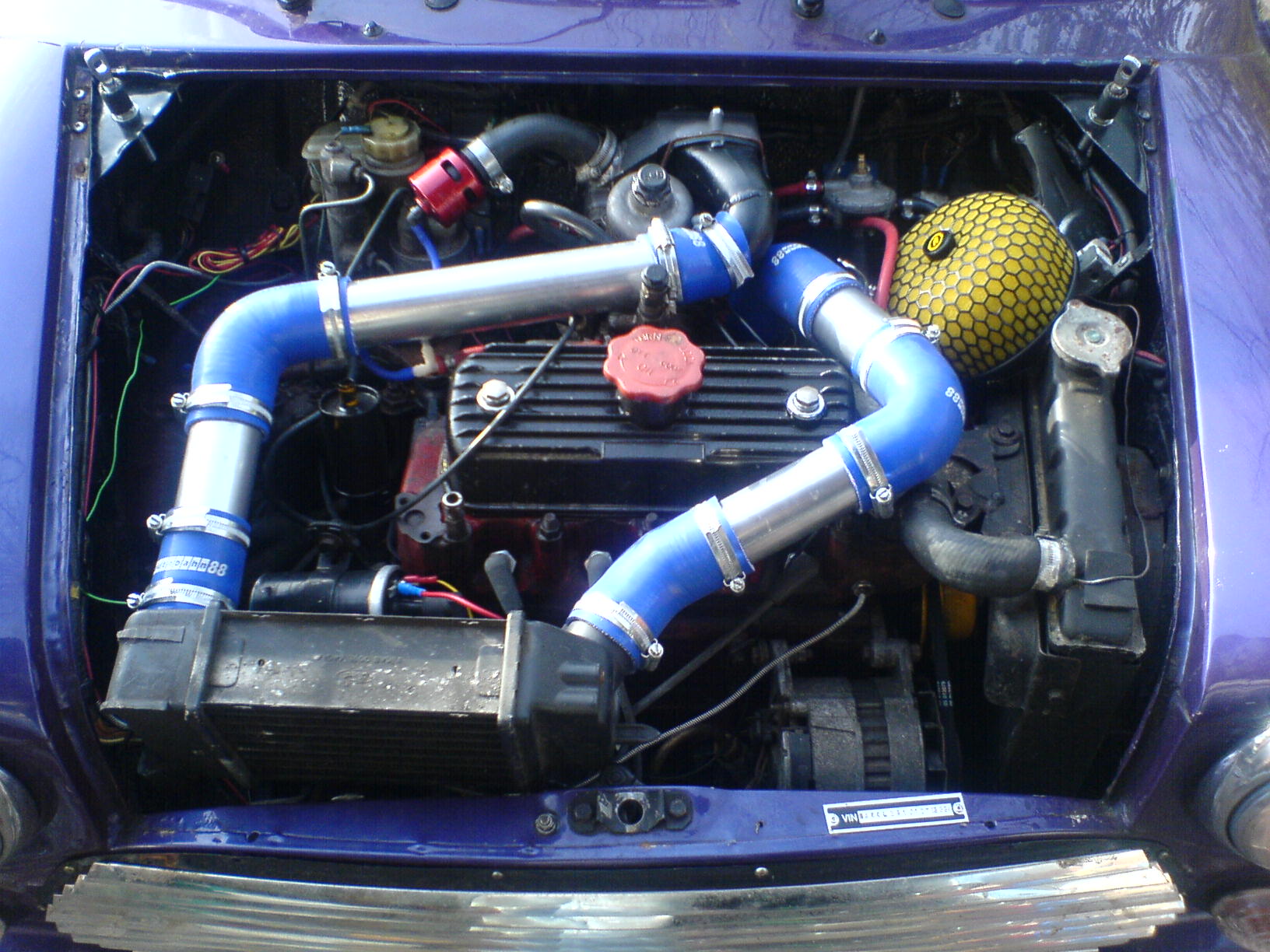

slight update, my addition 90 degree elbow finally arrived so have fitted up the cooler as per matt description.
Looks tons better imho and will obviously be a lot more efficient.
Last weekend i also fitted an uprated 8psi actuator as the standard one was goosed and opening at about 2.5psi and wasn't holding boost when i bled it.
