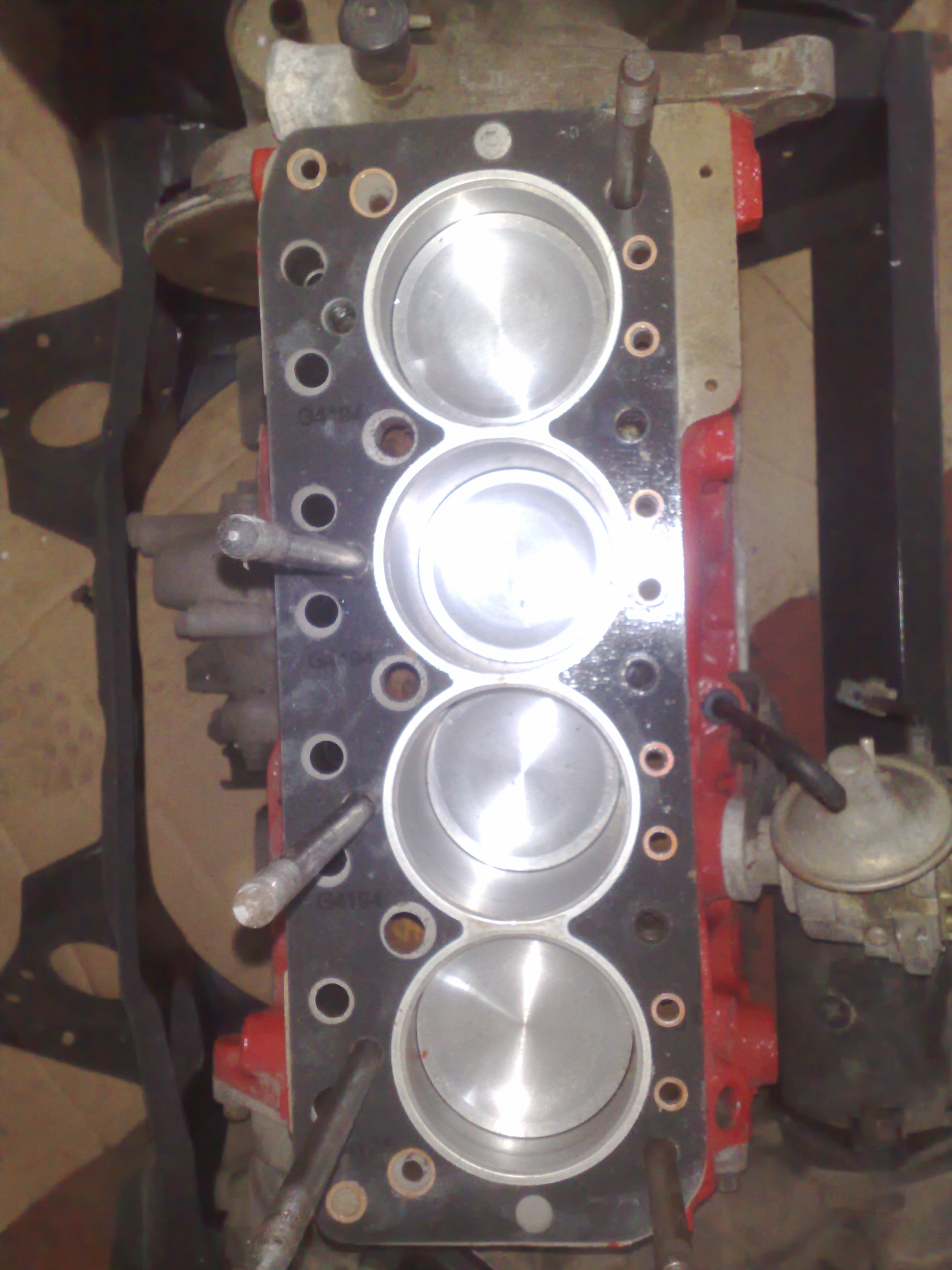

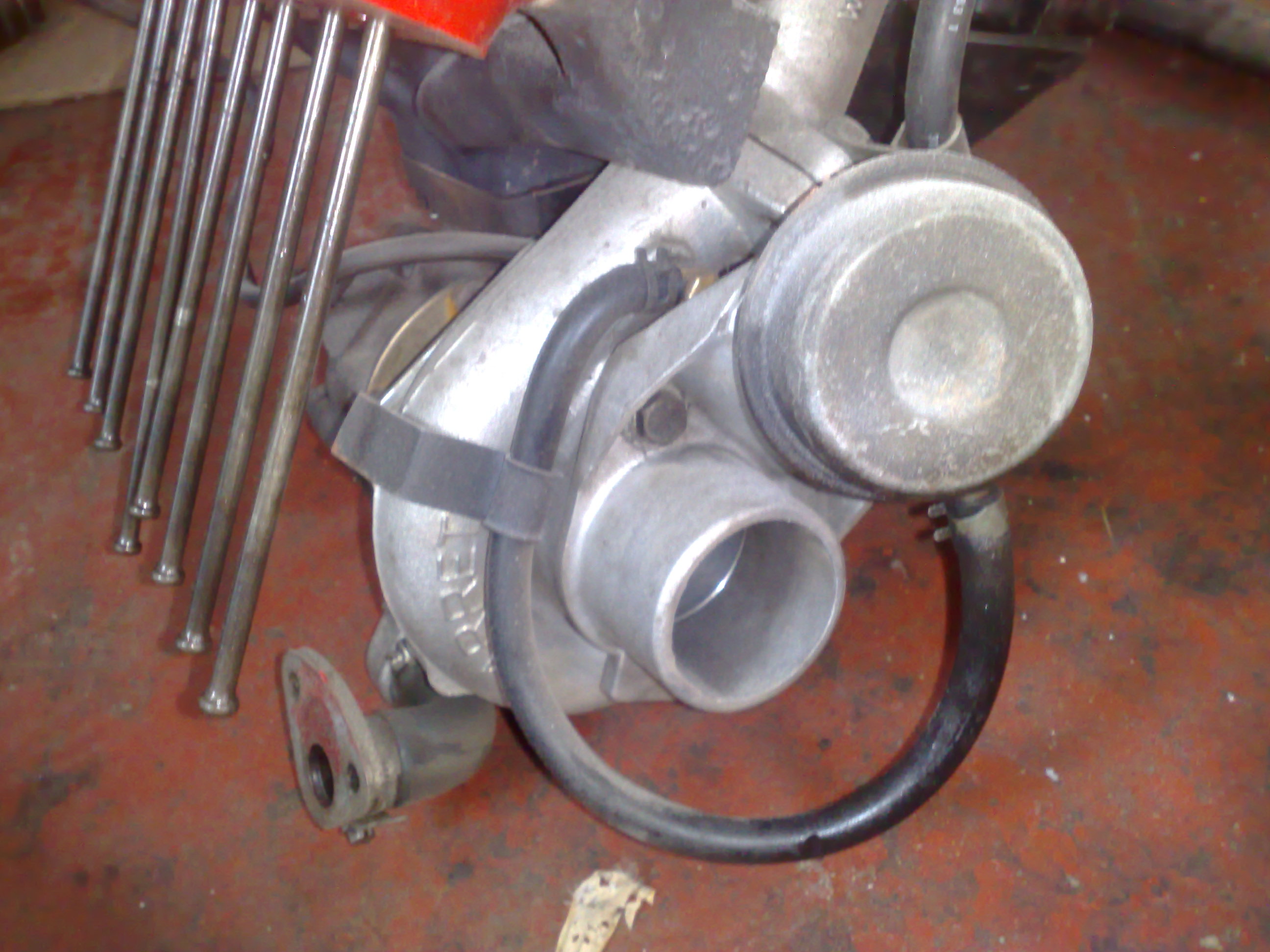

This is my turbo project. still miles off but am puttin it on turbominis for a bit of inspiration to finish the damn thing. had it 6 months now and have finally got round to starting it again.
The engine spec is,
+20 thou overbore to 1293
omega 10cc dished pistons
st4 camshaft and hardened followers (MED)
skimmed flywheel
comp clutch
highlift rockers
high capacity oil pump (MED)
Garett t3 turbo
High boost carb needle and spring
hardened and balanced crankshaft
balanced con rods
The plan is to go for big power while the Shell looks fairly standard.

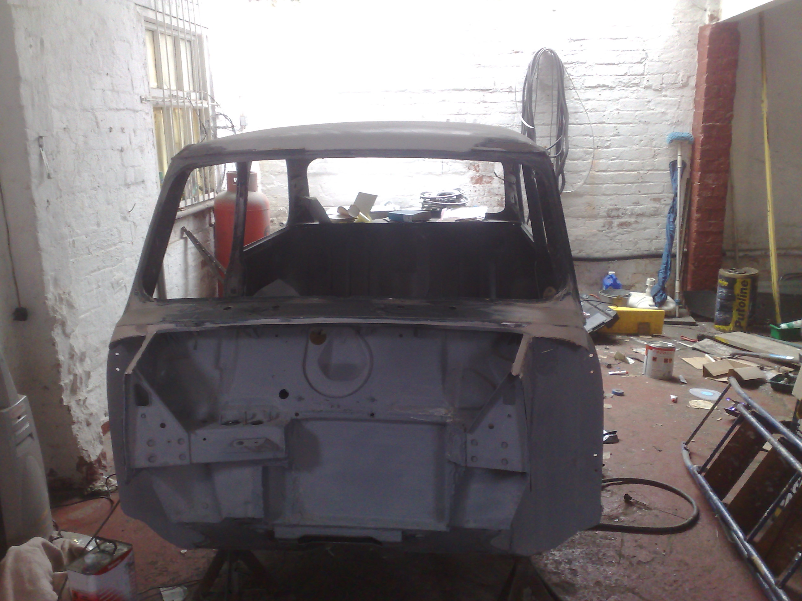

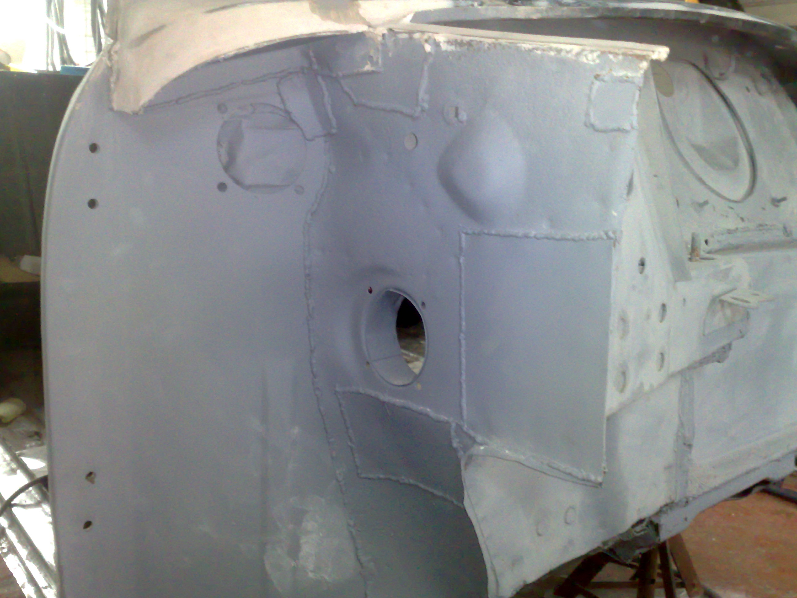

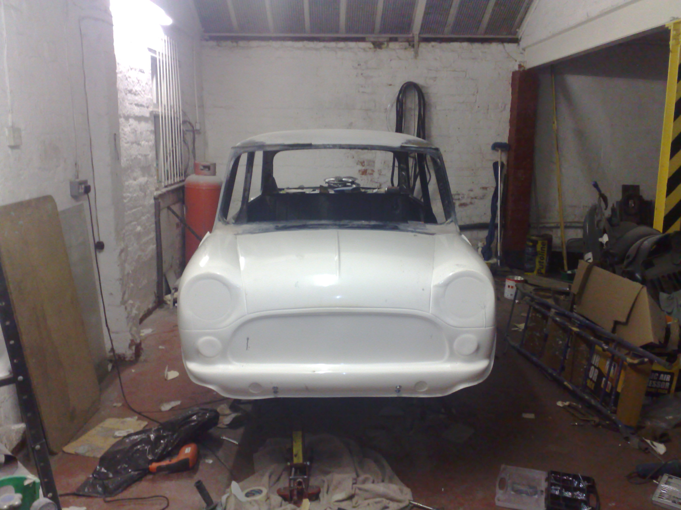

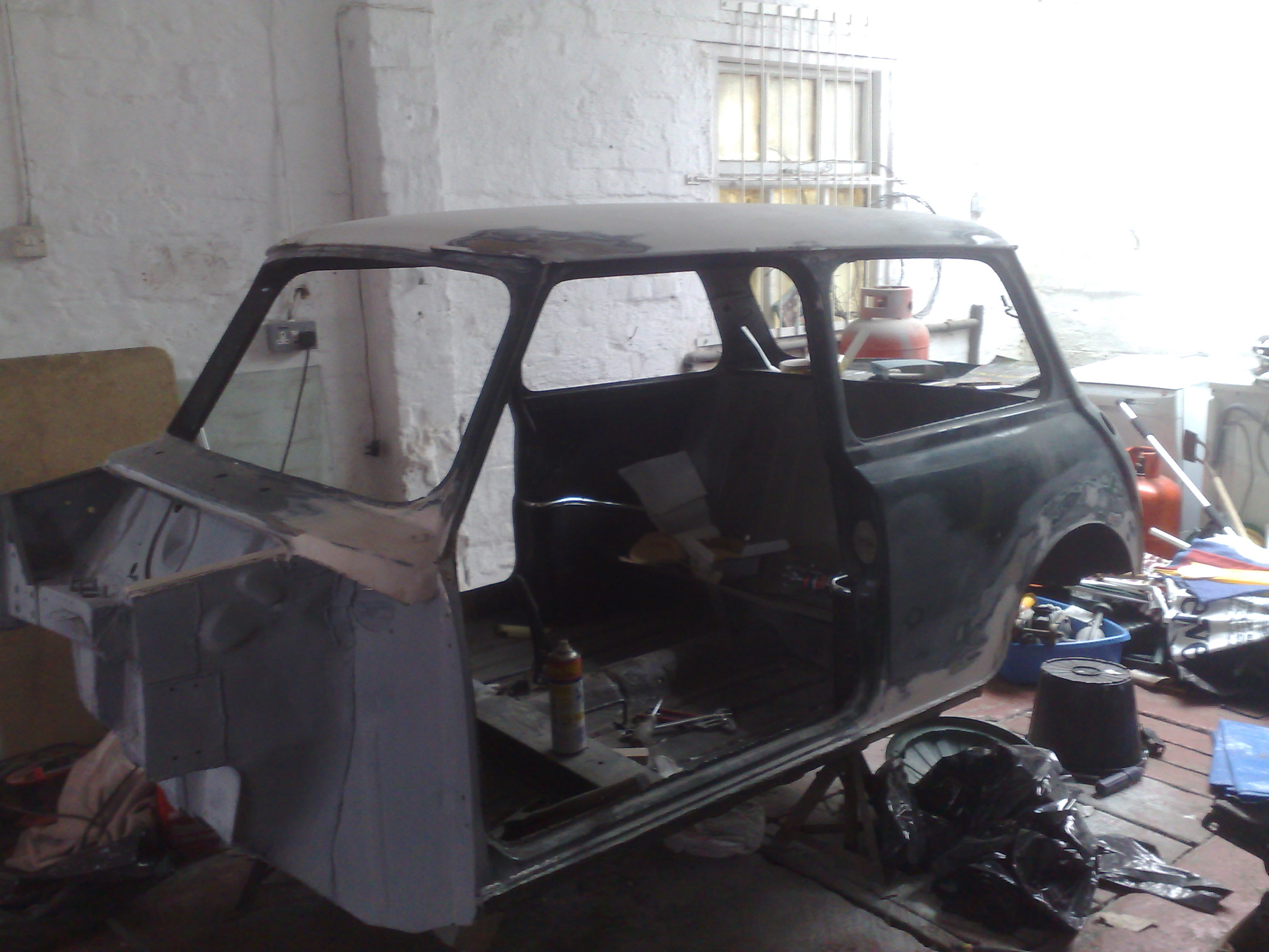

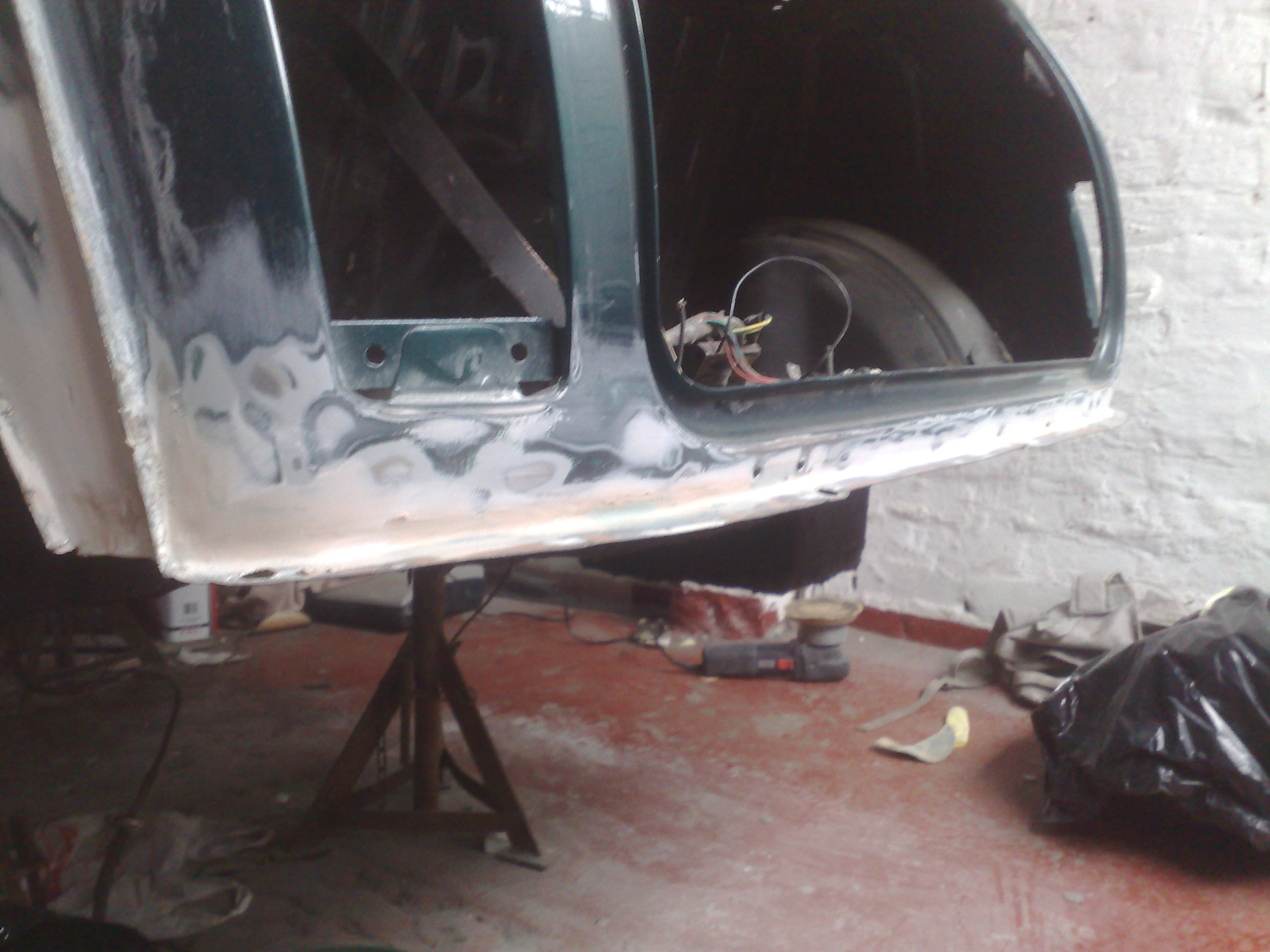

some pics of the sorry looking shell. Will upload more as soon as my project nears the painting stages.

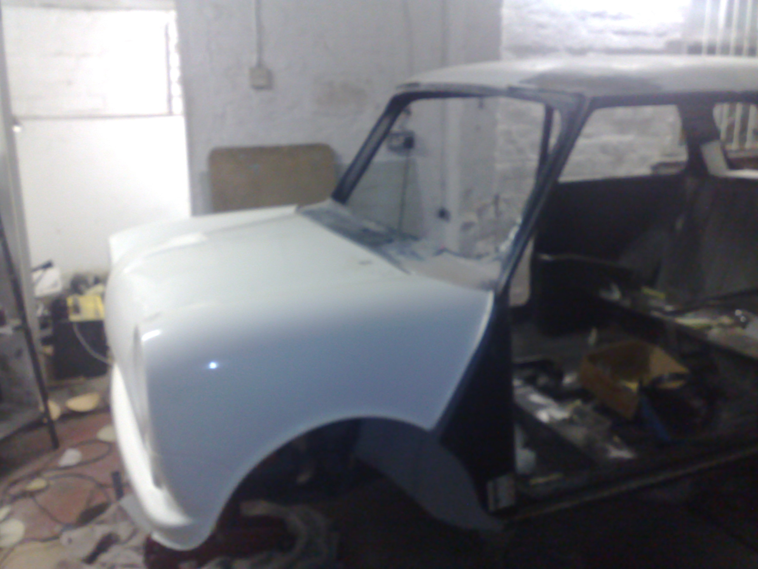

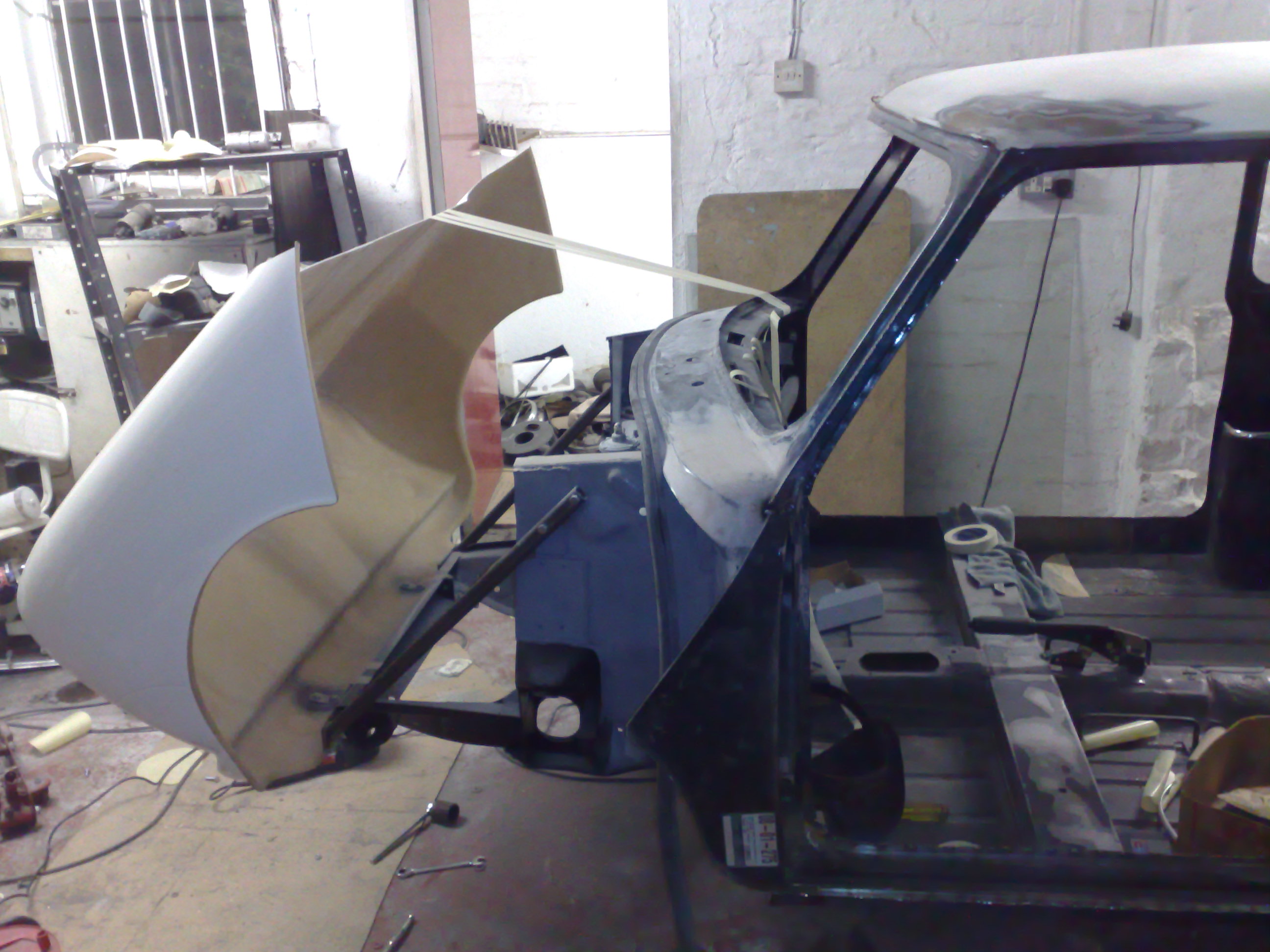

Anyone have any advice on fitting a fibreglass flip front? would it be best to fit the front subframe with the engine. line up the a-panels with the flipfront weld them on and then remove the engine, subframe and flipfront and paint the whole car as one? has anyone had any problems with the fibreglass fronts becasuse the edge that meets with the scuttle panel is not a gradual curve at all. Really want to have the car done by the 22nd of june to go to the blackpool mini day.
philc
1394 Posts
Member #: 1346
bromsgrove
i believe you need lots of sand paper and you make it fit to your car, lots of paitents
holmesgraham
107 Posts
Member #: 2556
Southport, Merseyside
A few more pic of the flip front!
holmesgraham
107 Posts
Member #: 2556
| cnt get the flipfront 2 fit. wel i can get the flipfront to meet with the a-panels and along the scuttle but its a stretch and would scratch the paint wen painted. have sanded quite alot off the back edge and am getting really close to the line down the centre of the bonnet. Any advice would be helpful.
I found lowering my standard really helped in getting a fit that I was happy with.
I can't offer much advice other than trim a bit put it back on, have a cup of tea whilst trying to work out what bit to trim next, then trim bit more. Repeat the whole process until you run out of tea bags, then buy some more and carry on with the above mentioned process.
Thats what i had to do, i really wanted a perfect fit but i found it nigh on impossible. Had to make do with the best i could get it, i'm still not happy with the way it meets the A panels, the arch line is stepped so had to hide it with the arches, I used this for the wiring for the lights.

Thanks for the advice really comes in handy. have had a few days off so will go back to it and spend a full day playing with the damn thing.
graemec
940 Posts
Member #: 1424
Carnforth, Lancs
Pack it out forwards slightly?

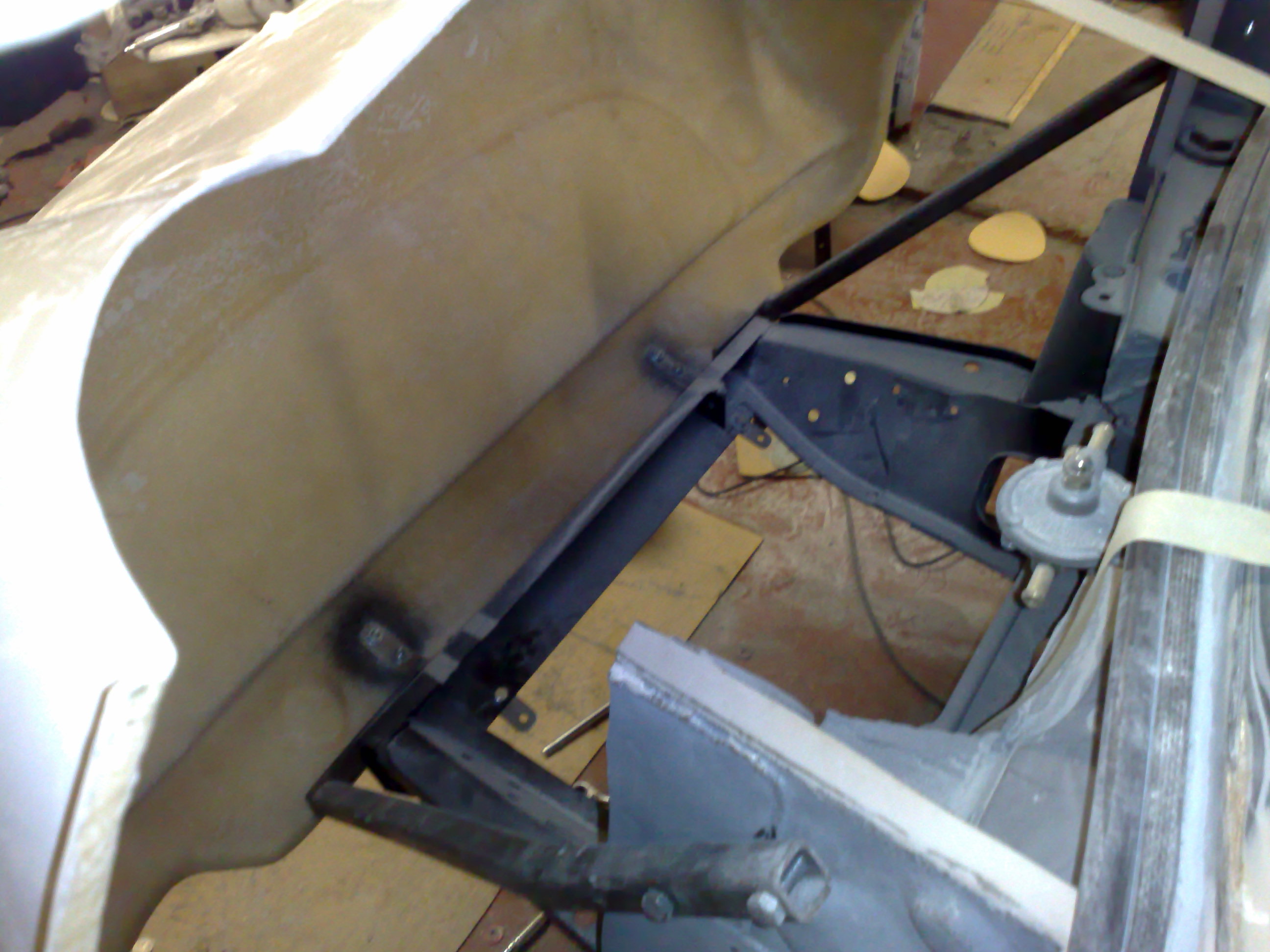

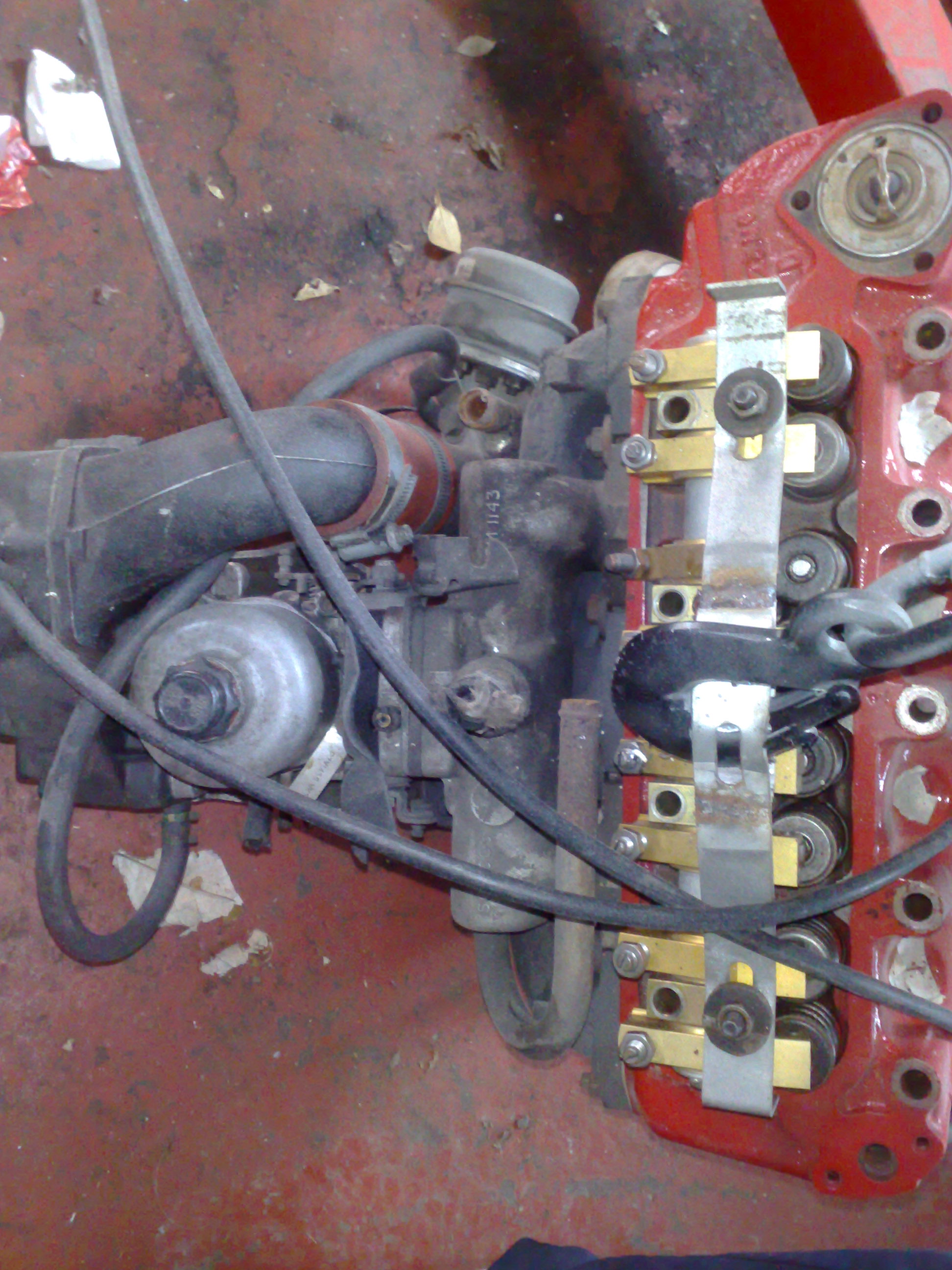

A few subframe pics

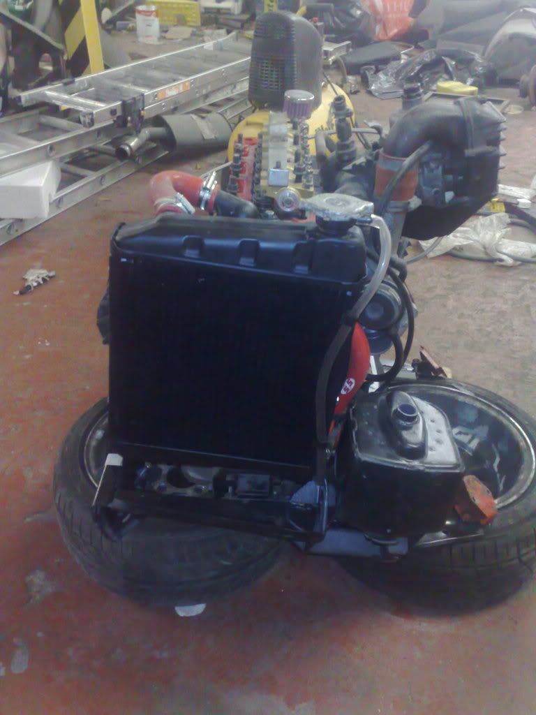

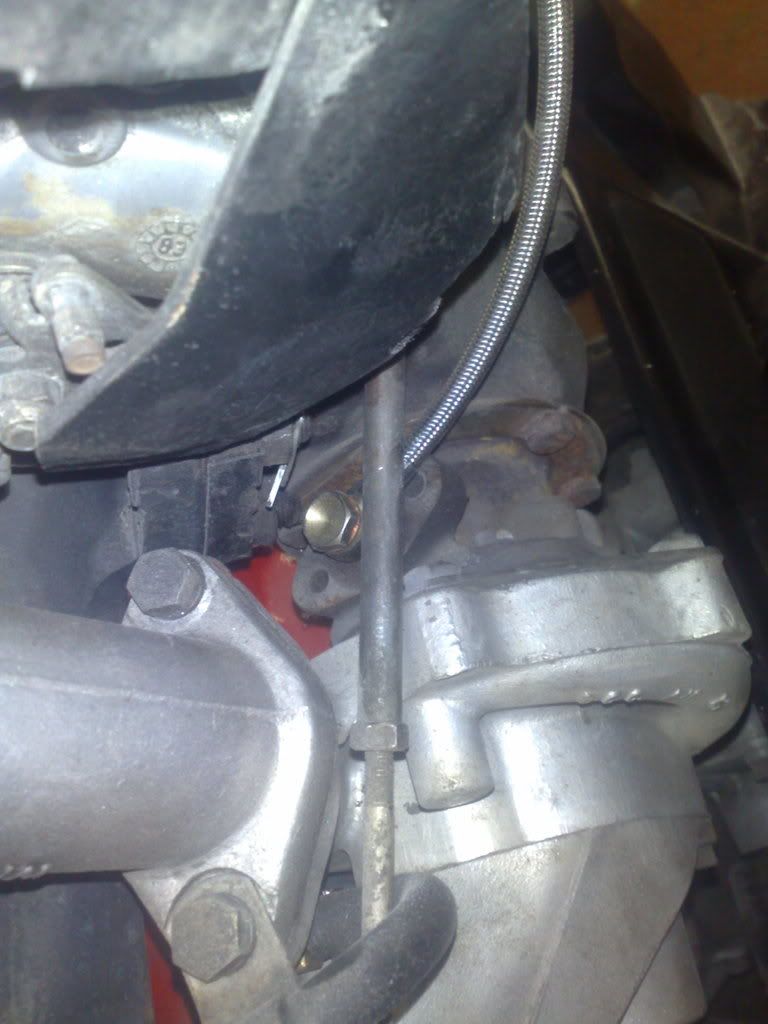

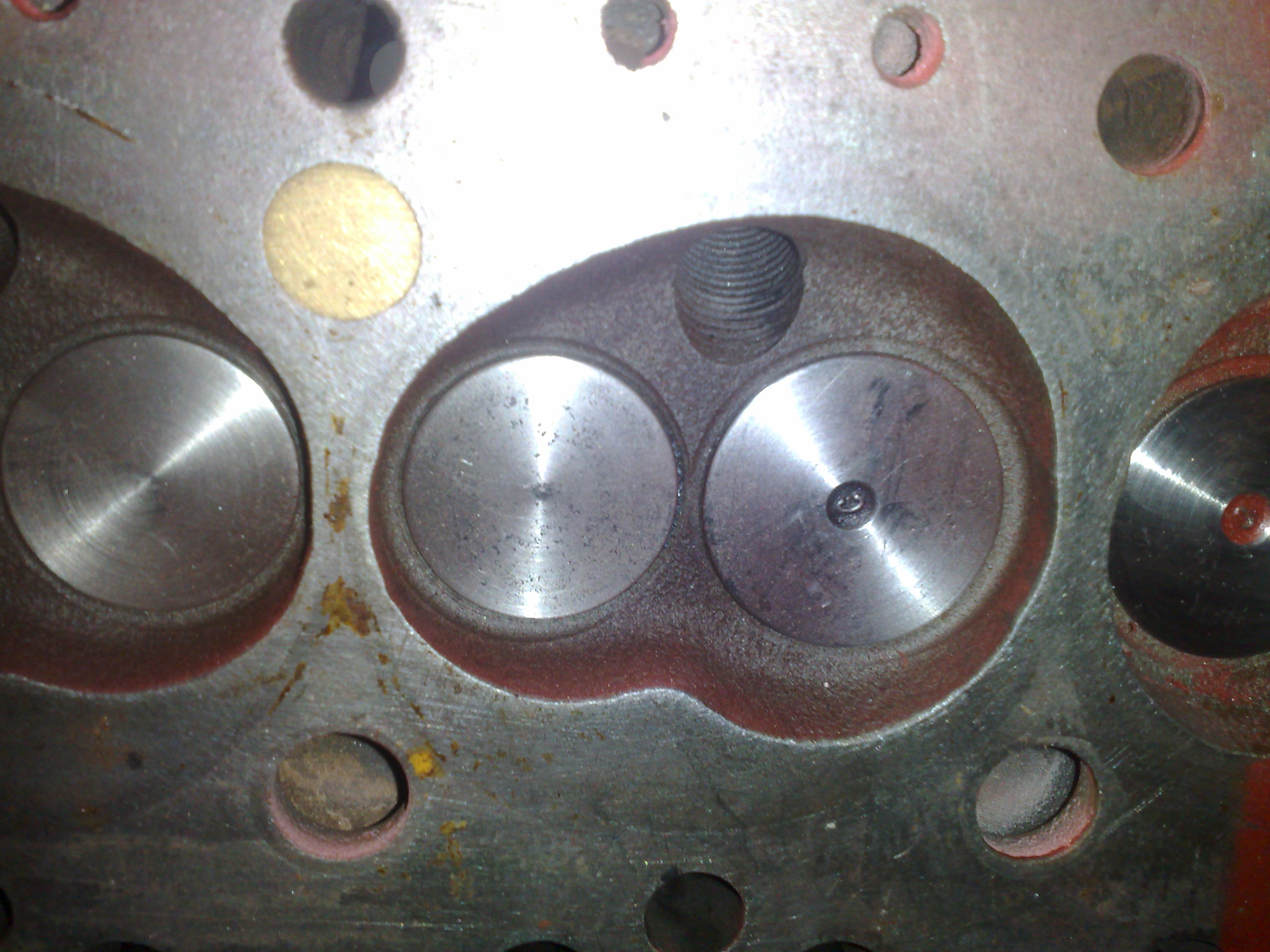

sum random pics
