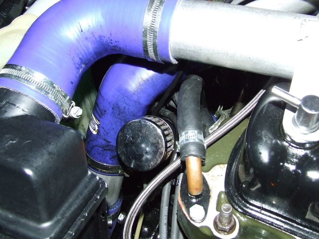

Got home from work, decided to get the mini out and clean it, then go out for a hack this eve, when comming along the duely i see a puddle of oil appering on the bonnet and wing, pull over and pop the bonnet and its oil ahoy everywhere! not obvious where it was coming from, but suspect the rings have shit them selves as it looks like it has came out of the crankcase breathers.
Will do a compression test in the morning and see.

for a start take them oil breathers of the top of the system mine got blocked quickly and squirted oil every were, i then removed them then it was ok.
but im sure its a bit more terminal than that though but worth a try

The breather on that side of the engine is a new one so thinking it would be ok, the oil is concentrated around the region of the breather tho, so am thinking the crancase has bee presurised? I was flat out an on full boost when this happened. oil level was a tad below full on dip stick, not over full. Need to sort out a few things for the house this morning, but will have a fudge around when I get back.

Im running two breathers, one from the timing cover and one from the flywheel housing.

tomorrow im going to disconnect the breathers and pipe them into an empty coke bottle, do a few runs up the duely one sencibly to see iff breathers spew out oil, then one on boost, just to prove where it is comming from. I have had a good look around and it looks like that is where it has originated from.
