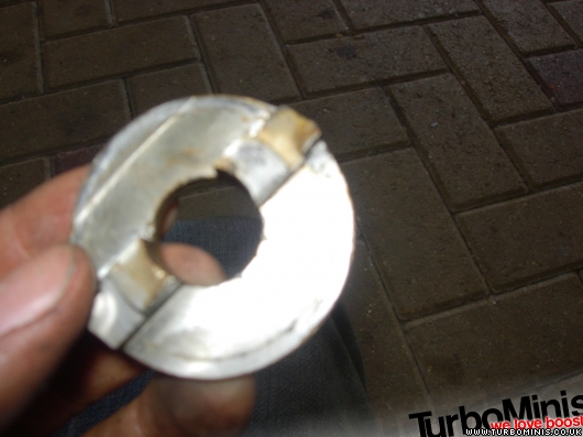

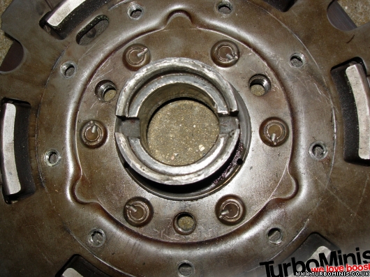

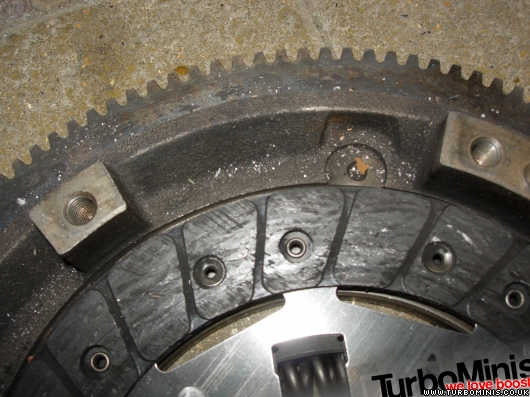

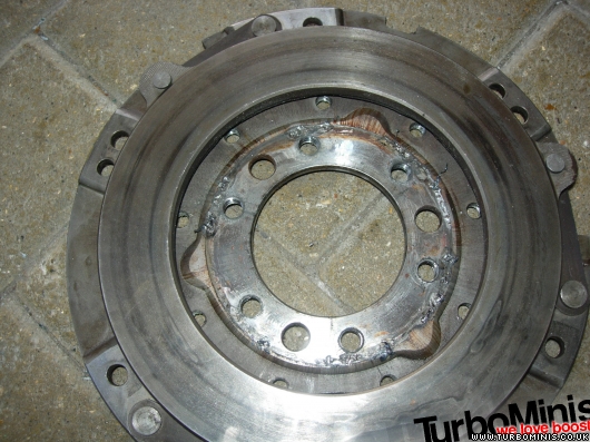

Well here's some pics of the clutch assy...it looks like the inner section has twisted from the outer? *surprised*
Note the blue coloured swarf between the two parts...
All of the bolts have rotated, but the notches on them were definitely aligned when it was put together...
Swarf...
Keyway starting to shear...
Not sure where to go from here TBH? *oh well*

Wow, never seen a key like that before, is the crank tail OK?
Paul
Hmmm,
so is the whole centre on the piss (it looks like it in the 2nd pic) or have the bolts just come undone?
I'm sure have a spare inner and bolts if you need them.
Paul
It looks ok, but towards the end (last 3-4mm by primary gear) has picked up a little, bu should clean up. They key was brand spanking new when I fitted it.

I don't think it is? I'm going to take it apart now and have a closer look.
Which verto cover did you use? Mine is flat and the same thickness all the way across. Looks like that one is pressed from thinner material.
I dont like the look of the threaded part where it has been pressed to give a longer thread depth.
Those bolts have to be torqued up very tight. If you just aligned the original staking marks then they would not be tight enough.
I would find a better cover and start again.
I'm worried about the keyway, was the me main flywheel bolt still tight

Matty I had this problem with the clutch on my rev'e 998 remember the thread:
http://www.turbominis.co.uk/forums/index.php?p=vt&tid=277858
I Know the bolts on mine where FT and yet the came lose in exactly the same way and crazily My keyway looked exactly the same I taught the flywheel bolt had come loose but I had used the after market retaining bolt torque to 170FP and it took at least that to loosen it.

Paul S - The clutch cover is one from a turbo clutch and the bolts were't touched from the factory? I suppose it is possible that they were removed and replaced at some point in the past but there was no evidence that they had? *oh well* Any idea on torque figure for these?
Jim - The bolt was still tight when I removed it, but I did oticed that when they flywheel came off it did't make they usual massive bang that it normally does. This could be down to the fretting near the top of the taper?
Paul H - When it goes back on im going to wang it up as tight as I can get it!

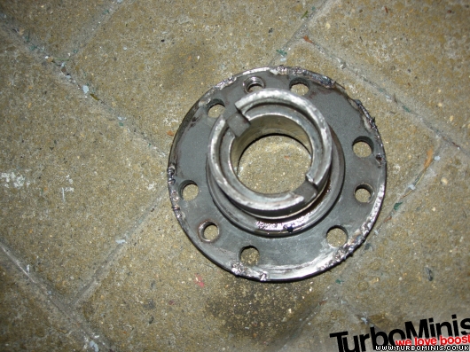

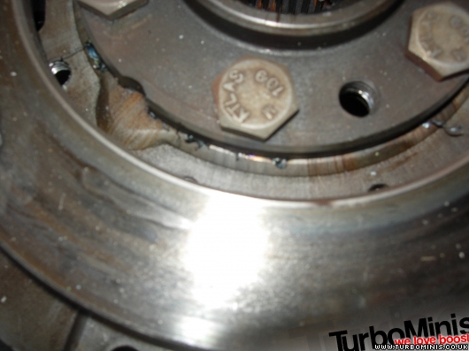

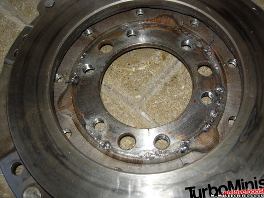

More pics...

It looks as simple as the bolts backed out a little and some friction welding accrued. Would think you might need to mate the taper a bit better on the crank next time with some grinding past maybe?
On 17th Feb, 2009 Rob H said:
How thick is the cover?
I've just measured three and they were 5mm, 6mm and 6.5mm. My RTS is made from a 6.5mm cover.
I reckon that you have suffered a bit of torsional vibration due to those bolts not being tight enough.
That has lead to the crank taper and key damage.
I cant find the torque figures but I do remember reading somewhere that those bolts should not be re-used.
