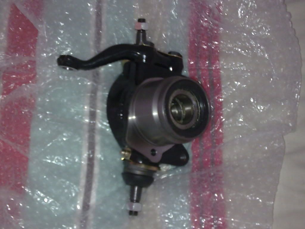

Ive received a few more bits for it through the post, so ill post a few pics up.
A pic of my shiny new hubs
My soon to be shiny 4 Pot Callipers and drive flanges
And ive got a few questions about putting the asssembly together. Do the flanges just slide into the hub? Or are they bolted to the disc? Or if anyone has a picture of a complete assembly they could post up id be very grateful.

Hi, The discs bolt to the flanges then the drive shaft slots through the hub and then through the flange/disk then you put the washer, castle nut and split pin on the end.
Out of interest where did you get those new looking hubs from?
I found them on ebay
http://cgi.ebay.co.uk/ws/eBayISAPI.dll?Vie...em=270404073787
Very tidy looking and ridiculous amounts cheaper than buying them over here. Not fitted them to my car yet but certainly look the ducks nuts.

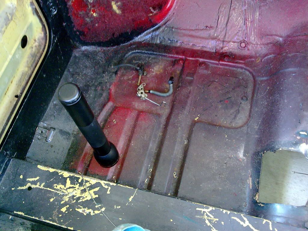

Hi everyone,
Did a bit more work today, Got the front subframe off and stripped the old drum brake hubs off that.
Engine bay before we started
Original subframe looks in pretty good condition, just dirty. A karcher fixed that pretty easily.
And the new hubs fitted on the old subframe. Very much liking the look of the new brakes.
I ordered all of the brake parts today, so they should be ready to go in a few days. Think ill put them on the blue one to bed them in and keep them from seizing.

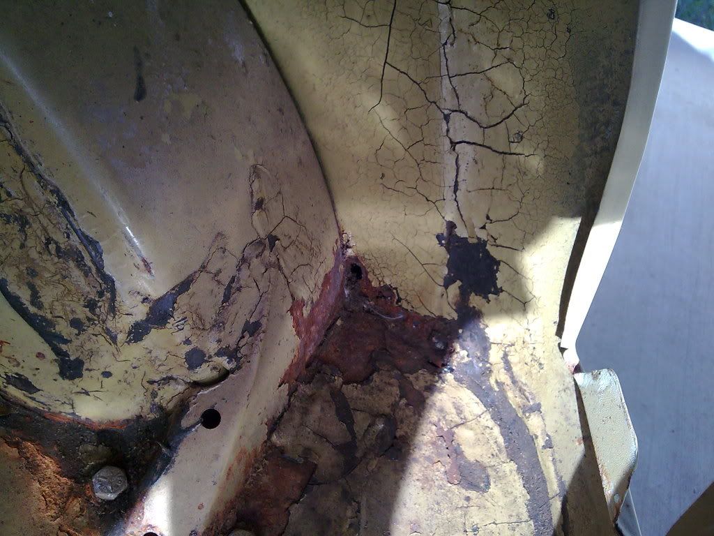

Took a few more pictures of the shell, found a bit of rust in the boot.
Everythings going pretty smoothly atm, but not thought about electrics so its going to get a lot worse i think lol.

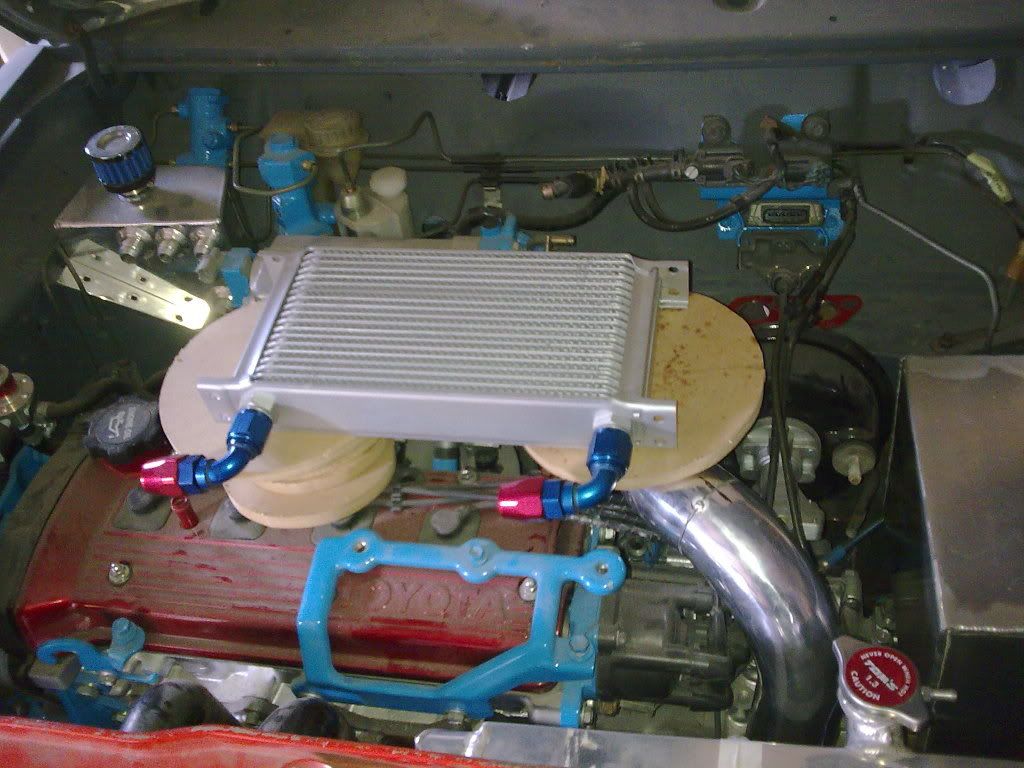

Hey everyone
Done a bit more work on the mini, and bought a few more parts.
Got myself a whole starlet for less than the cost of a halfcut, which i was quite pleased about. Got a few pics here. Just got a few small dents lol.
And the most important part, the engine. Looks pretty crowded in there.
Doesnt look so crowded in a mini

Looks factory apart from 'Toyota' on the rocker cover *wink*
