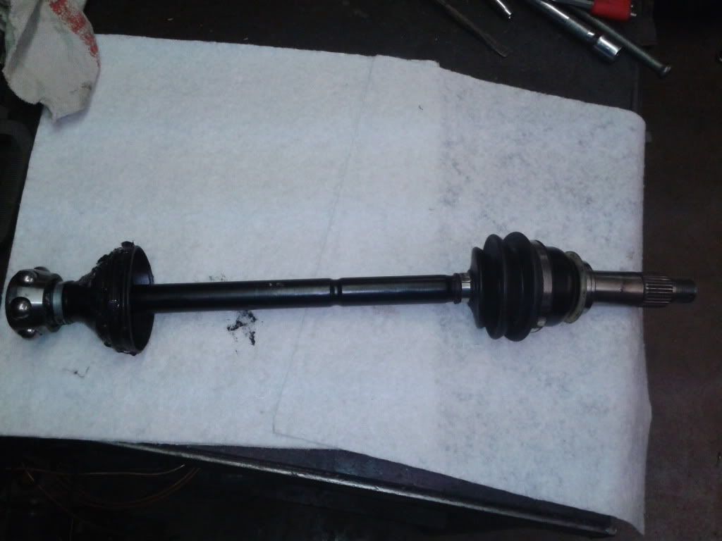

noticed that it looks like the drive shafts are to short and come out too far out of the inner potjoins...

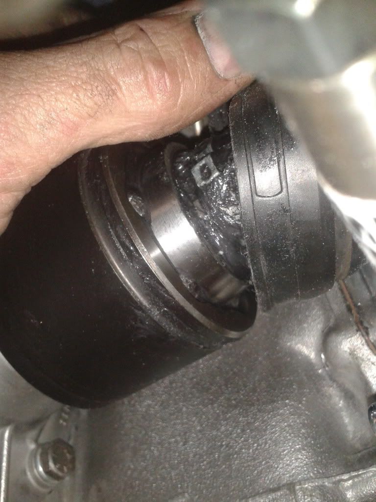

The outer outer ball race is just coming out of the pot joint.
Outer ball race is mounted correctly. the lower adjustable arm is turned incompletely to the end, and its stil to far out, ( if i turn it ou the problem gets bigger)???!! ( got the problem on both sides)
Driveshafts mounted on the correct sides :)
got the alu kad hubs, do i need different drive shafts?? or can there be an other problem??
hope someone can help me out....thanks

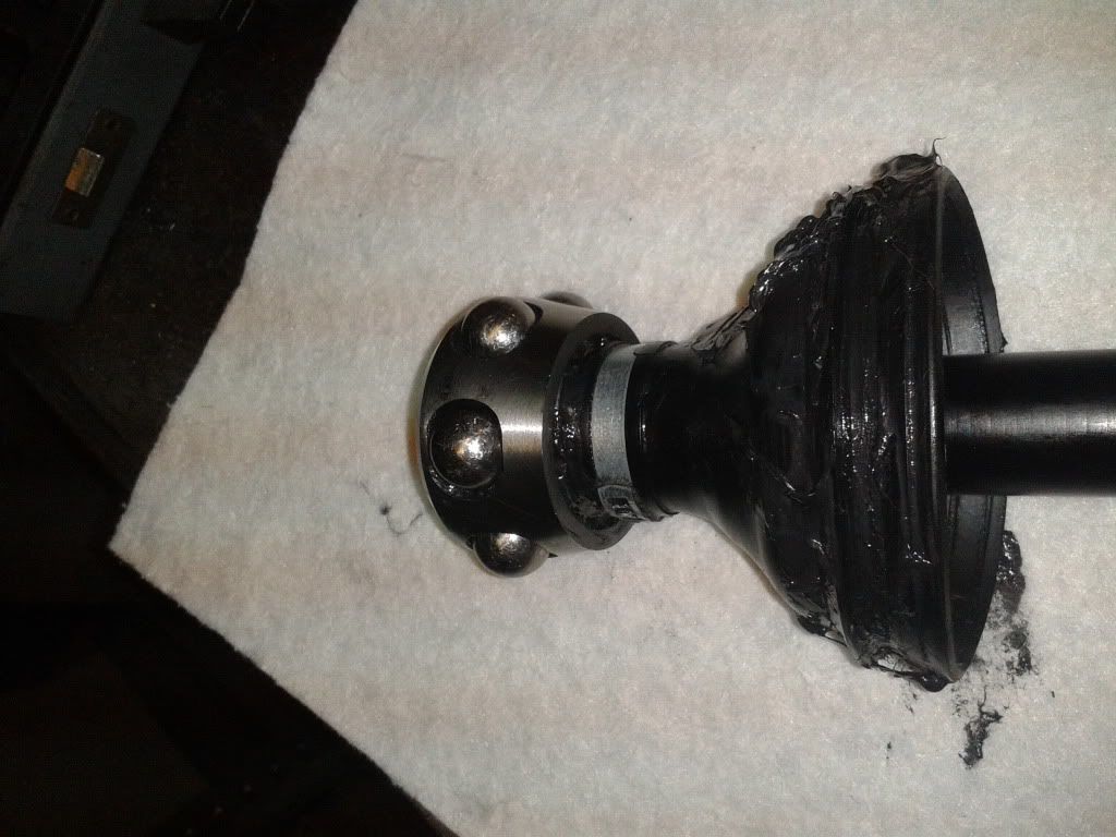

you need some better pics up, what is with the welded on ring, also i don't recognise the inner parts of the cv that are in view.

the face of the housing looked like it had a plate welded to it, but now i see that what i thought was some mig weld is in fact the balls hanging out,

Carl I think your looking at the steel zip tie that holds the boot on

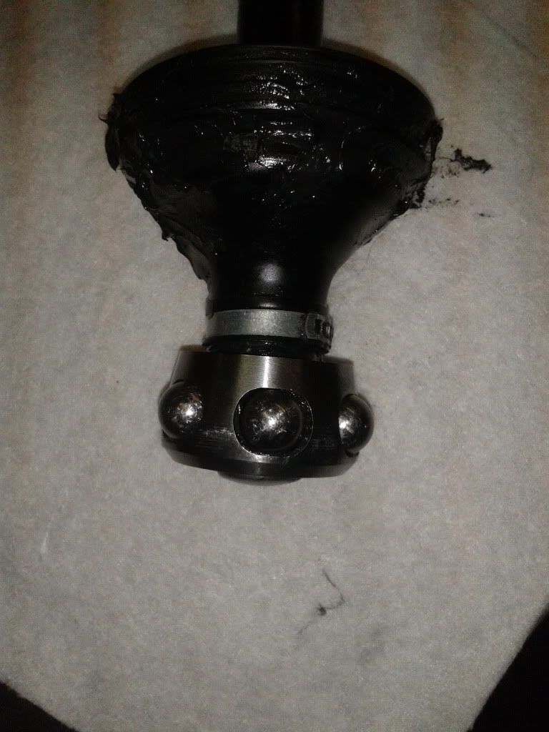

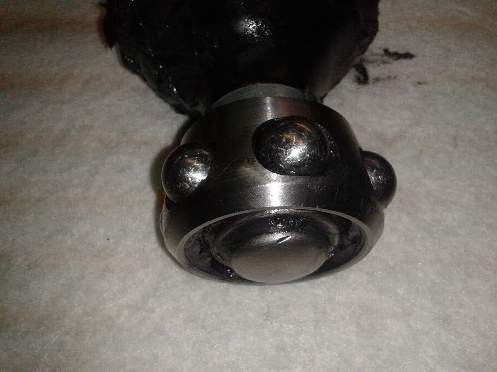

some more pics.... i can't notice anything wrong ??!! *Confused*

In the very first photo the outer part doesn't look right.
Any chance of a better photo of the outer part ???

In the very first photo the outer edge looks like it's been machined ???

looking at the pic above there seems to be a bigger lip after the rebate is this your problem making the pot joint shorter

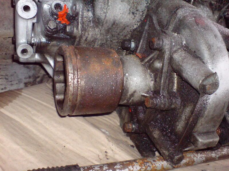

Inside view of a couple of standard ones, balls are frightenly close to the outer edge anyway from the wear marks,
But no evidence of the machining marks on the very first photo (ignore my nachining at the back face of the right hand/top one, that's for the TC sensor ring)
The outer edge of the very first photo just doesn't look the same.

That first photo looks exactly the same as this one. I see why you think it looks machined but that is just shadow, look at it closer, you can see they are the same
EDIT, look at the profile against the silver of the casing
