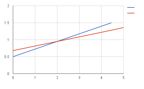

Just checked again and while on the Lambda Input page live, I see the voltage fluctuating as well which I think means that even if I had more or different reference points, the sensor output still appears to be fluctuating greatly.
If am reading correctly from the 14point7 documentation, these are the values that should be in place:
Green Linear Output
Interfacing device; ECU/Gauge/datalogger/etc...
0[v] @ 0.68 [Lambda] Linear to 5[v] @ 1.36 [Lambda]
, equivalent to 10-20 [AFR] for gasoline fuel

Unless they have a WBO2 controller with a custom calibration different from what is used on all other 14point7 products, the calibration you initially mentioned is way off. The one in your last post is the one that is used in the normal 14point7 products. And looking at the picture you had sent me, it does look like the standard Spartan 2 which I doubt would have a custom calibration.
Using the wrong calibration would make any small AFR variation look much bigger and trying to use it for closed loop would not give good results not to mention that it would not give you the AFR you want.
And from that, I too would be suspicious of any calibration they provide. Fortunately, a temperature sensor is a lot easier to check with room temperature and boiling water.

Calibration, as per Jean, the later figures look right, not the first ones you were given.

On 23rd Apr, 2016 tmsmini said:
I initially was trying to use an Innovate LM2 for AFR, but I switched to using an SC provided wideband sensor which is actually a 14point7 controller. This at least allows for the values to be viewed in the same interface. It seems the sensor configuration is not right as the lambda value is bouncing all around.
I am thinking the Lambda Sensor Input Scaling table is incorrect.
It only has two values
0.00 = 0.50
4.45 = 1.50
It almost seems like the wide band acts like a narrow band, maybe when it is in closed loop it does that, going high and low.
Input 0V ---> means Lambda 0.5 --> 7.35 AFR
Input 4.45 V ---> means Lambda 1.5 --> 22.05 AFR
The measuring range is between these values.

I sent an email to Innovate and already received a reply. It is out of warranty, but they will evaluate it. I think it has had issues all along and they have just been getting worse. Initially I thought it was due to the use of the tailpipe clamp, as the values were not consistent. Even using the ports in the LCB manifold, the readings were inconsistent. And certainly there was a difference between inner and outer, but that is a different story...
Assuming the responses from 4.2 and 4.9 are linear which means they only need two values and the software interpolates from that, the attachment is the values in a simple graph.

The response from the sensor is not linear but the output from the controller is. So you indeed only need 2 values to fully define the output.
And the 14point7 controllers use the same output calibration regardless of the sensor used (as long as you use the correct one). Note that there is an exception for their lean burn product which has its own specific calibration.
