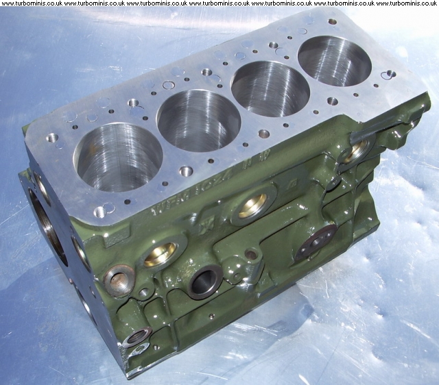

A couple of teasers sent to me by Mr kimmins. *tongue*

Mmm, tasty! :)

It'll be a shame to get it all dirty!

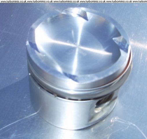

what pistons are those?? im still looking into the possibility of using bike pistons.
What a beautifully painted block... Someone forgot the core plugs though...

Look closer v, Theyre there but the smart bloke never painted over em.

i prefer bits like that unpainted to be honest.
Looking very smart!
Yes, I see that, just cannot understand why he's forgotten about them :)
Pickmeup thery're Omegas forged pistons.
Yeah I thought I'd go for BMC green as I want it to be a powerful engine. *wink* *tongue*
TBH I prefer the core plugs being nice and shiney.

got to have a bit of bling in there hey matty! *happy*
I also prefer the plugs unpainted. Matty your loosing at least 10% of your power painting it green!

Sorry, got to disagree with you there. BMC green is the original power paint so will give an increase of 10% in the banana stakes!!
