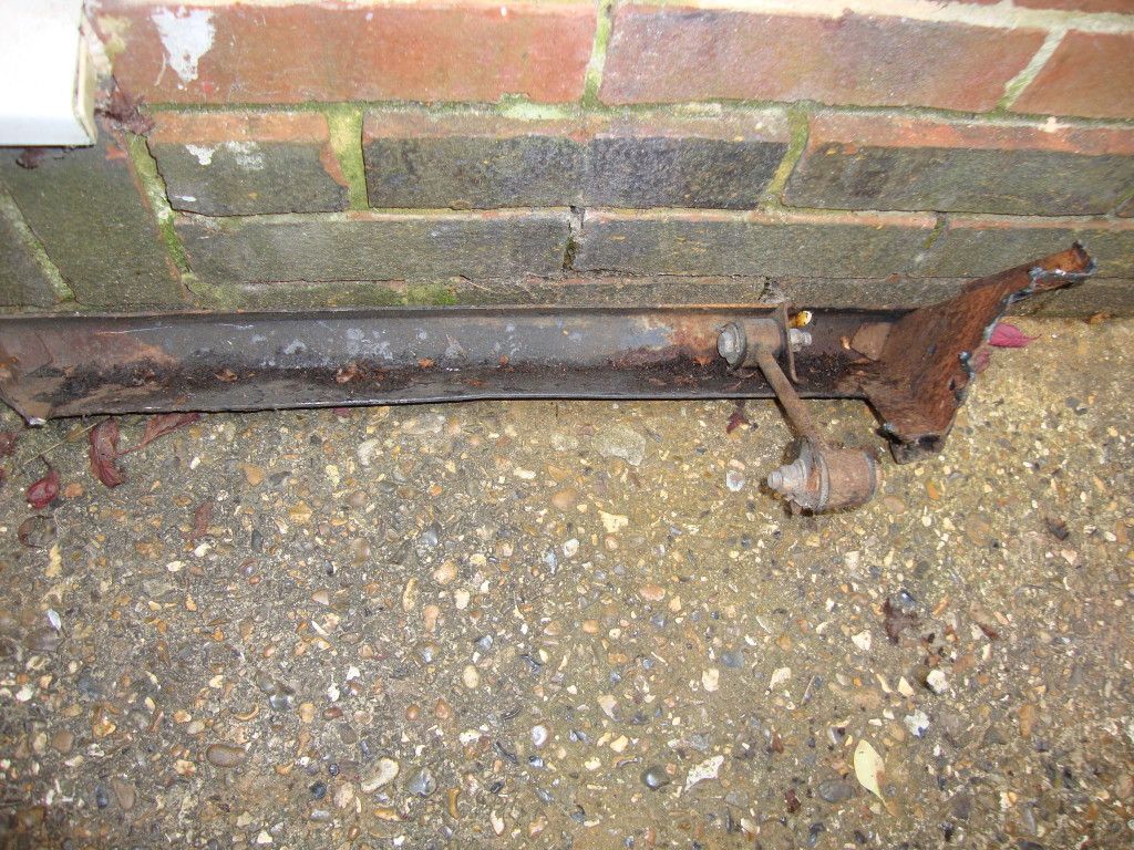

It has been full steam ahead today, I went down to the lockup to get the old subframe out that I started last year.
When I was back on R&R I had the chance to get half of a subframe that I could use to fix this one with. When I got the mount of the old bit of subframe I gave it a good clean.
I cut the old mount off and then set about welding the new one back on.
Then I seam welded the whole subby and I sort of wish I had had it dipped cleaned, cos when I was welding it all sorts of gunk was leeking out. So I had to keep stopping and clean it as it was f==king the weld up. I know it looks very agricultural in the pics but I will sit and dress this up in time.
Then I made some gussets.
Now I am in two minds, can I cut this bit back?? as I will be using coil overs it's not needed.
Then these little babies turned up nice work as always.
The little box of TI bolts is starting to fill up.
Thanks simon.
