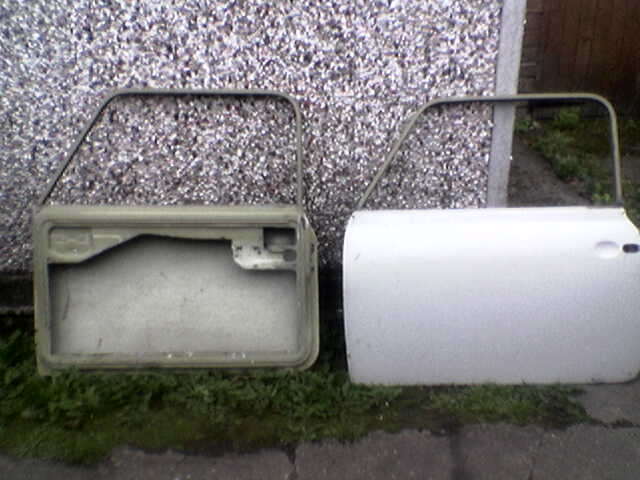

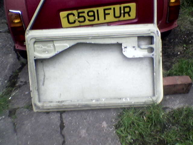

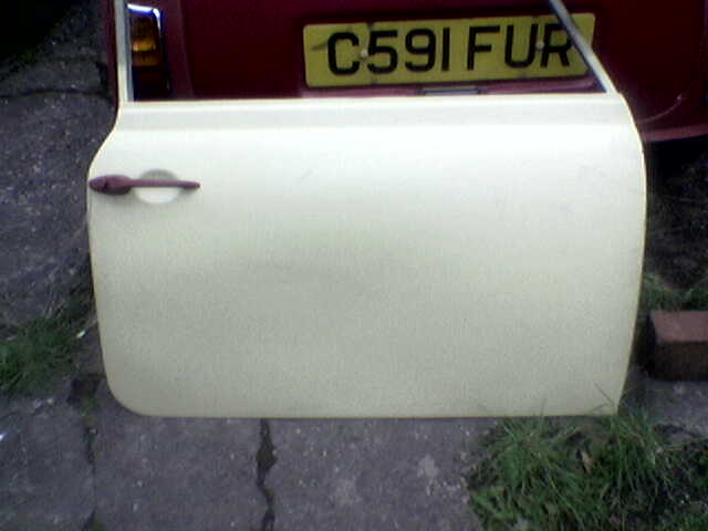

some pics, opinions on my doors plz chaps

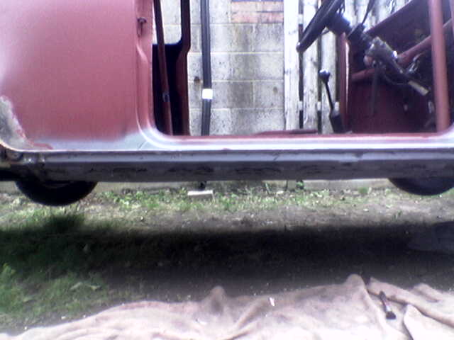

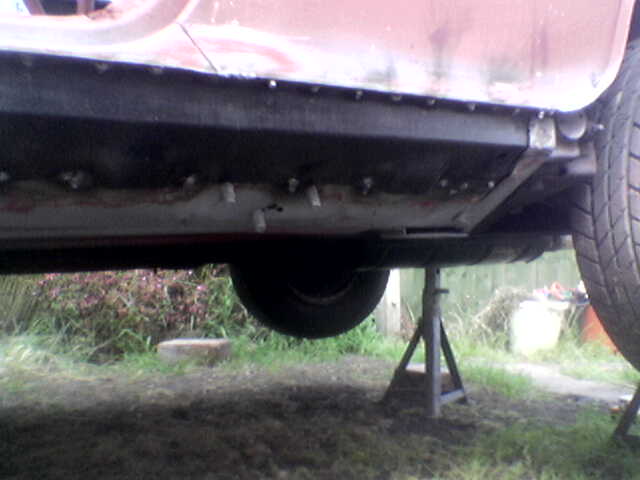

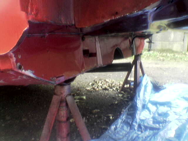

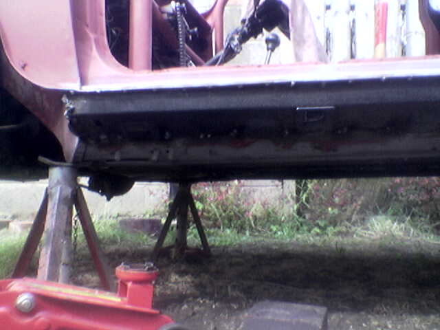

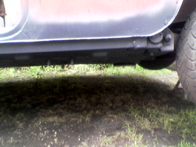

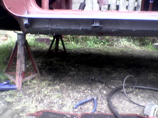

got my sill on, just some tiding of the welds! seam sealing & paint, i used genuine sills, alot easier to fit i must say, needed some minor inner sill repair too, i did cut a rectangle out & just wacked a patch on top, not the most professional thing to do i know & it aint tidy so not happy but have to many other bits to do so its solid & i may re-do it later in the year, hear are a few pics

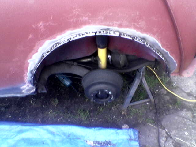

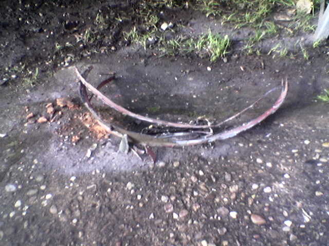

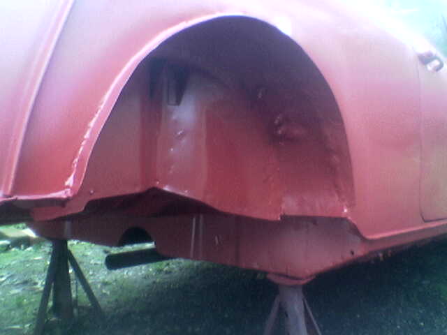

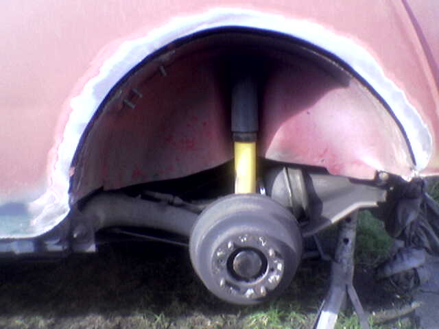

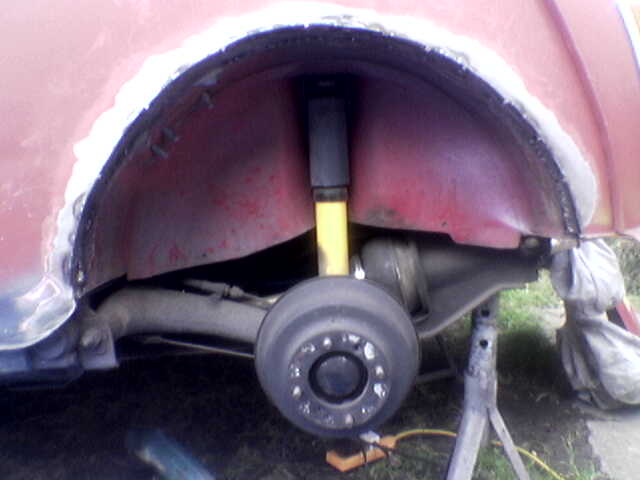

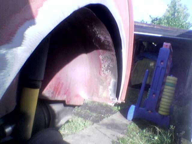

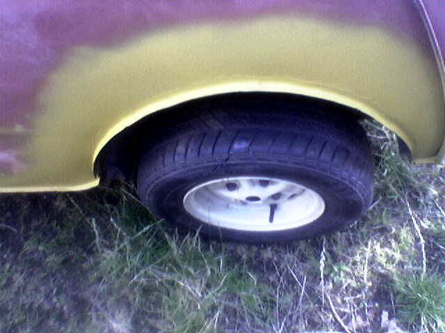

yes! well in the gaps in the weather when i could work on the mini i finished my sill & chopped my rear arch for tubbing, sanded relevant surfaces ready to weld my new metal in!!!!! looks ok to me i reckon???
woo hoo tubbed arches..............well happy!
other side to do & then i'm gonna try to drill the spotwelds & use the origianl rust-free steel front & flipfront it, as i have bracebars & hinges already,

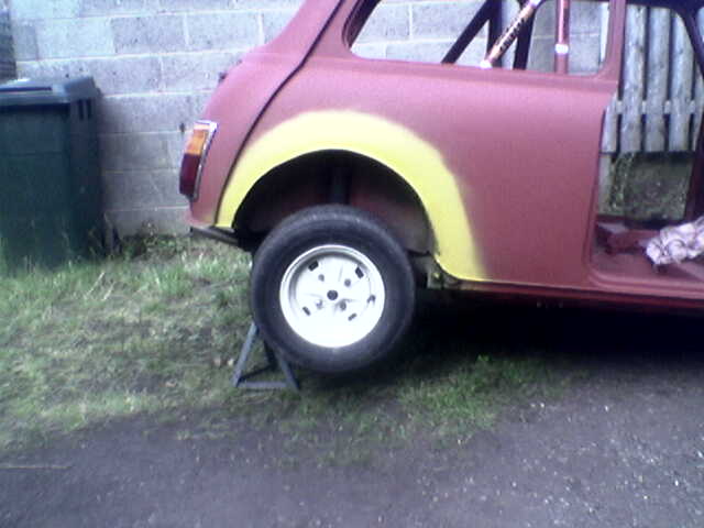

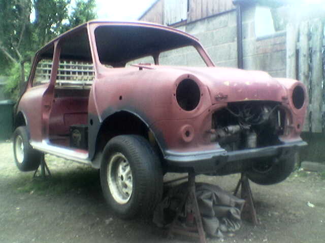

more done on my car, time is a bit of an issue but gettin there!!! still pushing & feeling enthusiastic, finished tubbing my arches, just have to do some filler work as its warped the 1/4 panals a little as others have said, not to badly though, my welding is'nt the best although not the worst (out of practice really) & i'm getting greaf from a neighbor about the noise but i really dont give a left testicle about the noise, i keep it to daytime so suck my small one!!!

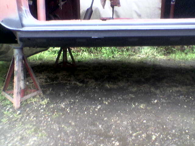

i've put two new genuine rover outer sills on it, inners were ok as were the subby mounts so alls good there, i used a zinc rich primer on the inner sills, inside the box section & stonechip over the top before welding the outers on, i know some of it will have burnt off through welding but some protection is better than none, i'll inject anti rust wax asap too! it should stop the brown stuff for a good while!!!!

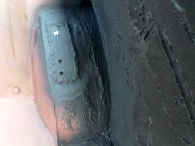

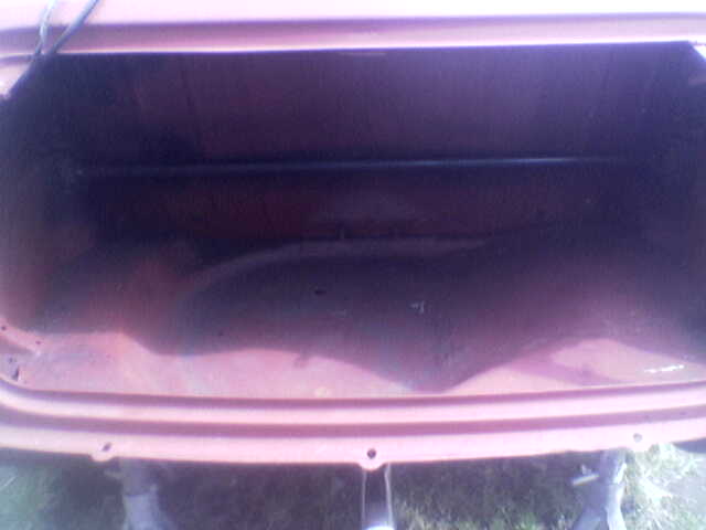

i've welded as brace bar that joins the wheel arches in the boot so should stiffen it up a bit, pics to come.....
just a few more brackets to cut off then the shell is solid & ready to prep for paint, that take me fricken ages as i've not the most patiant doing paint prep!

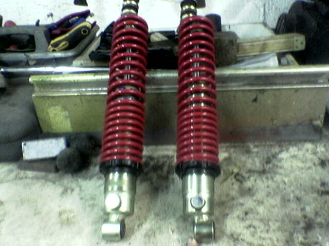

i bought some GAZ rear coilovers too as i plan to chop my rear subby & fit caster camber brackets, brained hoses & superfins, i know some say thgis is silly on a road car but i'm gonna try it, i have spare subby to convert back if its pants!
heres a few pics, comments welcome

as usual i have know clue of the spring rate on mycoilover so i'll have to try them & see

then i'll bolt my doors on & flat it again, doors need a little prep anyhow! & the interiour & boot area need a quick once over with a scotchbrite pad,

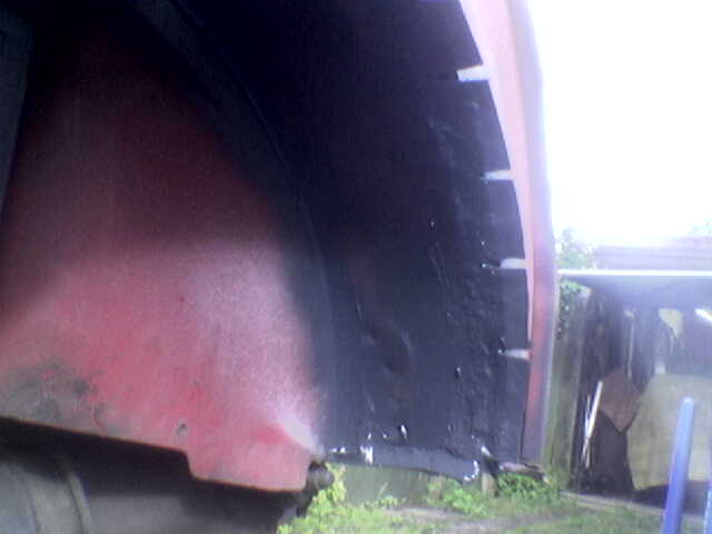

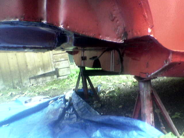

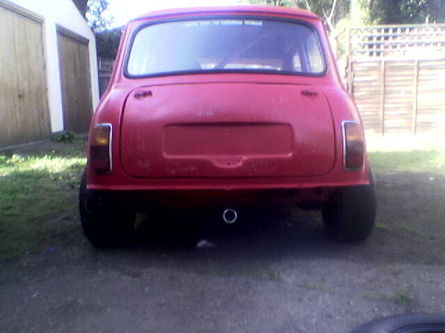

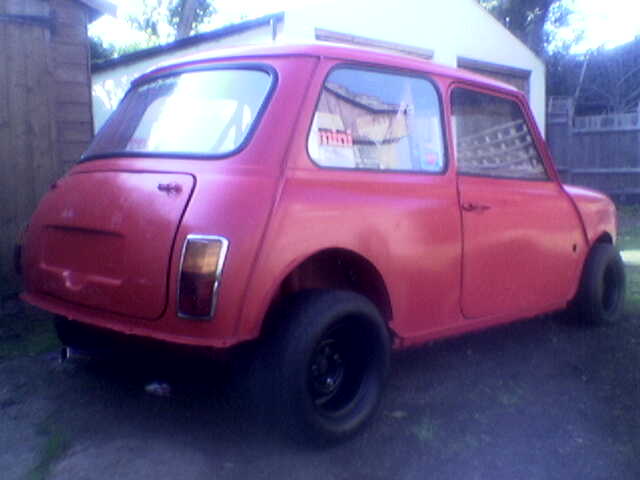

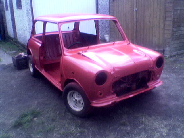

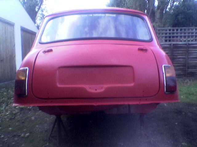

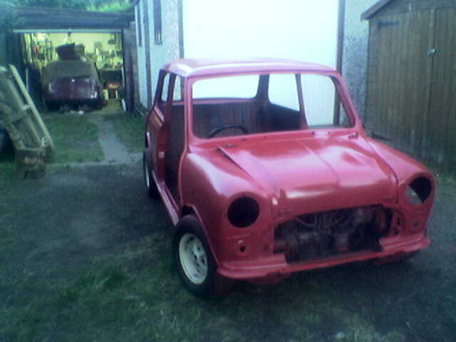

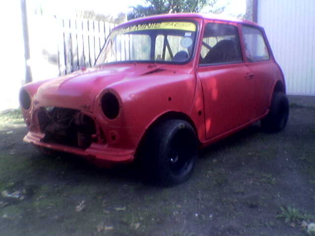

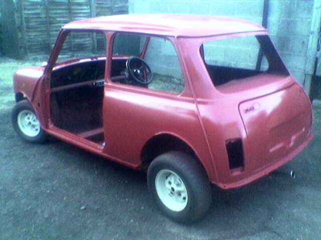

well some progress made in the bodywork department! managed to cut weld & repair the mini where needed, tub the arches & cut of any metal that is'nt structual or needed for a purpose!
a basic body prep & paint has followed in SATIN RED 2pack & the results! well i'm not that happy, i feel it looks SHITE, it looks toooo shiney, like a crap gloss paintjob, i should have bought matt finish paint i.e trusted my instinct! but.... i cant go back now so it'll have to do, i'll make it look ok-ish i'm happy with my shell in the respect that its
rust free
stiffer
lighter

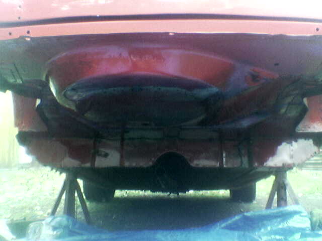

brace bar in the boot, tacked in!!!

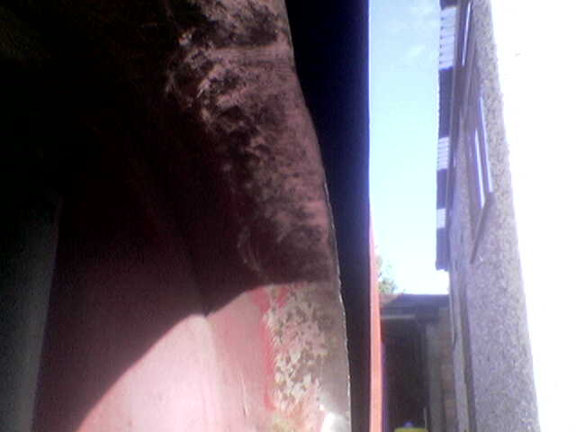

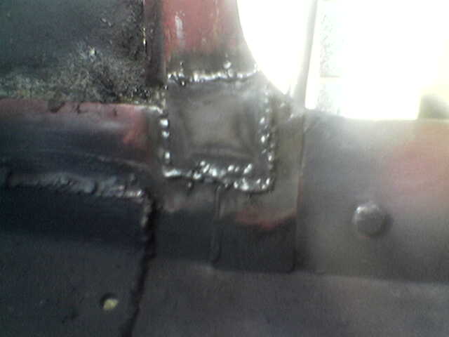

B posts tied into the sills, not great welding take the piss if you want *tongue*
is waterproof
one colour inside,outside & under the arches & sills

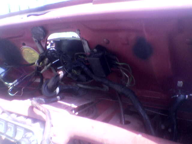

my wiring harness & fusebox etc is in the cabin rather than the engine bay woo hoo!!!
some pics below!
my wheels i'll tart up & may put some sort of stripe on the shell, we'll see..........

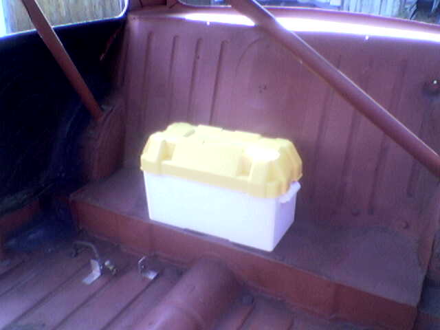

more pics, i also aquired a battery box with enough room for 2 bottles of water, yes its a caravan battery box but it was £8!!! that'll do me!

oh yeah! all this has been done outsideon a gravel entry!!! in the rain, painitng was inbetween the showers or when blistering hot with the airline kicking up dust & me flatting the bugger after so alls well, not happy in the paint colour/finish but happy in the progress & improvements i''ve made, i'm getting there!!!!

& one of my sills before paint

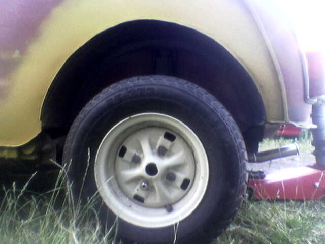

i got me some more innocenti reverse rims too in black!
strange tyres on them too 145/80/10's
i think i'm developing a steel wheel fetish, aslong as they are wide & unusual i'll have them, just like the birds i go for hahaha

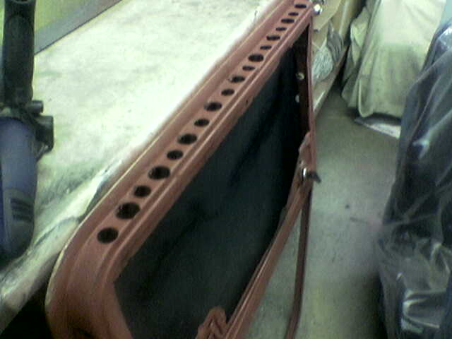

lol haha i got busy earlier drilling holes in my doors too!
holes in your doors i hear you all ask!
yes thats right all, i've gone bannanas & took the holesaw to them, i'm trying to think of other places on the car i can drill holes in but i've only come up with the subframes as i've cut off all the other metal
clubminiflip
1840 Posts
Member #: 54
nr coventry
A door pic with the holes in! i know they are'nt perfectly spaced but they are about right! & light, so o have steel frames with holes in the bottom & sides & bonded on grp skins with polycarb windows & i estimate they are half the weight of a standard door with handles & lock + rubbers, painting them 2moro woo hoo

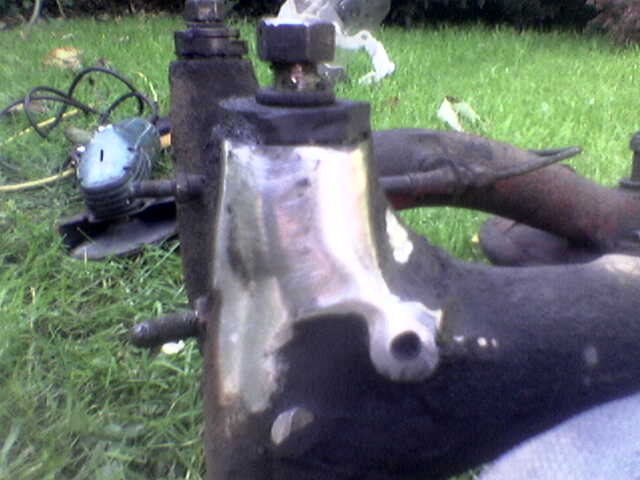

i was a bit naughty, i've chopped the bits on the radius arms off that the knuckle joints from the cones go into, pics to come!!!
i've sanded my radius arms down with the sandy disk on my grinder too to paint them & make them spiffffyyy,

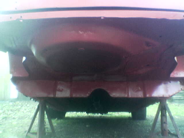

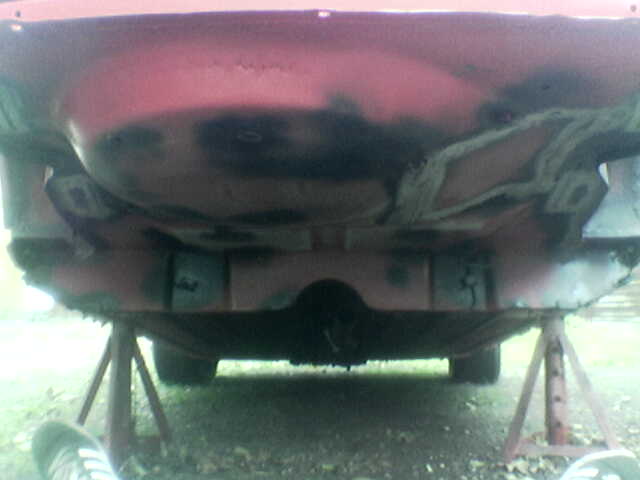

painted the rear arches,bootflorr underneath & sanded & repainted my sills proporly, up to the 1st stiffening rib on the floor asi cant be arsed to clean all the oil off the floor until my engine is out,

my modded radius arms & painted underside of the boot floor, arches & sills,
is there a way i can strengthen the shock mounts for the use of beam axle & coilvers????
i've drilled extra mounting points for my chopped subby four around the exhust tunnel & either end of where the radius arms mount, i've done this so its basicly sold mounted, i've used solid mounts in the trunions, not metal or ally but hard black nylon, i've welded two tabs that bolt through the rear floor with big weight spreading washers, they are large diameter, any advices are appreciuated muchly
