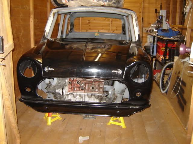

so the front end is now fitted properly, bonnet has both sets of pins fitted and i have riveted a bumper lip onto the front panel.
inside i am about 45% into the cage i have done the door bars now which look really good but i still have:
2 bulkhead support bars
2 roof bars
rear backstays
4 backstay supports
and a harness bar and couple of other bits i want to add!

the front is held on with 6 bolts (ive used countersunk bolts in panel washers), 2 on each side bolted through tabs on the a panels 2 at the top hidden by the bonnet.
at teh front ive got bonnet pins with spilt pins thru them.
i will get some better pictures when i fit the front back on but i have taken it off for a while.
