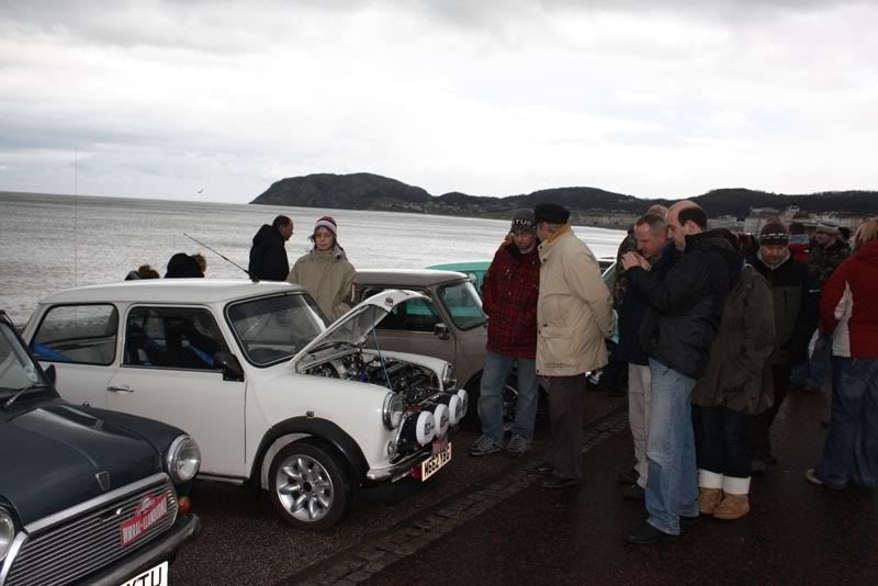

Pics at the Wirral to llandudno run on Sunday the 11th January, Thanks to Jackman for the pic s:)
The car and the engine never missed a beat. The only major event of the day was some BAC reversed into the front of the mini, while we were waiting at the counter of the McD drive through. only nudged it, bent the lamp stay and moved the lamp, putting a small dent in the bonnet! It could have been worse with the rad where it is and as close as it is to the alternator*oh well* It was a good day out all in all
Still a list of stuff to do, but the important ones getting done first for the dyno shoot out. Those are swap out the cams for a full compliment of RS ones *happy* and set the cam timing up hopefully with different numbers *happy*
Sweet!
That's really nice instal. You could almost pass the engine bay for factory..

I believe someone made a comment like that earlier in this thread.
It does look the absolute business however!
