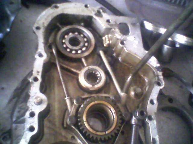

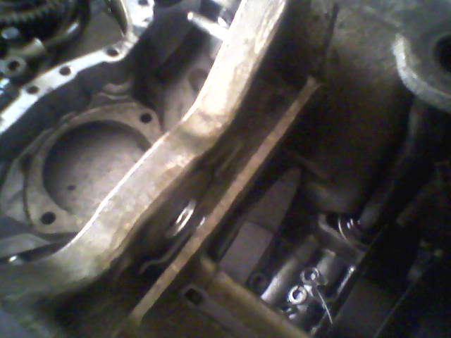

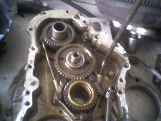

paulH i thought you might find these interesting,thy are the drop gears from an auto min box . bigger bearings and gears ,presumably to take the torque multiplication of the torque converter .
also see how theres a sort of ledge inside the gearbox casing ,this creates a bath of oil that can only get out through the bearing ,bit of a constant feed of oil .
regards robert
