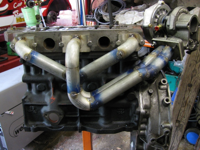

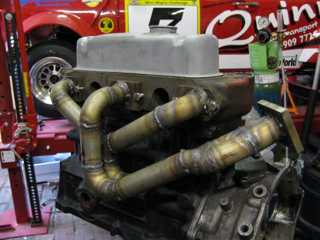

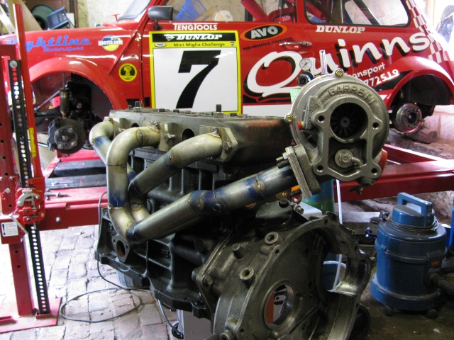

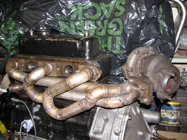

Any chance you can get the pictures back up Paul?
Here you go *smiley*
The reason the old links do not work is that I changed my ISP and the way that the folders referenced changed.
1293 manifold:
998 manifold:
The latest:
Edited by Paul S on 18th Oct, 2014.
danb41
562 Posts
Member #: 9285
Oxfordshire
Thanks for that Paul, very helpfull :)
We are currently working on the two cars that will have the tubular manifolds.
I've just been relocating the PDWA and brake lines on my 998, whilst Axel has been getting the engine out of the Racing Flame ready to take the 1293.
Hopefully have both cars on the road next year.

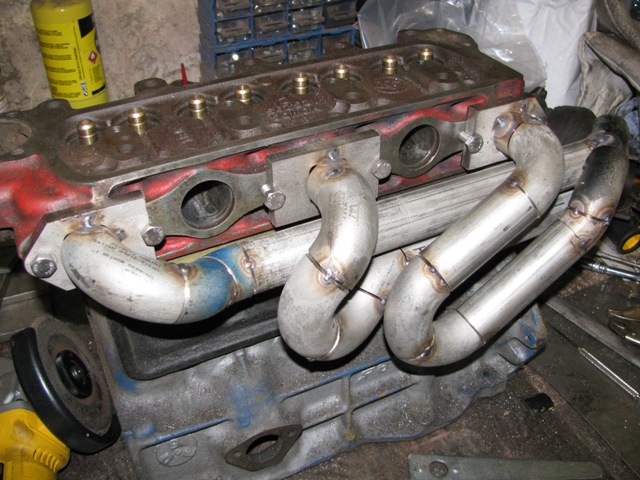

Good stuff, i will be keeping an eye out. Im thinking about making one now as i'm in the industry.
One thing i wanted to ask is what your take on having a step up in bore diameter on a manifold.
As nearly all motorsport systems i have seen made at the company i work for use this design.
Stepped headers are supposed to broaden the power band by anti-reversion. I'm sceptical about this and don't think it would make significantly more power. There is also the issue of finding tube and fittings of the right diameter.
A step in the diameter will cause a change to the pulse pattern in the manifold. Depending on other engine parameters, this could have a negative or positive effect. The trick is to get everything working together cam, head, turbo, manifolds so that their best contribution to making power occurs at the same point in the rev range.

Interesting, i wonder what particular effect it would have on power in the rev range. I.e would a step up in diameter move the power up or down?
As for fitting ect i am fortunate to have the ability to make any size/ bend i need.
Hence the questions really, as with the tools i have now available i want to experiment in the manifold department.

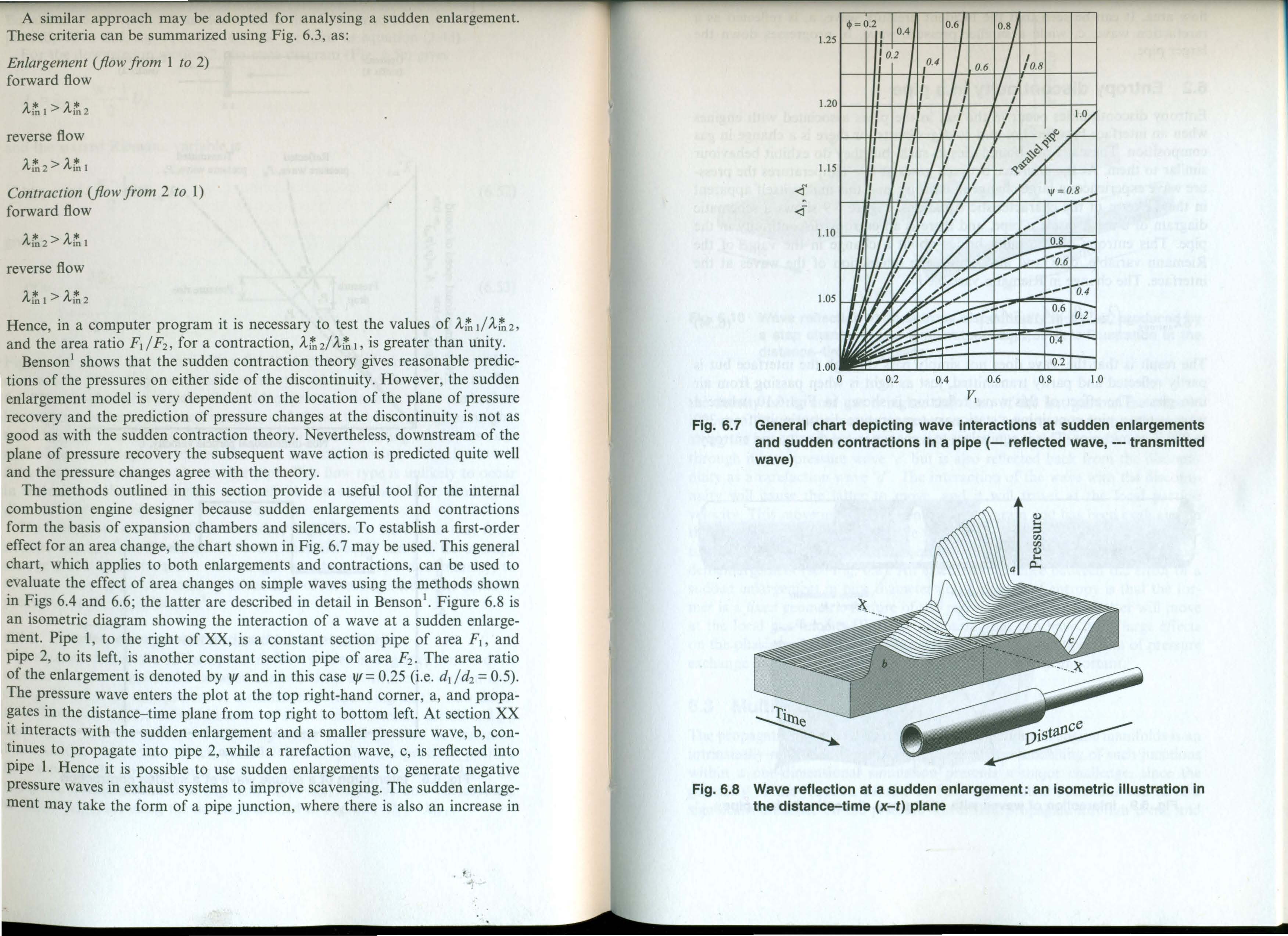

You will never know unless you simulate it.
EDIT: This describes what happens when you introduce a step change in the runner:
So you effectively send a negative pressure pulse back towards the exhaust valve earlier than the main wave coming back from the collector. Hence I would expect it to improve the top end, if the rest of the engine can benefit from it.

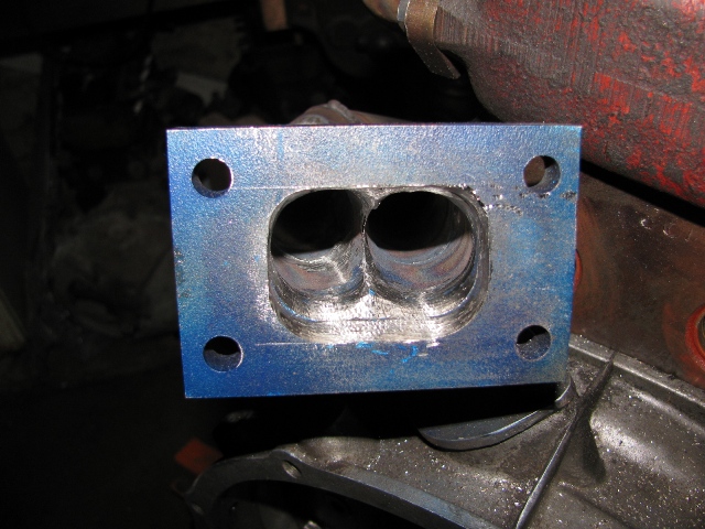

Try and find a twin scroll turbine housing too...make the most of the port design.
Tube size is another very debatable one. I'm guessing most are using around 1.5" ?
I'd nearly think given the small engine capacity, small ports and valve sizes...approaching 1" ID probably wouldnt hurt anything at all ?
9.85 @ 145mph
202mph standing mile
Pointless making the runners from the 1.5" stainless stuff as the pulses are too small to do any good.
You can see from the picture above, the plot of the pulses shows how the pulse amplitude reduces as the pipe gets bigger. You need the amplitude to get the exhaust pressure lower than the inlet pressure during overlap.
I use the 1" NB stuff which is about 28mm.
My simulation suggest that the optimum for both the 998 or 1293 is 28mm bore for the outer cylinders and 31mm bore for the centre branch.
