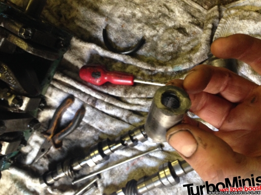

Pulled the engine today.
heres the damage. I cant believe my eyes.
Good skills !!
cheap bloody parts!
Probably Graham, the others look ok.
I reckon theyve only done 2000 miles at best
just_jack
547 Posts
Member #: 2928
peterborough
Shhhiit, looks very poor quality parts!
Where were they from?
Jack Jones
where's the middle gone ? *surprised*
Good point, have you found it in the cog box Michael?
any damage further up?
