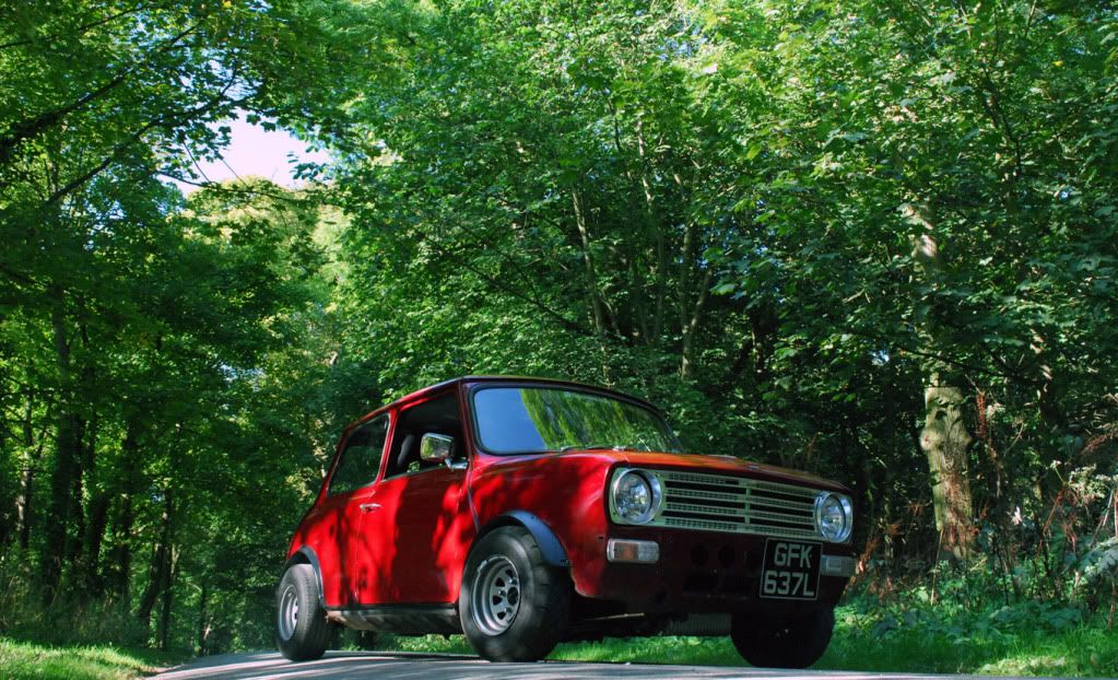

MOT passed, Tax aquired, all road legal again *happy*
Only given it a little bit of beans so far, this GT20 is fucking amazing.

Always loved this car! IMO get that black grille back on it!!
AWESOME!
AWESOME!
i was gonna say so too, but still looks fantastic nick

cheers chaps :)
I had it with a chrome grille/silver wheels originally then tried it with black grille and wheels and i just wasn't overly keen on it tbh so i've gone back to chrome and silver.
