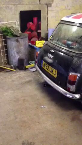

Yes the alternator is wobbling, its loose in the video as im need to get the belt and a few more bolts, but its all where it needs to be.
Yea was very happy, after all the stress with mini with the turbo engine and wasted money, was nice to have it maling a noise after a fee years. It was nice to know i didnt balls the wiring aswell. :)

Moved under its own propulsion today, so hook up the brakes, double check evry bolt and testdrive hopefully tomorrow.

Rick.SPI
1596 Posts
Member #: 8027
The problem....
Beand new dizzy, some dick didnt assemble it with a bolt in the rotor, so rotor wobbles around, spins off, smashes the arm to prices and then smashes up the plastic guard inside... Luckily thats the only damage.

Well pictures speak more than words:
And a vid...
Its all running, still a little bit rich (think map related, As i had to mate the wires sure to having the wrong plug on the loom) no ecl on tho so wiring isnt 100%, got revs, temp and oil pressure.
Now for the mot related stuff, ie lights, and dash making. Then were rolling :)
