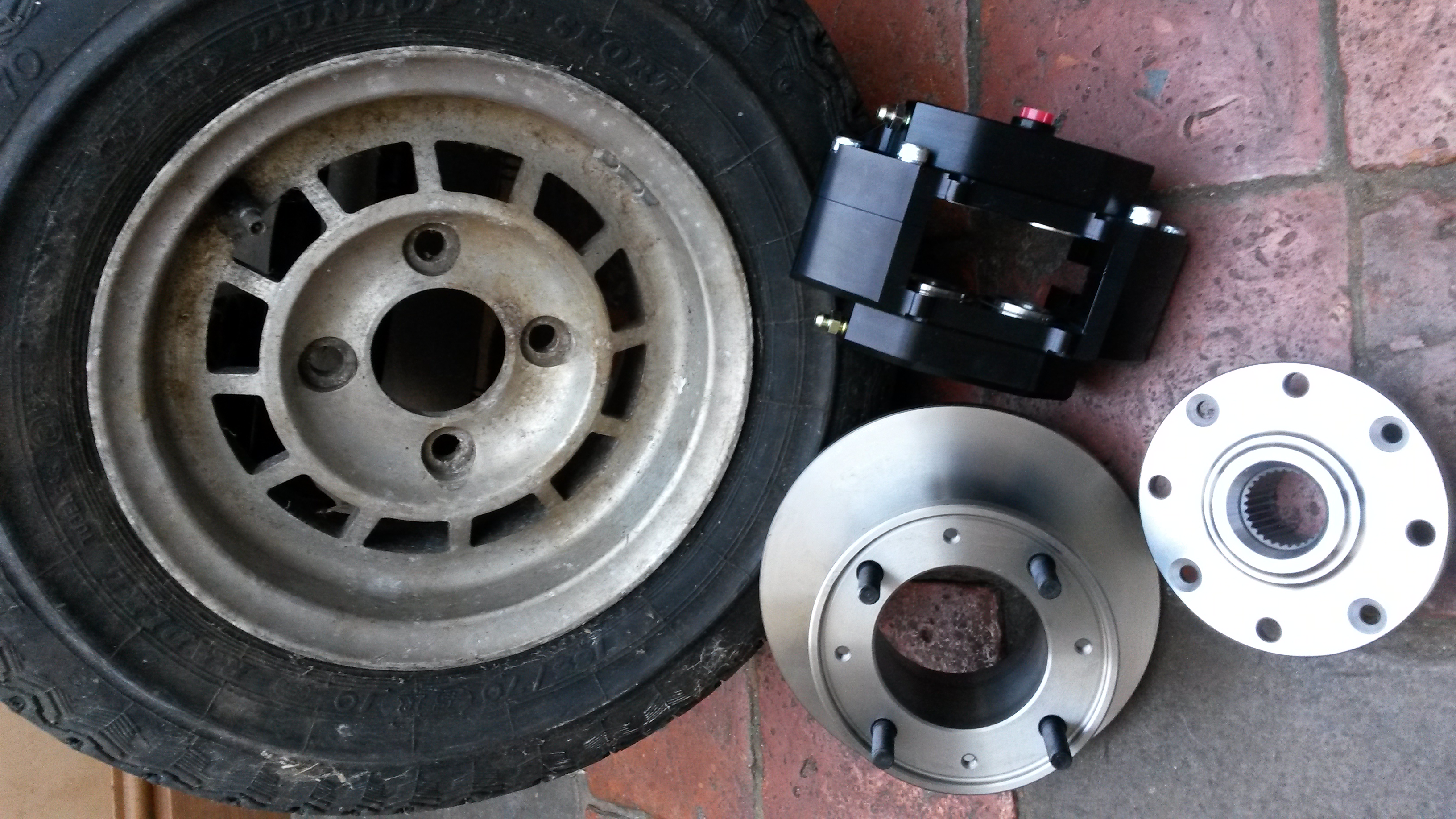

I've always wanted to go to 10" wheels and 4 pots but was undecided. I'd bought some calipers but little else. The other day Axel came home and asked if I wanted some 10" wheels as there were some in a skip at his workplace! He brought home 3 Mini Special/Exaction wheels in usable condition the next day :) Luckily we had aquired a single wheel in a job lot of parts a few years ago making up the set.
Black friday deals sorted some discs etc and we are good to go :)

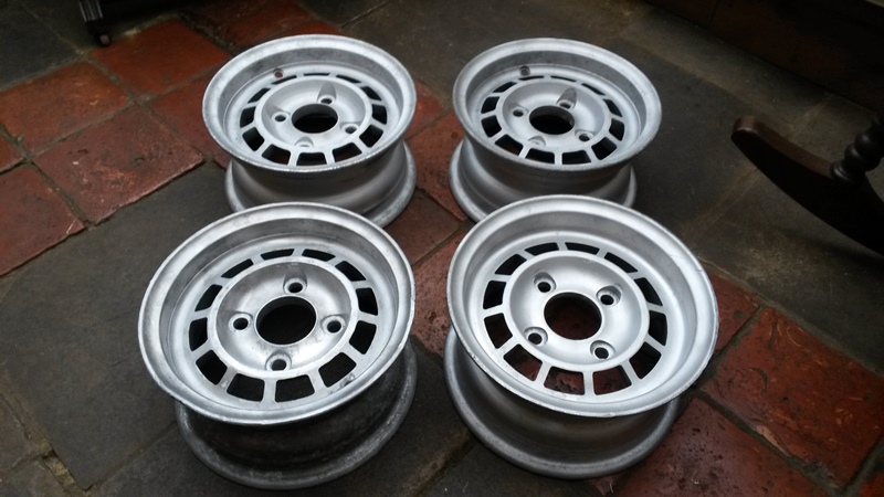

Not a lot going on here. Hurt my back again, pulled a stomach muscle doing press-ups, man-flu and trying to train for the 2018 World Champs etc, etc.
Got my Excation wheels blasted:
Undecided whether to use them. 2 are OK, one is heavily corroded on the bead surface which will need a tube and the other is a slightly different shape, different offset and squared off a bit on the inner rim. After seeing Longy's post the other day, I realise that I'm going to need arches to cover them which I was desparately trying to avoid. I've got another one coming from eBay to make up an identical set of 4 but may sell on. Let me know if you are interested.

Might know someone interested. How much are you after?
Shame you can’t use them.
I can use them, just need arches but that's not the look I'm after.
I'll let you know if I decide to sell.
Decision made. If I going with arches, then I might as well go a bit bling so the wheels are going off to Force Carl for some extendification :)
I trust you’ll be going full Carlos Fandango
Yep, but no cigar :)
Carl has worked his magic :)
So, the big question, what colour to paint the centres? I was thinking gold.
Goooooooollld!
Love them split. They look excellent.
I think they should be painted white and some O.Z. RACING stickers added. *smiley*
https://wheel-temple.com/2013/05/26/rare-oz...15-4x100-et-26/
Gold it is then:
