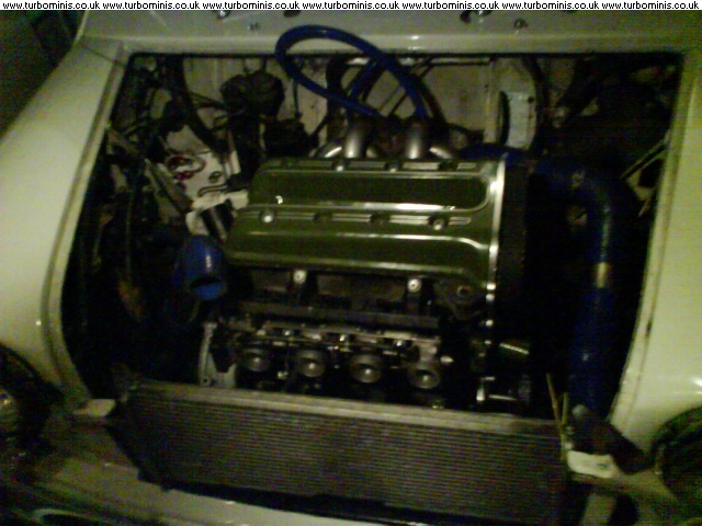

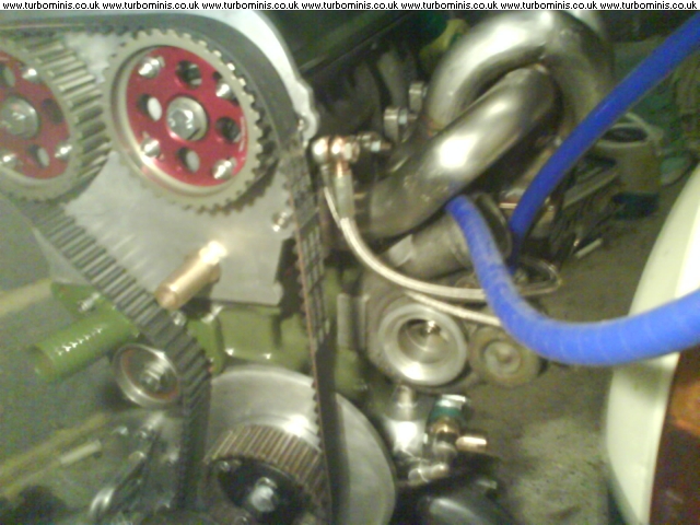

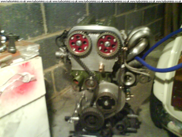

Managed to finish fitting the rest of the parts now.
Oil return with fittings.
Oil return fitted.

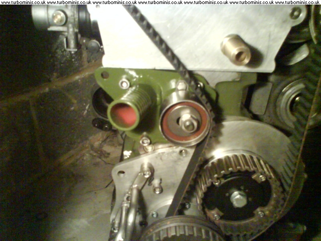

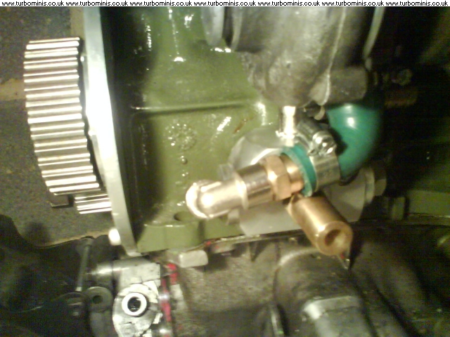

Timing tesioner/water inlet fitted
All ready to be fitted tomorrow! *tongue*

Matty, looking good ,BUT,,, i don`t like your oil drain from the turbo, it reduces along the way & it`s best you have it expanding - larger along the way down, if you get my drift?
www.miniman.com.au
On 23rd of Dec, 2007 at 07:50pm matty said:
Just watch out with these water hoses and the manifold that they dont burn through, try and keep them as far away from it as possible
Edit: that sounded patronising, but ive burnt through them before and it looks like itll be a pig to change in place
Edited by Nic on 23rd Dec, 2007.
yeah good point nic , i assumed mat was going to wrap all the parts near heat ,but if not matt , id deff wrap those oil pies or the manifold ,so it doesnt melt the teflon liner in the braided pipe .,may never happen but hey ,whats a bit of pipe wrap or loft insulation wrapped in tin foil going to cost !!
The water hoses would be an absolute PITA to fit in place (if it is possible at all). There are a few places I can route them without them getting to close to the manifold just don't want to cut into my nice new shiney hose yet till its in the car and all measured up.
Matt - The oil drain should hopefully be ok as it is still 4 times the bore size of the feed and it is well vented aswell. In an ideal world I would have it a consistant bore size as you say, i'll just try it and see what happens. *oh well*

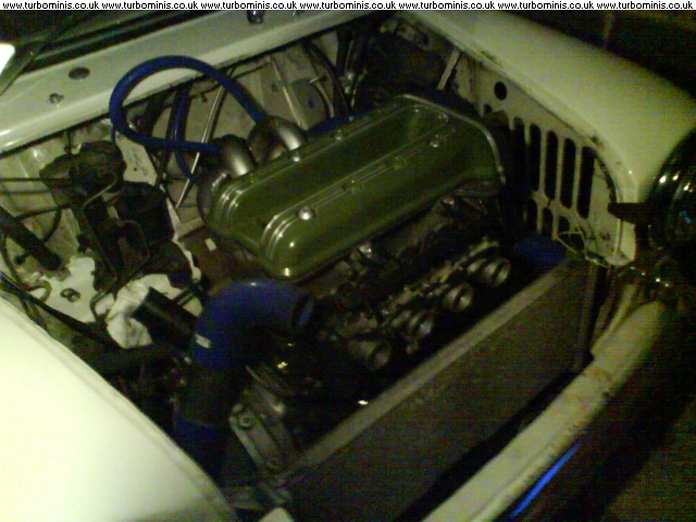

Looking nice there mate, really must crack on with mine some time soon.
What turbo are you using?
Bat
4559 Posts
Member #: 786
Bermingum
Looks like a Saab GT 1752 from what I can see?
Gavin :)
My Mini build diary
Its the GT1752, seems to be a nice efficient turbo.
Hows your build coming along Mike?
are you going to use the thermoinsulation on the manifold? to keep temps down and to save your water hoses *tongue*?

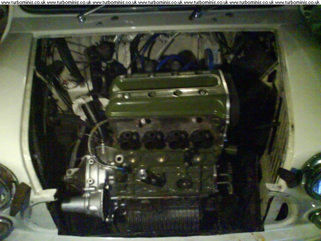

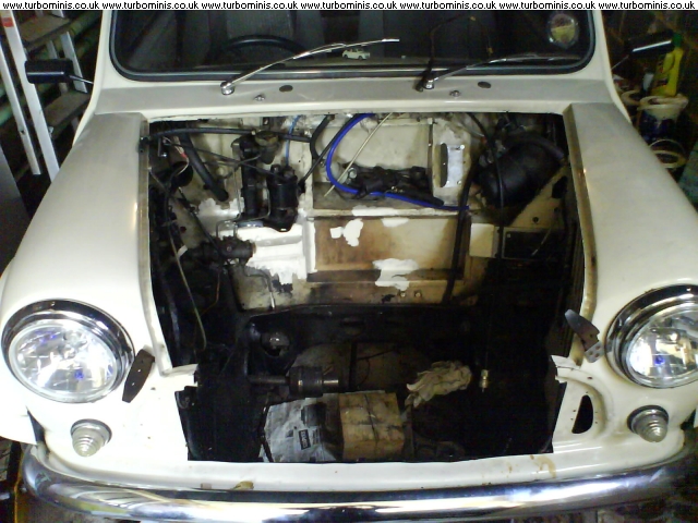

Managed to get some more done despite feeling rough...lol
Before..
I decided to try Nics method of fitting the engine as I didn't have access to a hoist.
One clap of the hands later...
A few more hours later, unfortunately clapping of hands didn't seem to work for the rest. *oh well*
Bat
4559 Posts
Member #: 786
Bermingum
It's in! 8)
