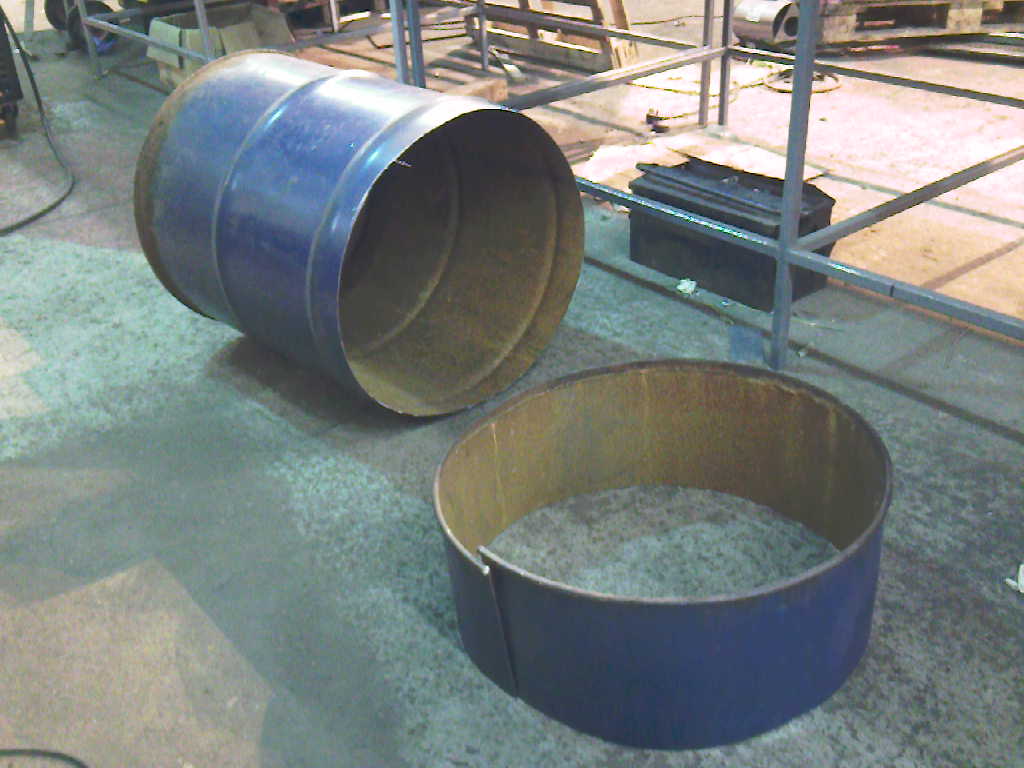

Mine warped because I started sunday evening and had to drive to work the next day, stop. Filler time!
Also I used a section from a 50gal. steel drum because its the same gauge as the shell 1.3mm IIRC.
It is already curved and you just roll it up, hold in place then let go and it springs to fill the hole and stays in place, you can then just trim and weld.
