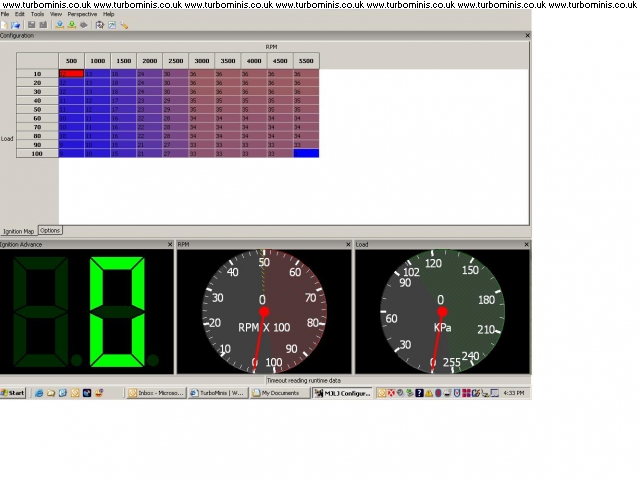

Good news it has got a map, not sure what map it is or how copy and paste it onto the thread though! Getting there slowly! :)
LOL
Out of interest what configuration software are you using?
You might be able to get the map up onto the thread using the print screen button.
Im using the latest version 3.1, looks much better than the previous versions.
Still struggling to post the Mj spread sheet, print screen button doesn't work!

The new verions of the software automatically open up the map in the MJ if you are connected and powered up.
Heres the map currently on the MJ.
I know the pictures not that clear but, you can just about make it out .Does anyone know if this is the basic map for a Turbo?

just done a search on my C drive and found this saved in the previouse version of MJ. Never used it, but the figures look more familiar!

that bottom one looks like an NA map to me, just going off the scale on the side.
Can't make out any of the values in the boxes though

yeah thats a n/a map.. the map values only go up to 100...
i'm sure someone can post their "generic" turbo map

personally i wouldnt be running 34 degrees advance untill on an unsetup engine. when i was running mine in i just put the same figures in all the boxes (like running a fixed dizzy) think i used 23 degrees whilst i run mine in, not 100% sure on that but do a search and the "safe" ignition setting is on here some where

Bottom one is NA.
Top one is for a turbo - but its a "soft" map. To get the most out of it you will need to get it mapped.
This is ofcourse assuming that the EDIS and MJ are talking :)
Have you tried unplugging the MJ and going for a drive, then repeating it with the MJ connected - there should be a BIG difference in power, when it comes on boost etc etc
