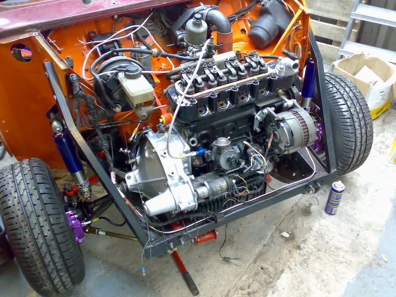

bit of an update as of today, got some of these
And one of these
Picked up from RACE engineering, 1293cc, mg metro cam
can't wait to get stuck into fitting it this bank holiday.

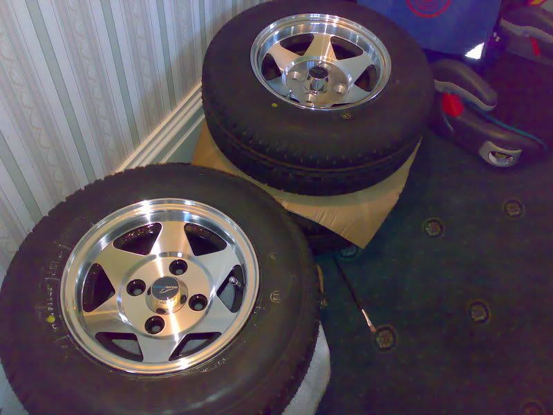

these are the wheels for it, diddy starmags.

in the above picture, can you spot the difference in the wheels?.

Looks like the offset is different.
1 has black paint around the stud holes.
Different height center caps?
What's the spot the difference prize?

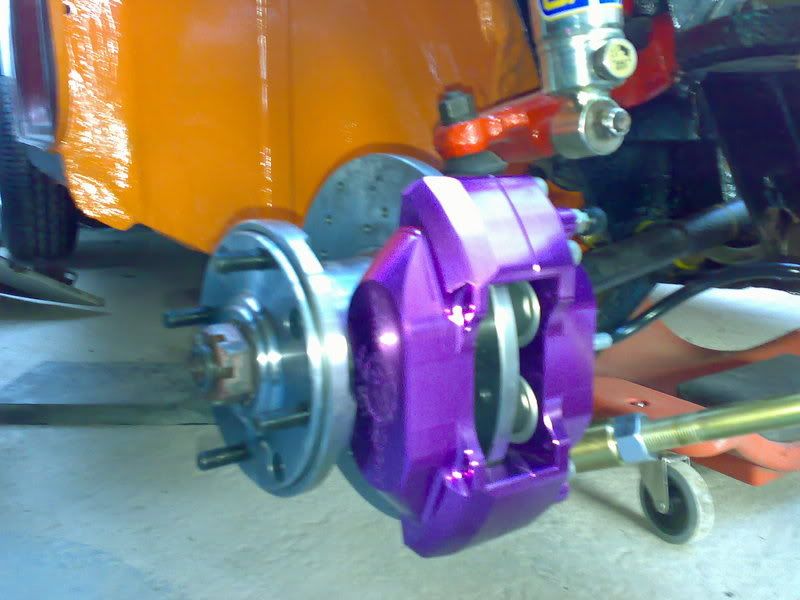

Where are the calipers from. Im after some myself!

calipers where from minisport, they produce their own. with mg pads (modified) and pins total 306.00.
The left wheel is the odd one out, painted black where the nuts go on, returned to midland wheels for a replacement now.

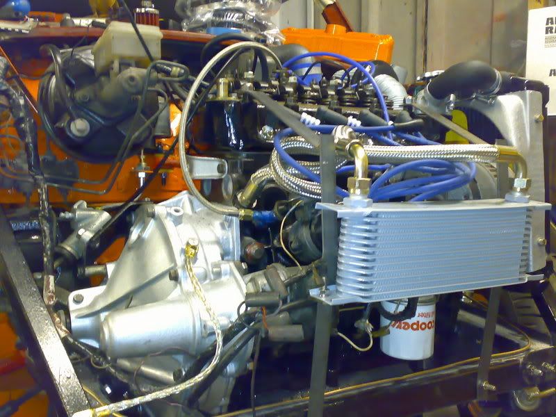

This is the weekends labours
Managed to get a part from avonbar that they ommited for the oil pipe. rad, intercooler,oil cooler next, then fit the flip, then get on with the bodywork.

looking very good indeed, where did the Starmags come from?

Here I think?

10x6 with yoko 360 inc vat and delivery with free centre caps, nuts and locks.
can't really complain

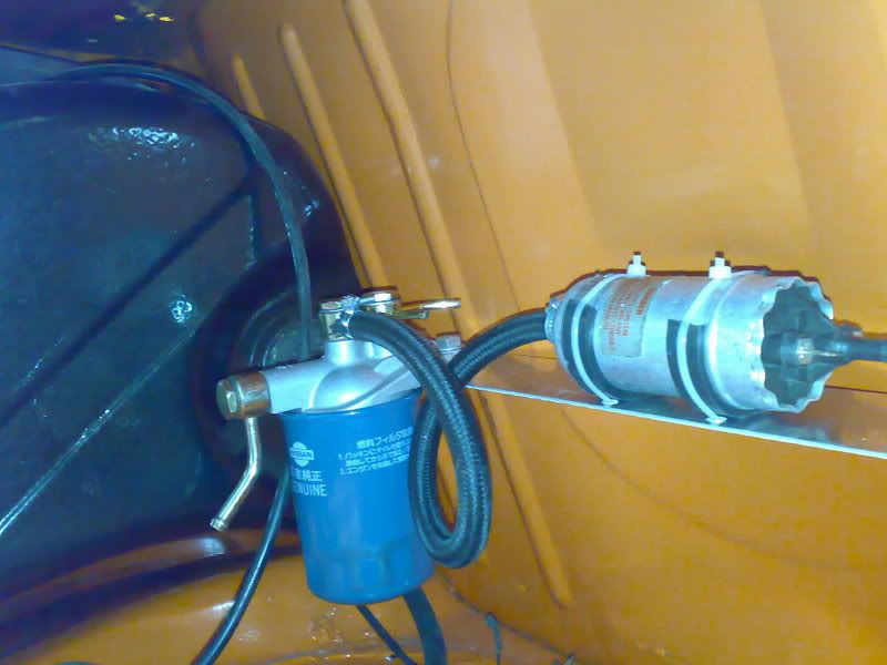

Bit of an update, not done too much recently so thought it was about time to crack on, Maniflow exhaust fitted today and got my head round the fuel filter and pump install.
Opinions welcome.

just a thought on your pump most people tend to fit them lower than the tank so the pumps gravity fed if you know what i mean. not sure if itll effect its performance.
whats the filter all about? looks ver ott imo.

Cheers Carl, will take you up on that offer of a visit. The pump i got off fleebay for a fiver, brand new off a nissan summat, I thought it had two return pipes from the picture when i bought it, but i'm not too sure what they are now as they have a one way valve, still, i'll give it a whirl, at least the filter is screw on and i priced them up at £2.90 each for replacements.

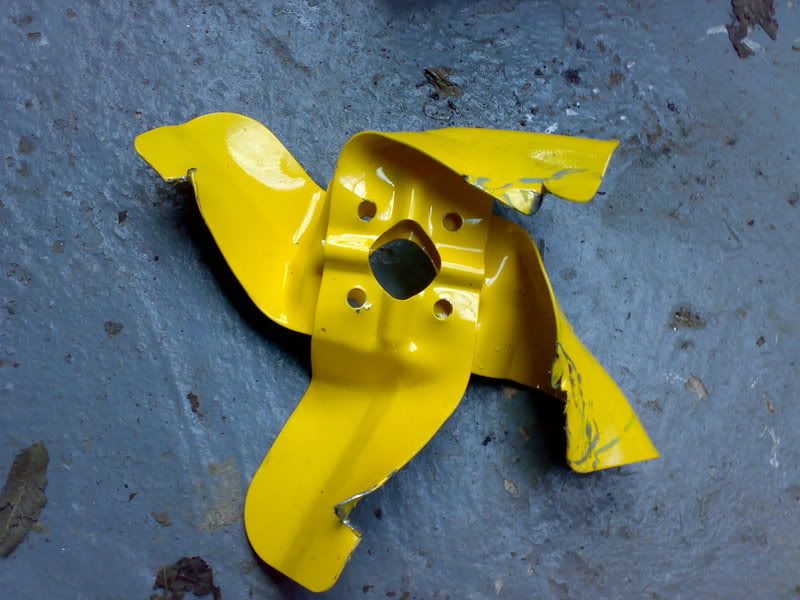

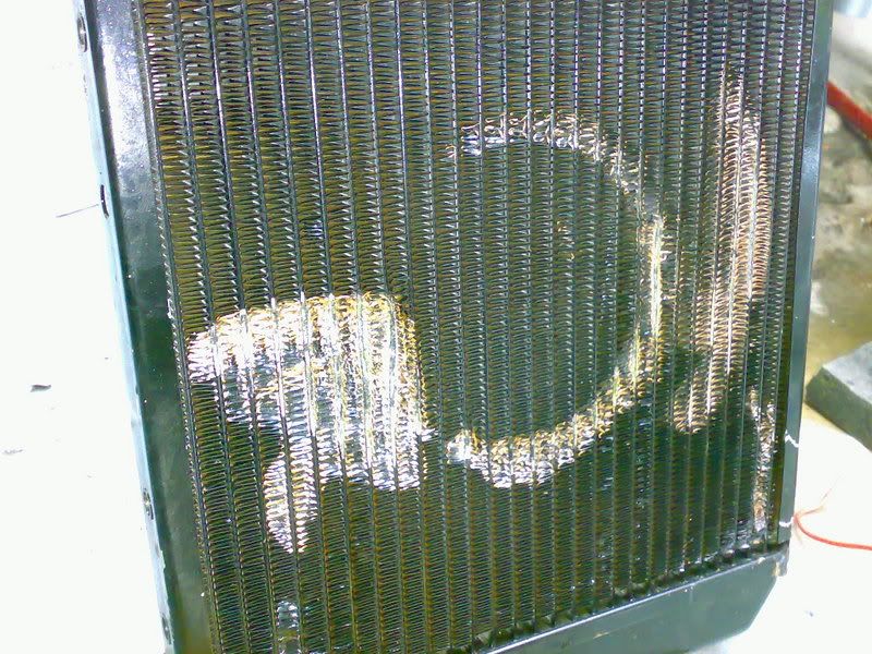

IT RUNS!!, was quite surprised how easy it fired up until this happened.
Note to everyone to double check clearances on the fan to timing cover breather, how daft do i feel?, the downer is, it did this to my nice new 2 core rad

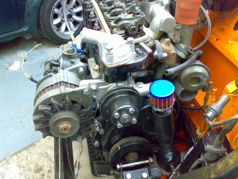

Lesson learned methinks, thats gonna hurt my pocket a bit, what a numpty. Anyway this is the latest engine pic.

Looks great mate,
Ive done somethink like this once. Forgot to put spacer on the fan and my rad got a nice scar.
I see as well that the engine pic was done before the Accident.
what a total bastardo , much commiserations ,still not a lot of work to do now ,and its looking spectacularly spanky !
