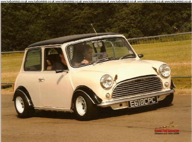

LOl!!! that can't be right, I'll have to re-measure!
This is pic of mine.

matty-yours is the lowest road car that ive seen, doesnt it catch and scrape everywhere?
So had a thought about mine....I measured it with my trusty plastic ruler but didn't compensate for the 3/4mm before the numbers start.
Its probably more like
Front 184mm Rear 199mm
It looks lower than "normal" here for some reason!

Still lower than a miglia! Are you sure your rear arches are standard? lovely car btw.
iain
8506 Posts
Member #: 16
Near Lincoln
the miglia's will run as low as possible at the front then have the back to suit weight distribution i guess rather than getting it as low as possible.
Cheer Gav,Im sure there standard, I will Tub them at some point though!
Nic, the only times it srapes on things, is those annoying speed bumps that are like an island in the middle of the lane instead of going all the way accross!
Front never scrubs on arches, rear only does occasionally, normally when loaded up with camping gear.
