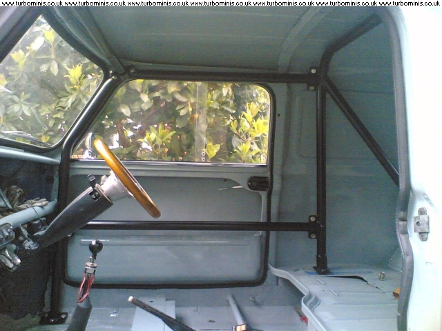

i have now got a cage thanks to "Bat" and below should be a photo of it fitted. i know it wont show so can some one sort it for me!
http://www.turbominis.co.uk/_photos/events...thumbs/3546.jpg

Looks cool in there.

looks great now but imo it looked great before too *laughing*

Blimey you didn't hang about putting that cage in! Looks like it fits the van better too! Car looks mint 8)

the cage fits but it took some fitting! i cut the diagonal out so i can use the back of the van. then the rear legs to the arches were too short so extended them with tube frim the diagonal. the door bars were shaped to fit around the Mk1 door bins but i couldnt fit the seat so moved the mounting bracket and made a door bar from the diagonal. just need one more straight door bar
You cannot cut out the diagonal. What's the point of the cage then? Also, cutting the rear legs in half and extending them is a no no. You'll need to change them at the main hoop if you don't want it to fold in a shunt.
