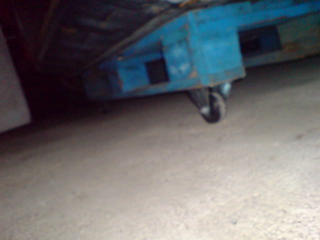

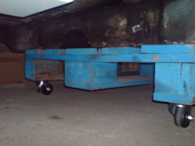

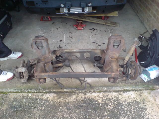

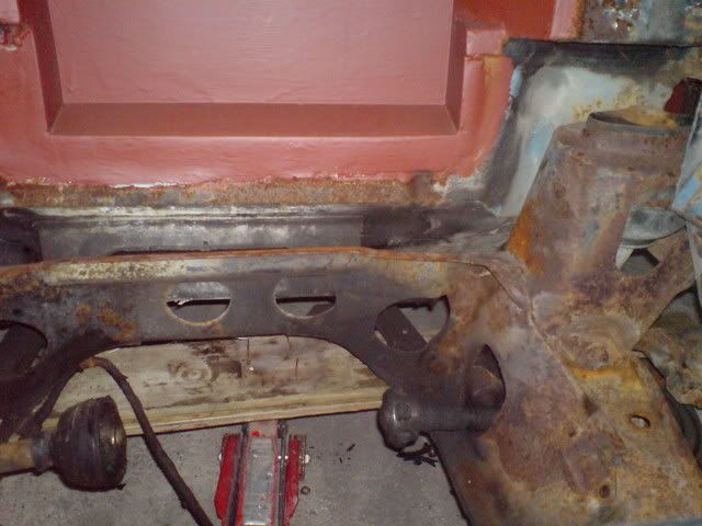

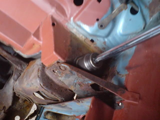

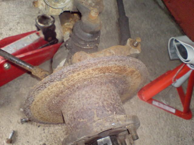

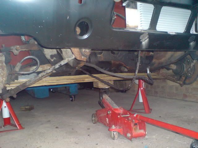

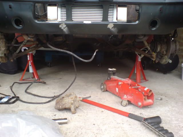

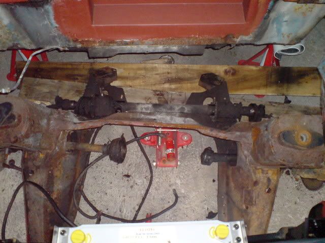

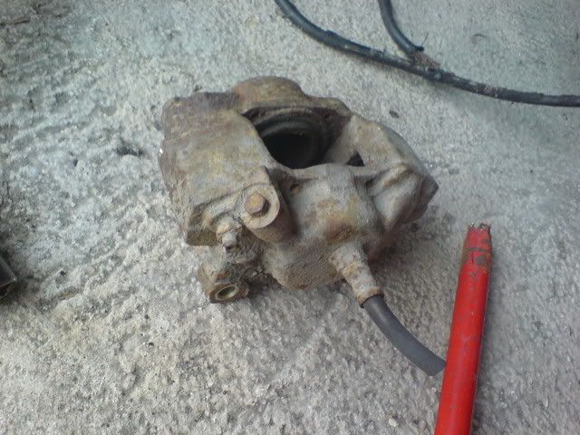

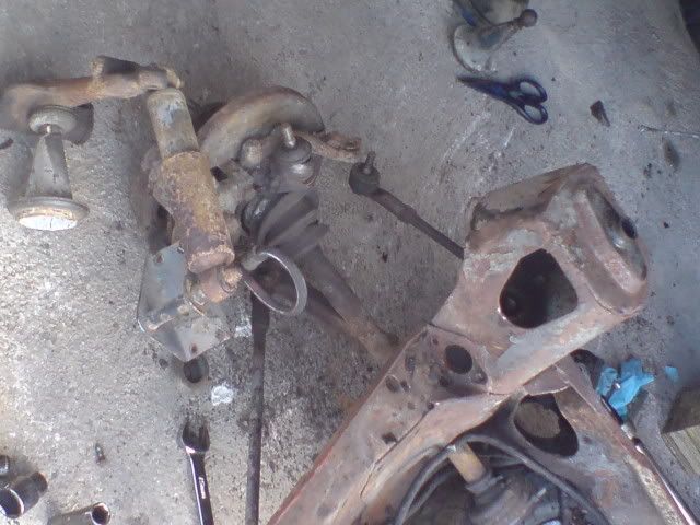

While Ollie eats the maltesers i will post this for him. we did abit of work to his mini today taking his front subframe out. also took his calipers off and the steering rack//wheel. and placed his car ontop of a pallet. pics are below :)
Ollie
524 Posts
Member #: 1380
Cheers for the help Paul - looking back i think we spent more time breaking the pallet up than actually removing the subframe, lol.
Now it's out of the car (after a strip) i can have it blasted and re use it - the back off to welding!

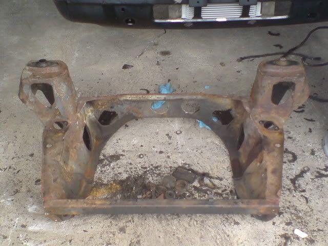

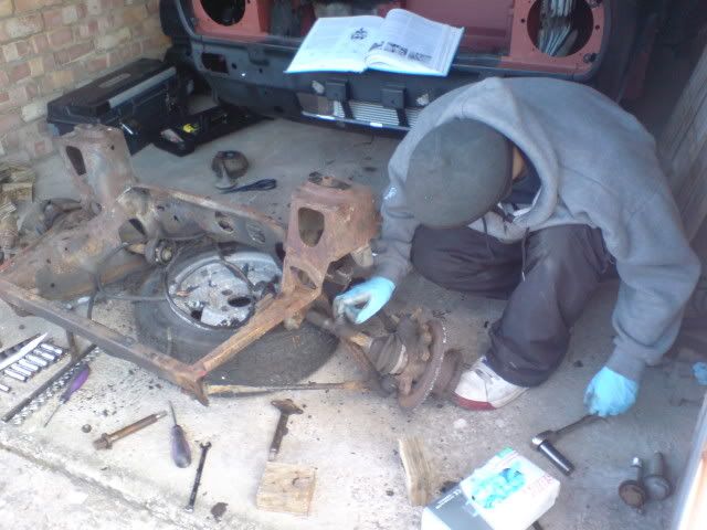

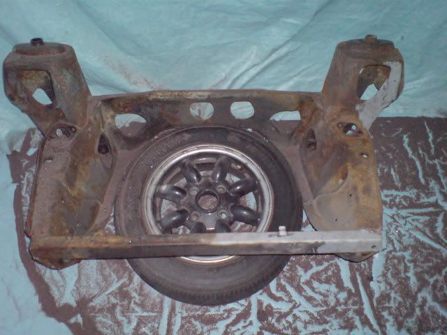

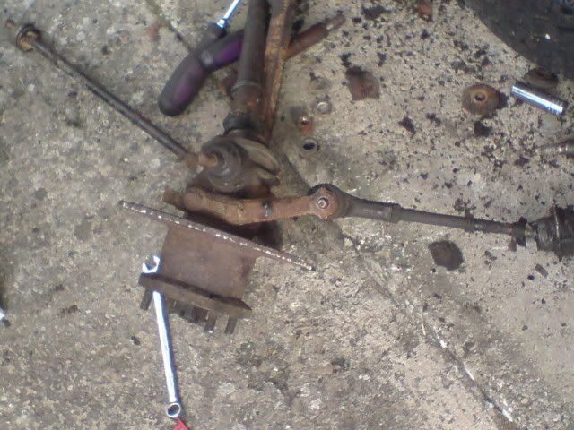

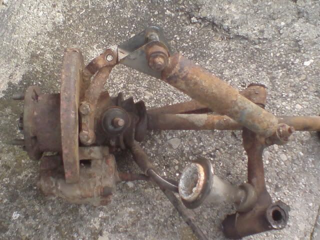

Another little update today i helped Ollie to strip his front subframe ready for us to sand blast it 2moz... well try to :)
enjoy

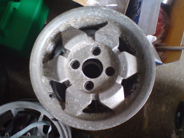

and some original dunlop D1's

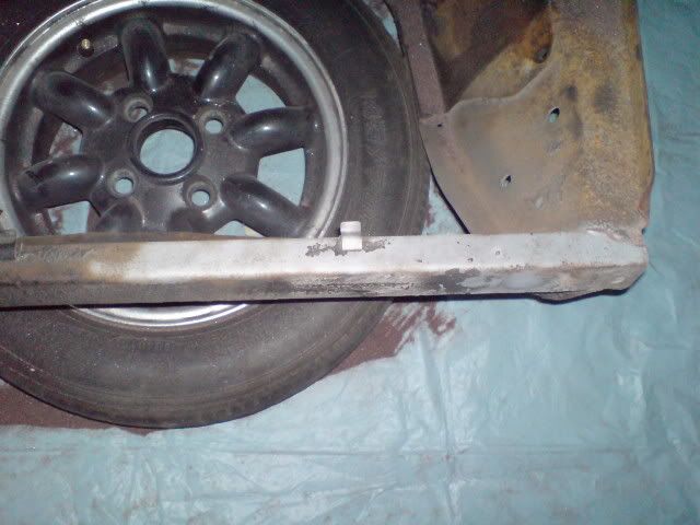

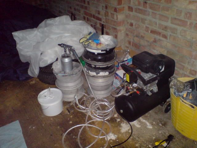

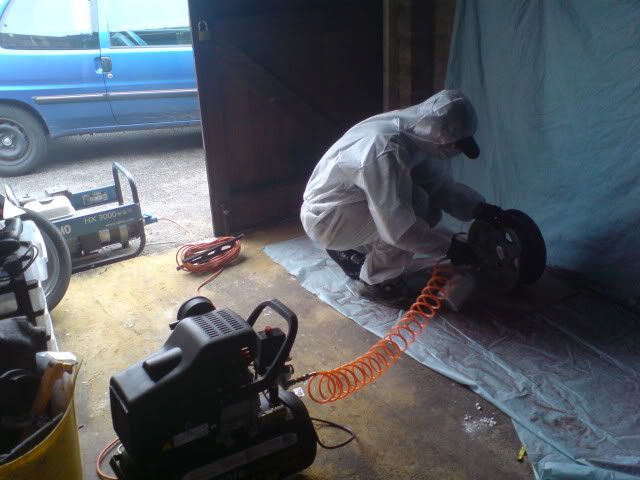

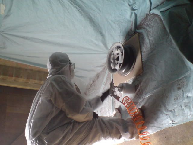

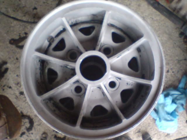

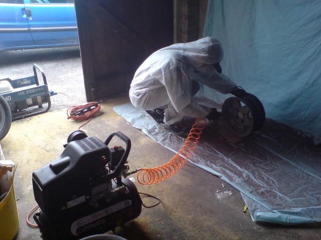

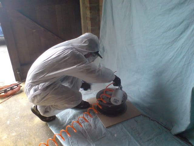

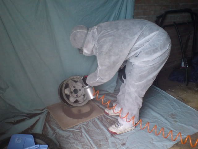

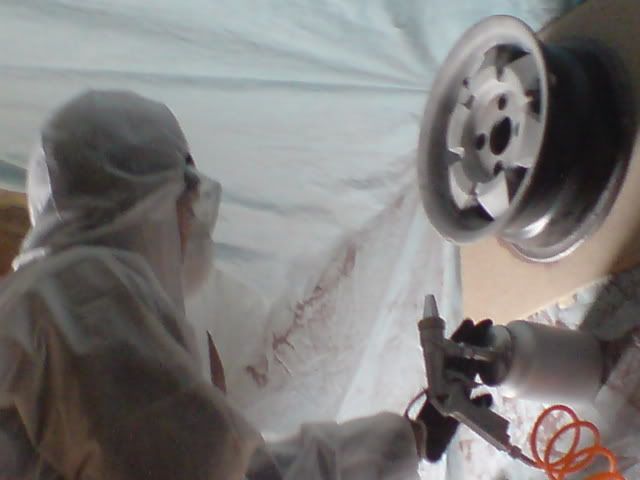

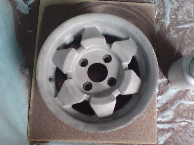

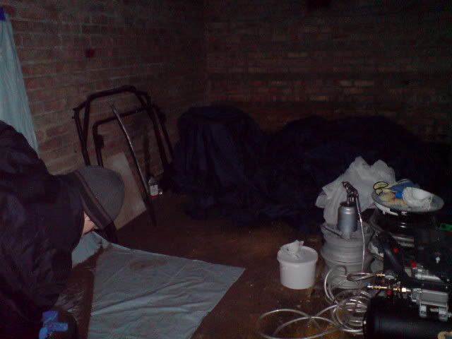

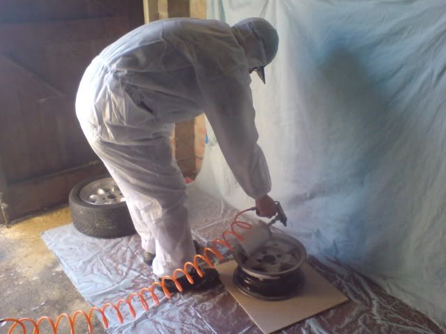

Once Again another update, started doing some sand blasting. started off with the KN wheels which were in very very bad condition, will be doing the subframe very soon once we have a new hose!

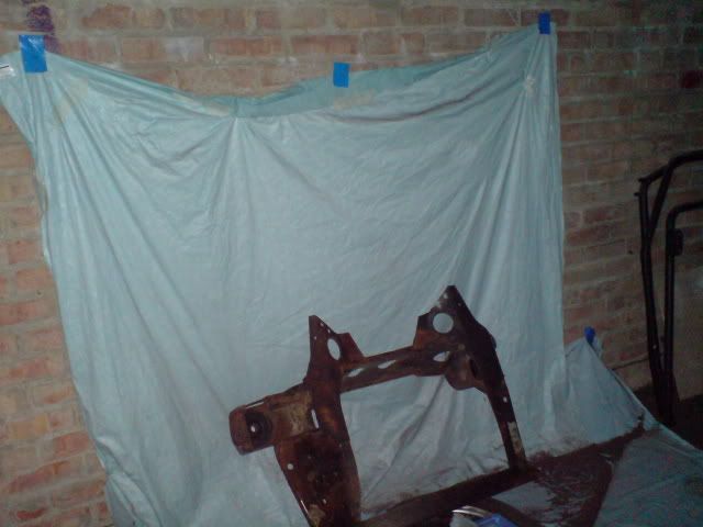

got a few of the subframe which we started doing before it got abit dark
how it started
the sandblasting workshop!
Edited by Paul R on 29th Oct, 2008.

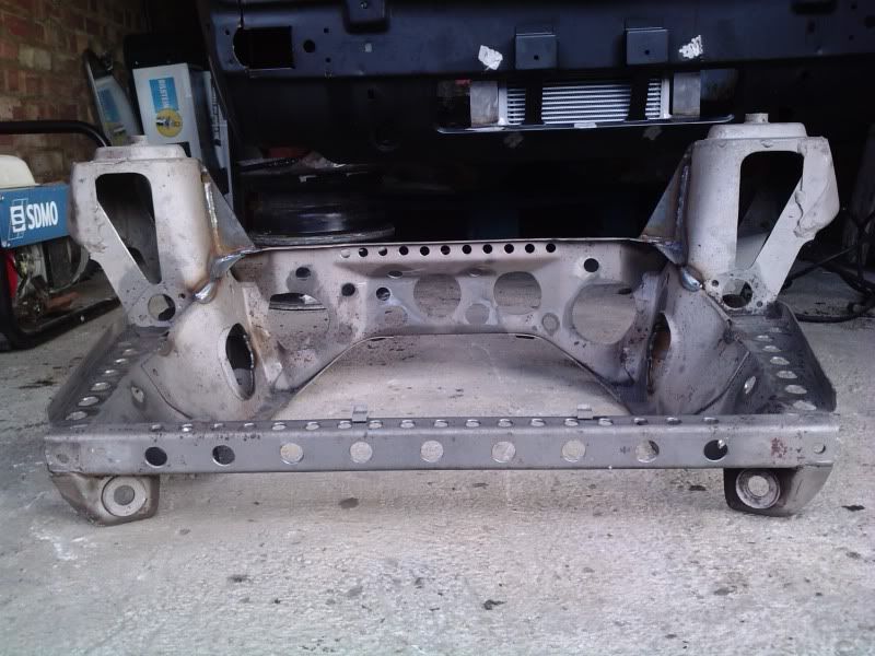

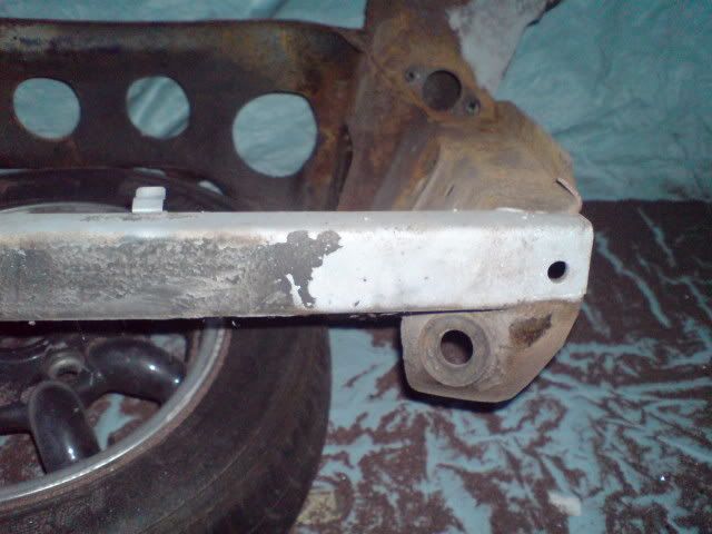

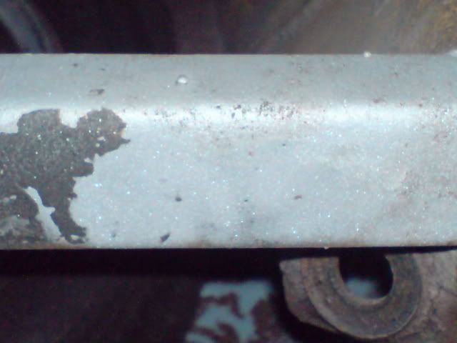

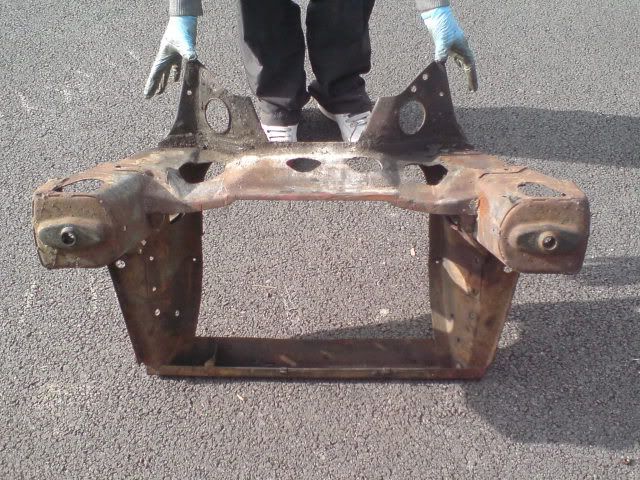

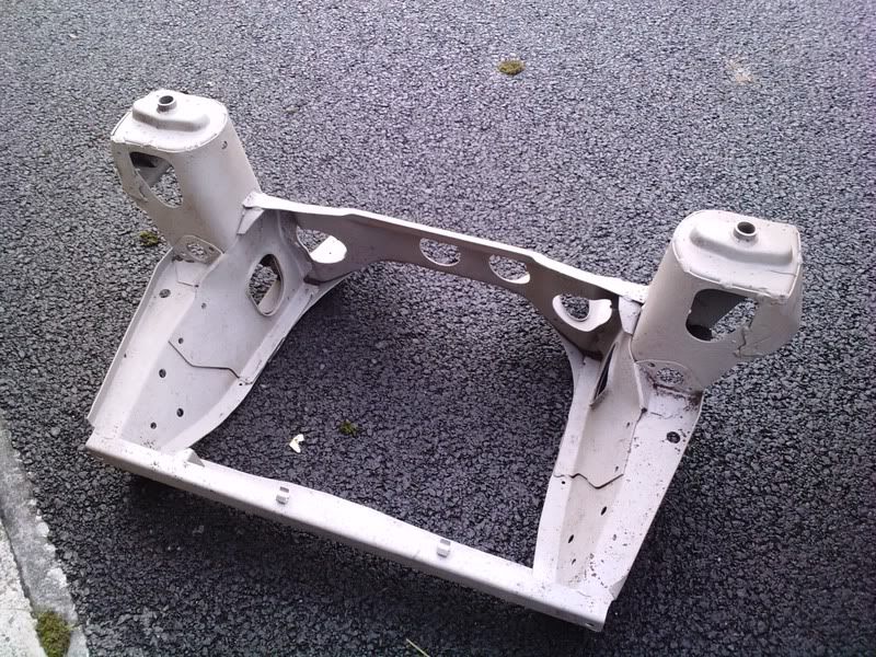

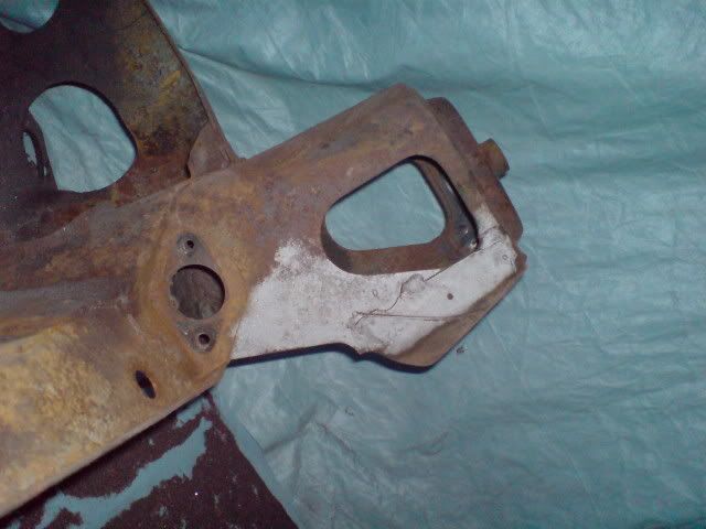

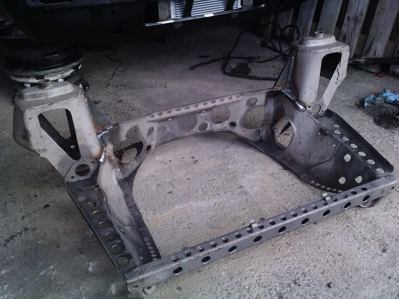

Just a very brief update on the front subframe, after removal and the stanges up to being lightened.
thanks to the search button i managed to research all the work that went into the subframe so thanks guys :)
the only thing i saw mentioned but couldn't find any pictures for the life of me was the enlarged hole for the driveshaft.
when it came to looking into making it bigger, we didn't really see where it would be possible unles you went towards the back of the subframe?
So left that for the moment. If someone could give a brief explanation or a little picture it would be greatly appreciated.

Cool project, coming on nicely. So how much weight did you save from the front subrame? I guess what im thinking was ‘was it worth it’ ?

Good job with the subframe mate,theres still a bit more to come out of it if you ask me..*wink*

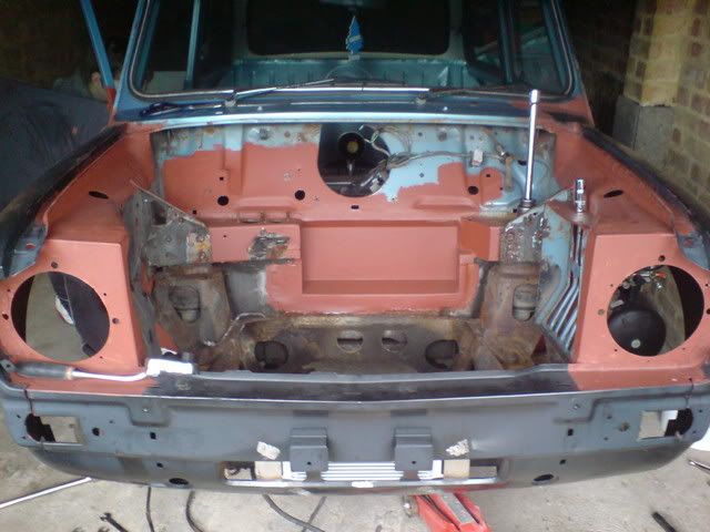

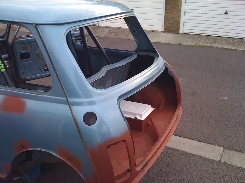

It's probably about time I updated the slow progress that has been made to my project car!

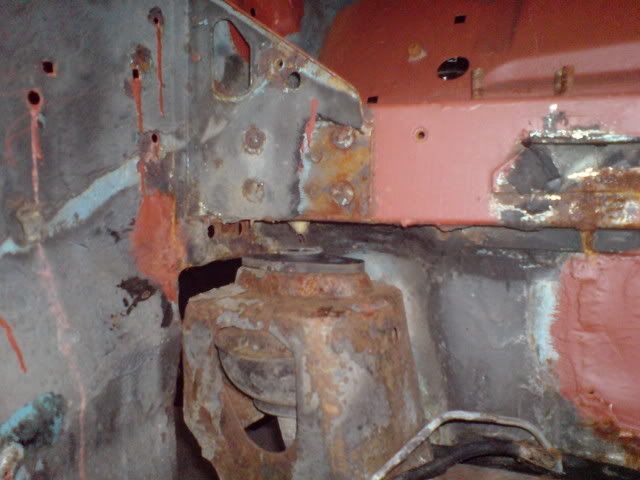

Although not alot appears to have been done, the stage of shotblasting the whole shell is getting nearer now. And i'm hoping this will not uncover any other areas that will need welding :) haha.
Since the last batch of pictures (before Pauls random ones, I had most of the panels done, but as i'm sure all of you know - it's the last "small" jobs that become the longest ones.
Firstly, before I post up the pictures, i'd like to thank Neil (Wolfie) for shifting my car to his welding friend about 10x in the last 2 months! - Thanks mate, really appreciated.

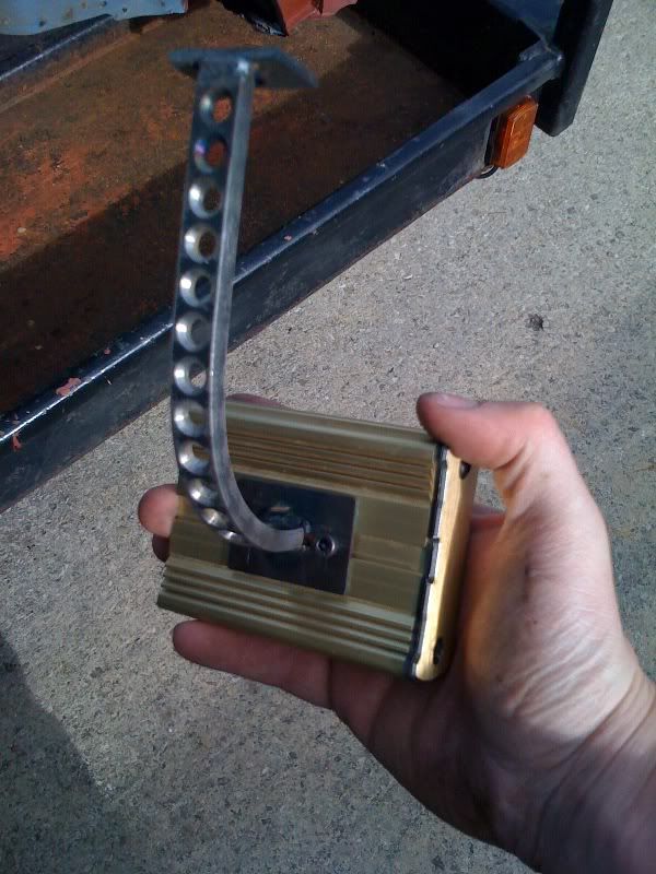

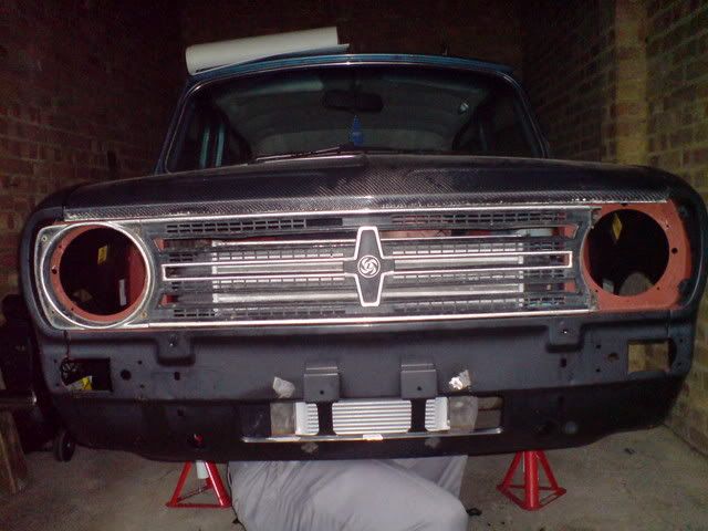

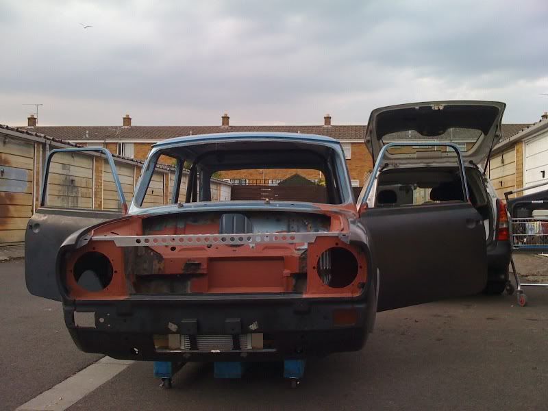

One of the first tasks was to put on the slam panel. I did have a heritage part but ideally wanted something a little different (and as I don't have need for the lock, it could just be as simple as a 90 degree ally angle and some holes drilled) Which it was :)

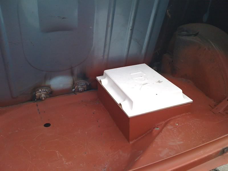

Next stop was some mountings for my seats (please do not look if you are seeking an example of lightweight development, lol)

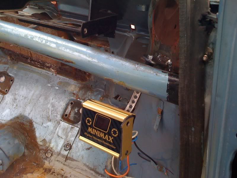

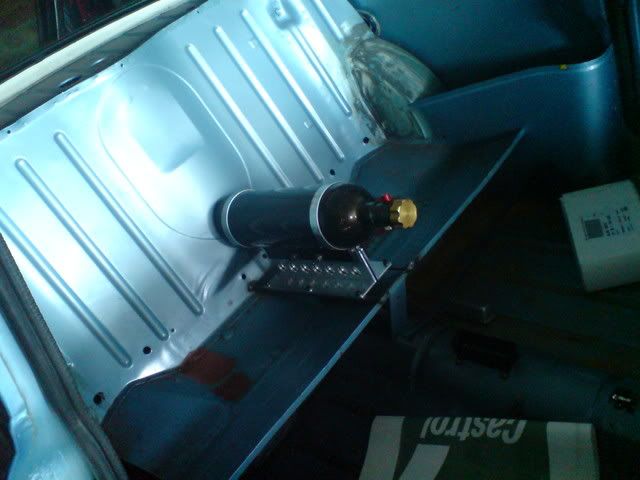

Once the seat mountings were in place, I could fix the seats in to see where abouts i could mount my nitrous controller once in my driving position, after a few options I decided to have it on the right hand side just below the bottom dash rail.
A bracket was then fabricated to suit:
and it sat here:
While the seats were in place, the eyelets for the harnesses could be positioned and put in place:

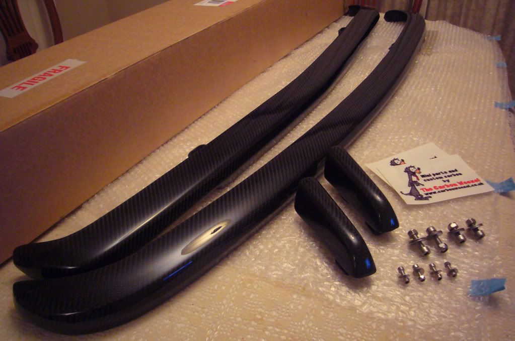

another imtem i treated myself to was the clubman bumper and underrider set, must say im more than impressed with the quality and weight difference to original!
I spent this evening stripping out the last few little parts that were left in for bracket positioning etc. Paul aided in this, thanks mate :)
Thats all for the time being, but I still have a list of stuff that needs to be completed before the shell is ready to be stripped to bare metal. I'll try to keep this updated with any future stuff I do.
