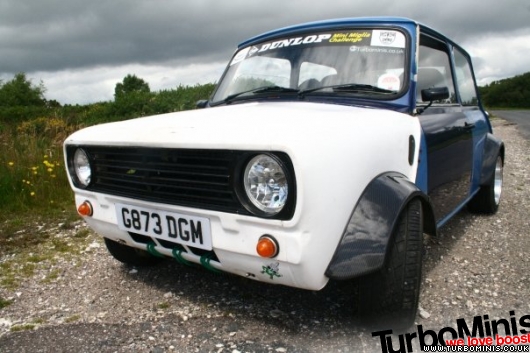

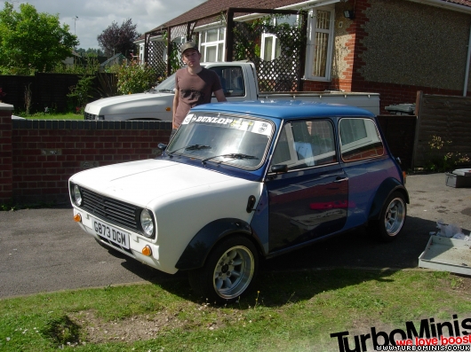

Havn't updated in a while as i've been away at uni! The car's ready for it's MOT now. I've got a second bucket seat on its way aswell, bit pricey though!
Anywho here's what it looks like at the moment!:
Plan is to get it passed the MOT, iron out any problems. Gonna de-seam the rear valence and sort some bits of rust, tub the rear arches!
Then its on with the turbo build! I have alot of the bits so hopefully wont take me to long to make some decent progress!

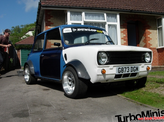

who is being noughty! two diffrent number plates on your car tut tut *tongue*
richminiturbo.
2370 Posts
Member #: 719
Horndean - Near Portsmouth
But youre supposed to have a white one on the front and a yellow one on the back *tongue*
Only had the black and silver plates on to see what it would look like. Reckon I might get some made up for the actual reg of the car

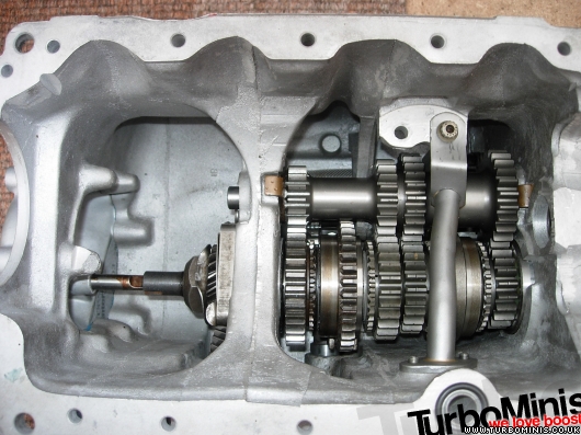

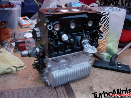

But yeah, I got my the block built up and phase 2 cam all in and timed perfectly!(just resting on empty gearbox casing in this pic):
Got the minispares 4 pin diff all built up and put into the box:
When stripping the old diff to get the output shafts out I found the pin in this condition:
^^ This was the same both ends, quite suprising!!
Got the clubman sccr gearset in the box and everything went swimmingly, well happy with myself:
So now the short motor and gearbox are attatched together! Drop gears and oil pump are on and Im waiting for an ultralight backplate, grey diaphragm and clutch plate. Hopefully later this month a fully worked benross head will be going on aswell!!:
(I didnt build it all on the conservatory floor *tongue*, just attatched the block to the box!)

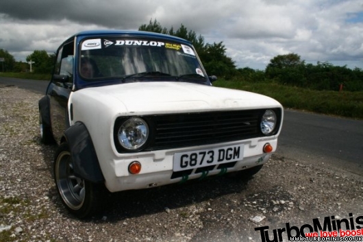

Thought i'd whack up some recent pics as i are bored:)
Mx5 Looks about the saime size!
^^ I go out fiesta hunting sometimes, all im after is the dam EDIS module and bits, but they get away as the n/a engine is cack*tongue*
