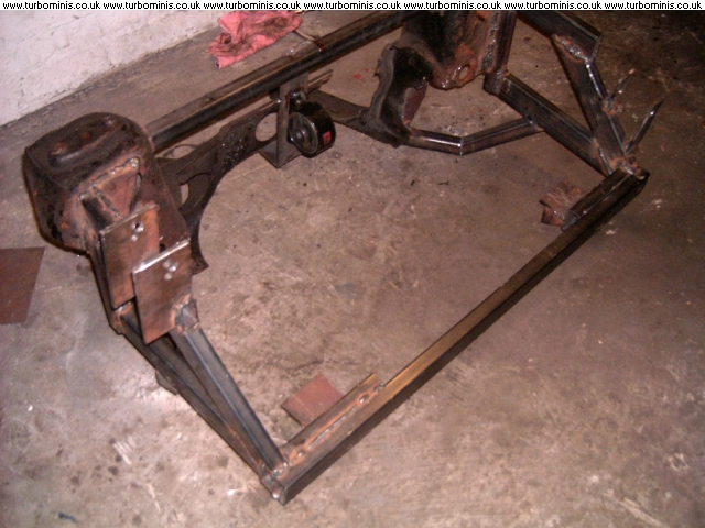

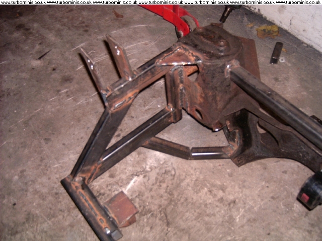

well bit of an updae for those that will be interested. sold my a series and all associated spares etc so no going back now. so ive been making my subframe, which is almost complete just a few bits to change, strengthen or tidy up. my new frame weighs 25kgs maybe a bit more. sump and diff are approx 4 inches off the floor will have to be carefull on the old speed humps.
my target is easter but to be honest depends on funds
4310 Posts
Nice bit of fabrication you have got going on there. I'll be interested to see how this develops.
loooking good, i cant wait to see it in action
Looking good Carl,
I'm really excited about this project, it's going to be a great balance of performance and power (while the engine is standard at least).

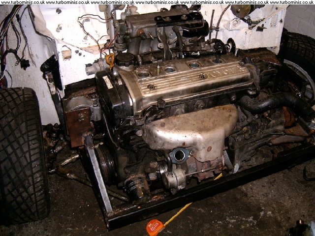

got to try me front on at weekend got a feeling it may not fit*oh well*
4310 Posts
What does the engine and box weigh in at roughly?
Carl
2924 Posts
Member #: 95
liverpool-on-sea
dont know tried to find out, but havent succseeded. cant get it to balance on the bathroom scales.
looking good carl
could you draw the spec of the subby you made and post it ???
Carl
2924 Posts
Member #: 95
liverpool-on-sea
On 21st of Nov, 2007 at 06:45pm BENROSS said:
looking good carl
urm how do you mean, ive just been making it u as i go along. i can do measurements etc once its finished. would that be ok

Its moved on since last time i cam round. Looks solid enough.
Driveshafts next then?
yep, i hope to get the frame finished this weekend, so be expecting a visit soon. lol

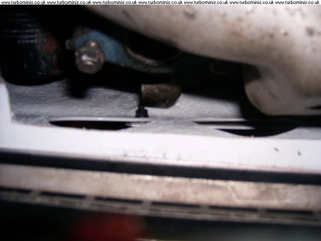

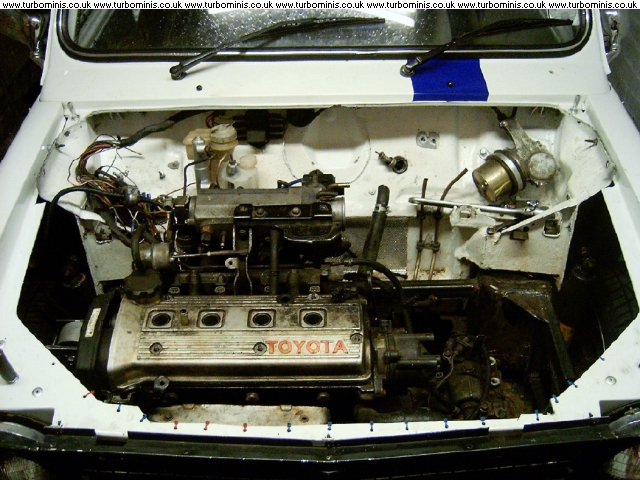

well another quick update.
tried fibreglass front on and it fits around the subby perfectly, im well happy. the engine doesnt look as low now the fronts on.
i fitted all me suspenson properly and ill have about 4-5 inches of ground clearence which aint to bad, altho not made the exhaust yet.
although i had to remove the turbo actuator to get the front on.
im either going to have to reposition the actuator or move engine back a little, i think icould move the engine about half an inch back with a little grinding and welding ill have to see.
also not much room for intercooler so may have to use the standard on which sits on to of the engine and put a vent on bonnet. ive seen pics of these conversions done and they seem to have the engine further back than me but i dont see how theyve done it cause of steering rack clearences,
im planning on using one of them slim honda radators on the gearbox side, should also have room to fit battery under bonnet.
